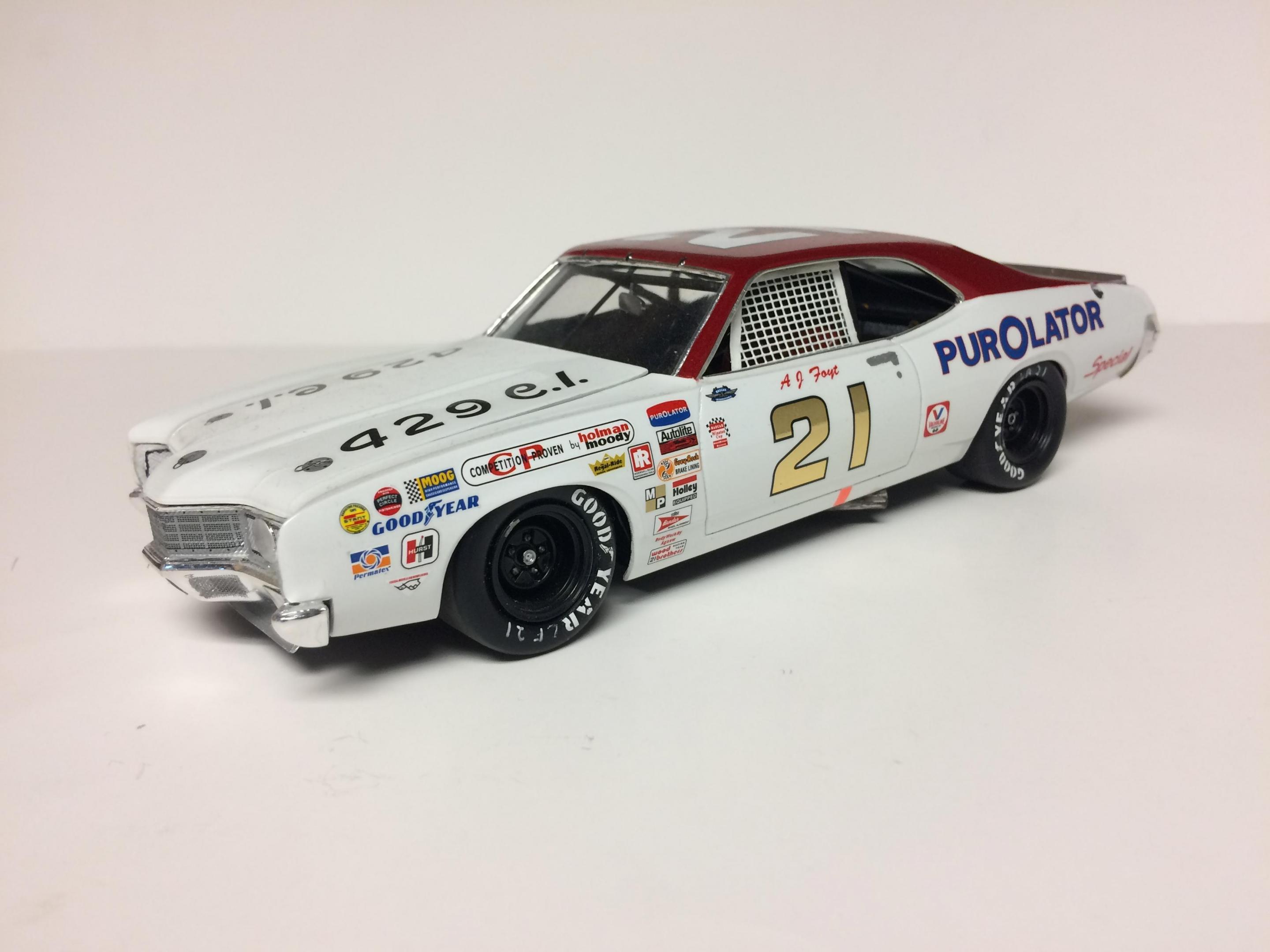

gks1964 Posted May 18, 2020 Author Posted May 18, 2020 7 hours ago, afx said: My Merc build with the PL chassis and 429. That's a beauty. Hope I cant do half as good!!
