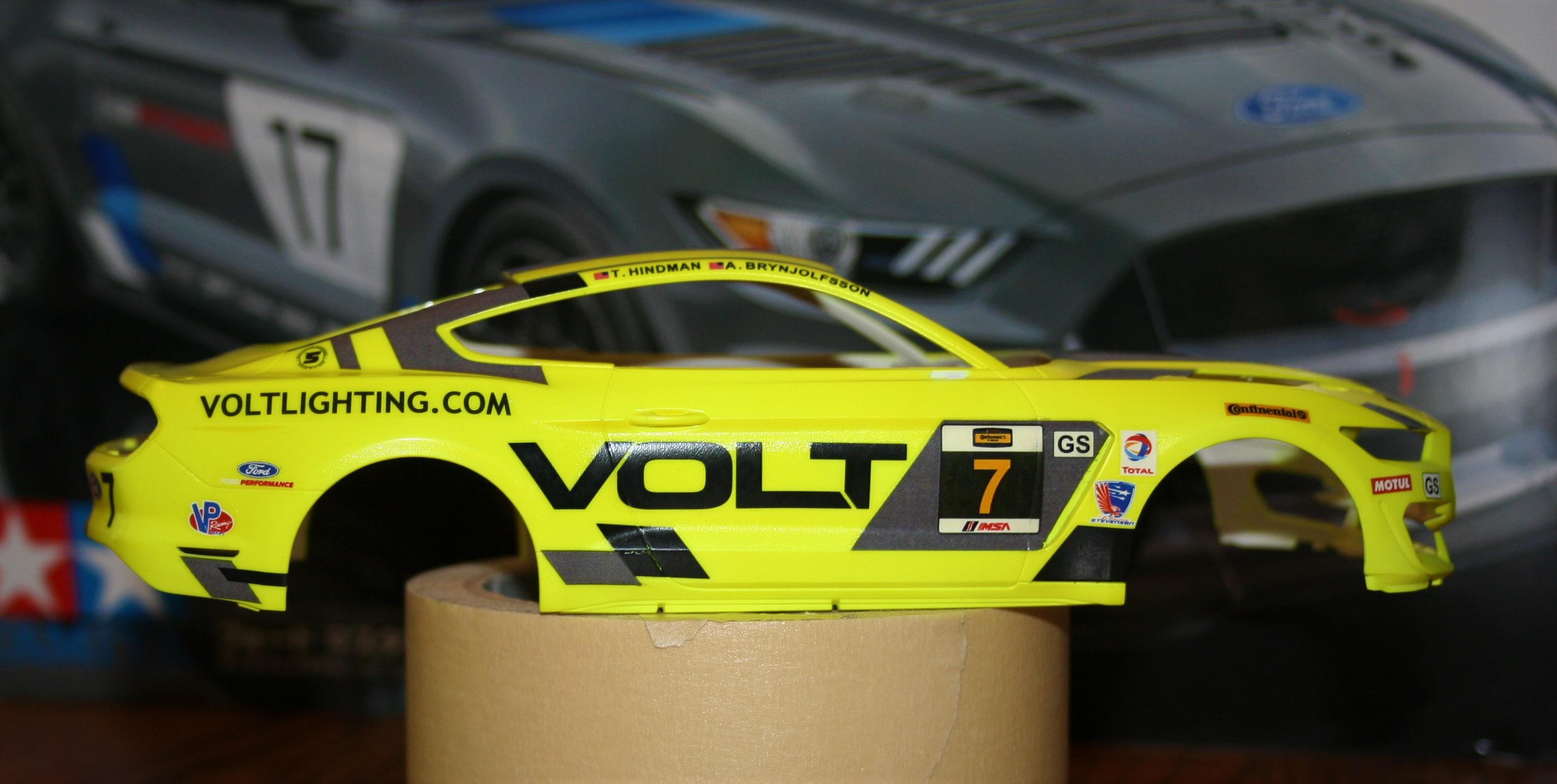

Penguins87 Posted August 9, 2020 Posted August 9, 2020 I started this a week ago. Tamiya GT4 kit, Gravity Colors EUR flourescent yellow exterior sprayed over Tamiya fine white primer. Interior is AS20 Insignia White. Sprayed a coat of Tamiya clear to smooth out and seal the color for decals. IndyCals for the decals- microsol and hair dryer on low to set them. Going to now give it about 3 coats fo HOK USC01 clear. I have to touch up a couple places where the grey decal didn't cover over a lip. Tamiya's German Grey is a match. Quote
CabDriver Posted August 15, 2020 Posted August 15, 2020 Nice job! Looks like a complex decal job, but you got them nailed - looks great in that flouro yellow too! Killer! I’ll be watching! Quote

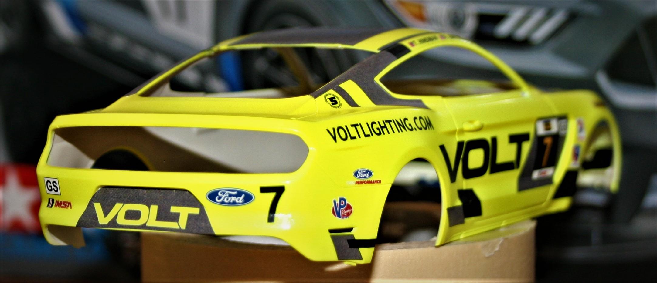

Penguins87 Posted August 16, 2020 Author Posted August 16, 2020 I got the tires sanded and decaled last night. This morning I gave the body three coats of HOK USC01 clear. Now it must sit for 24 hrs. for clear to cure. Quote
martinfan5 Posted August 19, 2020 Posted August 19, 2020 (edited) It looks like you had much better luck and results with Indycals than I did, but there are not any decals trying to go over complex curves for that livery like with some of the other ones. Edited August 19, 2020 by martinfan5 Quote
Funkychiken Posted August 23, 2020 Posted August 23, 2020 Cool car, paint decals and clear look perfect! Quote
