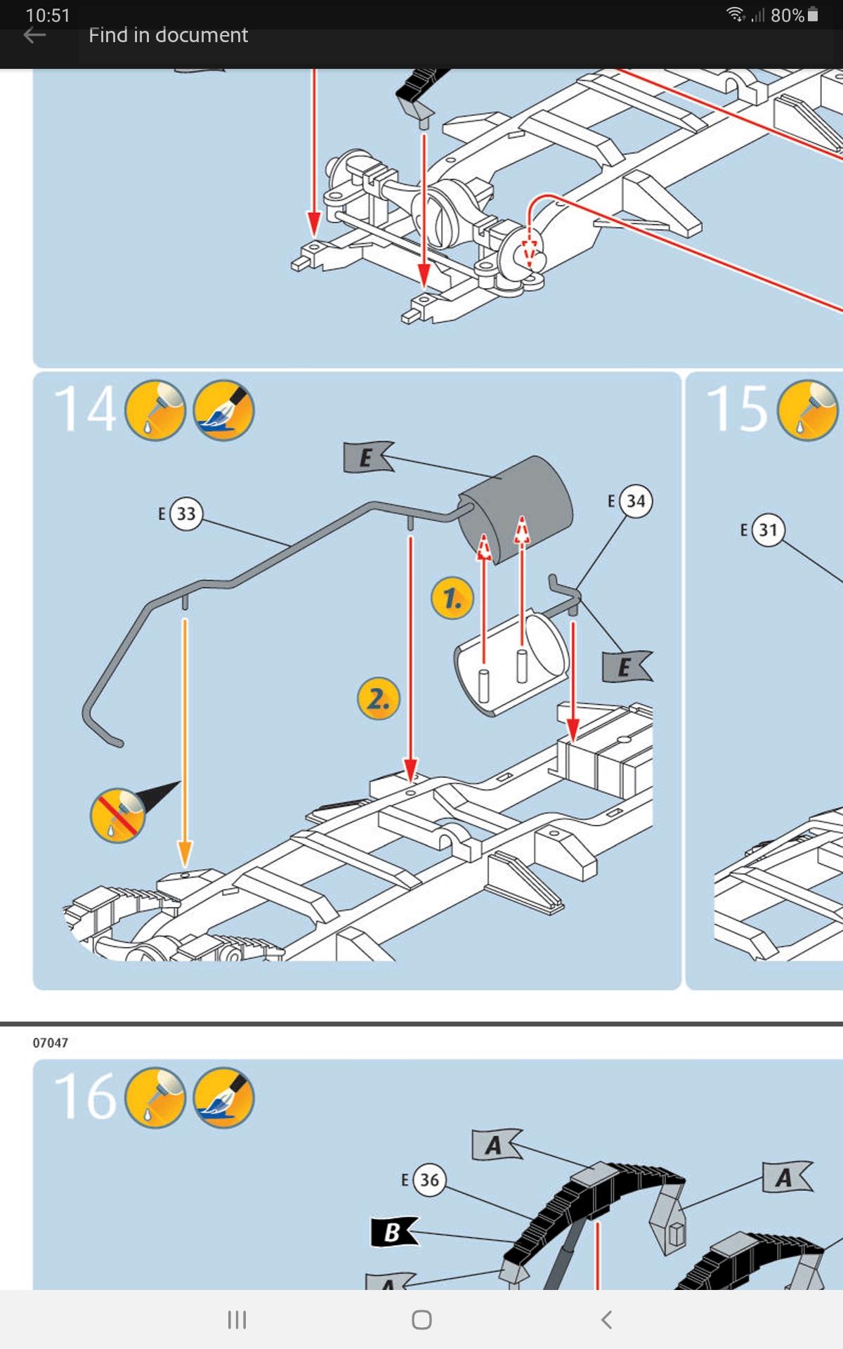

martinfan5 Posted September 14, 2020 Posted September 14, 2020 (edited) Just a heads up, if you connect the exhaust pipe to the engine like the instructions say, you wont be able to attach the interior bucket to the frame ?, attach it after you join them together. Edited September 14, 2020 by martinfan5
lrlocke01 Posted September 14, 2020 Posted September 14, 2020 Just started this kit myself. Love it so far.
GeeBee Posted September 14, 2020 Posted September 14, 2020 8 hours ago, martinfan5 said: Just a heads up, if you connect the exhaust pipe to the engine like the instructions say, you wont be able to attach the interior bucket to the frame ?, attach it after you join them together. There's nothing wrong with the instructions, just follow them correctly, don't glue the exhaust to the chassis frame at the front, as instructed, and pass the exhaust through the inner wings before gluing it to the manifold
mrmike Posted September 14, 2020 Author Posted September 14, 2020 Thanks Jonathan, Rickey and Geoff! I had noticed the exhaust and interior mounting as I was reading the instructions earlier. I was going to leave the exhaust off until after the interior was mounted to the frame. Thanks to all for the heads up!
martinfan5 Posted September 14, 2020 Posted September 14, 2020 9 hours ago, GeeBee said: There's nothing wrong with the instructions, just follow them correctly, don't glue the exhaust to the chassis frame at the front, as instructed, and pass the exhaust through the inner wings before gluing it to the manifold You're right, I must of, well, didnt see that part for whatever reason and did the exhaust first.

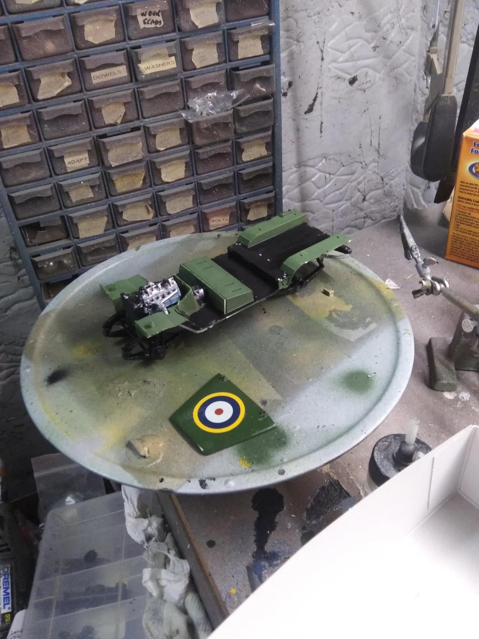

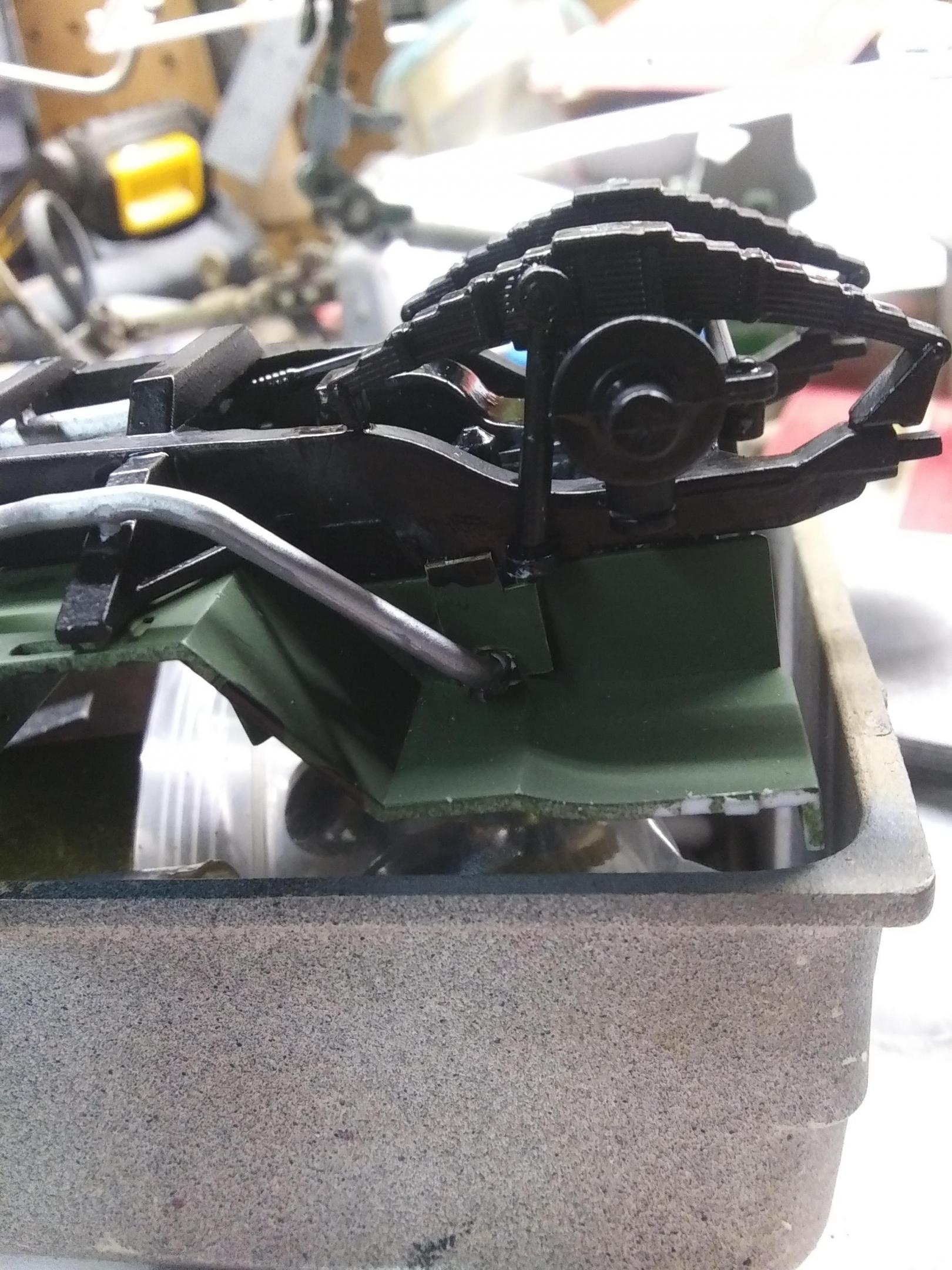

philo426 Posted September 21, 2020 Posted September 21, 2020 I didn't read ahead and had to cut a slot abd patch it with a plate!

philo426 Posted September 22, 2020 Posted September 22, 2020 Well all of my previous car models did not route the exhaust pipe through the fender wells unless they were drag headers.Still I should have read the directions all the way through...live abd learn!

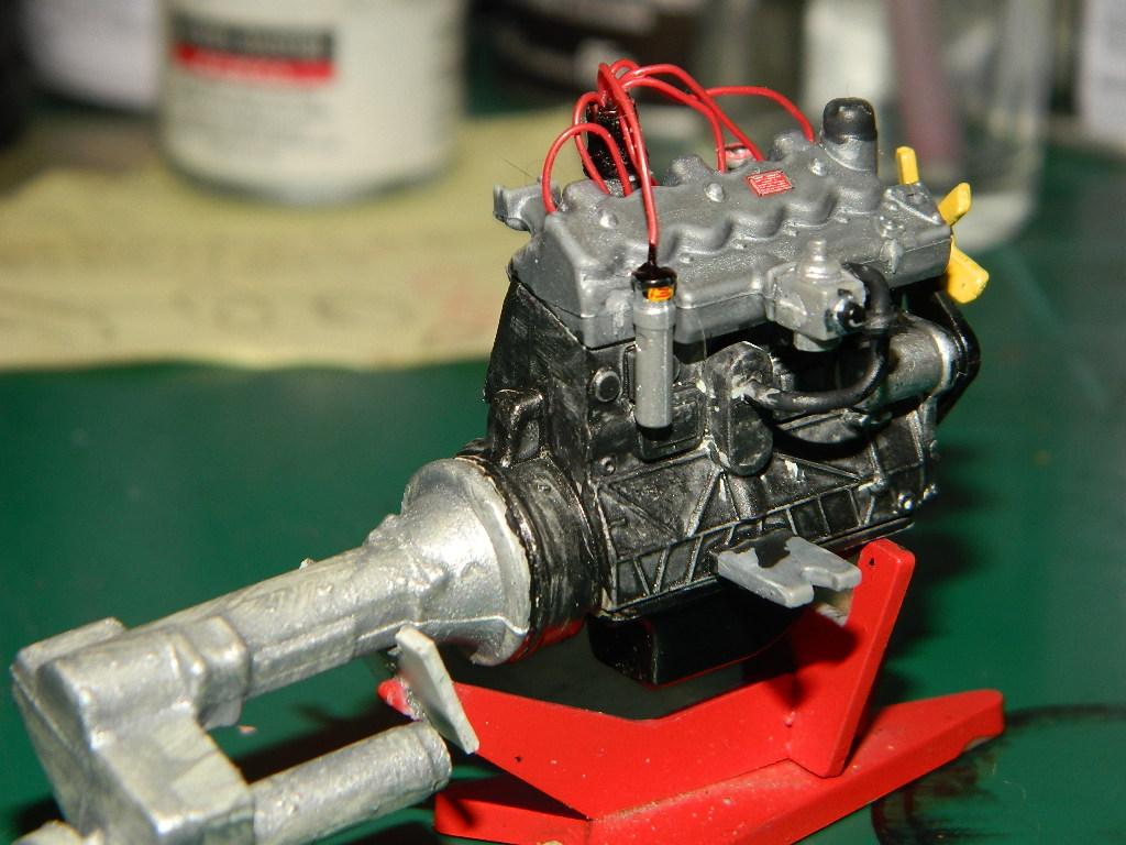

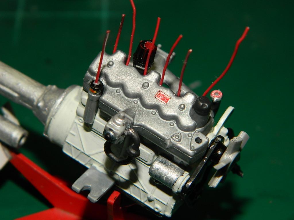

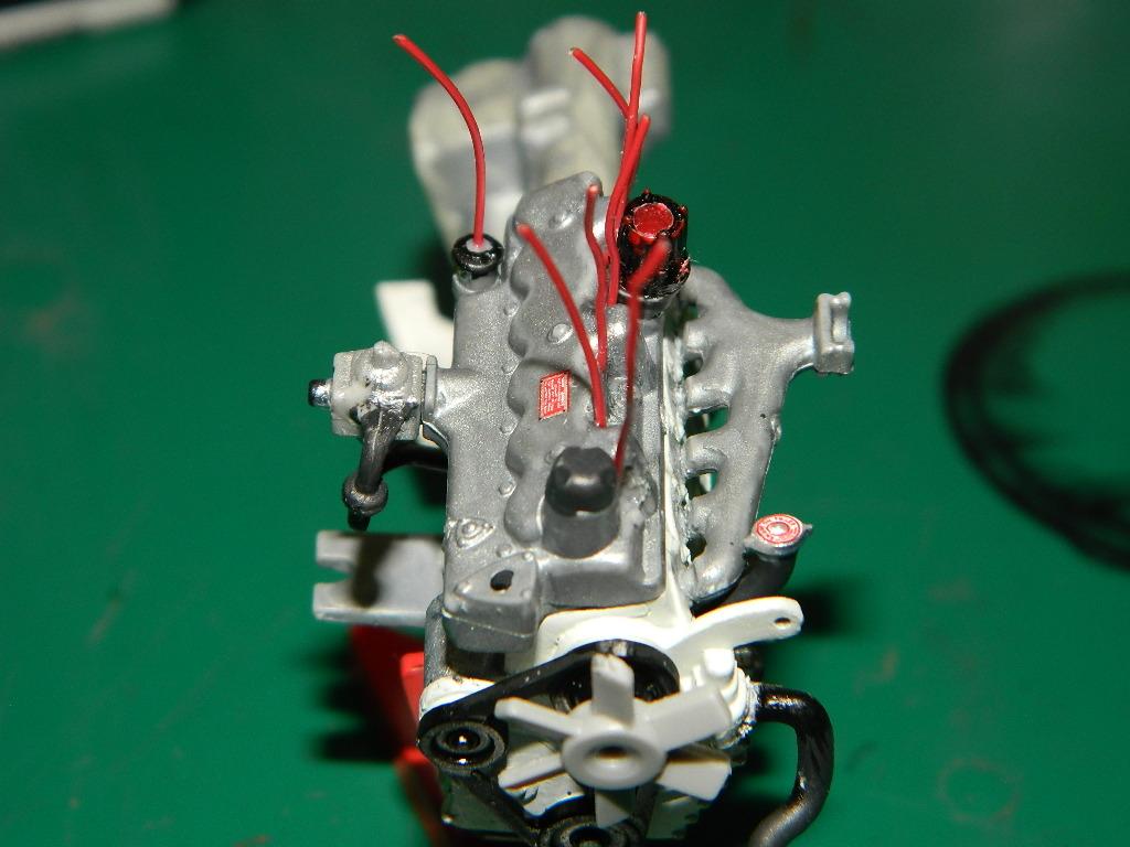

mrmike Posted September 22, 2020 Author Posted September 22, 2020 The Story McNally gets off the plane in Liverpool and he catches a cab to Westby Hospital to visit with Angus. Angus is happy to see him and he tell McNally where everything is at the farm, including the keys to the Land Rover Series III LWB which is parked on the side of the house. McNally tells Angus that he will do his best with the harvest and for him to not to worry about anything and to get better. Angus tell him that he glad that McNally made the trip across the pond and he will try to get better. Then a nurse comes into the room and throws McNally out. The Build The 2.6 L straight six engine is nearing completion. I have wired it, but in the process, I destroyed the distributor, sending me looking for another distributor cap which I found in the parts box. McNally will return...

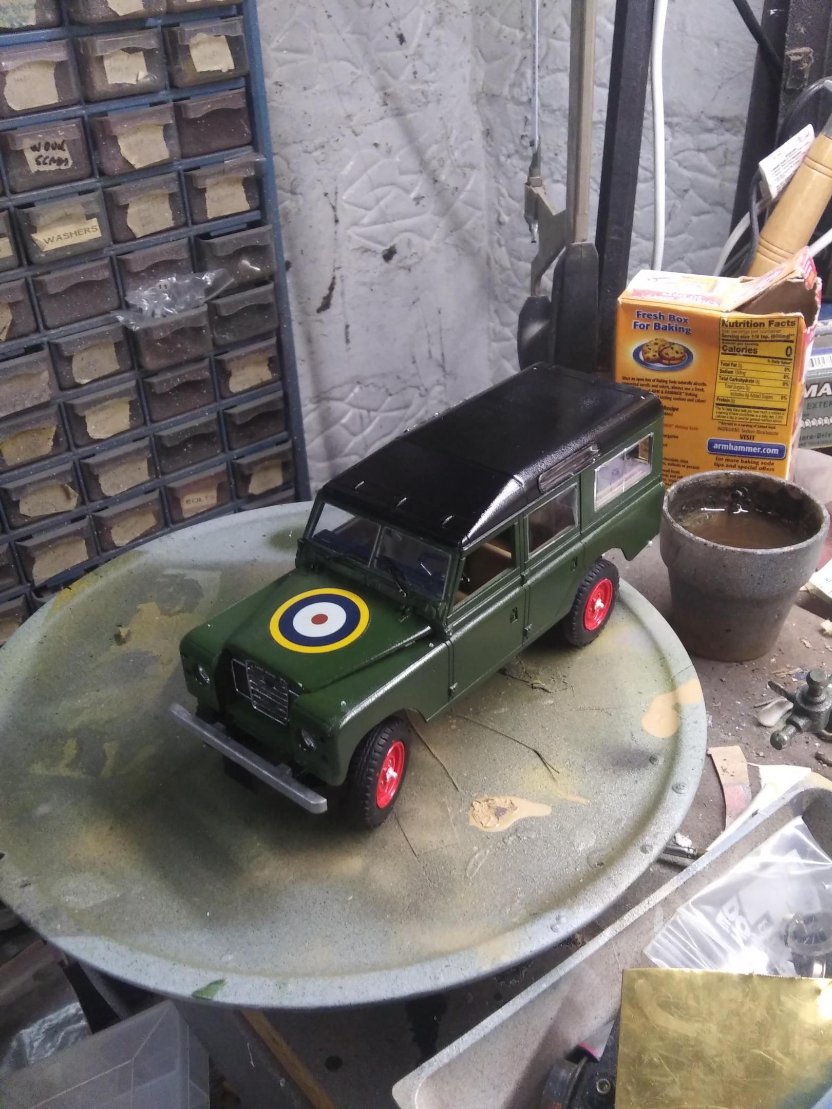

philo426 Posted September 24, 2020 Posted September 24, 2020 Came out exactly the way I wanted !Represents a custom restoration of a classic Land Rover..
mrmike Posted September 25, 2020 Author Posted September 25, 2020 Nice. Why are you posting your build on my WIP thread?

mrmike Posted December 6, 2020 Author Posted December 6, 2020 The Story The National Crime Agency sends a team of investigators to Alston-at-Harkness and the McCann Farm. While they are looking around at McCann Farm, Agent Barchans of the NCA is at the Police Station with PC Dunbarton questioning him about Alfred McCann and what he knows about him. McNally walks into the Police Station to check up on PC Dunbarton and Agent Barchans says no comments to any information to anyone. Dunbarton explains that McNally is a former Boston Police Department Police Officer and that he can be trusted. Barchans wants McNally out of the Station and the area. The Build I spent a little time on the Land Rover yesterday. I painted the hubs and the lugnuts with Tamiya Semi Gloss Black.. I got the driveshafts and the radiator installed. Then, I noticed that the lower radiator hose was missing and I made one out of some tubing I had lying around on the bench.

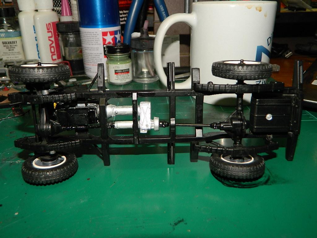

mrmike Posted December 10, 2020 Author Posted December 10, 2020 The Story McNally met Angus Burrows while he was in the US Army. Angus was an instructor at the base teaching Covert Surveillance Applications and McNally was one of his pupils. The class was a tough one for McNally, so he studied this class more than the others and asked more questions and he did rather well with it. When McNally graduated, he became friends with Angus until he retired a couple of years later and he returned to England. He has worked on his farm ever since. The Build Adding the driveshafts had created a problem...the engine was cockeyed! I ended up removing the engine and shortening the housing for the front driveshaft. This put the engine back into the motor mounts like it should instead of sitting on the edge of the engine mount. Now, everything sits straight! McNally will return...
