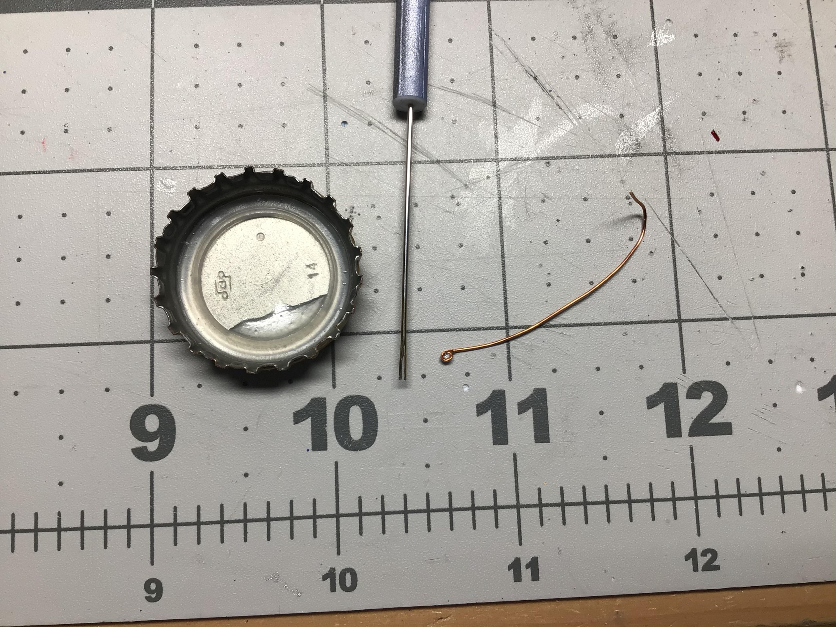

NOBLNG Posted December 7, 2020 Posted December 7, 2020 (edited) 1 hour ago, TransAmMike said: Peter I thought that I should mention what glue. I like to use the Super Glue brand sold at the Dollar Store. Dries real fast but soooo many times I wind up with a drop of glue on a finger and invariably touch it on the paint Grrrr. Maybe I need to use a liquid glue but does it dry fast?? I have the same problem with super thin CA glue. There is NO WAY I can apply it from the bottle. First the nozzle is usually plugged and I have to open it with a pin. Then it will dispense way too much. I usually put a couple of drops in a bottle cap and use an applicator made from a thin piece of wire. I also made an applicator for the kicker from a large sewing needle that I ground the tip off of to make a tiny fork. It would likely work better than the wire for the glue also.? You can most likely buy special applicators at a hobby shop? The Tamiya extra thin quick set will get your parts stuck together quite fast, but takes a fair while to completely evaporate and gain full strength. The medium or extra thick CA glues are easier to manage but also dry slow unless an accelerator is used. What type of joints are you needing it to dry quickly for? Things like door handles, mirrors and wipers, or....? Edited December 7, 2020 by NOBLNG
TransAmMike Posted December 7, 2020 Posted December 7, 2020 Greg I use a pointed toothpick the way you use the needle and as you said, the darn nozzle on the glue bottle stops up so yeah, gotta poke it with a needle.
