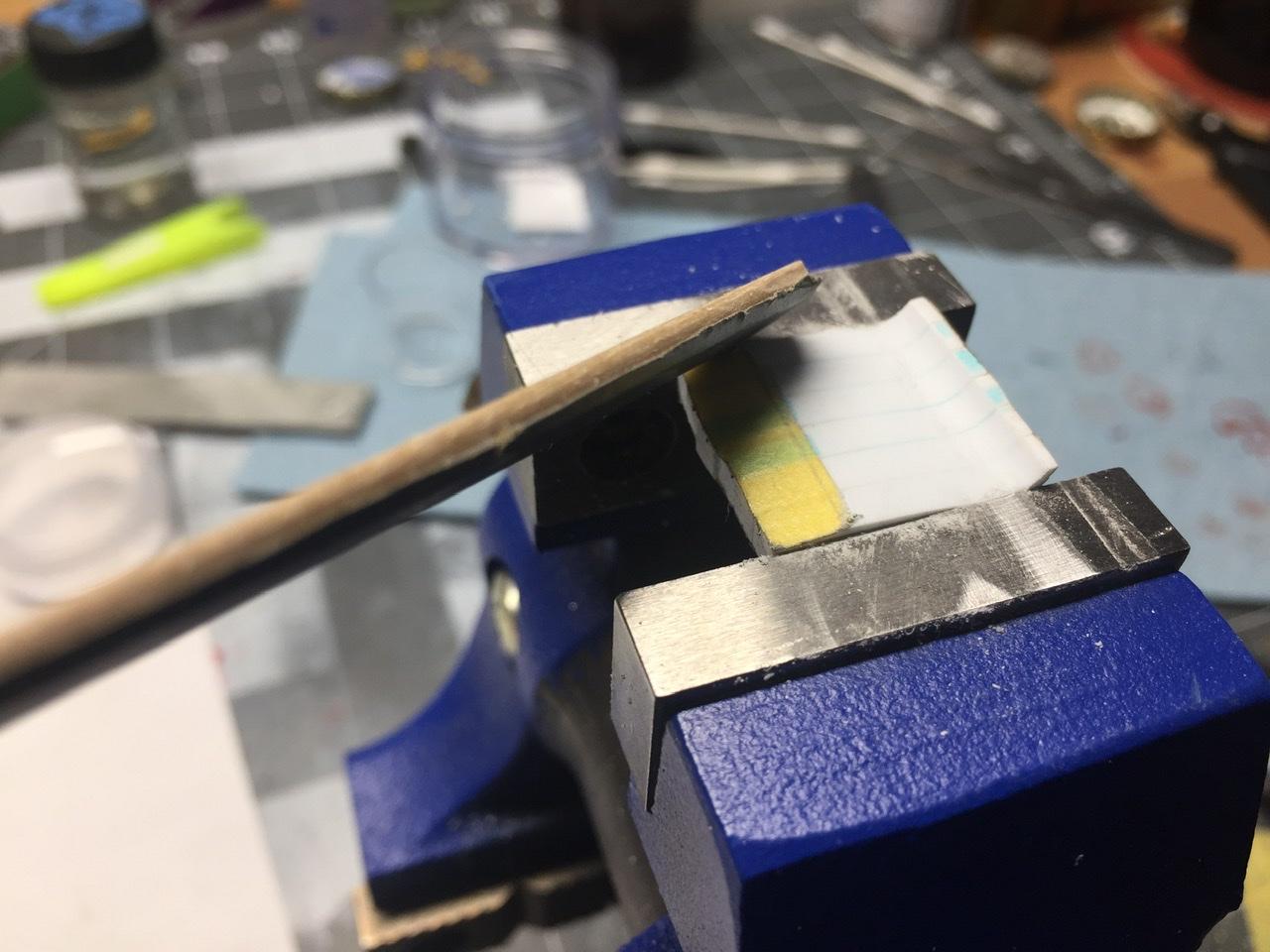

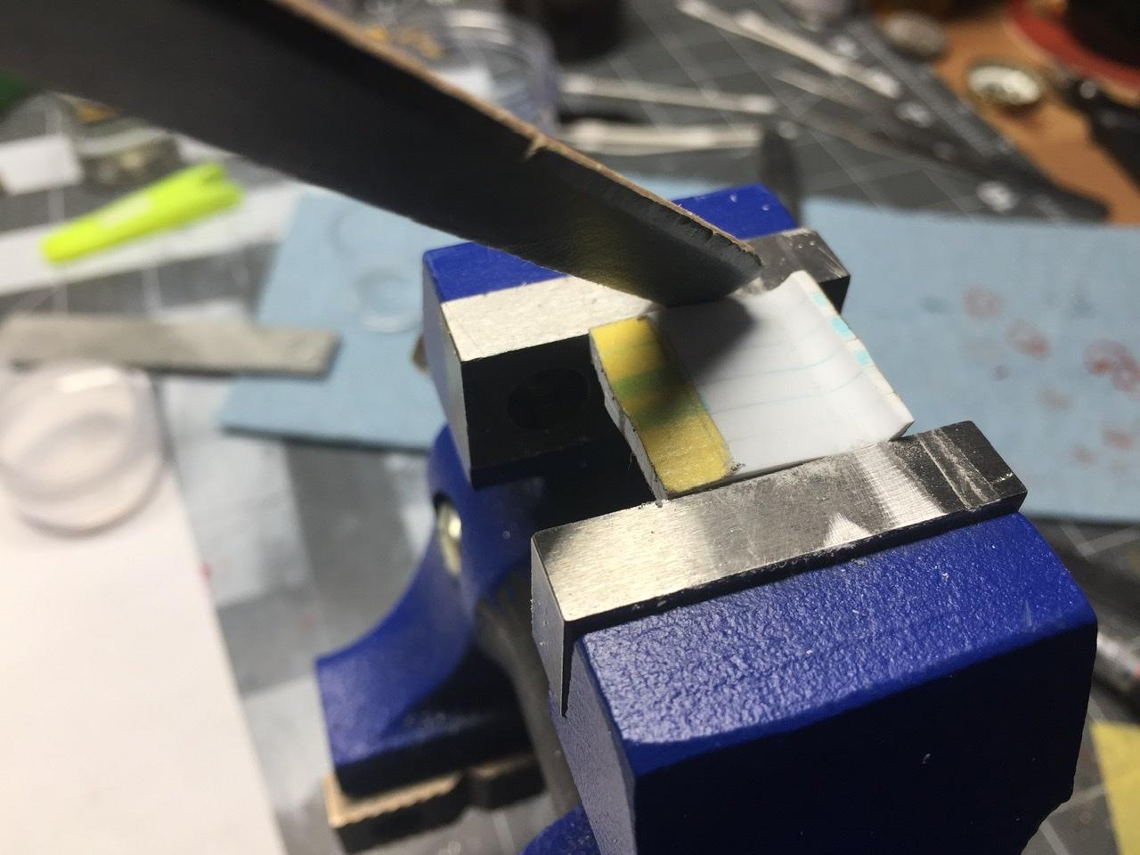

I make my own too. I use 3M tape and I cut one side flush so I can sand tight to an inside 90 degree corner. The other side, I leave the sandpaper Sticking out 1/16”- 3/32”  so I can sand an inside radius corner.

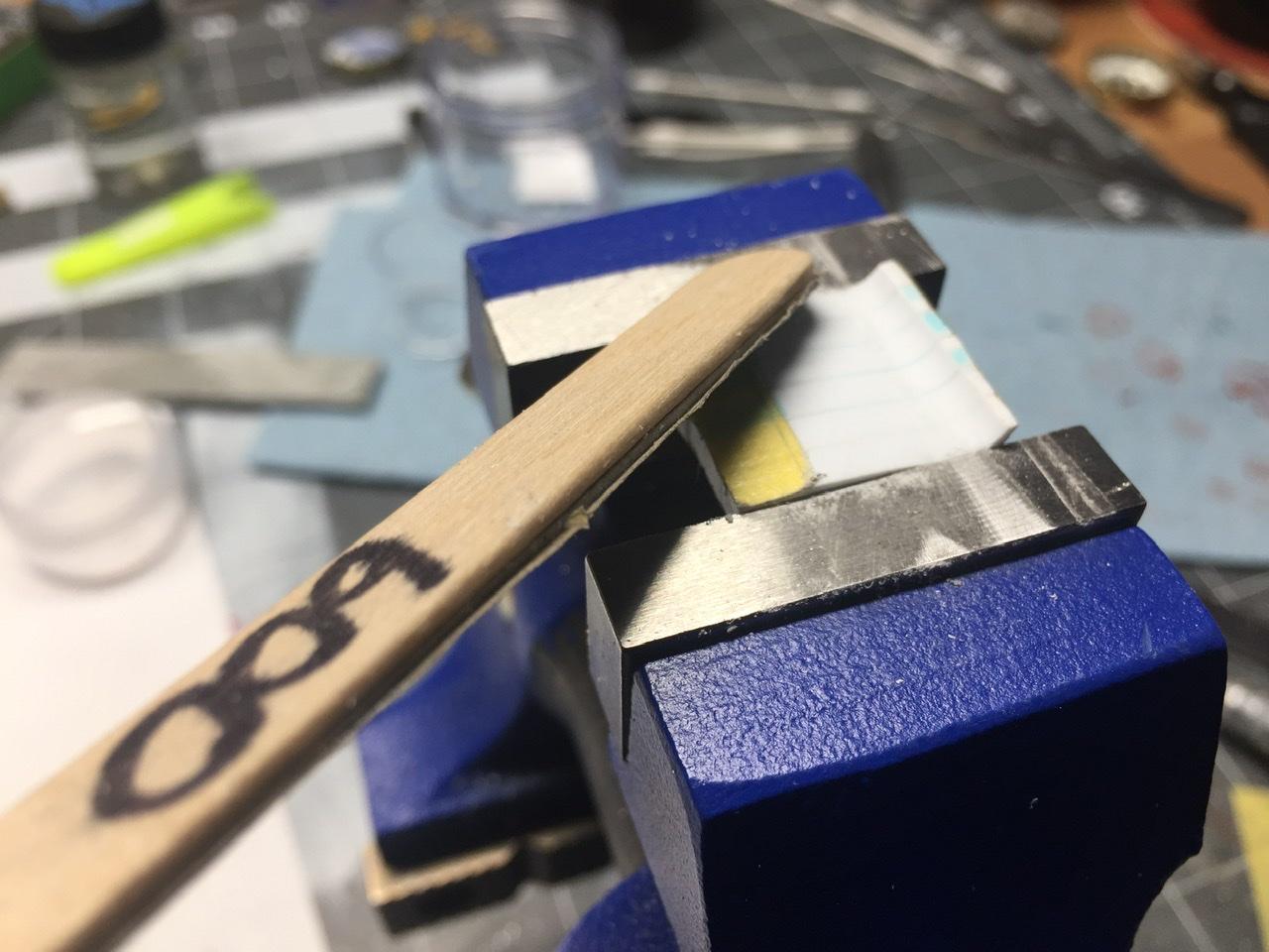

This is why I leave the paper wider than the stick. It makes it easy to sand an inside radius like this without leaving any score marks from the edge of the stick.

I make mine out of popcycle sticks cut to whatever width I want. I cut strips of whichever grit of sandpaper I was a little wide & use Testors glue that's in orange/red tube. When dry I trim off excess sandpaper.
