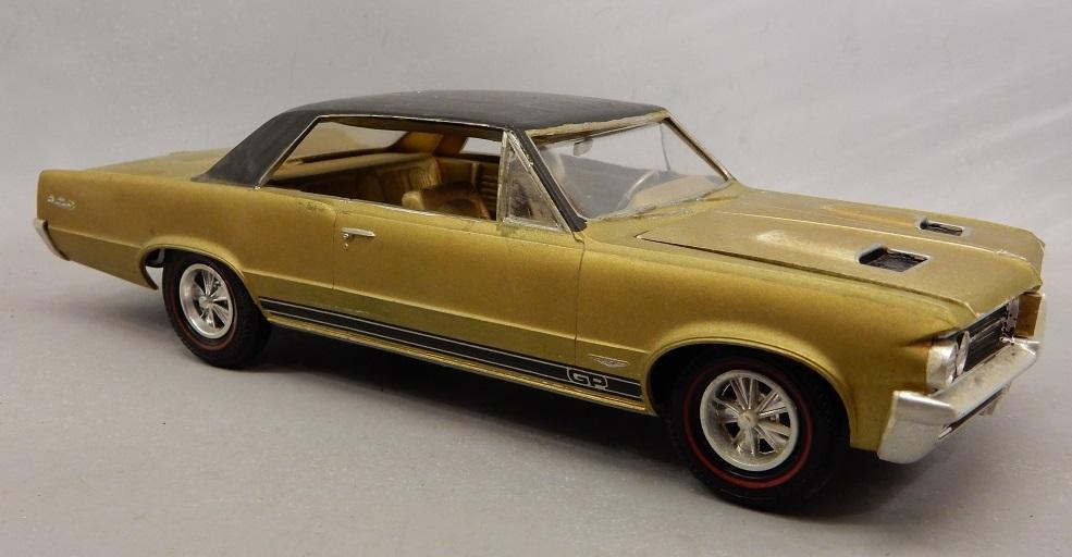

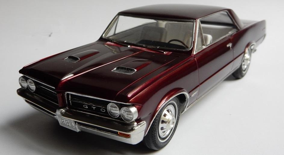

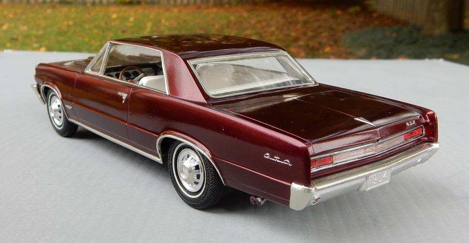

pack rat Posted October 25, 2020 Share Posted October 25, 2020 (edited) My latest restoration; an AMT '64 GTO. I've never fussed over the Monogram or Polar Lights kits to compare them to the 1:1 car, but to me this is the "proper" '64 GTO kit. Sure, it's a simple old '60's-era kit with the metal axle through the oil pan etc etc, but I just like the old stuff and to me this one looks right. Basically box-stock. I was missing the AMT hood inserts so I massaged a Monogram hood to fit. The fit is a little wonky at the front corners, but I have the AMT hood painted to match just in case I ever find the inserts. Paint is Tamiya TS-74 clear red over TS-38 gunmetal to simulate Marimba Red; not bang-on but I'm satisfied with the look. Edited October 25, 2020 by pack rat Quote Link to comment Share on other sites More sharing options...

doorsovdoon Posted October 25, 2020 Share Posted October 25, 2020 When I read the description and saw the first photo I was going to say it looks pretty nice, which it does, but then I scrolled down and saw what you made of it! Very nicely done, hard to believe it's the same car. Great job! Quote Link to comment Share on other sites More sharing options...

charger74 Posted October 26, 2020 Share Posted October 26, 2020 Very Nice, the color looks great.and i really like those hubcaps Quote Link to comment Share on other sites More sharing options...

espo Posted October 26, 2020 Share Posted October 26, 2020 Man that color is striking to say the least. I like the bright white interior. I would keep those old Hurst Mags around as a switch set of wheels. Very nice job getting the rear of the roof to match up with the body. Like you I'm also a fan of the early AMT bodies but with the metal axles I just cut them to length and use them as a spindle and fill the hole in the engine. This along with a little radiator detailing and hoses and they look almost as nice as any of the newer better designed kits. You got all of the chrome trim nice and cleanly done. Quote Link to comment Share on other sites More sharing options...

Bob Ellis Posted October 26, 2020 Share Posted October 26, 2020 20 hours ago, doorsovdoon said: When I read the description and saw the first photo I was going to say it looks pretty nice, which it does, but then I scrolled down and saw what you made of it! Very nicely done, hard to believe it's the same car. Great job! I agree, the as found picture shows a decent find. But now it is perfect. Quote Link to comment Share on other sites More sharing options...

drodg Posted October 27, 2020 Share Posted October 27, 2020 Looks so good and period correct. It looks like you freshened the chrome. Did you do it yourself or sent them out? Quote Link to comment Share on other sites More sharing options...

pack rat Posted October 27, 2020 Author Share Posted October 27, 2020 1 hour ago, drodg said: It looks like you freshened the chrome. Did you do it yourself or sent them out? Front/rear bumpers were touched up after cleaning with srategically-applied BMF and Molotow liquid chrome. I'm still experimenting with the Molotow. The ink can give pretty good results when applied with a brush to some areas, not so good in others (applying it with the pens isn't worth the trouble due to the "dulling" issue discussed by others). The GTO scripts and grille/headlight areas were done this way. but I also tried it on the wheel lip moldings; they looked like BLAH_BLAH_BLAH_BLAH. The profile pic (second from bottom) was taken before I re-did the moldings with BMF. Quote Link to comment Share on other sites More sharing options...
