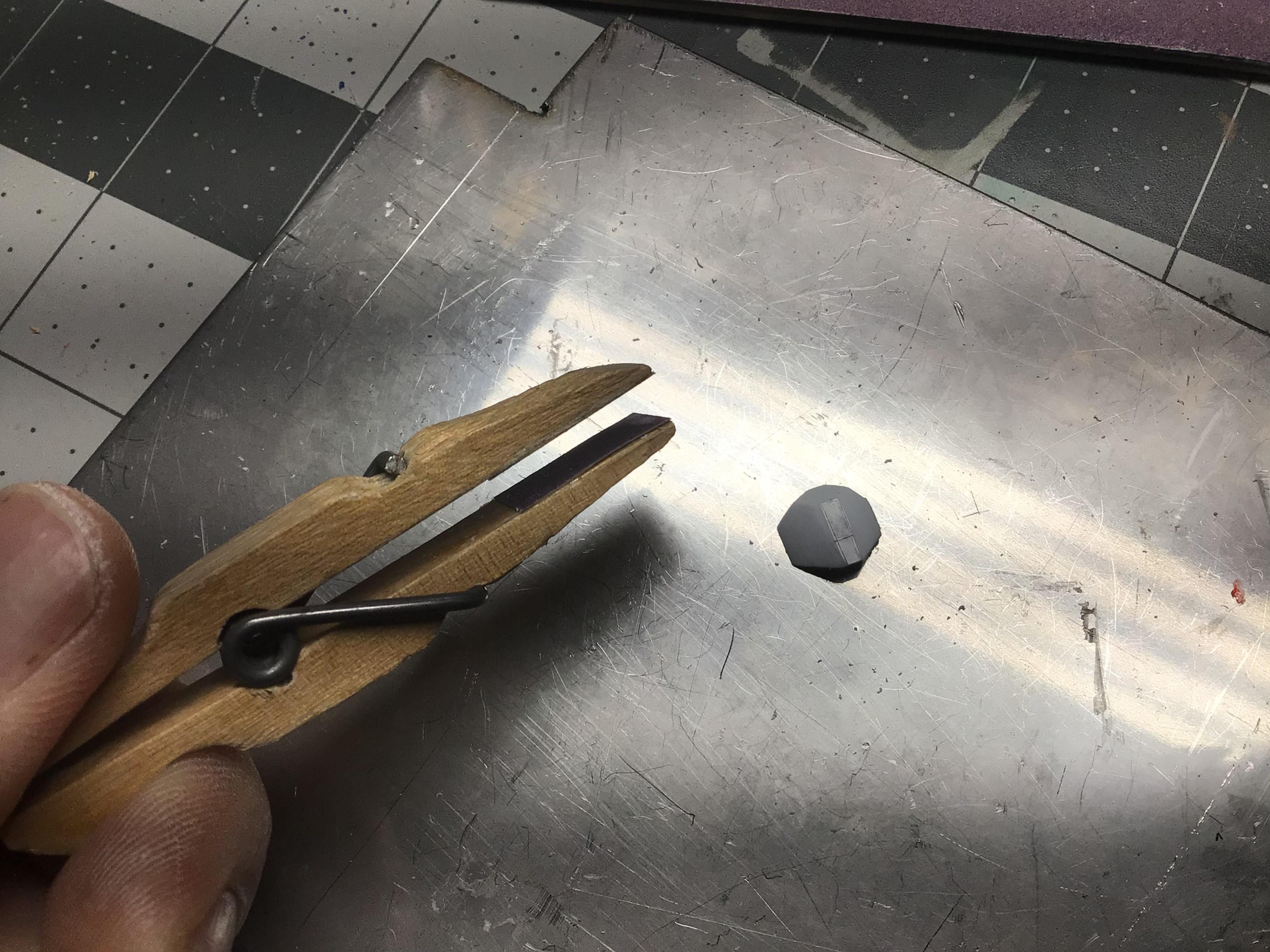

NOBLNG Posted December 13, 2020 Posted December 13, 2020 (edited) I use these alligator clips a lot for clamping things. They have a nice strong spring and can get in where other clamps can’t. Sometimes though, the teeth can mar the finished paint or chrome. So I trimmed a piece of popsicle stick to fit inside the jaws and then filed the teeth down flush to the wood. If anyone has any other handy tiny clamps, please post them up here. Edited December 13, 2020 by NOBLNG
TransAmMike Posted December 13, 2020 Posted December 13, 2020 Wow Greg, great idea about the wood in the clamp. Those teeth can definately do damage.?

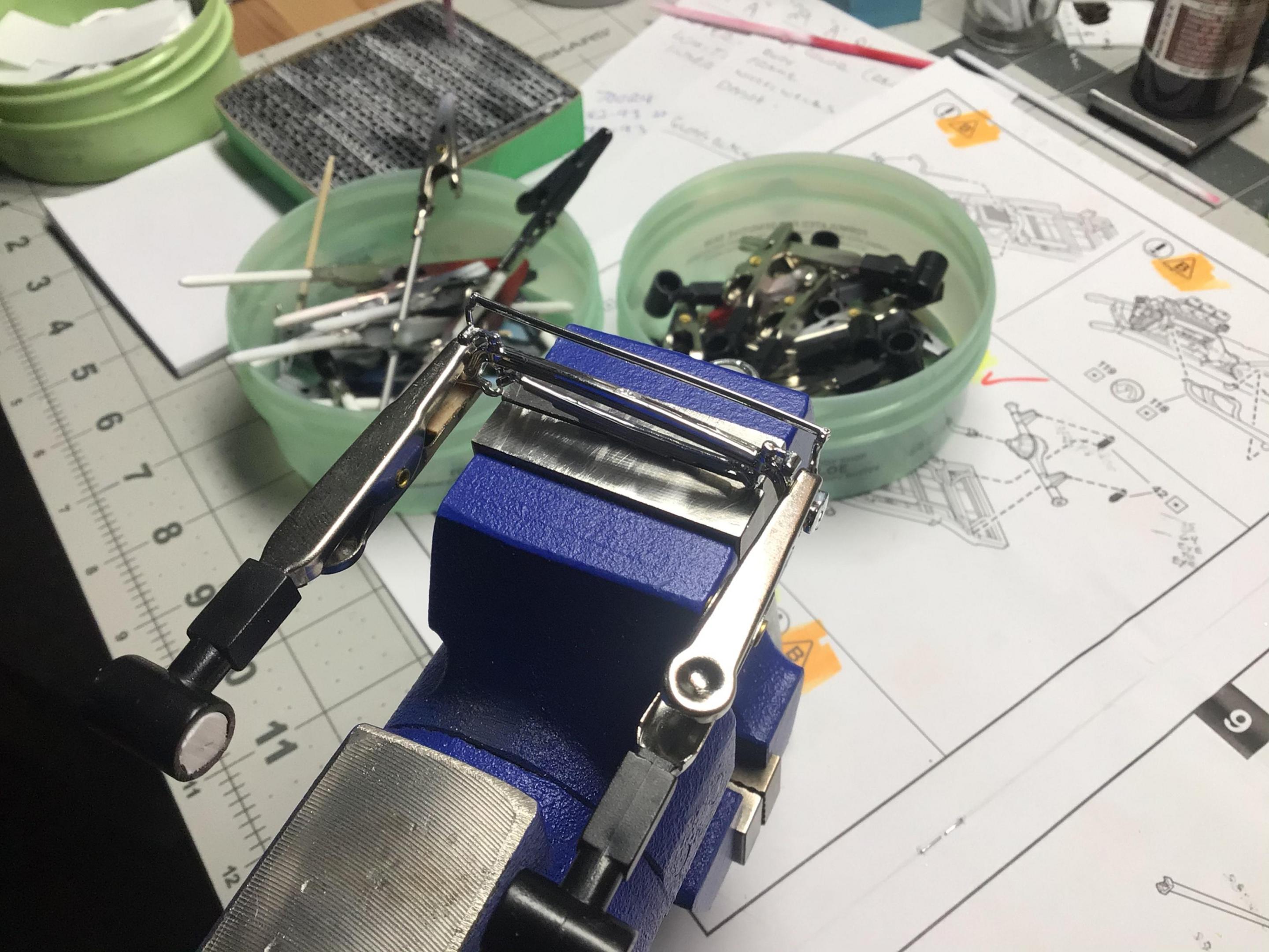

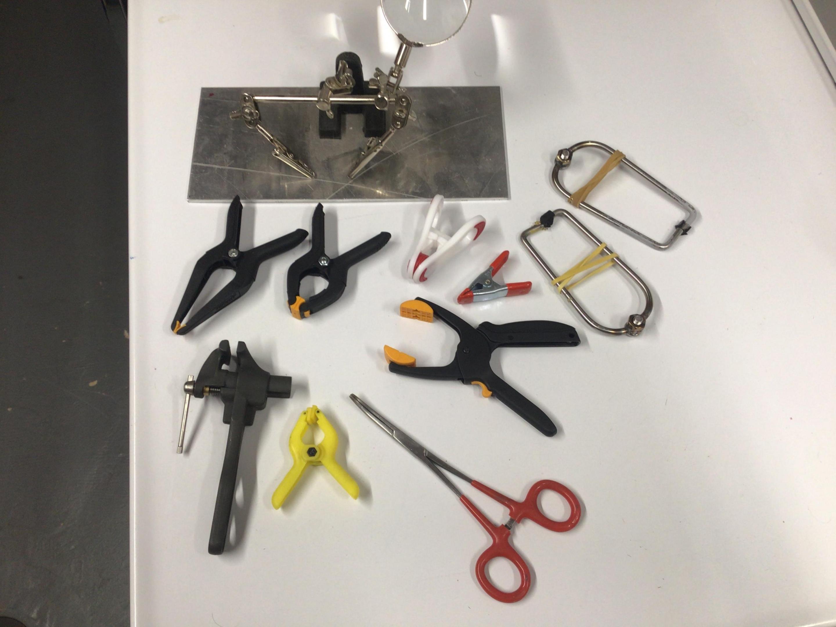

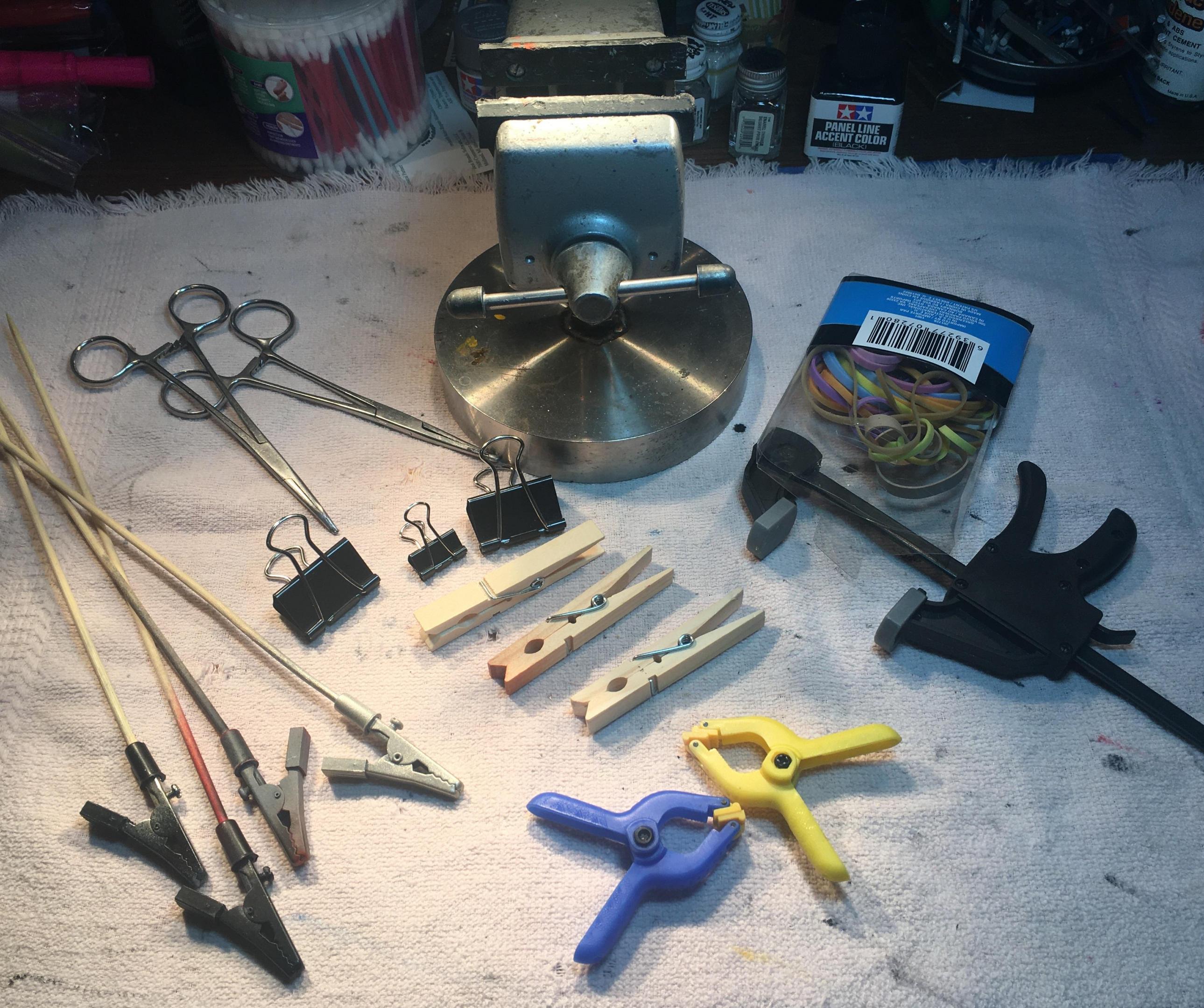

Bills72sj Posted December 13, 2020 Posted December 13, 2020 I use a range of clamps based on the reach and/or tension required. I use alligator clips mostly for spray painting. I use both large and small black binder clamps from any office supply house. I use plain wooden clothes pins for most of my gluing as the tension is adequate but they do not open very wide. I have some $1 store plastic clamps which are very versatile. I have a plastic jawed Panavise with a very heavy base which is invaluable for holding things still. I have some mini ratcheting clamps for big stuff. I even use rubber bands when they are needed. My favorite are the two pairs of hemostats for the tiny stuff fingers cannot deal with.
cheyenne93 Posted December 13, 2020 Posted December 13, 2020 I use these. Usually in a dollar bin at Value Home Center. Like four in a package.
NOBLNG Posted December 13, 2020 Author Posted December 13, 2020 Thanks Guys. I have some of those same clamps. I probably use these yellow ones and the white plastic ones the most. The long nose ones on the left are handy, as they have very tiny jaws. I made a couple of long reach ones that use elastic bands for clamping, but they are a little sloppy. I may have to re-make them. My hemostats will pretty much crush any plastic part if I clamp tight enough to lock them...maybe good for installing metal pins.?

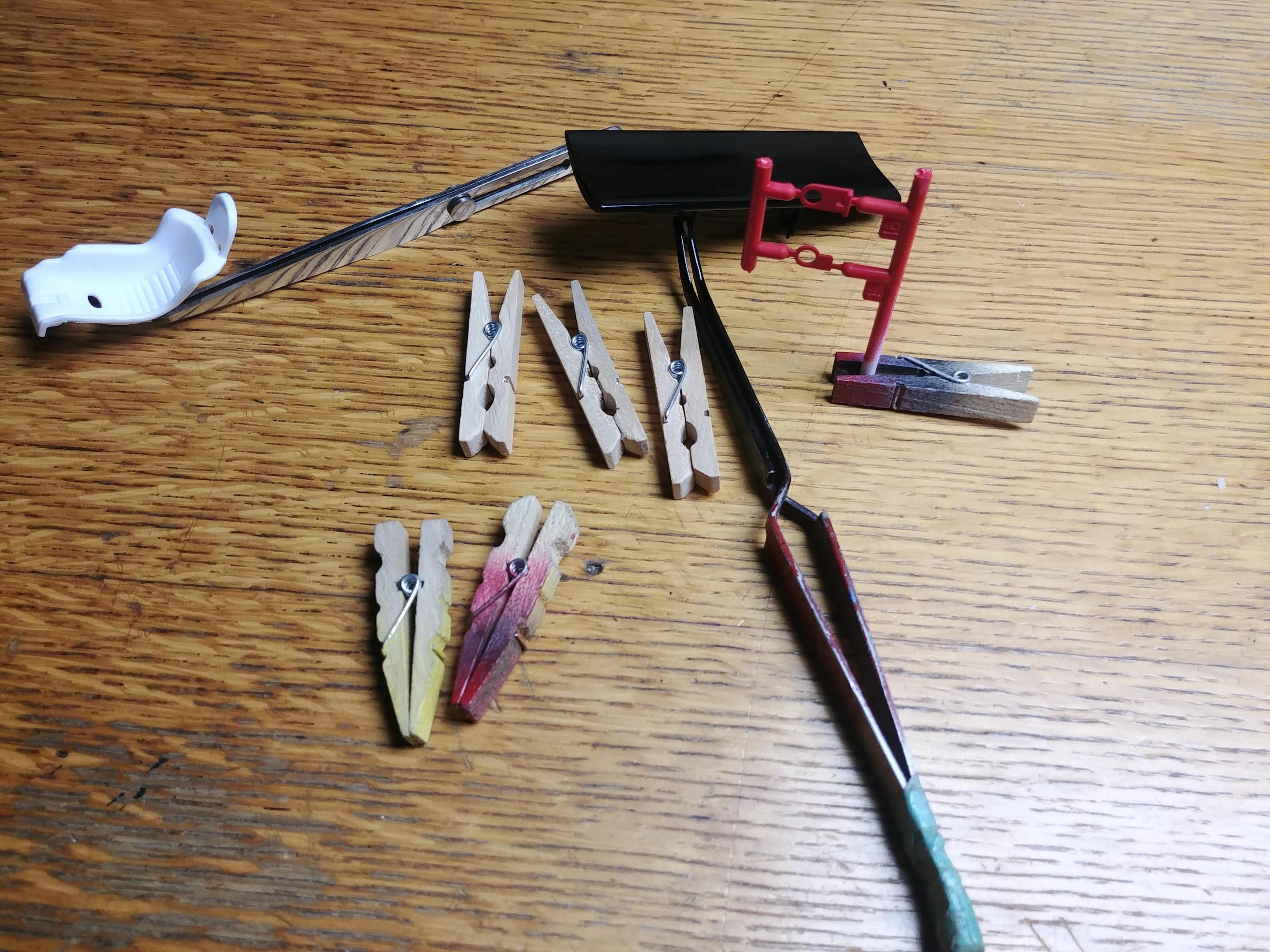

89AKurt Posted December 14, 2020 Posted December 14, 2020 I use wood clothes pins, hemostats, different tweezers that can either spring load or lock, and on rare occasions a little Erwin quick-grip. I'm tempted to get the little wood clothes pins at Hobby Lobby.
CabDriver Posted December 14, 2020 Posted December 14, 2020 14 hours ago, 89AKurt said: I'm tempted to get the little wood clothes pins at Hobby Lobby. I use those a lot - and if you have one of the rotating Tamiya paint stands, they fit in the slots on there perfectly to hold the parts

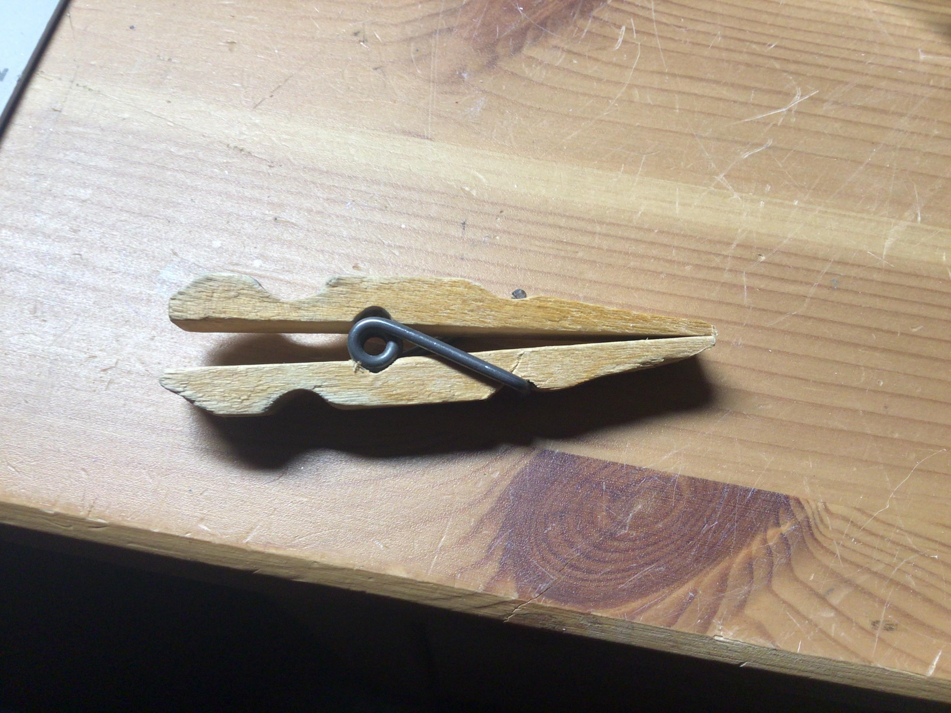

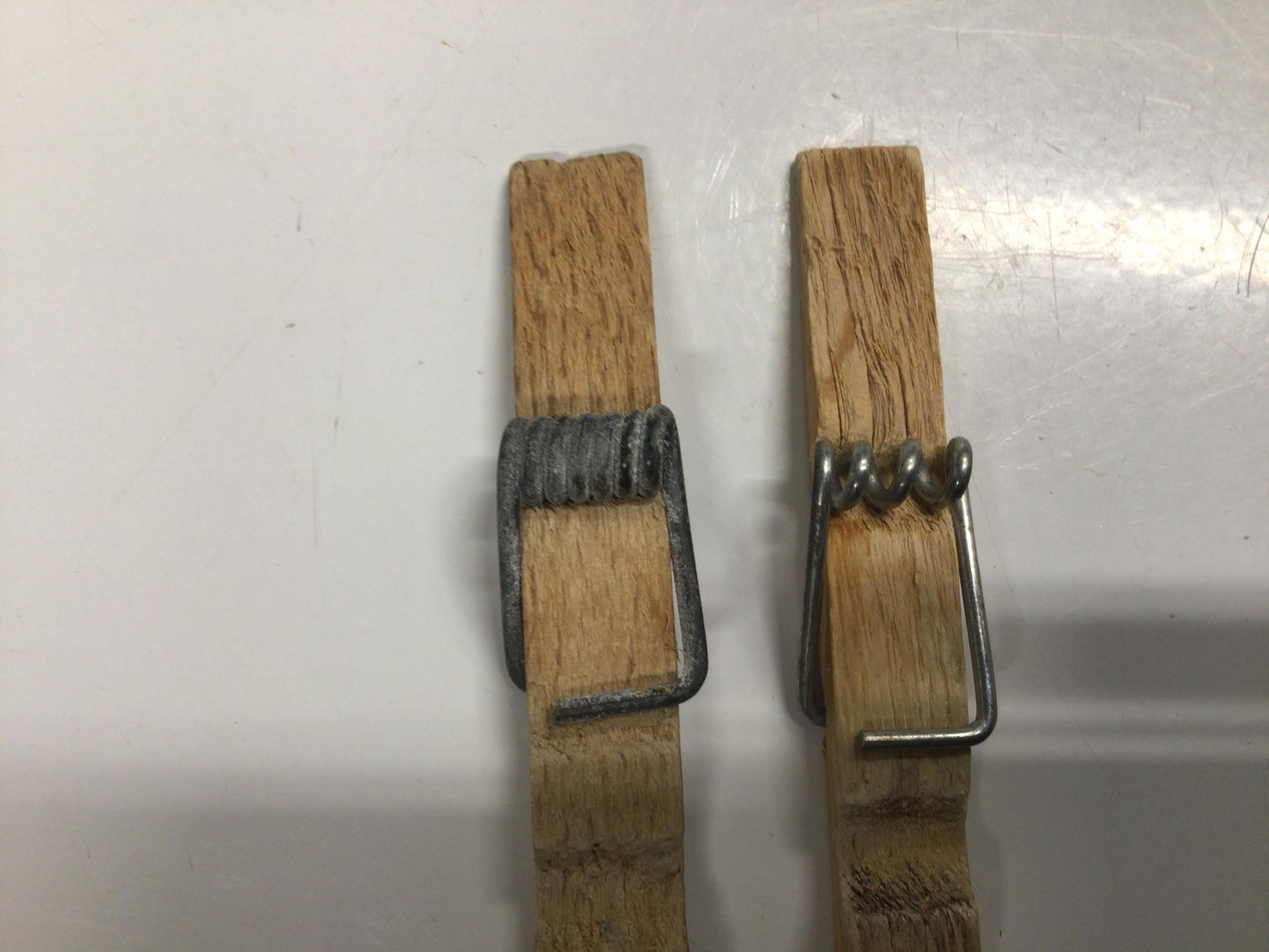

Belugawrx Posted December 14, 2020 Posted December 14, 2020 (edited) Yes to all of the above...have you guys flipped the jaws / springs on the clothes pins? I find they can get in a little tighter to the object ... the bottom, left pegs have been reversed Edited December 15, 2020 by Belugawrx
peteski Posted December 14, 2020 Posted December 14, 2020 (edited) I also made those reverse clothespin clamps (using regular and miniature clothespins). I have learned of this technique years ago in some modeling magazine (I think it was FineScale Modeler) - the magazine most members here love to hate. Edited December 14, 2020 by peteski
NOBLNG Posted December 14, 2020 Author Posted December 14, 2020 (edited) 5 hours ago, Belugawrx said: Yes to all of the above...have you guys flipped the jaws on the clothes pins? Now THAT is a good trick! The jaws can also be carved to suit tight spots. Thanks! Edit: All clothes pins are not equal either. Edited December 14, 2020 by NOBLNG
peteski Posted December 15, 2020 Posted December 15, 2020 5 hours ago, NOBLNG said: Now THAT is a good trick! The jaws can also be carved to suit tight spots. Thanks! Edit: All clothes pins are not equal either. Very true! Also, when I reverse them I take rat-tail file and enlarge and round off the new "nest" for the spring.That makes the clamp's jaws more stable.
NOBLNG Posted December 15, 2020 Author Posted December 15, 2020 (edited) 2 hours ago, Belugawrx said: I learned that one right here at MCM ? Thanks to whoever discovered the trick and thank you for passing it along. 1 hour ago, peteski said: Very true! Also, when I reverse them I take rat-tail file and enlarge and round off the new "nest" for the spring.That makes the clamp's jaws more stable. Exactly what I did. And filed the tips flush. One leg could even be cut shorter for special applications if needed. Edited December 15, 2020 by NOBLNG 1

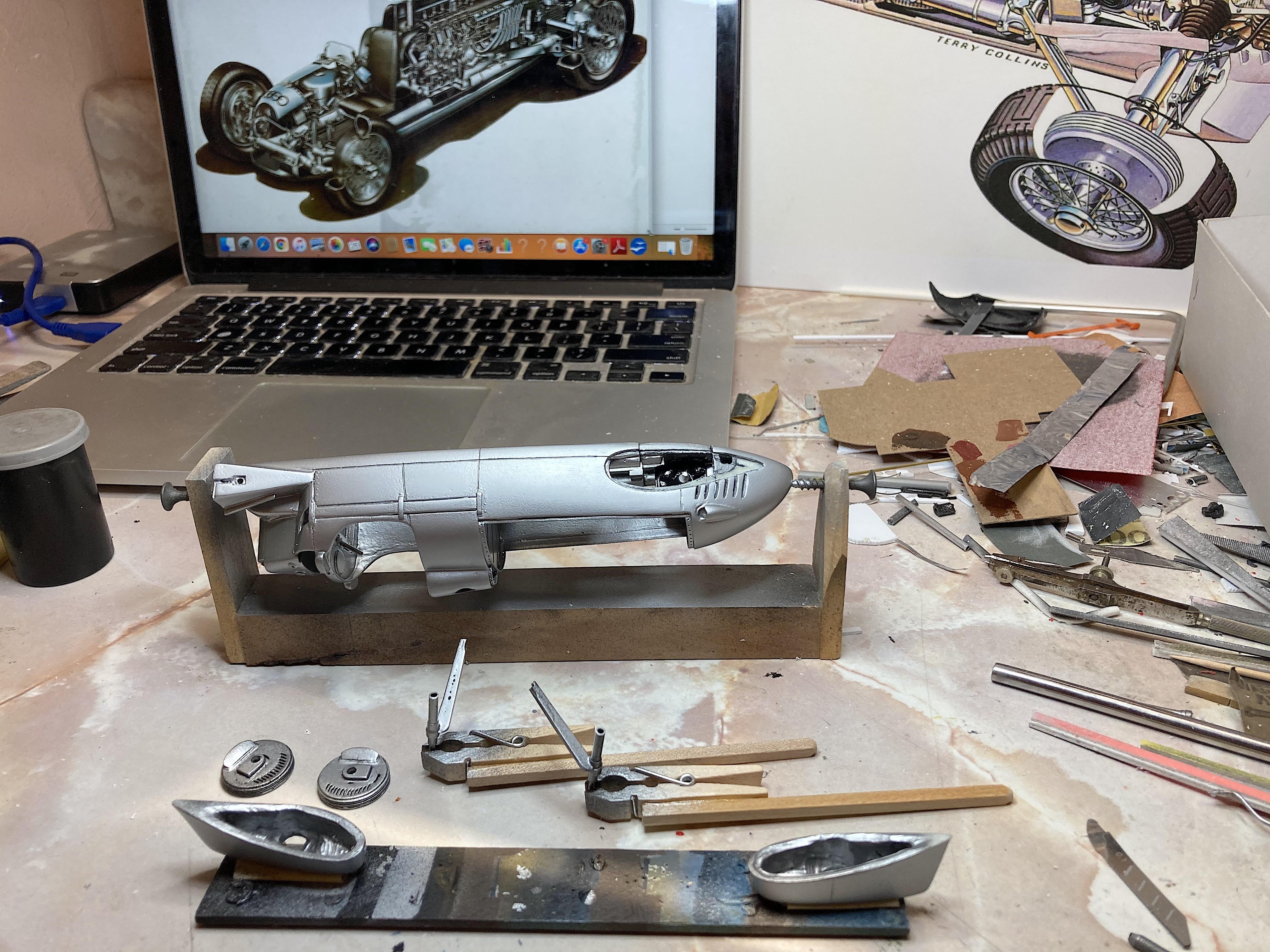

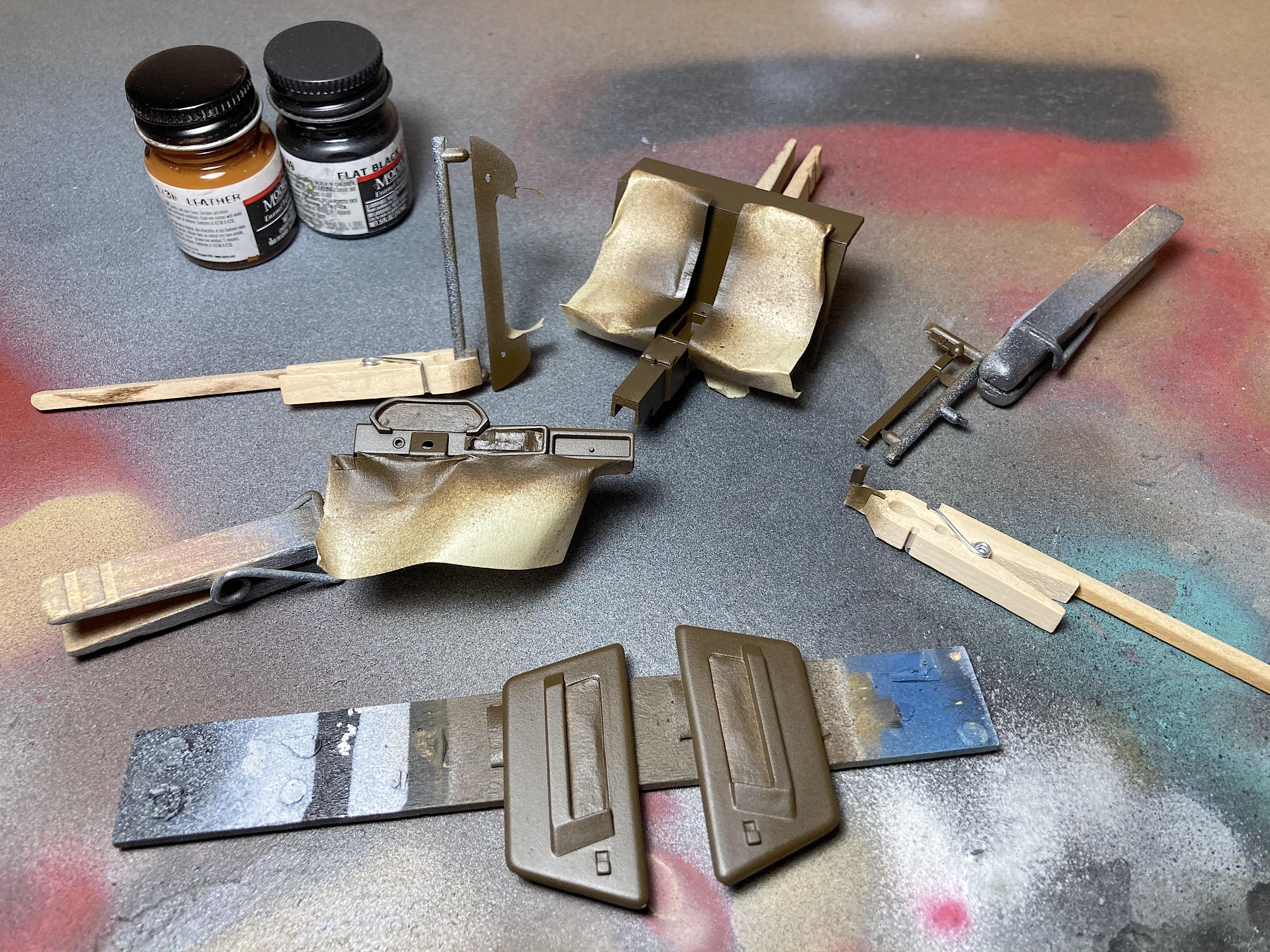

89AKurt Posted December 27, 2020 Posted December 27, 2020 I got these little wood clothes pins at Hobby Lobby. Glued on sticks to make them longer, and removed the tips using a disk sander. I use full scale clothes pins to stabilize for painting. Reversed some, but haven't used yet. 1

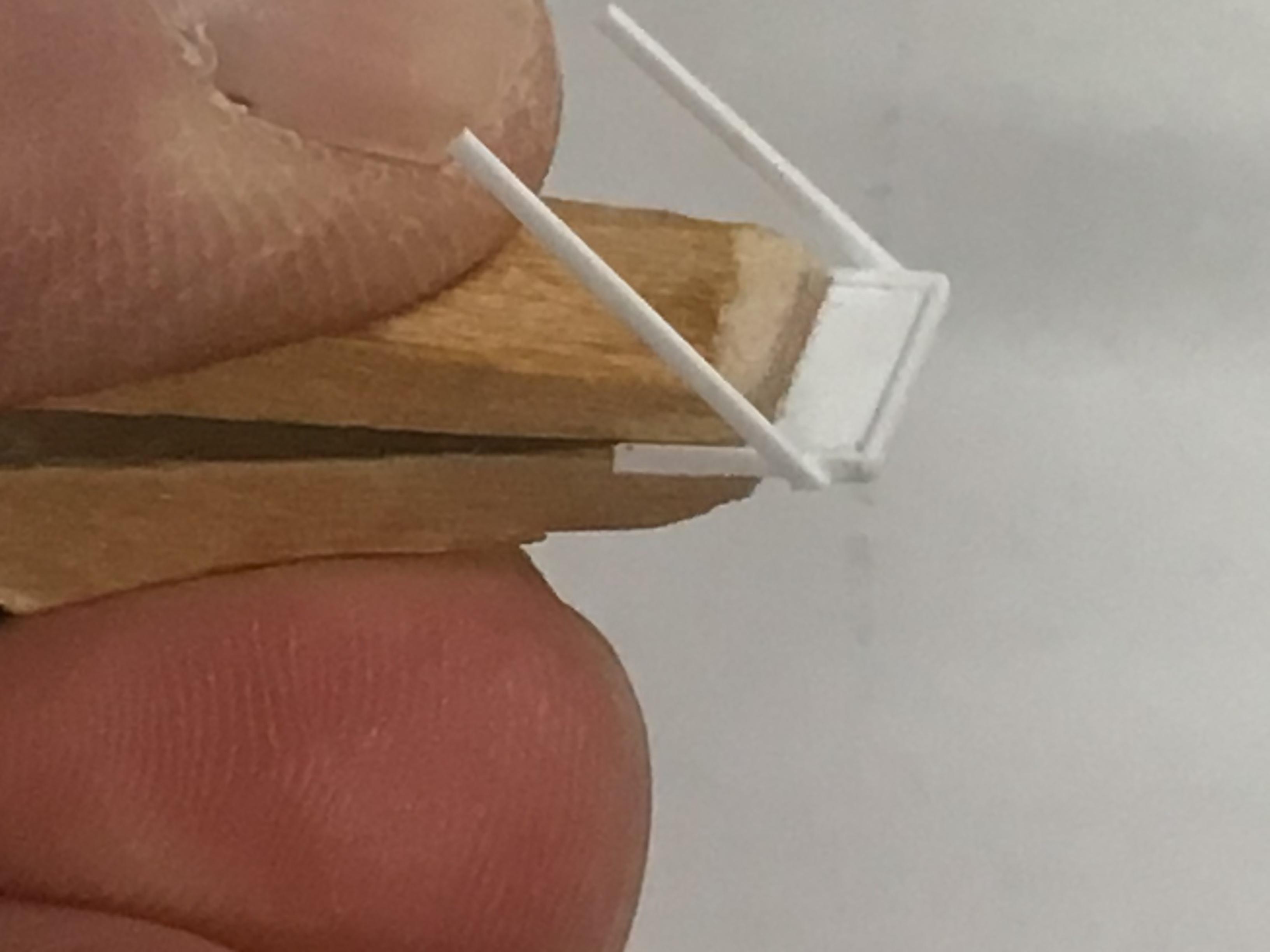

NOBLNG Posted January 1, 2021 Author Posted January 1, 2021 I modified these a bit with some sandpaper glued to the tips. They’ve got a better grip now for holding tiny parts when sanding or filing to shape. 1

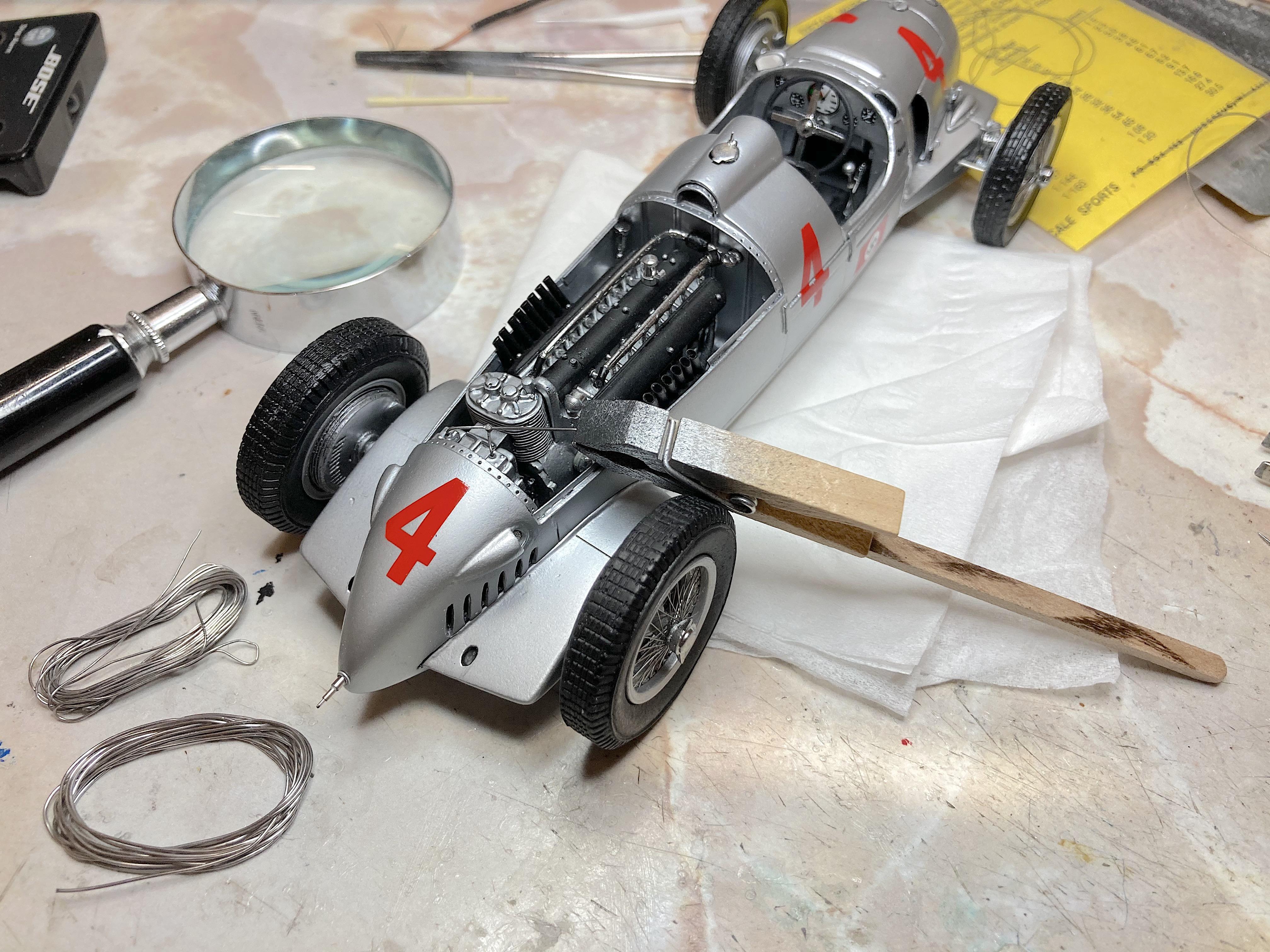

89AKurt Posted January 2, 2021 Posted January 2, 2021 Another time I used the mini clothes pin. Any of the other clamps I have would crushed the solder wire held in place. 1

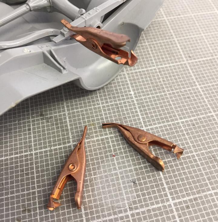

GarryR Posted January 4, 2021 Posted January 4, 2021 These toothless alligator clips are very small; made of copper so the tips are malleable. 1
peteski Posted January 5, 2021 Posted January 5, 2021 Those are likely copper plated soft steel (at least the ones I have are), but regardless, they are useful. 1
