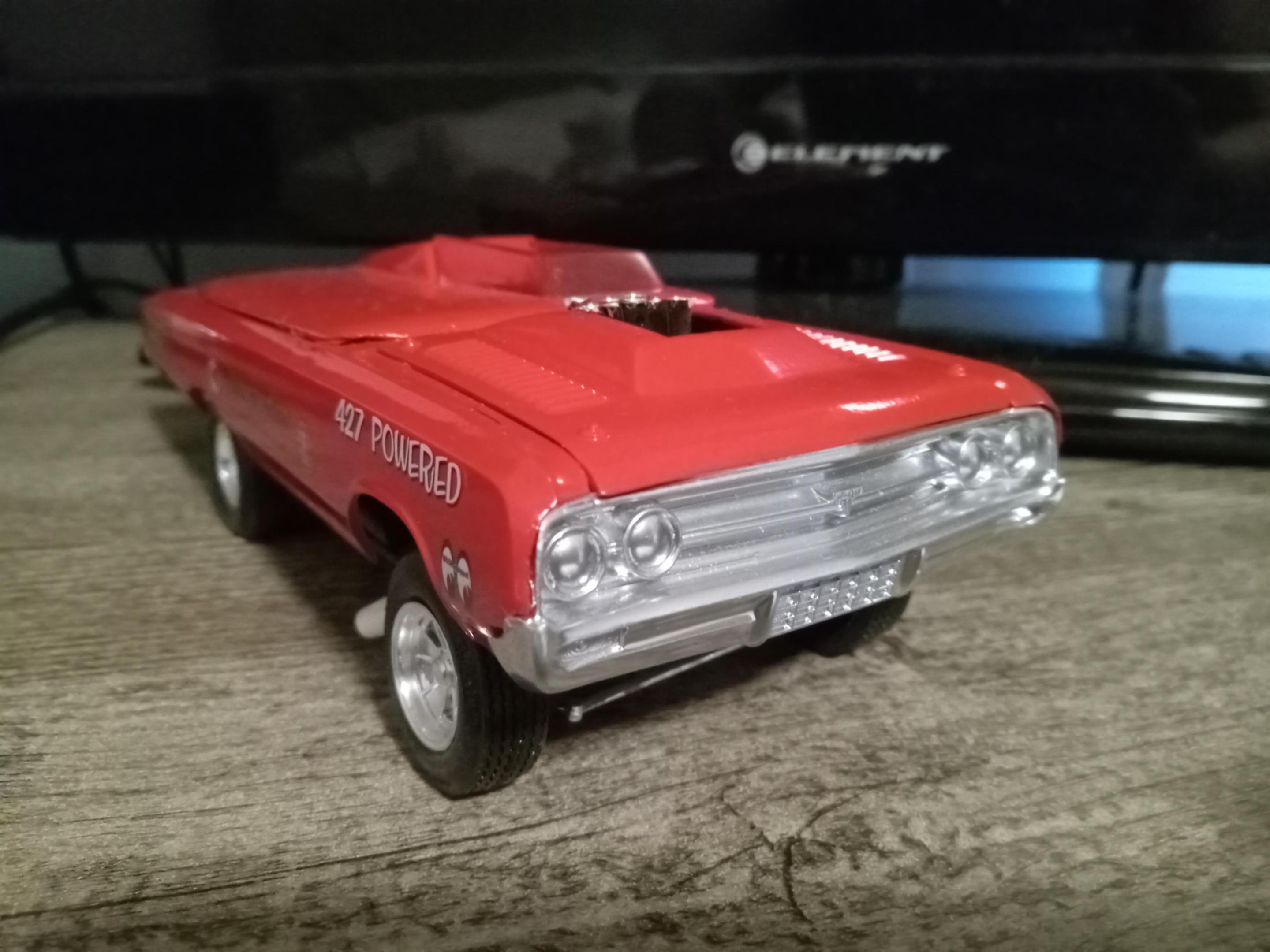

M W Elky Posted April 4, 2023 Posted April 4, 2023 12 hours ago, Scott8950 said: Don't think I've posted this yet.  Scott it looks great did you build this from the original kit or did you modify the new issue convertible kit? 1
Scott8950 Posted April 4, 2023 Posted April 4, 2023 3 hours ago, M W Elky said: Scott it looks great did you build this from the original kit or did you modify the new issue convertible kit? It's the original kit, I got it as a complete rebuilder. 1

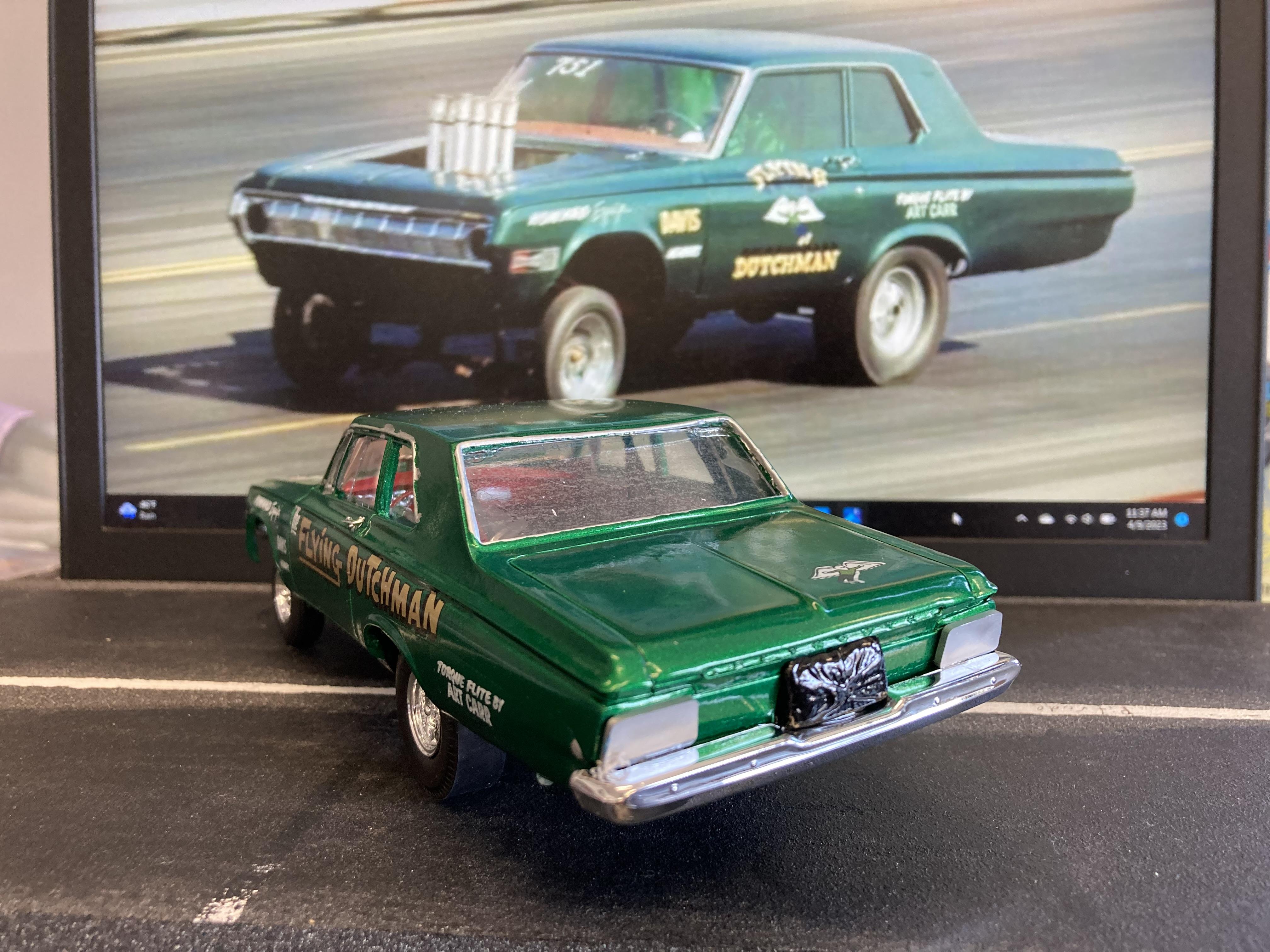

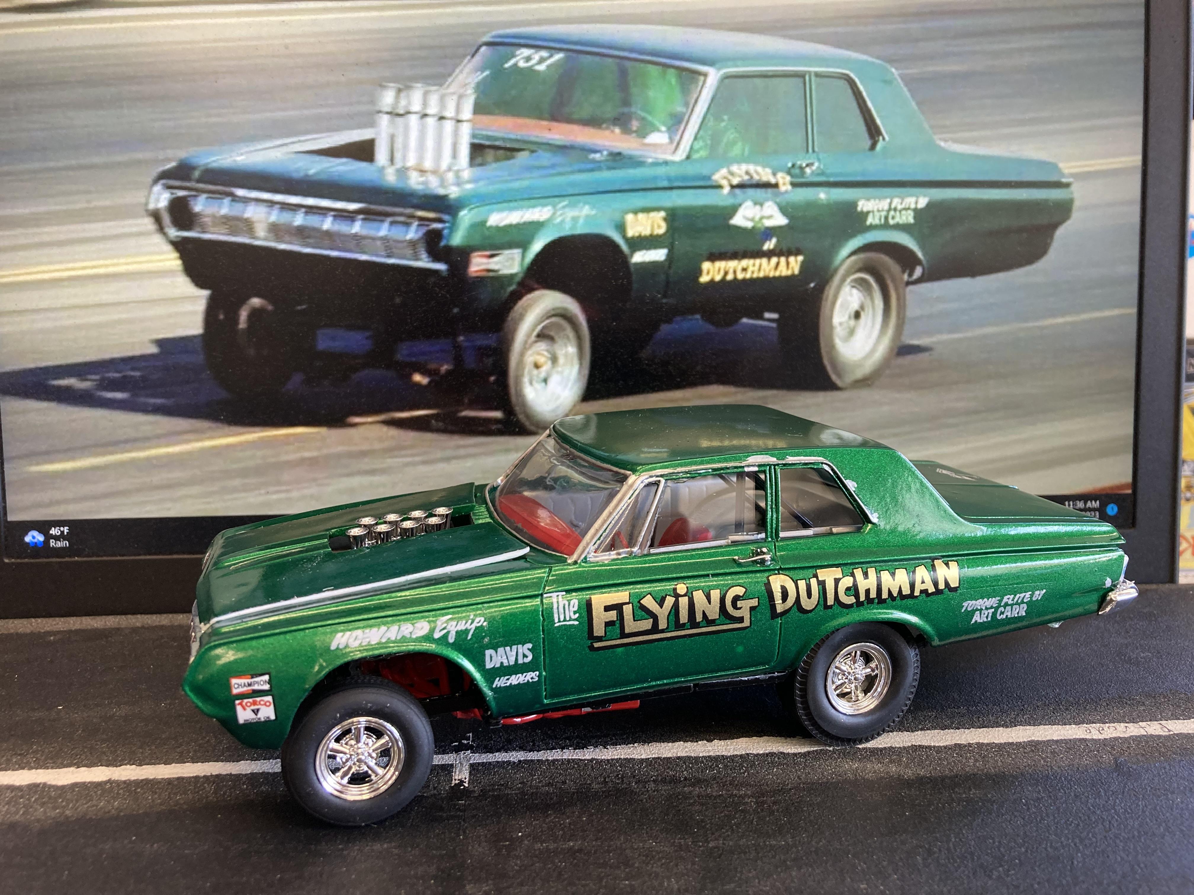

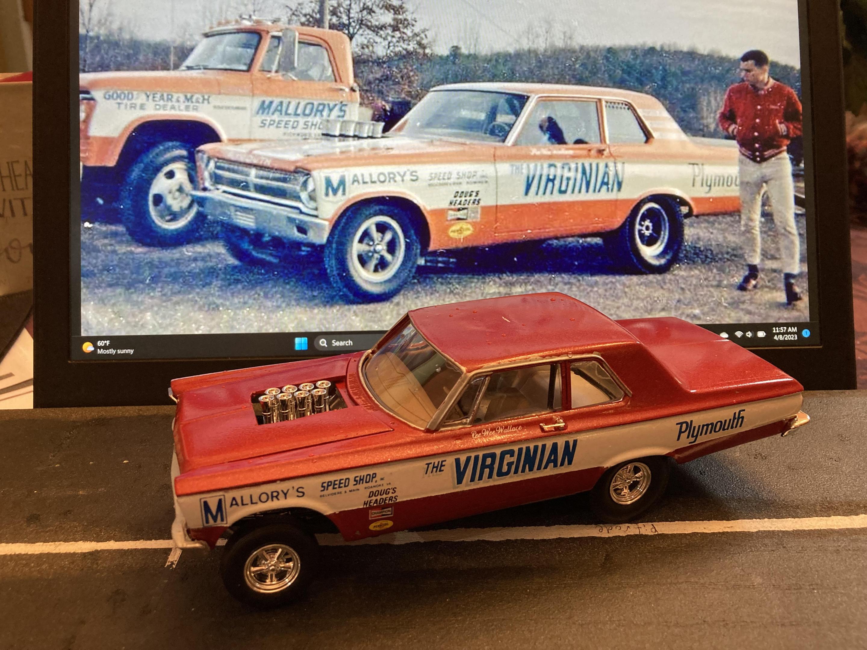

Altered Ego Posted April 8, 2023 Author Posted April 8, 2023 It's been awhile, but here is my latest build. This is a total copy of Swinger 340's Virginian build. Used the same Fremont Racing body and the same Moebius chassis, engine, etc. After messing up the first set of Fred Cady decals, I painted my stripes and ordered another set of decals. The only chassis modification I encountered was having to narrow the chassis behind the rear wheel wells. The resin body appears thicker in this area. The Fremont Racing body is by far the best resin body I have ever used. This was also my first attempt at building my own windows and was surprisingly easy. 2

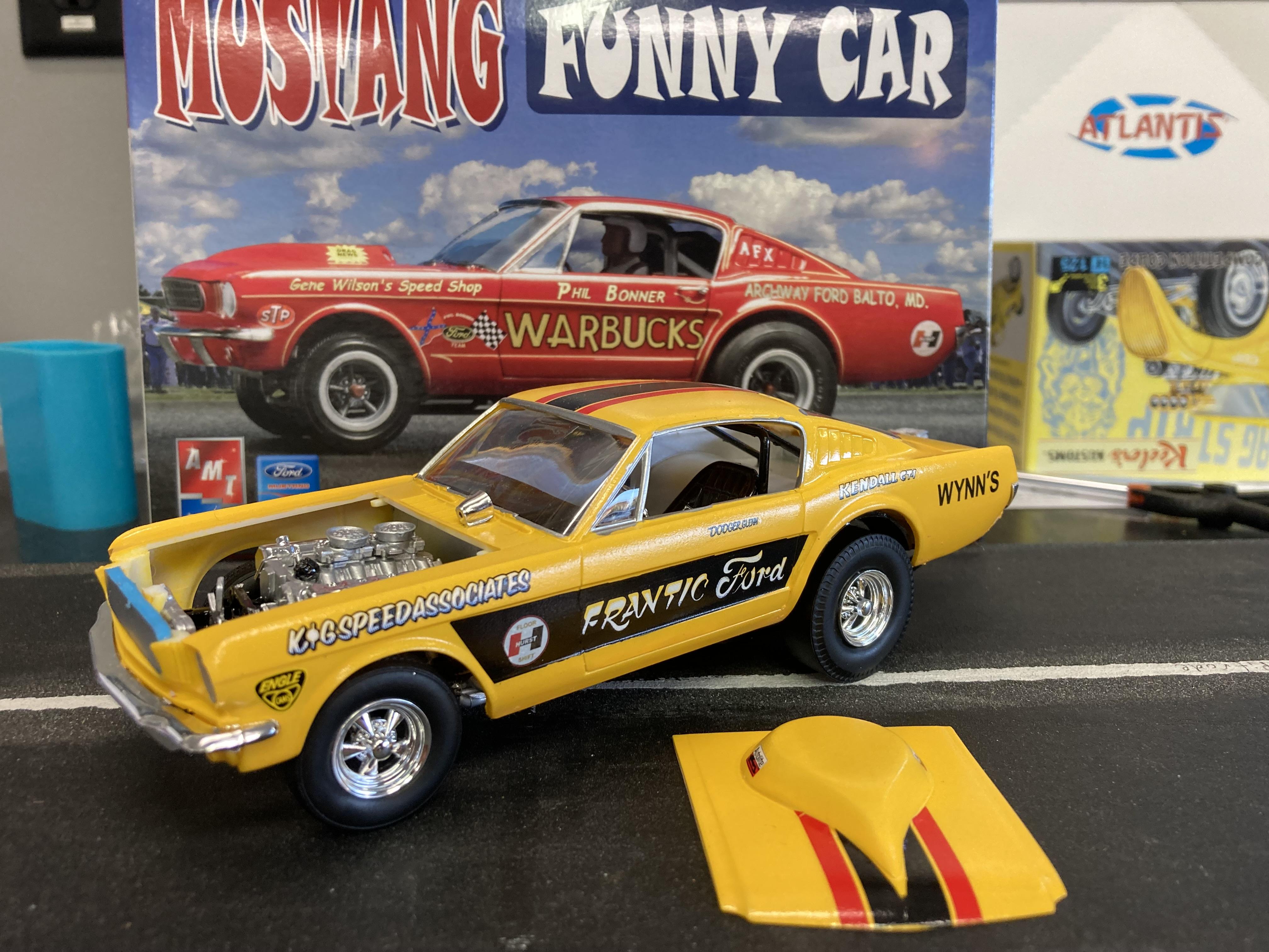

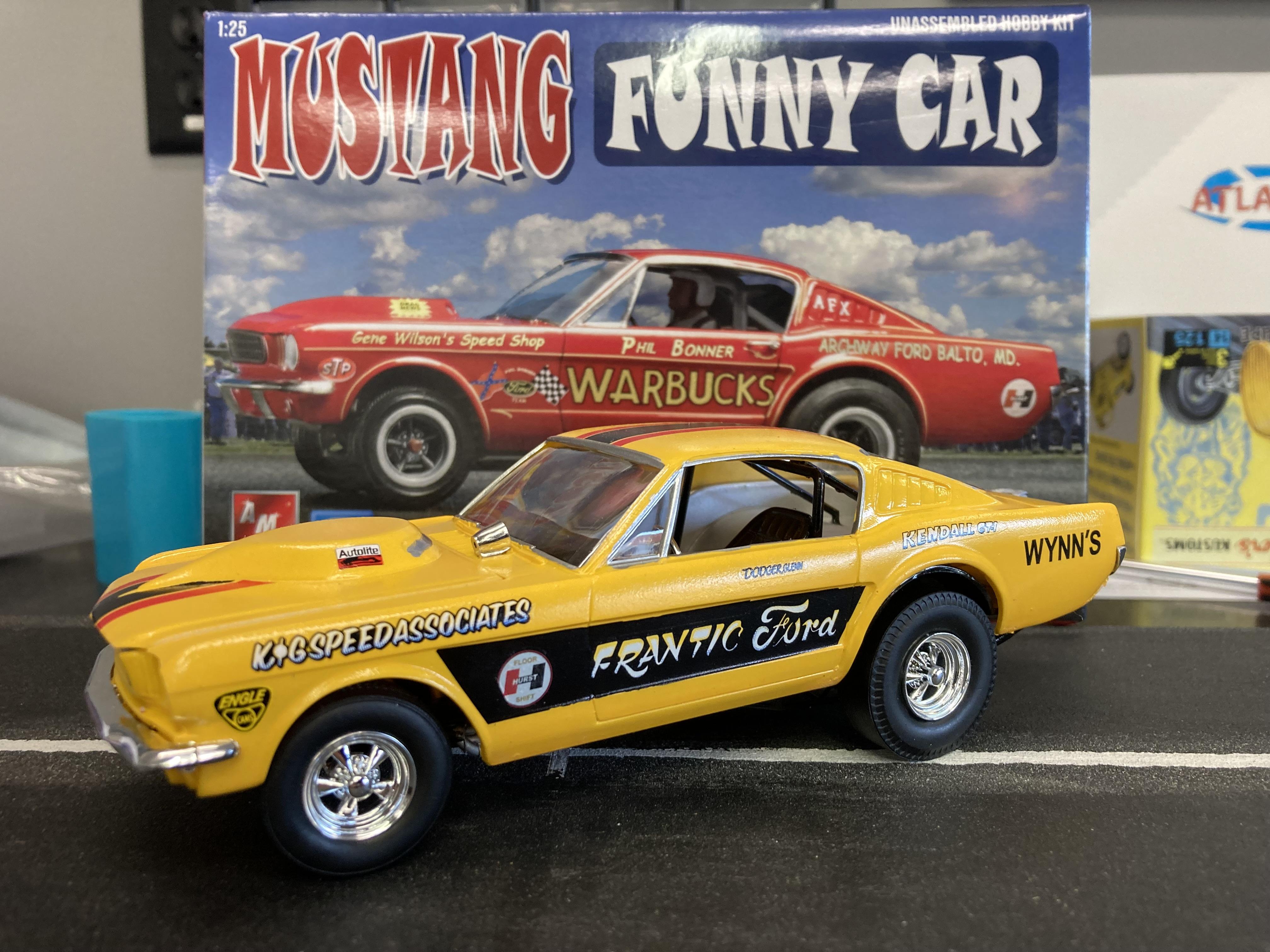

Altered Ego Posted April 19, 2023 Author Posted April 19, 2023 This is the third in my recent "binge build". This car was really a parts bin special, so I will give the best details I can. I started with the Model King Warbucks Mustang and painted the body Testors Extreme Lacquer yellow and used Slixx Frantic Ford decals. The chassis is the AMT 1967 Shelby GT-350 piece and fit very well with the Model King interior tub. I cut out the trans tunnel and torque boxes to fit the interior tub. The 427 Cammer is a leftover Moebius Comet piece mounted 8" back from stock. Everything else was just pieced together from leftover kit parts. The concept is a match race version of the Ford A/FX Mustangs. This meant the rear axle was moved forward 8" instead of 3" on the A/FX car. The front axle is from the Cosmic Charger dragster mounted with leftover leaf springs, replacing the A/FX Mustang's cumbersome torson leaf setup. 4

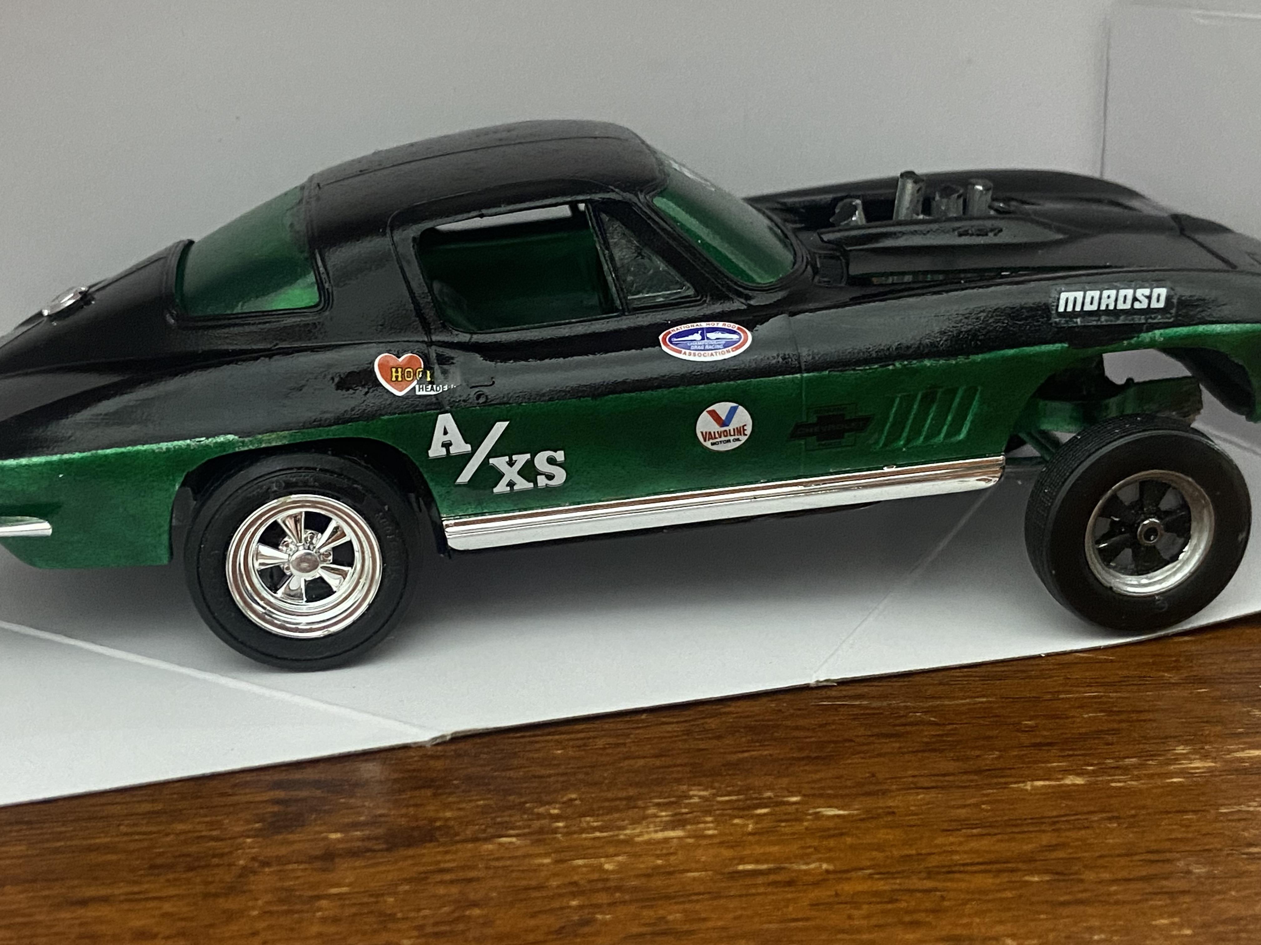

Brockc Posted November 19, 2023 Posted November 19, 2023 On 8/12/2023 at 10:52 PM, Altered Ego said: Did you post it? I would love to see it. I am thinking of doing another as the Blue Hell Corvette.  Here it is 2

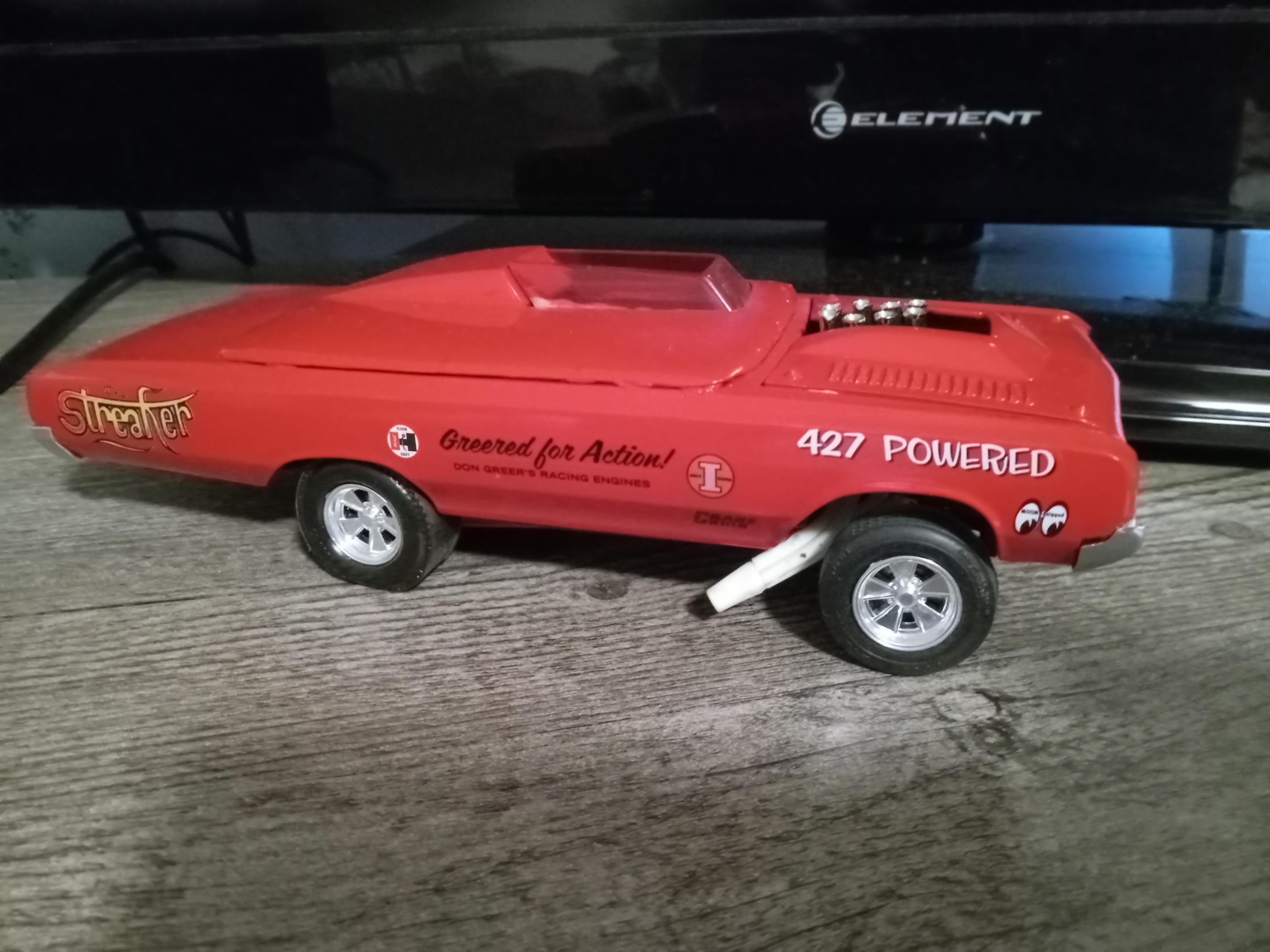

MeatMan Posted November 20, 2023 Posted November 20, 2023 (edited) My only altered. Did a build thread on this a couple of years ago. Edited November 20, 2023 by MeatMan 6

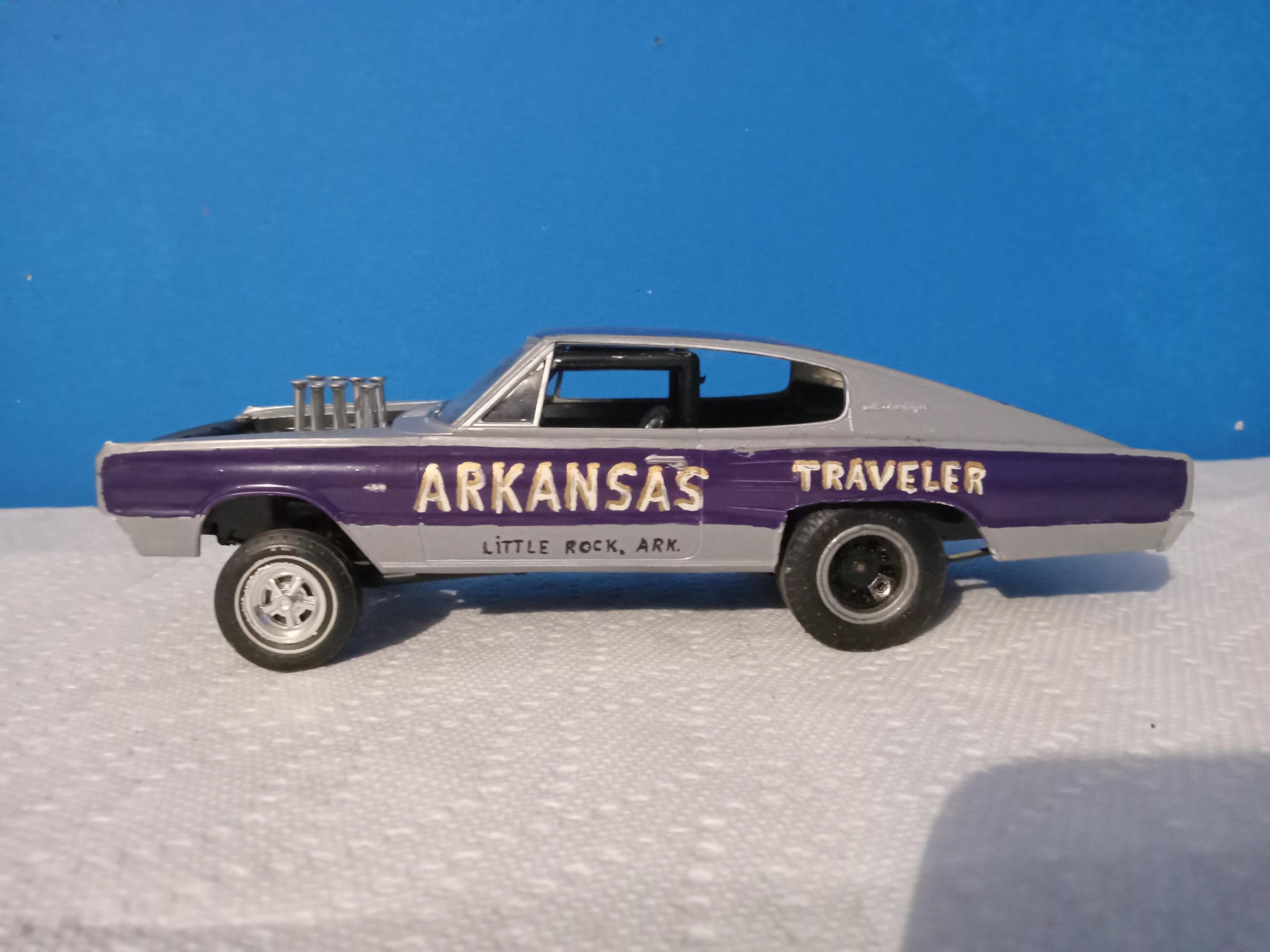

Scott8950 Posted December 4, 2023 Posted December 4, 2023 Here's a few more, the charger is a screw bottom i got in a trade. 5
