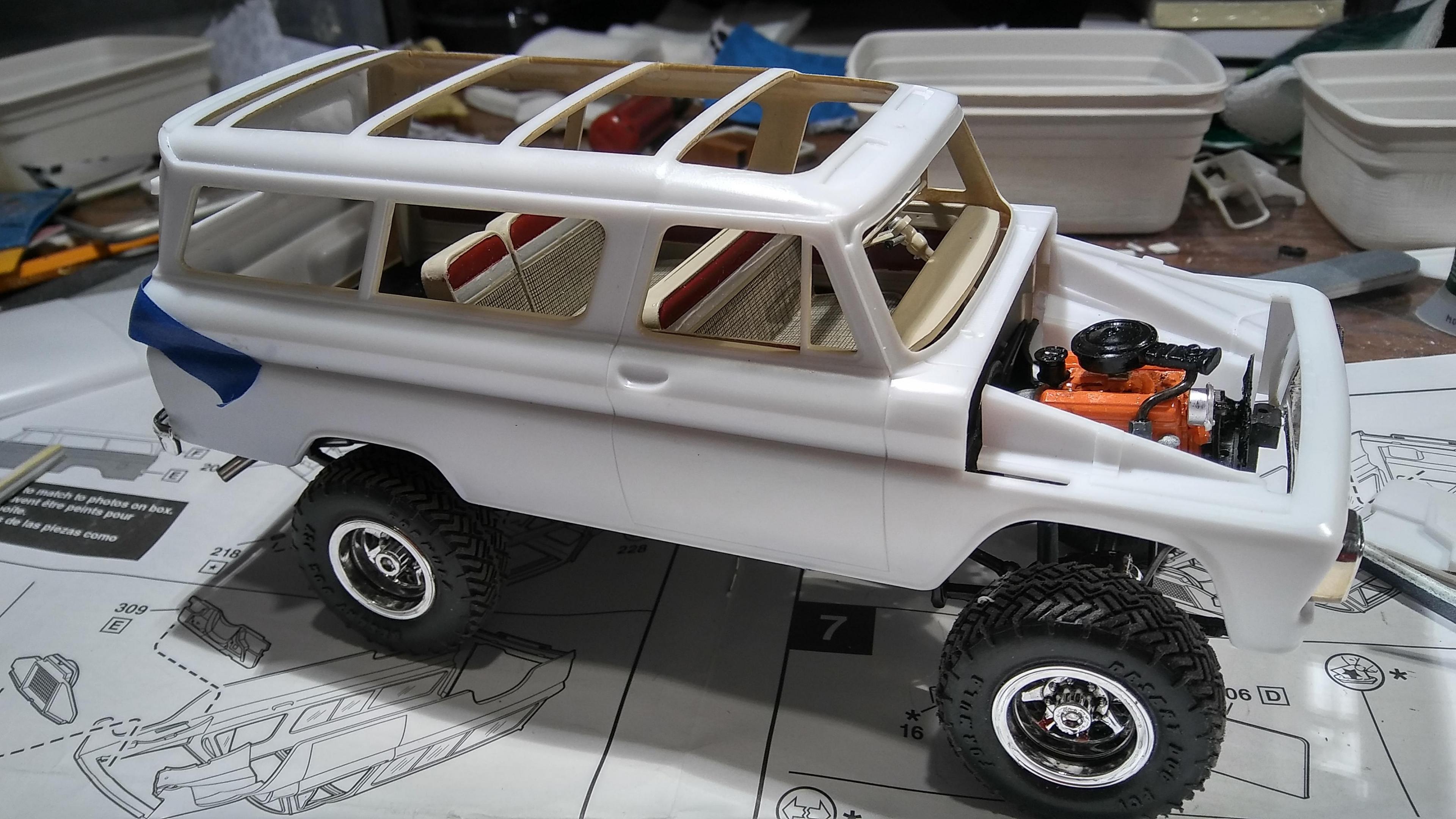

mikemodeler Posted January 15, 2021 Share Posted January 15, 2021 The easiest way is to use the 84 GMC pickup kit Deserter as the chassis donor. Here's a picture of a Burban sitting on the chassis, sorry for the bad lighting, but the wheel base matches up. The beauty of the donor kit is that you can build it stock height with regular tires and wheels or you can jack it up and use the big wheels and tires from the kit. Quote Link to comment Share on other sites More sharing options...

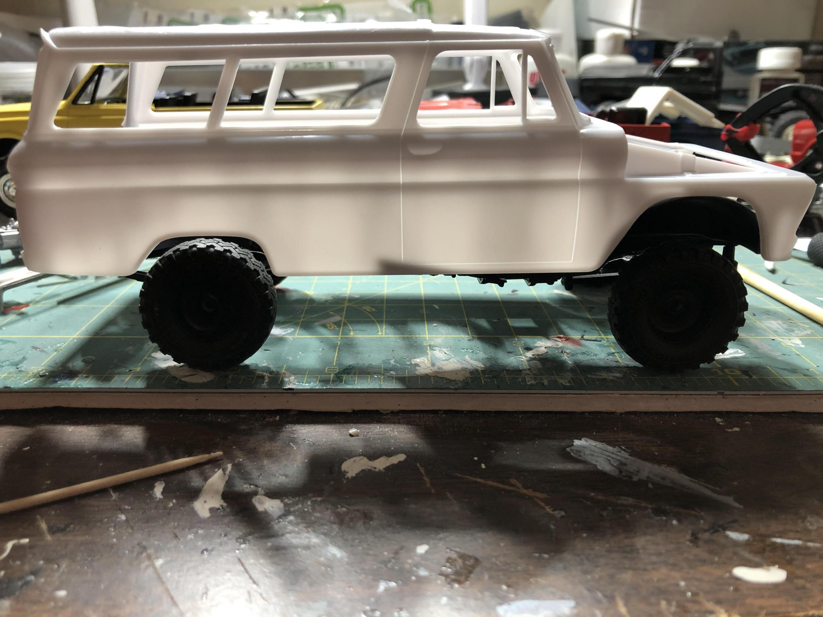

Chuckyg1 Posted January 15, 2021 Share Posted January 15, 2021 I'm doing exactly what mikemodeler recommends right now. It's an easy bash, just some minor tweaking is required. Here's a pick of where I'm at in the build. Quote Link to comment Share on other sites More sharing options...
64SS350 Posted January 15, 2021 Share Posted January 15, 2021 21 minutes ago, Chuckyg1 said: I'm doing exactly what mikemodeler recommends right now. It's an easy bash, just some minor tweaking is required. Here's a pick of where I'm at in the build. I like this look, good to know on the easy fit from the deserter. Quote Link to comment Share on other sites More sharing options...

Chuckyg1 Posted January 15, 2021 Share Posted January 15, 2021 Avidinha posted a great build using the deserter chassis back on February 17. Check it out. it's where I got my inspiration. search for 66 suburban in under glass. Quote Link to comment Share on other sites More sharing options...
