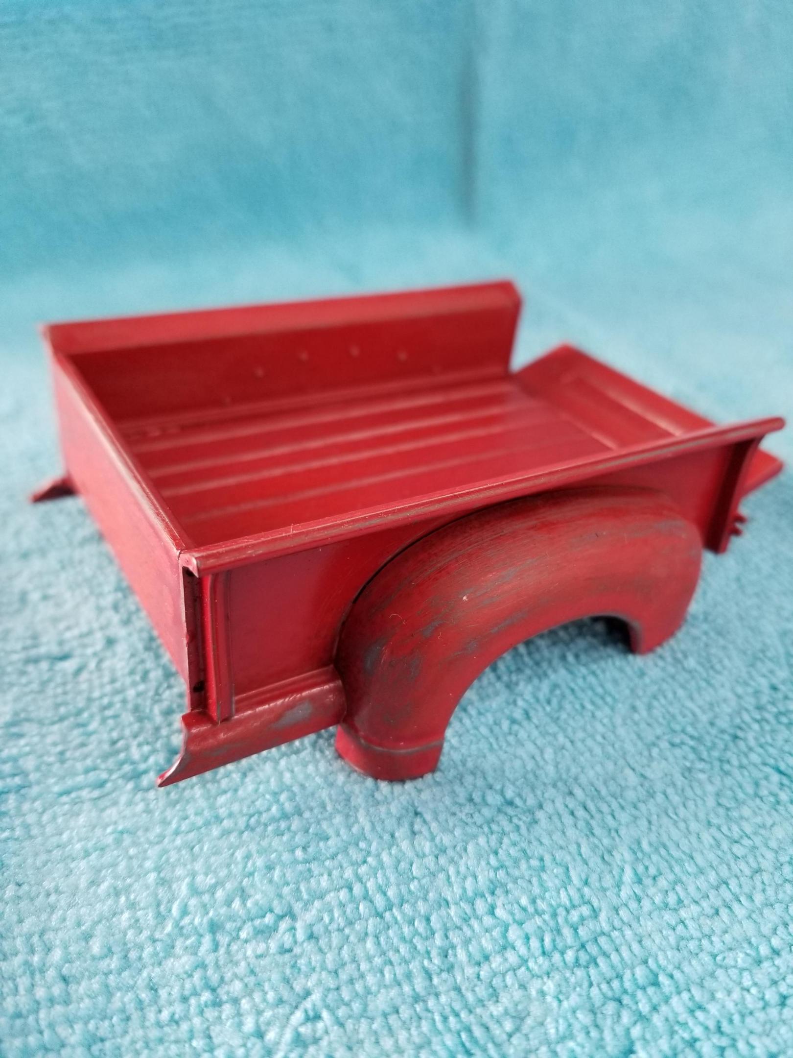

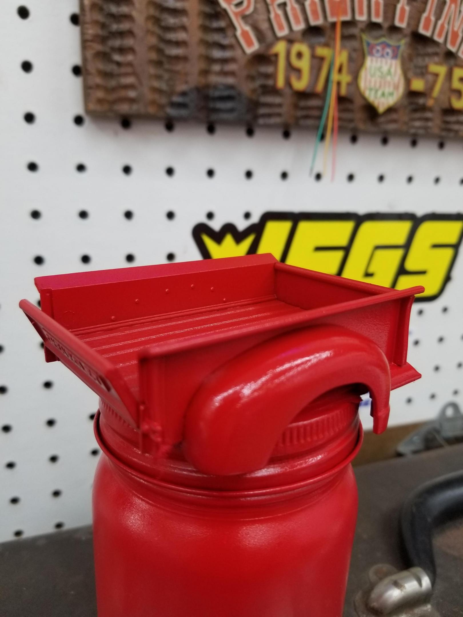

Zippi Posted March 5, 2021 Author Share Posted March 5, 2021 I was afraid that using any chemicals would soften the glue so I decided to just sand it down. It's now a heck of a lot better. Looks like a lot of orange peel so not sure to just leave it or not. Quote Link to comment Share on other sites More sharing options...

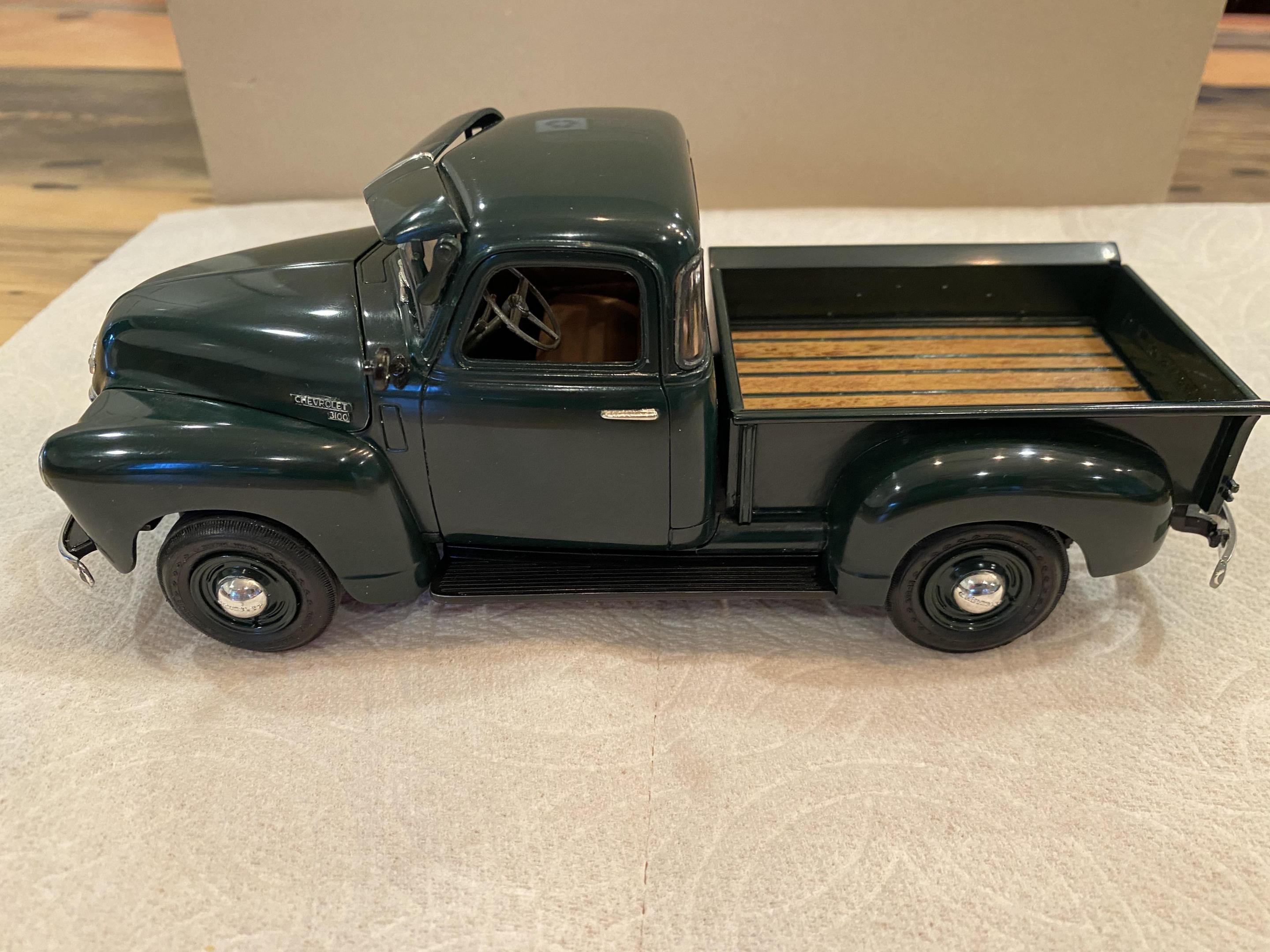

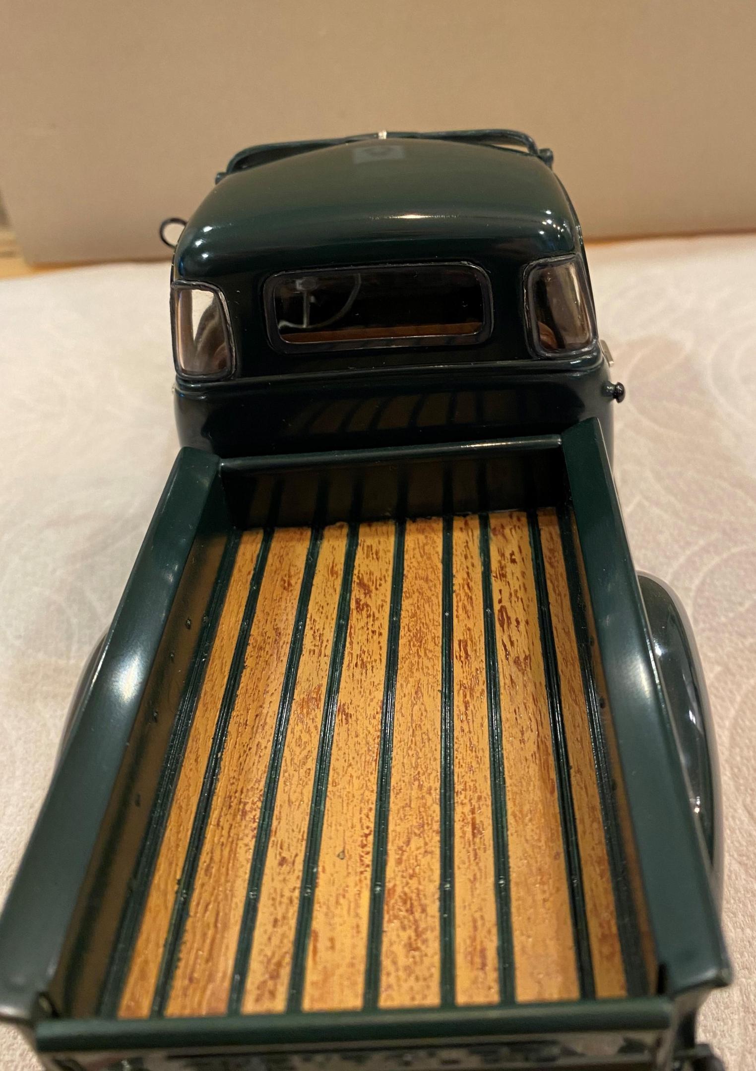

Kromolly Posted March 5, 2021 Share Posted March 5, 2021 I find rattle cans very tough to use for a quality paint job on a body. After changing over to an air brush I was amazed at the difference. In an earlier post you mentioned the bed slats. On my '50 Chevy PU that I built (pic below), I painted the wood and then masked the bed & cut the masking away from the slats and shot body color. You could do the same with chrome paint, or use bare metal foil on the slats. Quote Link to comment Share on other sites More sharing options...

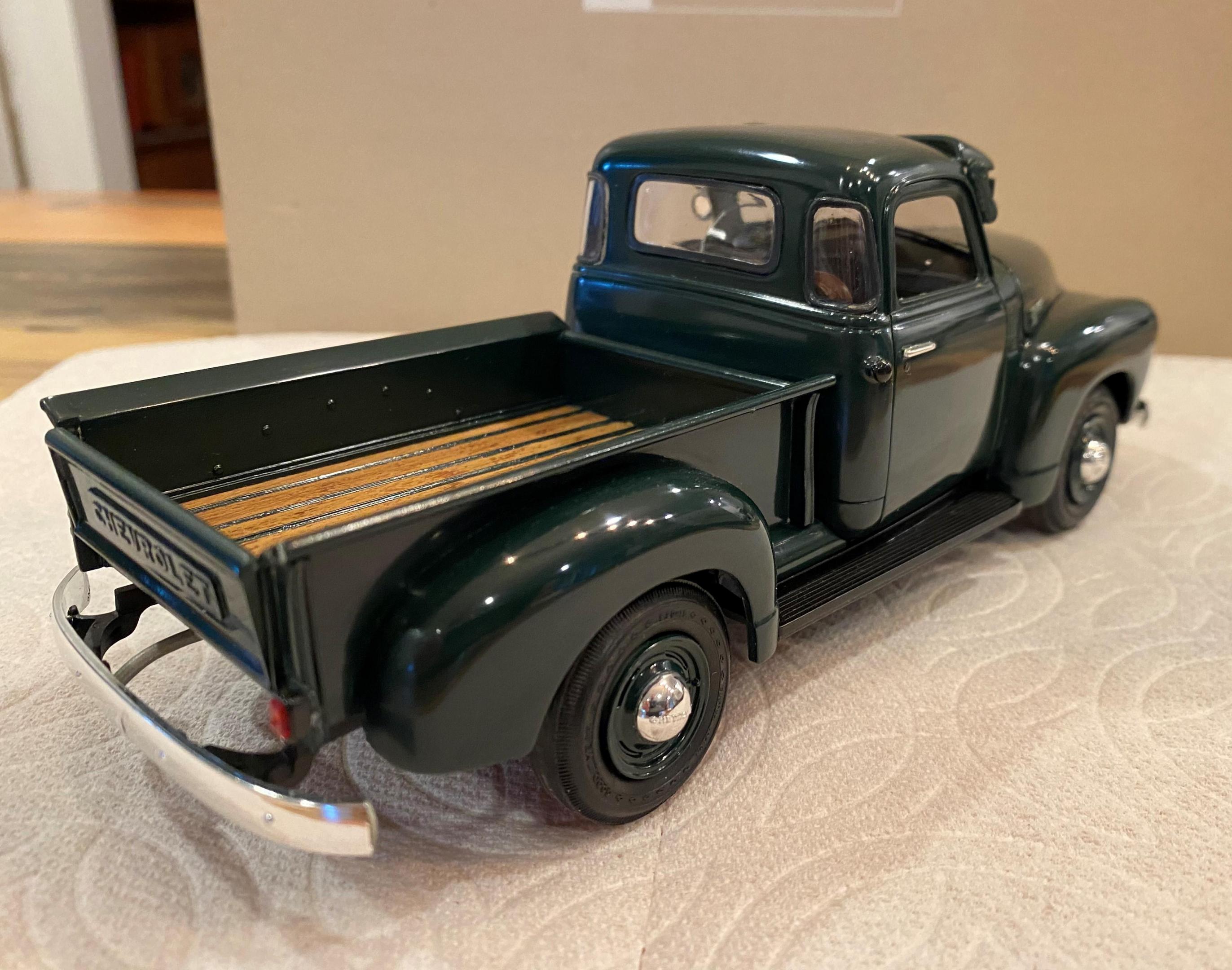

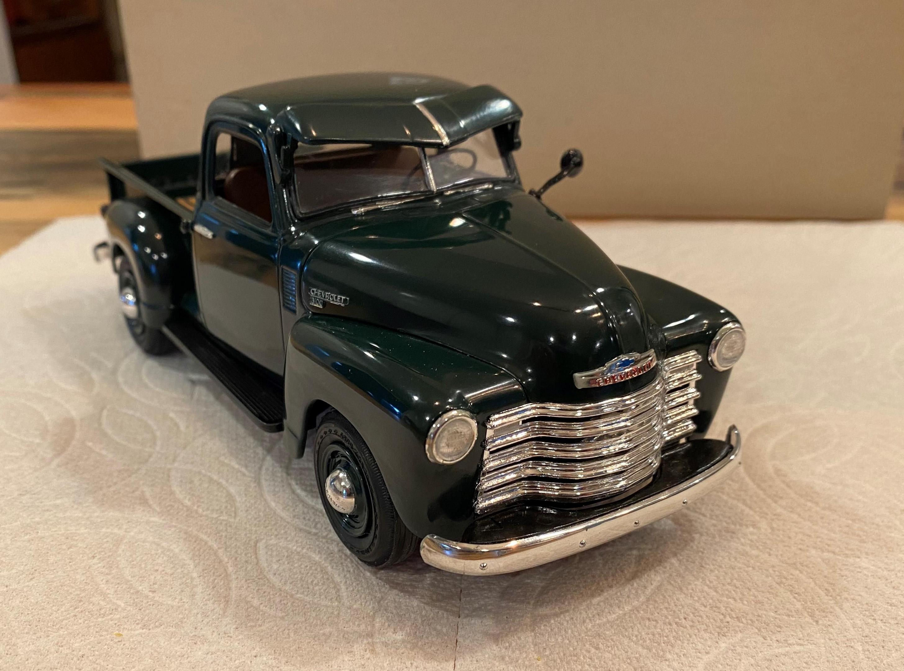

Kromolly Posted March 6, 2021 Share Posted March 6, 2021 Here are a few more shots of my truck. I built this about 25 years ago. The paint is Testors Model Master enamel, air brushed and polished. My biggest challenge has always been dust. I can lay down a glossy paint with the air brush, but inevitably something will float into the paint and I need to polish it out. I've started covering the model immediately with a plastic tub and I think that might help. My spray booth (homemade) is inside the house. I can spray with rattle cans (I use them for primer and engine, chassis parts etc. where I'm not looking for such a smooth, glossy finish) and my wife can't even smell it across the room. I posted my homemade paint booth in the "How To" or FAQ section... I'm not sure how to go find that link while I am writing a post. Quote Link to comment Share on other sites More sharing options...
