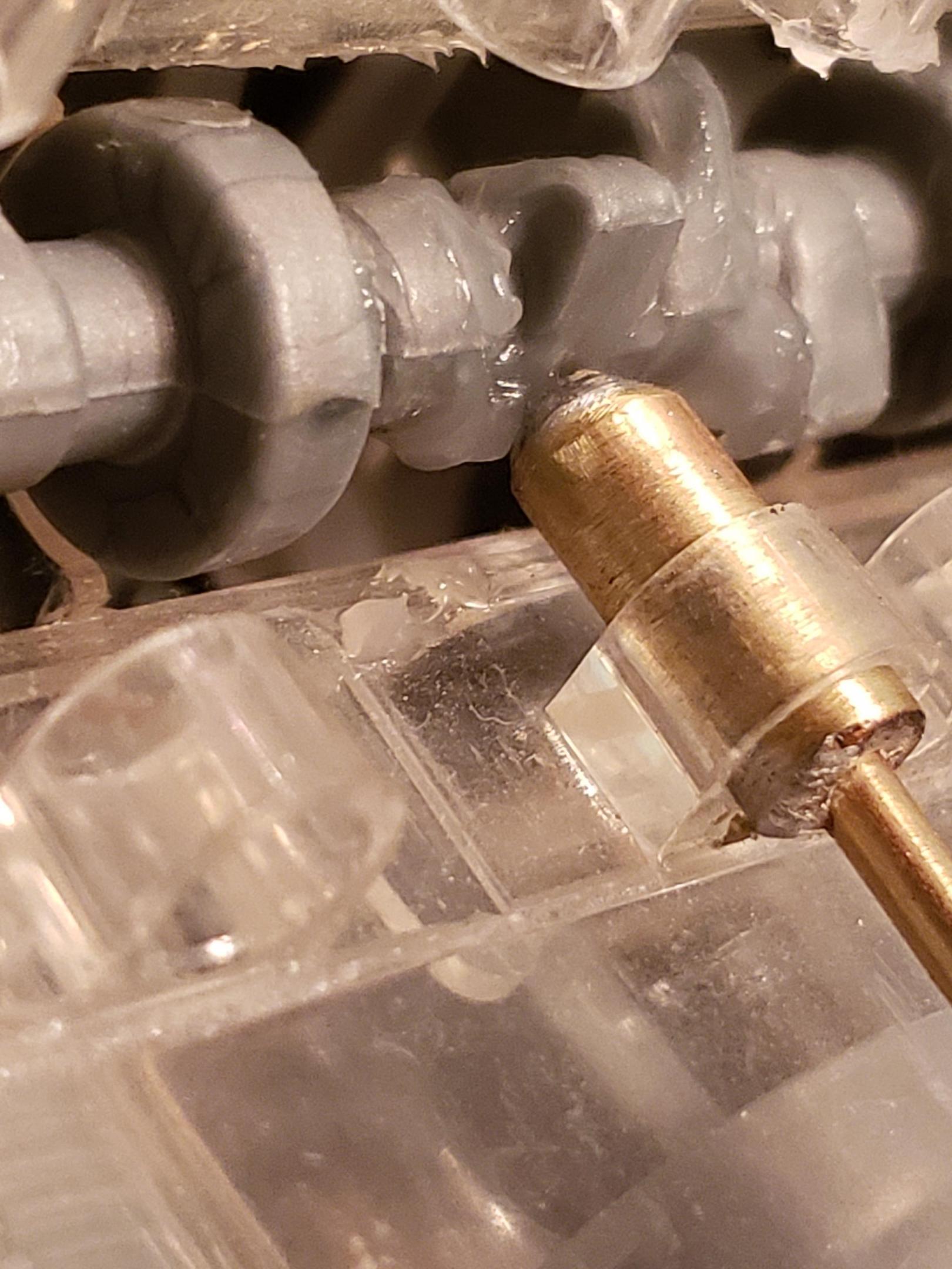

johnfin Posted April 24, 2021 Posted April 24, 2021 Any tricks to making this kit actually work? Seems like the valve springs are too stiff causing the lifters to jamb up at the cam. I have the newer non-motorized crank version. Anyone make parts to convert to motorized version with lights.

johnfin Posted April 25, 2021 Author Posted April 25, 2021 no way to lube. Thats not the problem. Too much force on lifters. Pushes them past the lobe on the lifter and causes them to jamb up.

johnfin Posted May 2, 2021 Author Posted May 2, 2021 Even with the better fitting lifters, there are no cam bearings so the cam flops around and jambs the lifters.

johnfin Posted May 6, 2021 Author Posted May 6, 2021 Its a geometry issue. The flat side of the cam comes around and wedges the lifter. Doesnt matter how much goop is on the cam.
Wolfangel Posted May 7, 2021 Posted May 7, 2021 They one thing I did on mine...and it helped a lot. And this depends on if you can get it back out. Is sand the mold seams off of every cam lobe....and make sure it it smooth. The lifter will get hung up on that and cause problems. Also make you don't "flat spot" the cam lobes. Make sure they stay rounded. I used an oil that is made for slot cars, its light and doesn't cause problems. All of that makes a huge difference.
bisc63 Posted May 7, 2021 Posted May 7, 2021 First thing I noticed, too, is the flat spot on the cam lobe(s). That's a pretty sharp demarcation between the side of the lobe and the top of the lobe.
peteski Posted May 10, 2021 Posted May 10, 2021 (edited) On 5/6/2021 at 7:49 AM, unclescott58 said: Also, did you paint your lifters gold? Adding paint to those parts may be part of your problem. To me it looks like he replaced the plastic parts with scratch-built brass lifter and pushrod. Looks like pushrod is a brass rod soldered inside a larger diameter brass tube (lifter). Then the end of the lifter that is in contact with the cam lobe is beveled (usually lifters have flat bottom). Edited May 10, 2021 by peteski 1

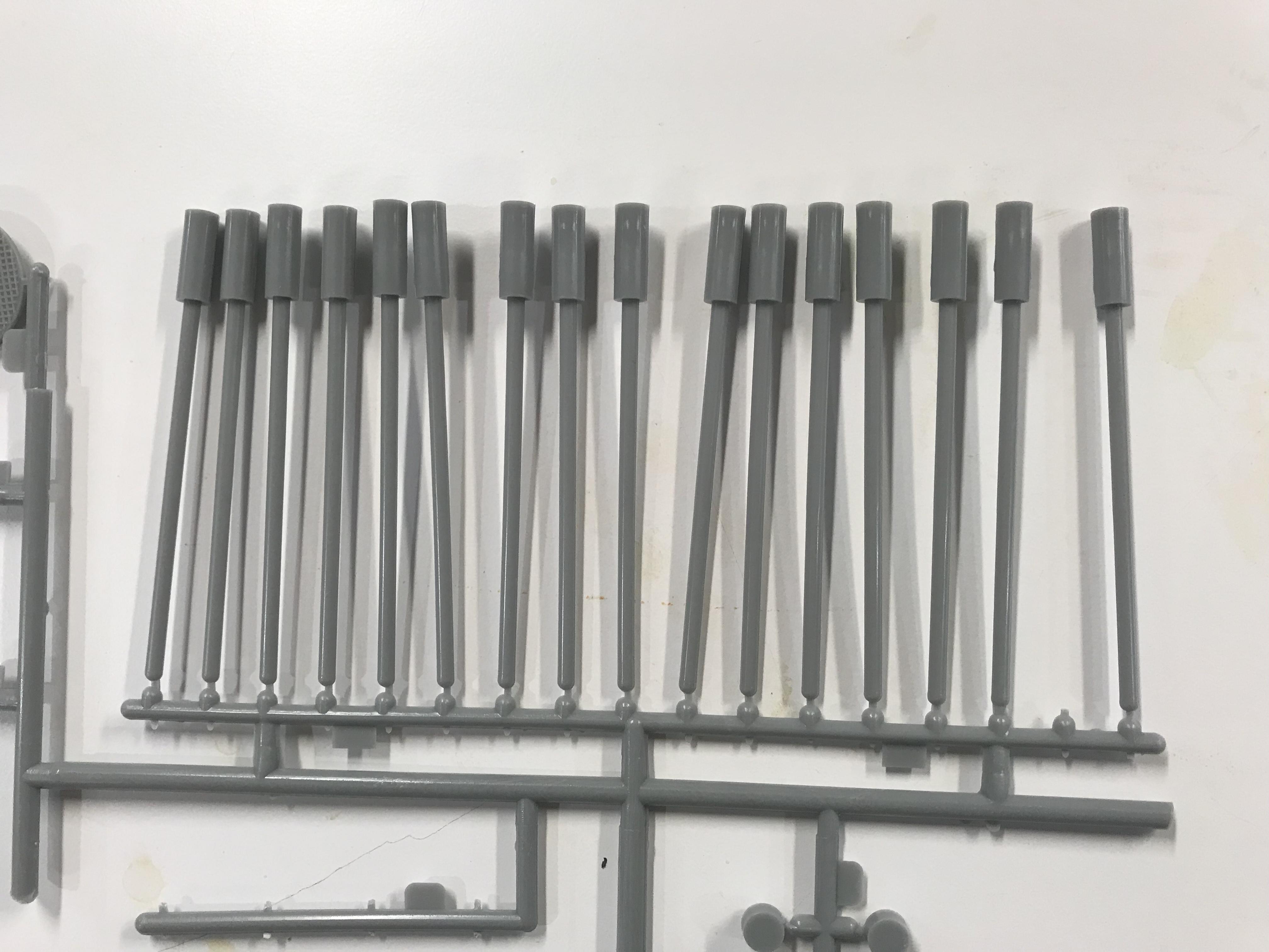

JohnU Posted September 20, 2021 Posted September 20, 2021 On 5/10/2021 at 2:01 AM, peteski said: To me it looks like he replaced the plastic parts with scratch-built brass lifter and pushrod. Looks like pushrod is a brass rod soldered inside a larger diameter brass tube (lifter). Then the end of the lifter that is in contact with the cam lobe is beveled (usually lifters have flat bottom). Glad I came across this thread! So, a while ago I bought the original Renwal kit to build again like when I was a kid from EBay. Long story short, it didn’t have all the clear engine block parts. Everything else to make a running model was there and worked! I bought the Revell kit from HL with 40% coupon (before they discontinued) to complete it. After seeing this thread, I compared the parts in question here and found what might be the problem. I posted pictures for reference. The first picture is the Renwal part sprue the second picture is the Revell part and the third is a side by side comparison. Looks like Revell screwed up the mold and rounded off the tops of the lifters! This also added material to the hight as well! Did a measurement of a random part from each sprue and found Revell added approximately .020 in. to the lifter! Renwal is .550 in. Revell is. .570 in. at the lifter end! The rod end looks to be about the same. I suppose if you’re careful about sizing the length of the total rod and lifter it shouldn’t matter. Just thought the radiused lifter was curious. Was Revell trying to make an improvement? Think I might stick with the flat Renwal parts. I remember my original build when I was a kid worked! Although, my Dad did help with the electrical part!?
