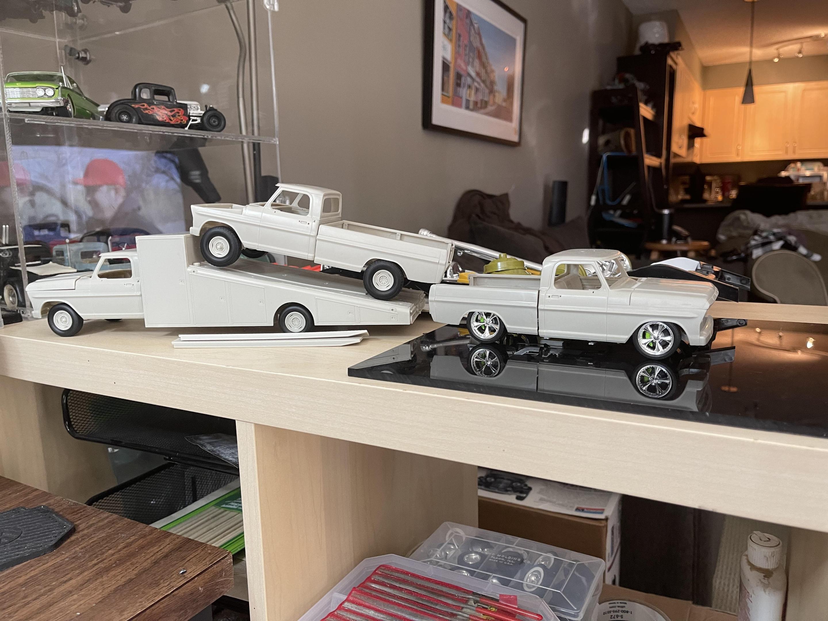

Bullybeef Posted October 7, 2022 Posted October 7, 2022 On 10/6/2022 at 7:27 AM, Daddyfink said: Ok, before we storm Moebius, who here is actually even building one of these right now? I'm not. Working on three atm, the ramp truck, the 70 4x4 and the 70 2wd short bed. 1

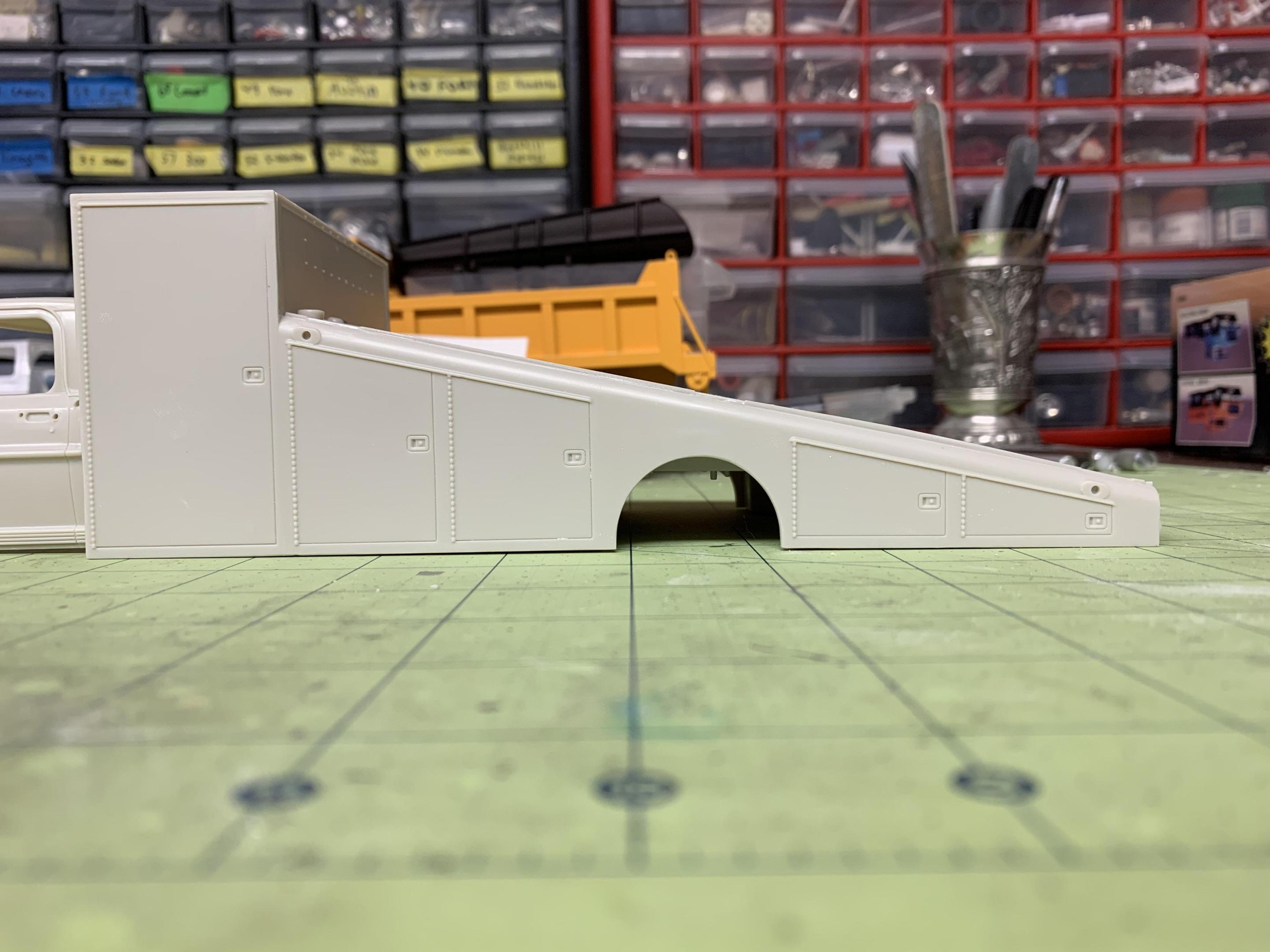

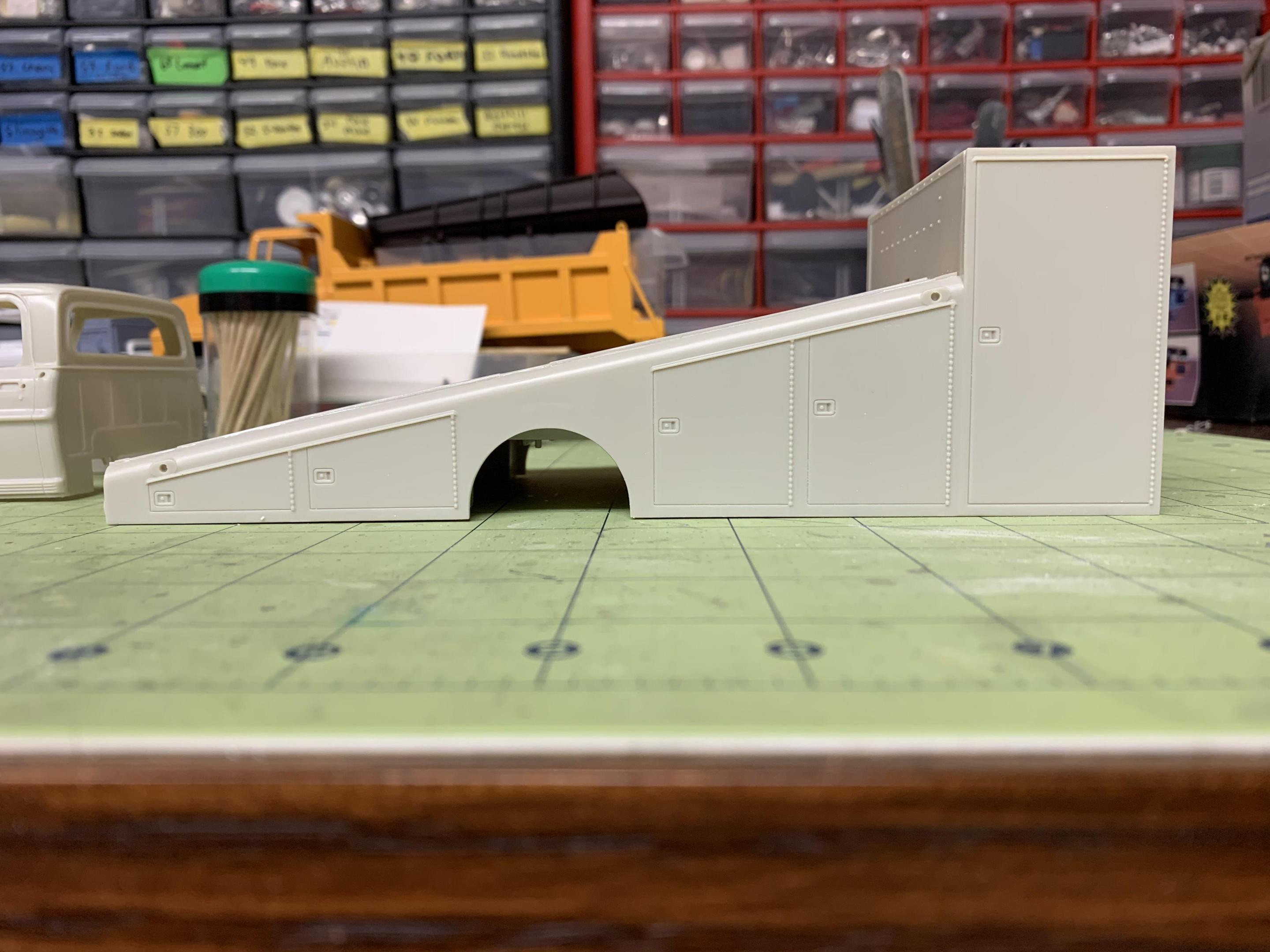

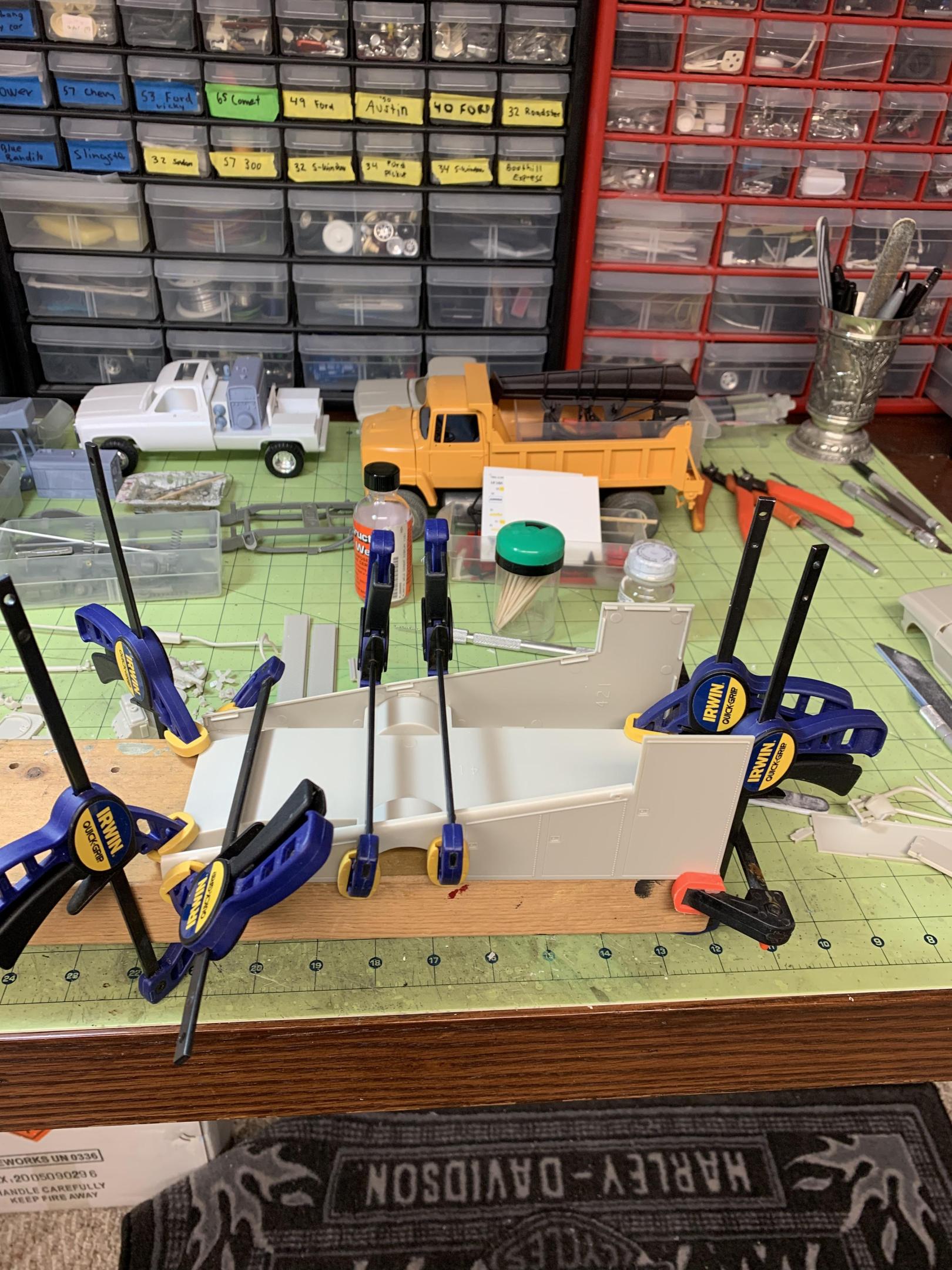

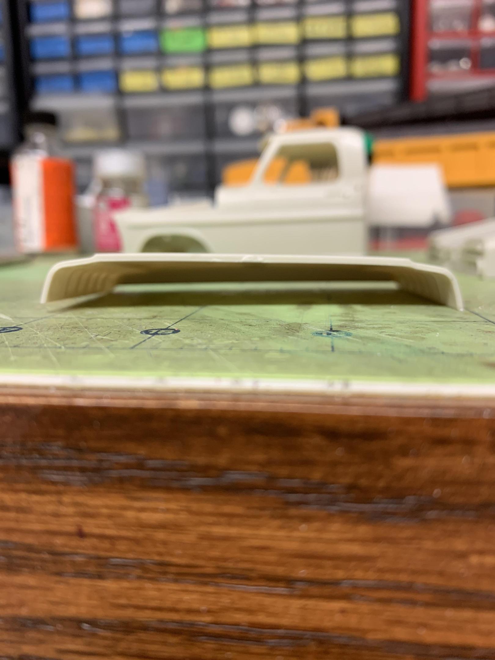

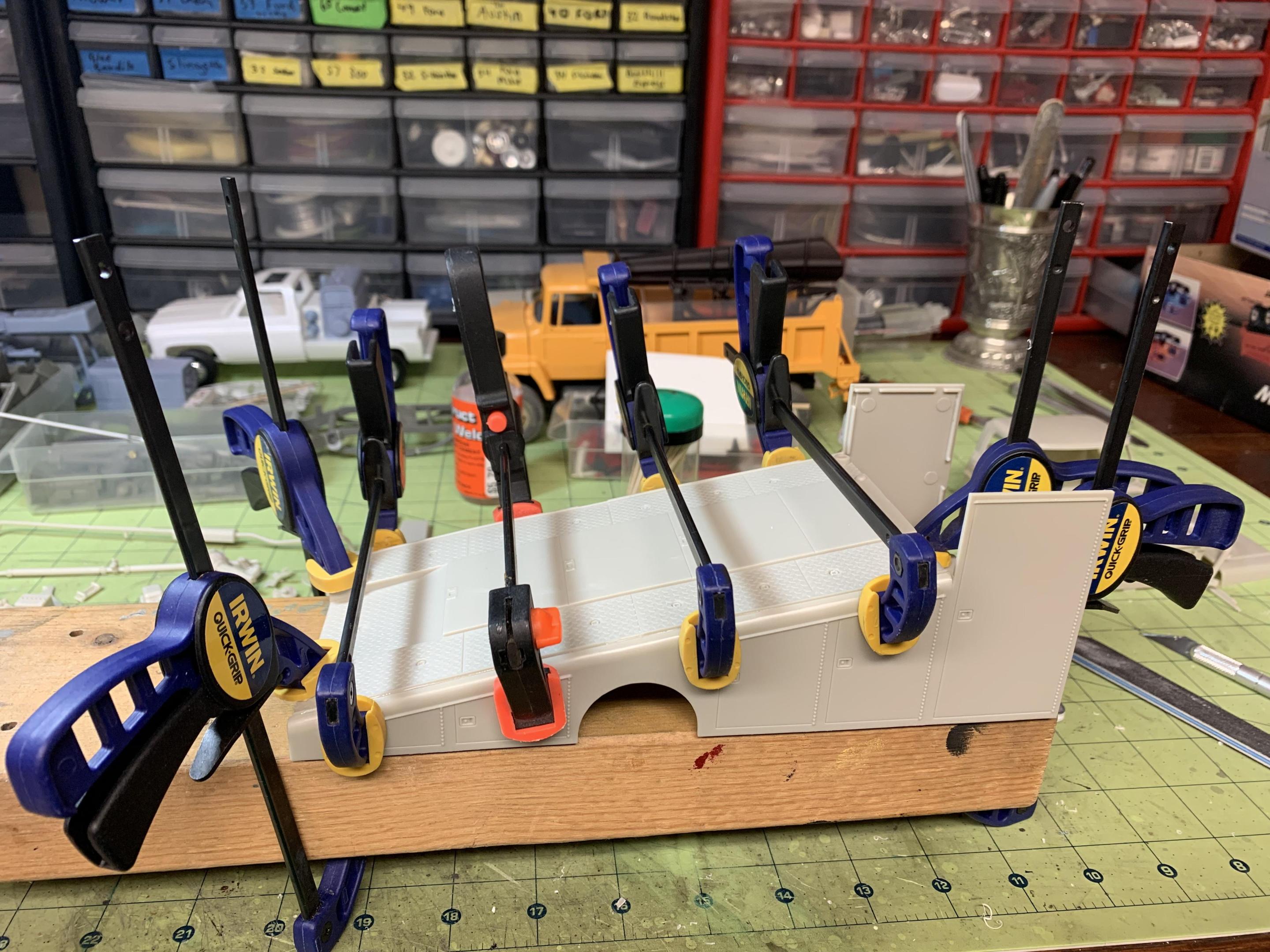

zaina Posted October 11, 2022 Posted October 11, 2022 So to those with the warped ramp parts, it can still be built. Mine was warped about 1/4” from one corner to the other. I clamped the bottom to a 2x4 and assembled one piece at a time while keeping it clamped the whole time making sure the glue was dry before gluing the next piece. It now lays perfectly flat and is very solid. The hood and floor pan I will have to try the hot water trick and clamp down while cooling. 3
