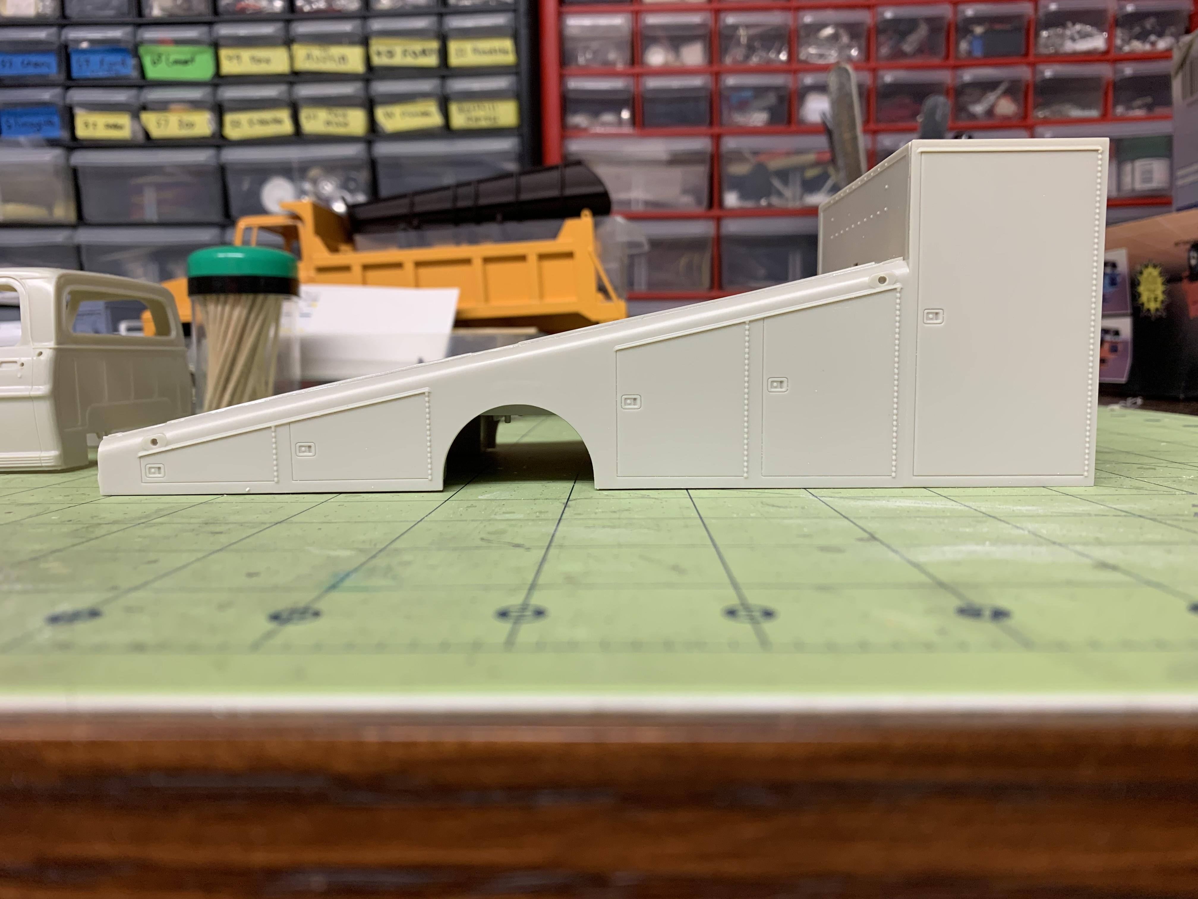

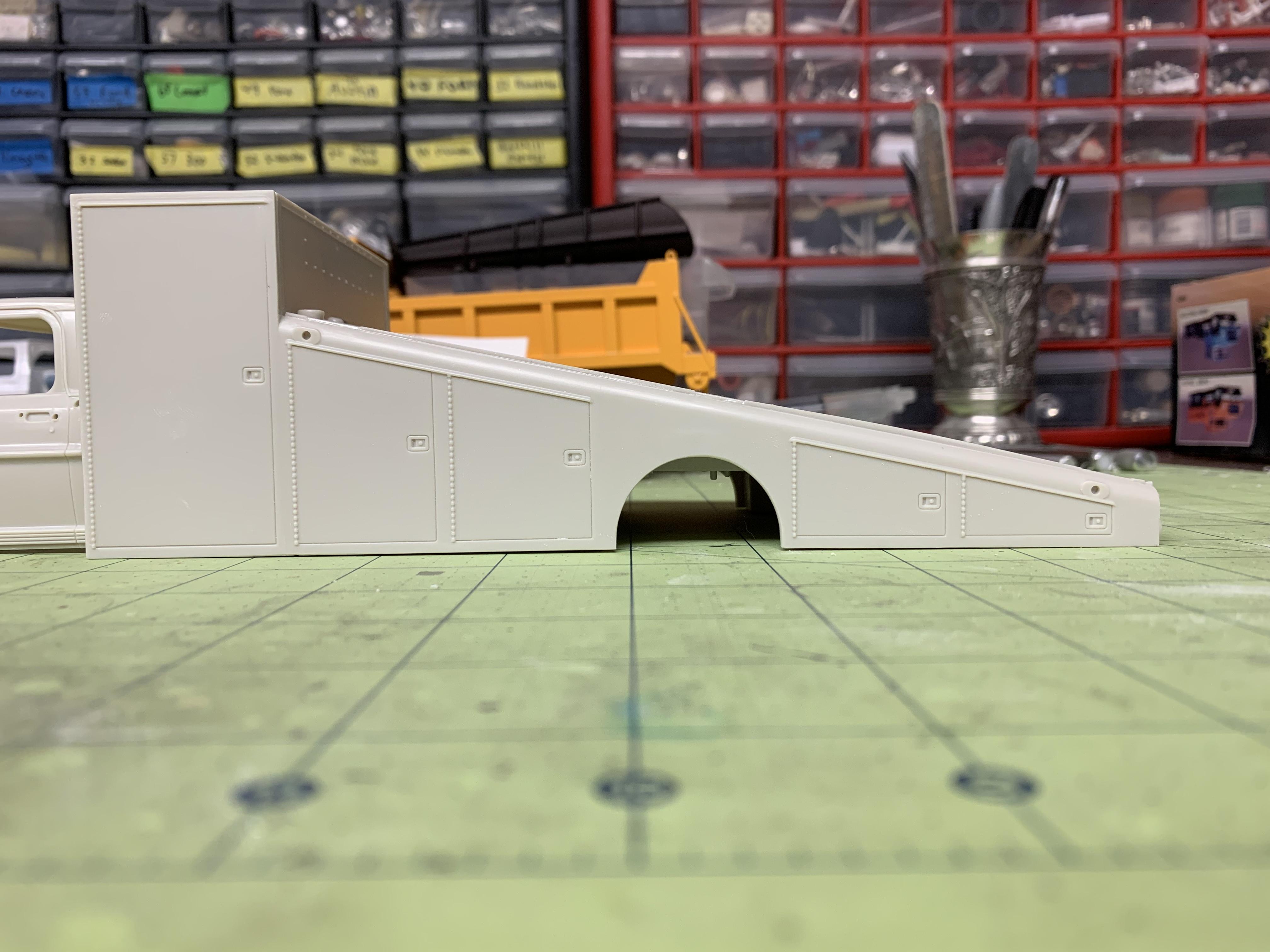

thatz4u Posted October 14, 2022 Posted October 14, 2022 just built my ramp bed, using plastic clamps & blue painters tape on a sheet of plexiglass. it sets level....primer & paint are next... 1

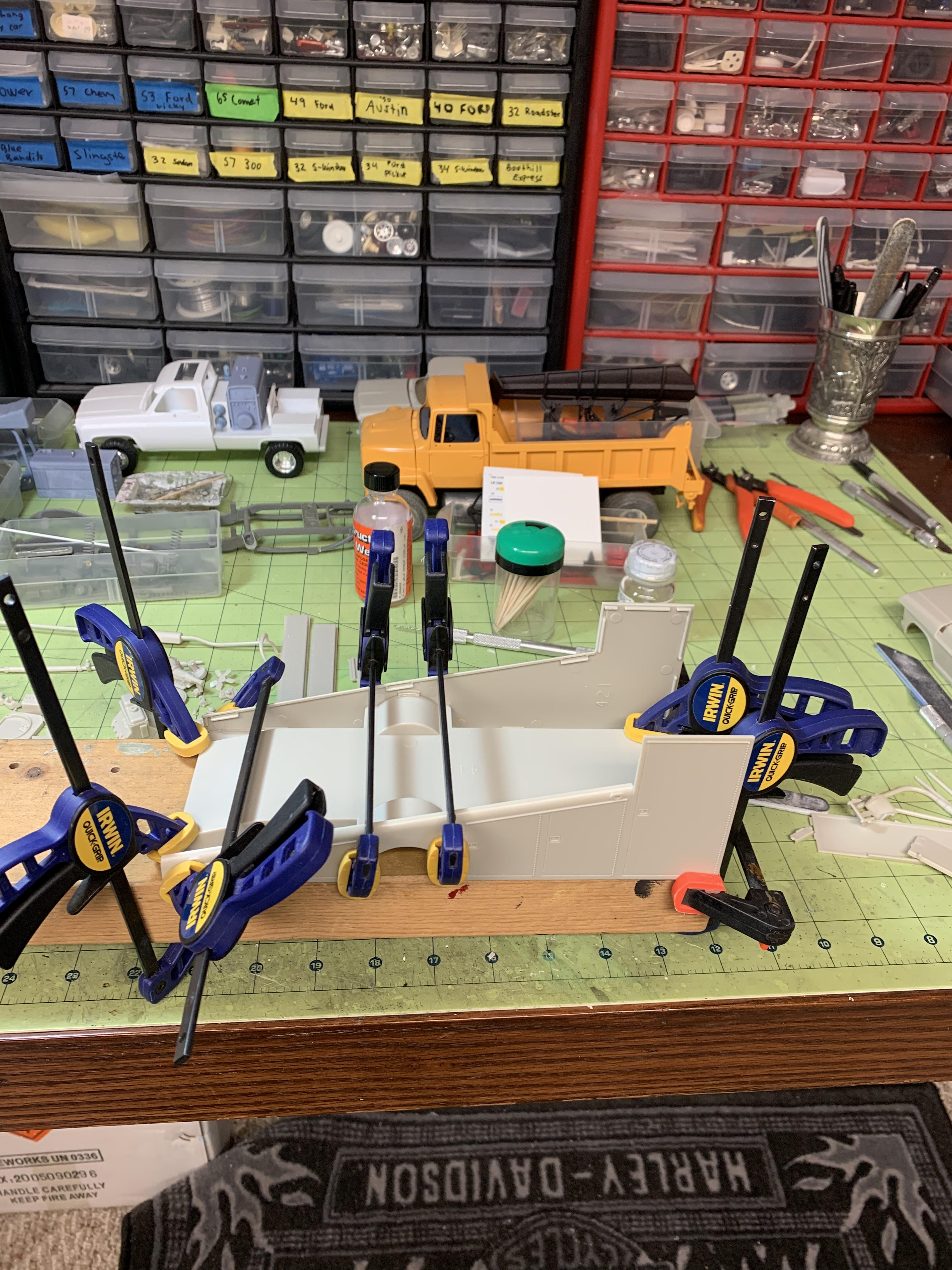

slusher Posted October 15, 2022 Posted October 15, 2022 On 10/11/2022 at 7:42 AM, zaina said: So to those with the warped ramp parts, it can still be built. Mine was warped about 1/4” from one corner to the other. I clamped the bottom to a 2x4 and assembled one piece at a time while keeping it clamped the whole time making sure the glue was dry before gluing the next piece. It now lays perfectly flat and is very solid. The hood and floor pan I will have to try the hot water trick and clamp down while cooling. Looks great!

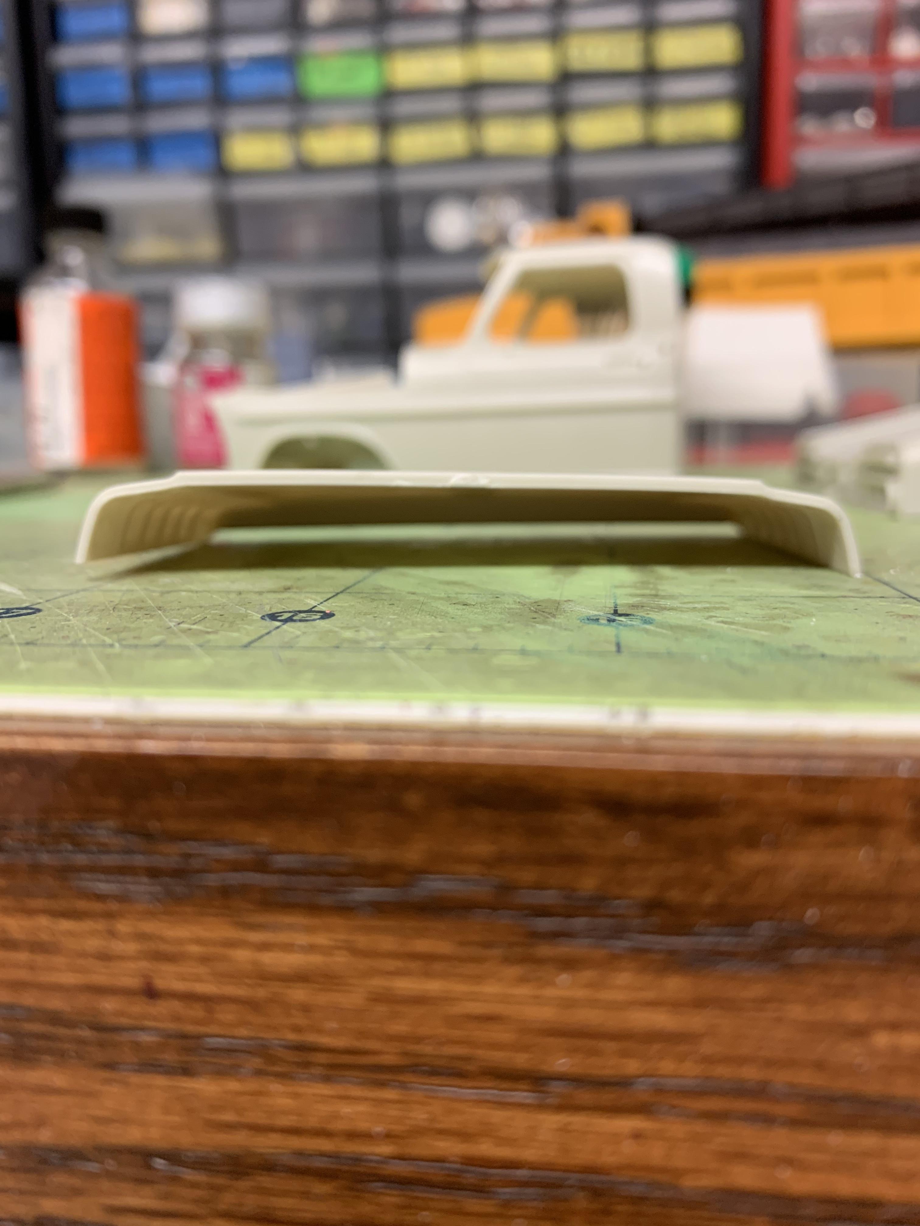

Dpate Posted October 15, 2022 Posted October 15, 2022 On 10/7/2022 at 1:09 PM, Bullybeef said: Working on three atm, the ramp truck, the 70 4x4 and the 70 2wd short bed. See how your hood is warped? That’s how mine was that came with the kit, and the replacement they sent was the same way but on the opposite side lol.

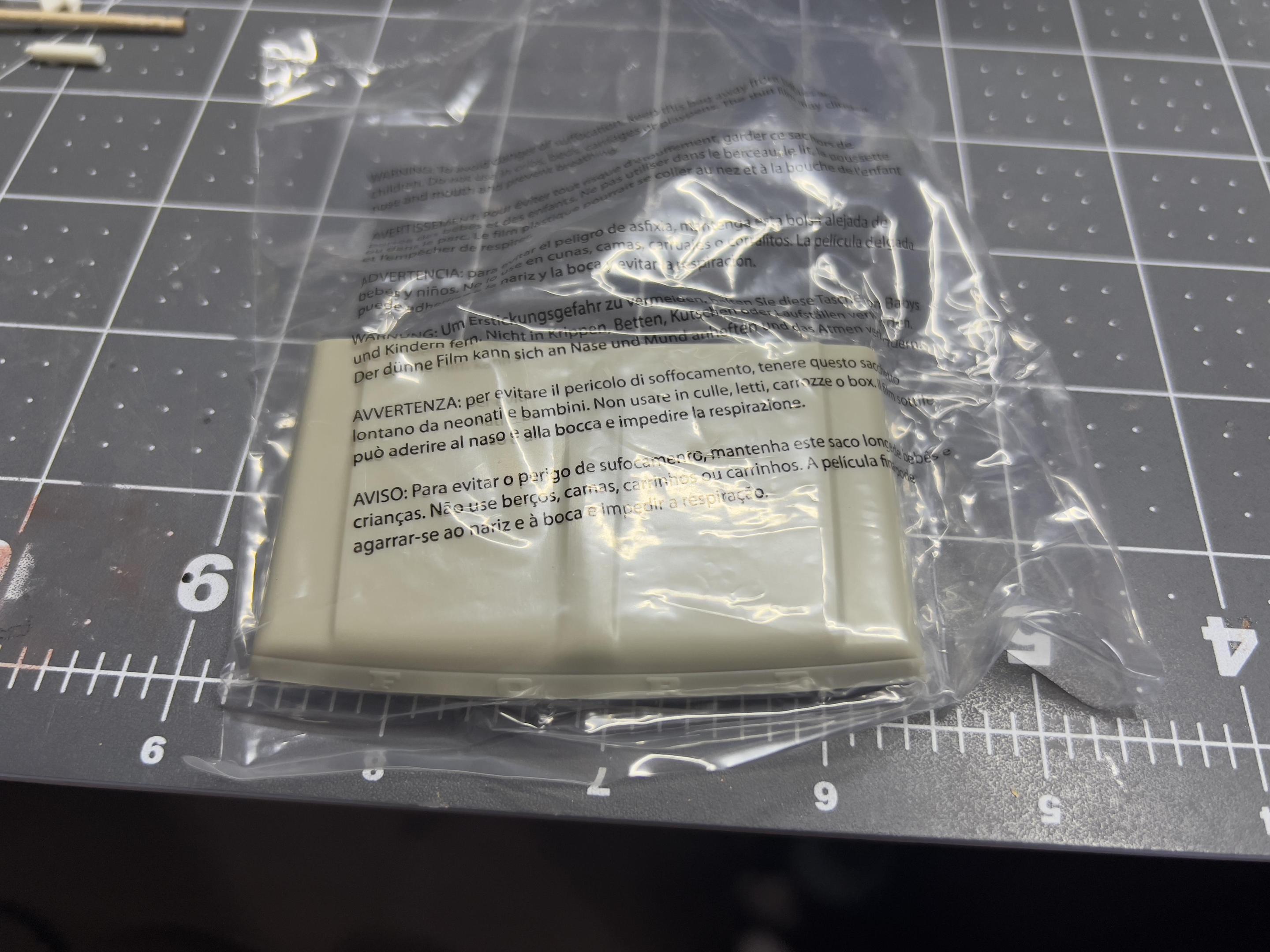

Dpate Posted October 15, 2022 Posted October 15, 2022 So I went to the hobby room today and there was a package left on my chair. No idea what is was, and the writing on the back made me chuckle. So I opened it and I was like woah how did they know? I never asked for a 2nd replacement. But I test fitted the new hood and it’s perfect no warpage. So are they lurking on the forums? Or they knew the other hood they sent was bad, and recent a new one? So now I have 2 warped hoods and a perfect hood lol. 2
