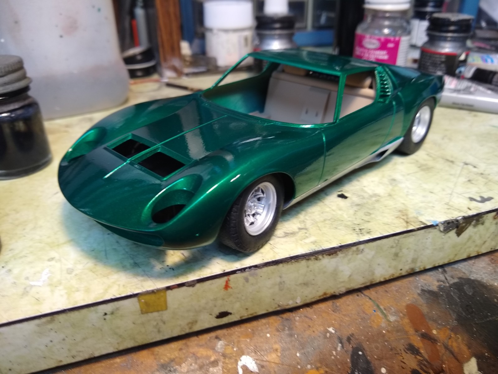

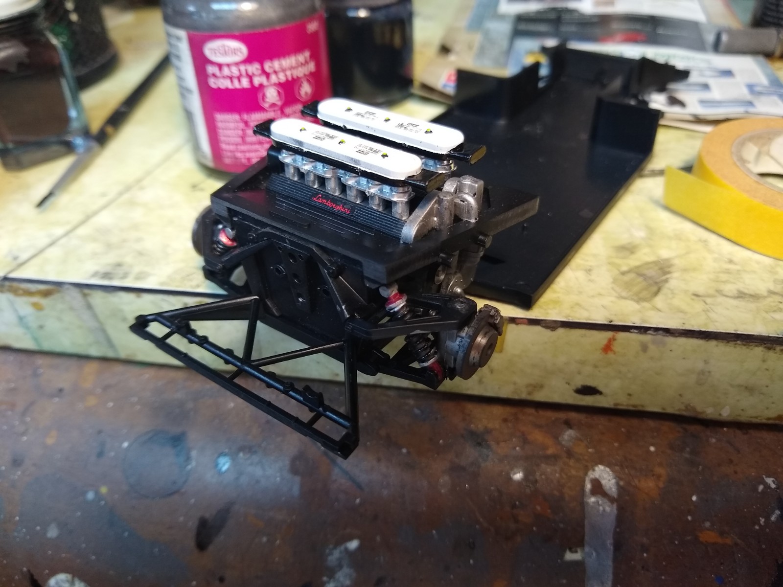

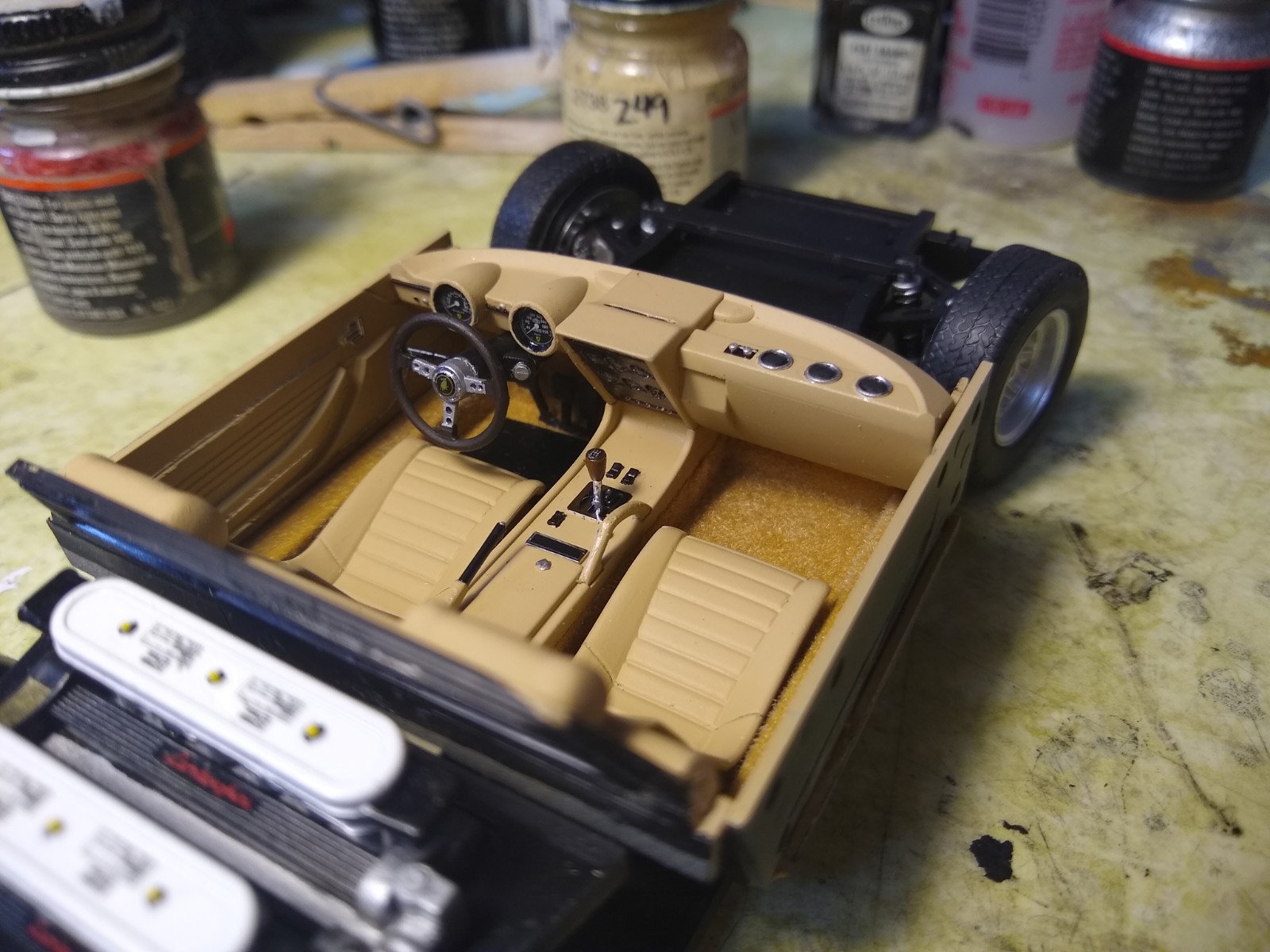

Here's some stuff from my build - sounds much like yours.  I don't have any completion photos though.  My photos never go in the right order.   I primed with silver of some sort apparently - looks like I had the red body as well.   Paint is testors out of can, but I might have decanted it to airbrush.  That would be my guess.   Basic engine photos - then you hide it all with the body.  Interior is nice enough to spend some time on.   I found a site with this exact car that had lots of reference photos.

Looking good! I'm watching with interest. Few years ago I got this toy Miura for a couple bucks, it looks like it's right around 1/24-1/25 scale and I've been looking for some inspiration of something to do with it. First job will be to find some appropriate-looking wheels and tires. Drive on with yours! B)
Link to comment
@randyc Looks great. Love that interior - great colour choice and detail.
