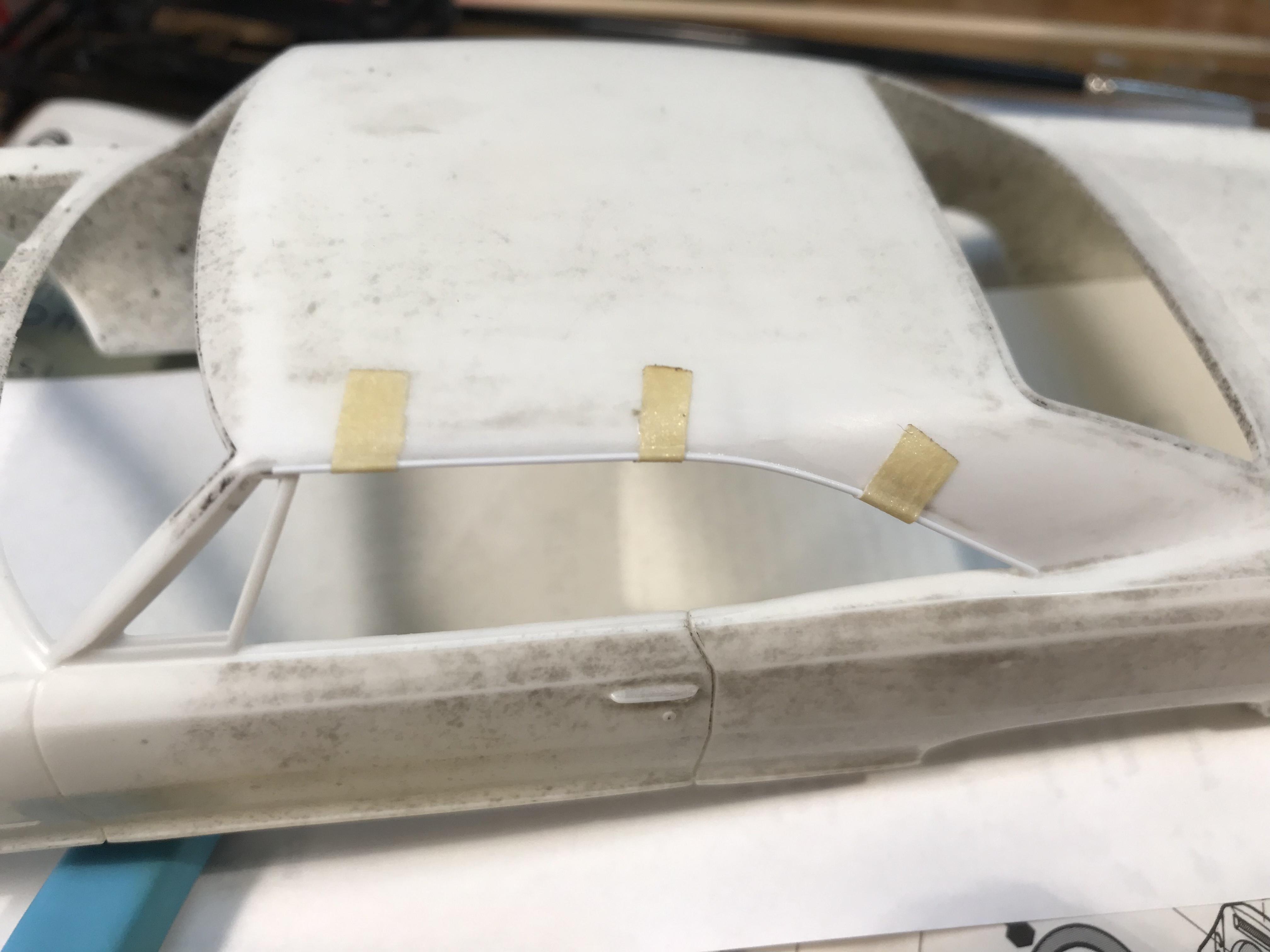

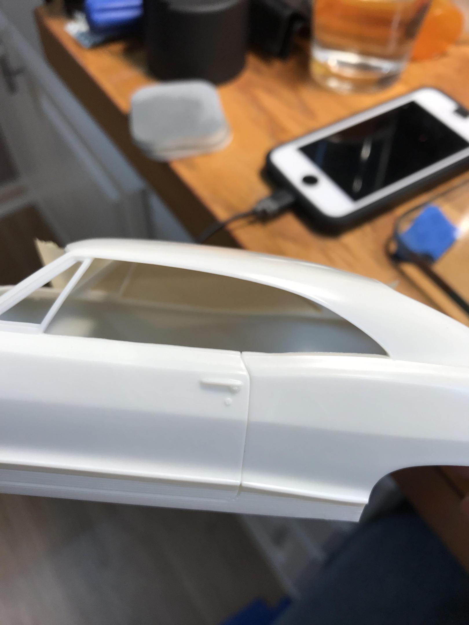

Motor City Posted December 5, 2021 Posted December 5, 2021 Steve, How did you get the correct contour on the window opening? Is that Evergreen strip you used to recreate the drip rail? On 12/2/2021 at 10:36 PM, steveracer said: Here is a simple fix on the left DLO.
Mark Posted December 6, 2021 Posted December 6, 2021 The window opening can be traced from the passenger side, and the pattern used to replace the rain gutter on the driver's side. After that is done, the excess material can be trimmed out. I did the same thing in another thread relating to the 2+2 issue of this kit. 1

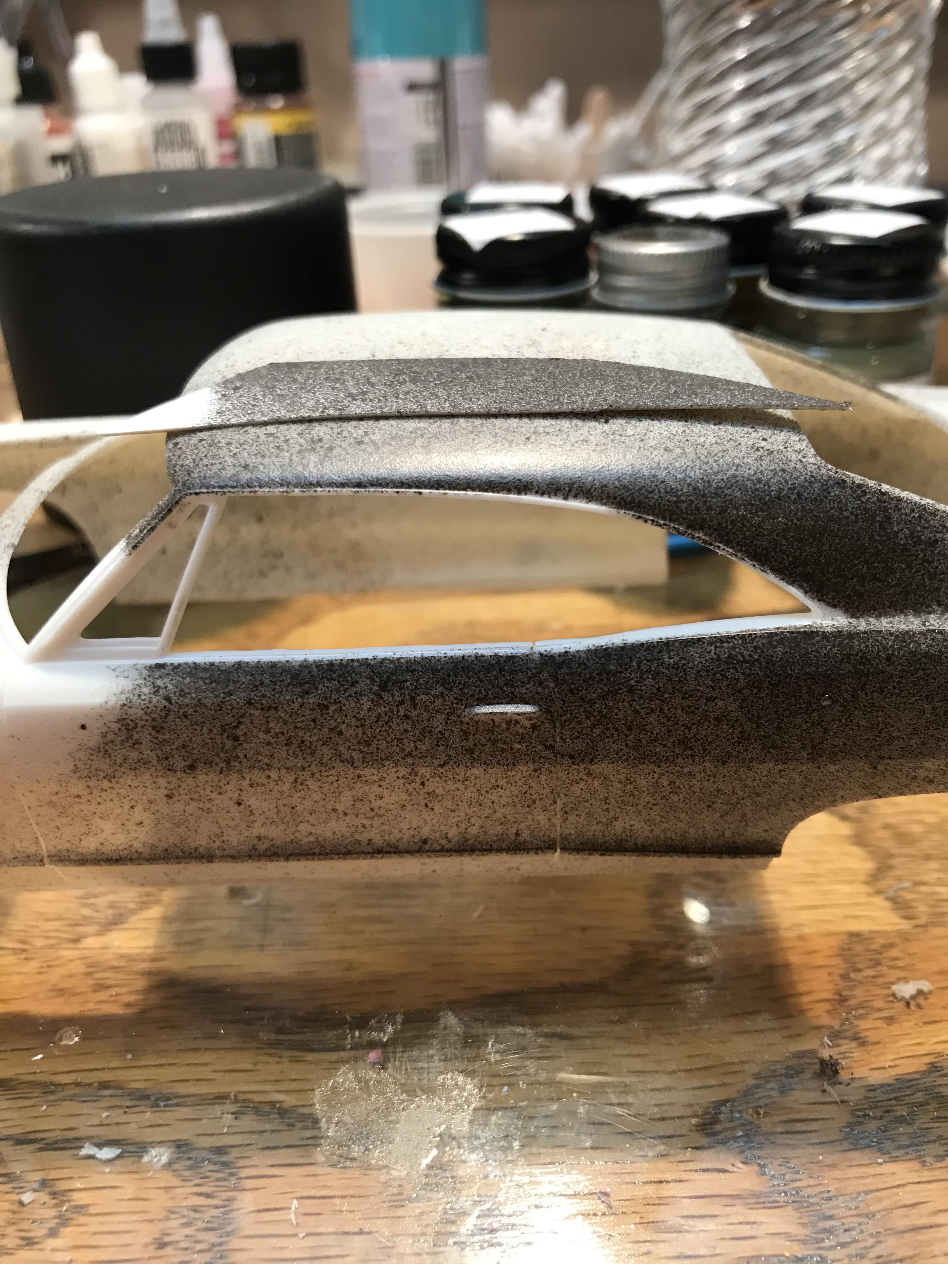

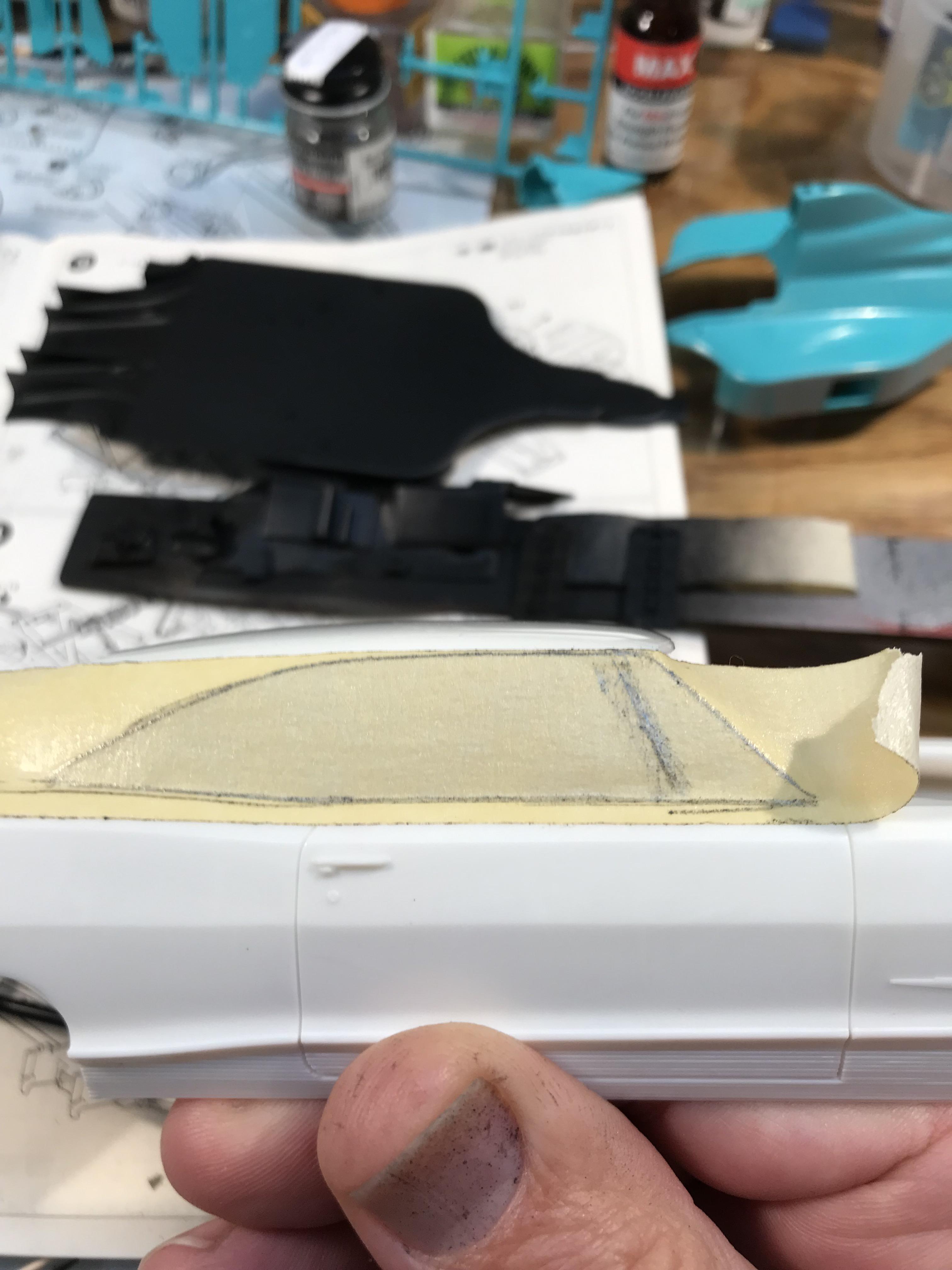

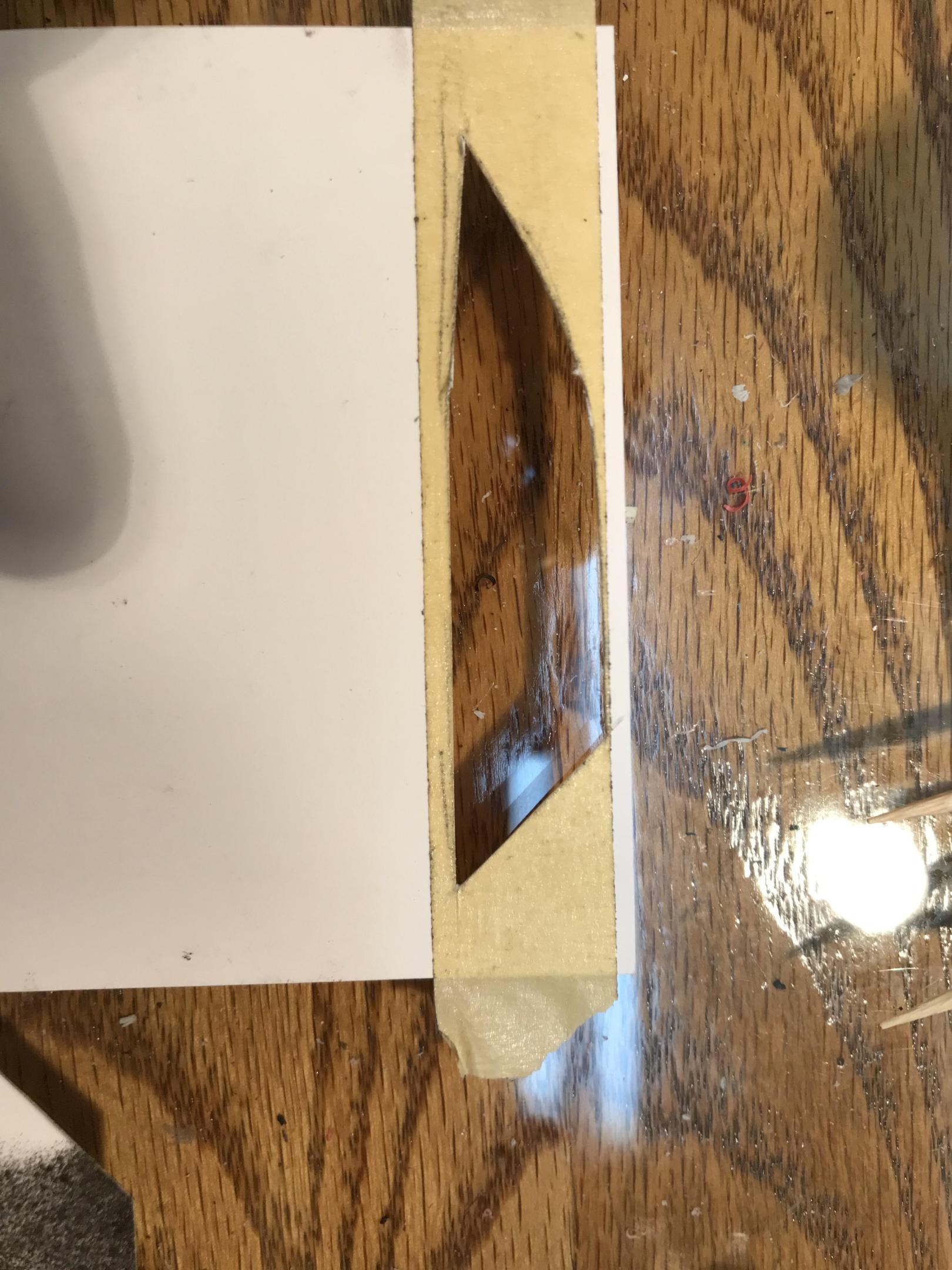

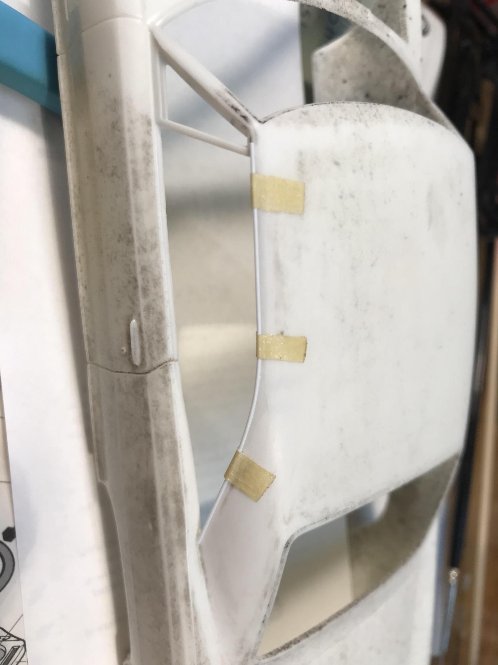

steveracer Posted December 7, 2021 Posted December 7, 2021 It was pretty simple and only about an hour at most to make the shape. I traced the passenger side window opening onto tape. Created a template. Placed the template on the driver side opening. Sprayed a dust trace coat of black primer. Removed material to create the more accurate shape. No material added. Created a rain rail from the smallest evergreen rod - which is .5mm I may rain rail the passenger side too, as it looks more accurate for depth and dimension, but we will see how lazy I can be. This will be just a box stock build, nothing fancy.

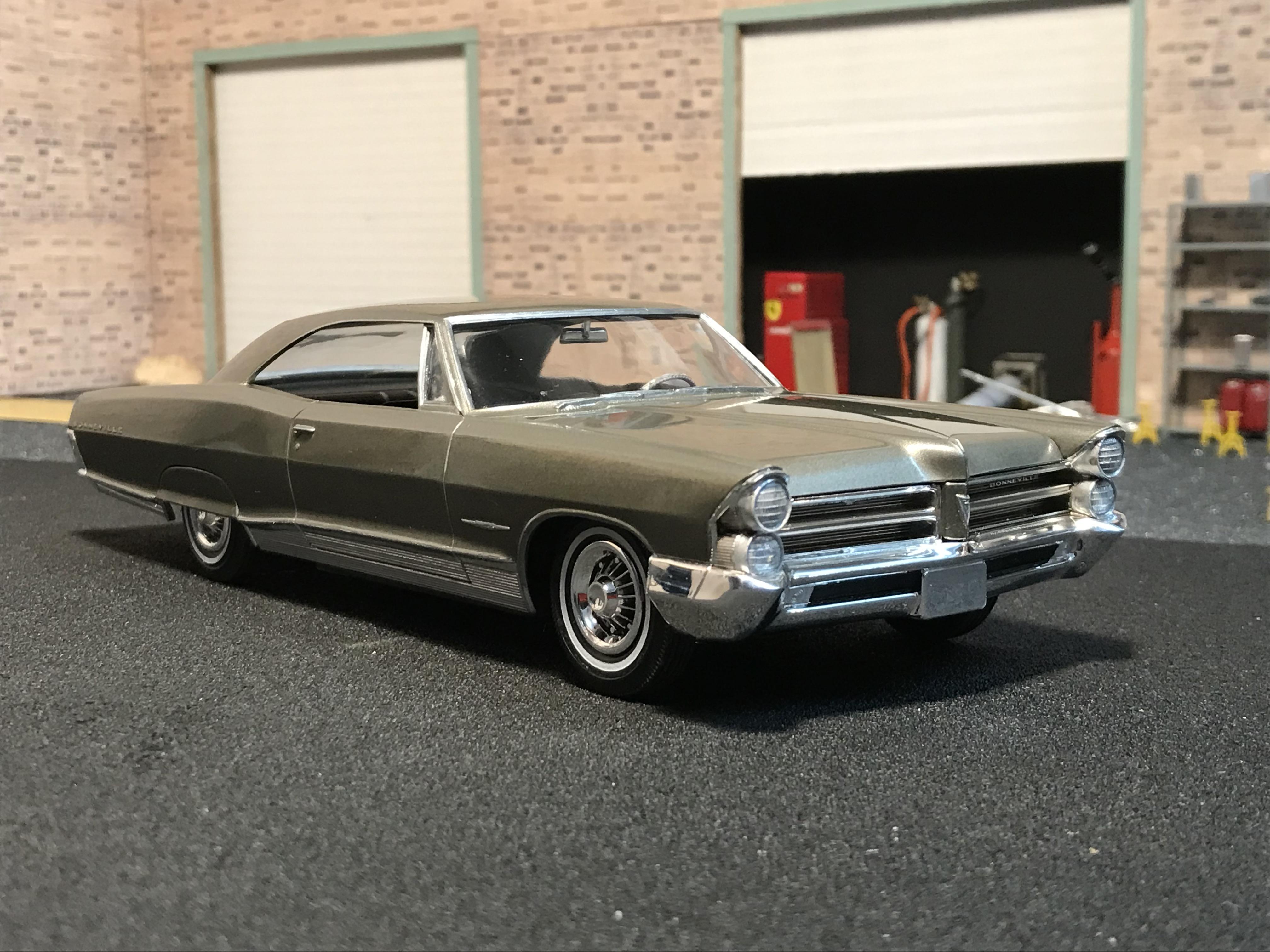

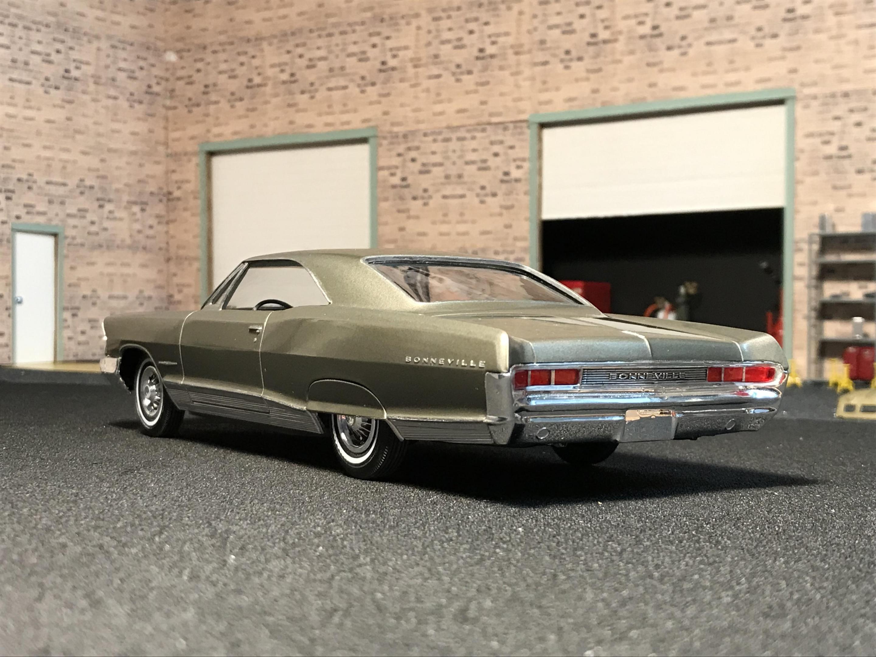

rrb124@sbcglobal.net Posted March 13, 2022 Posted March 13, 2022 Looking like a real 1:1 Bonneville. The wheels are perfect. 8 lug wheels are complex. Used to see these in the neighborhood when I was growing up.
