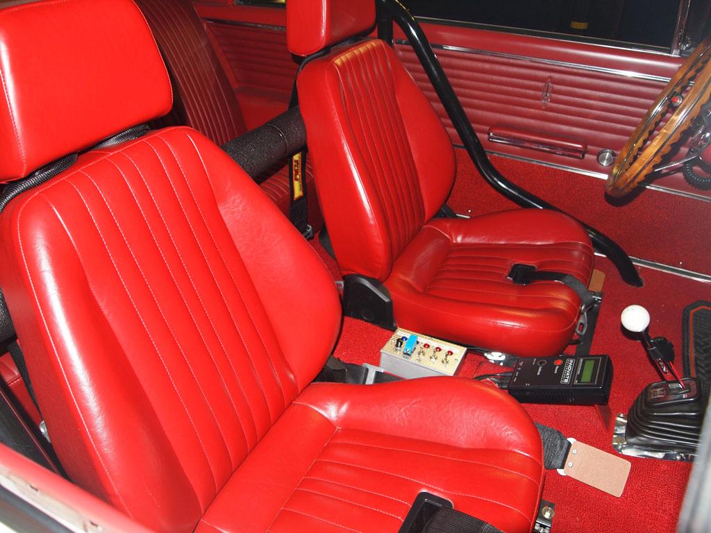

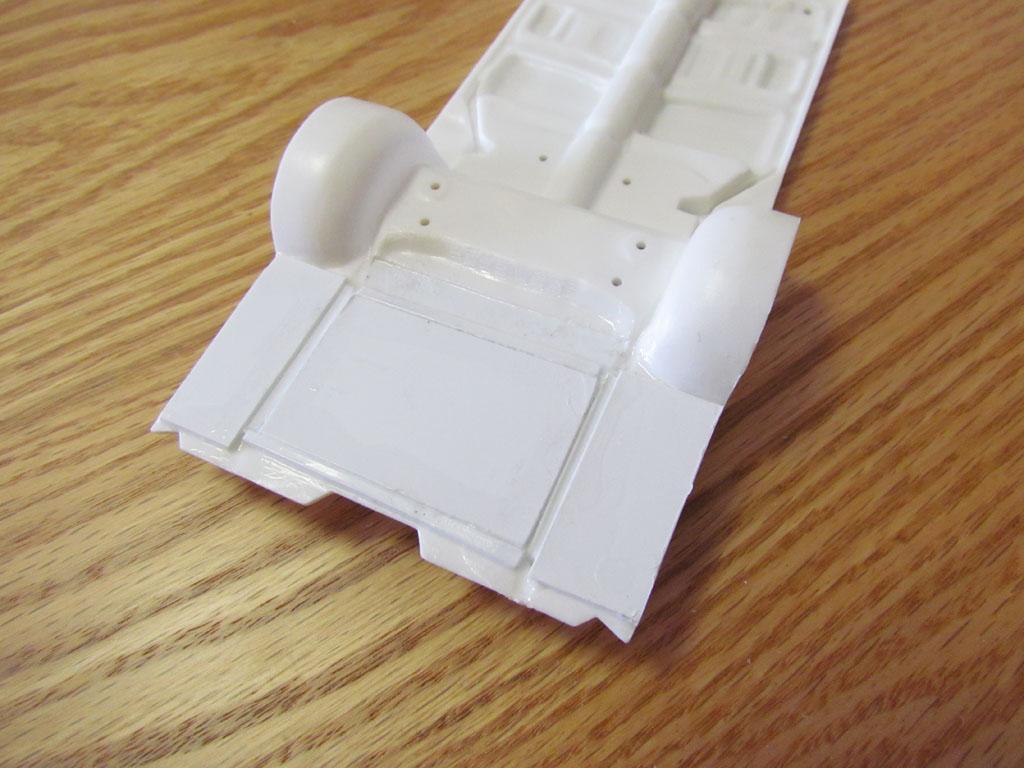

crowe-t Posted November 16, 2021 Posted November 16, 2021 (edited) I'm building a '65 Olds 442 for my friend. It's going to be a model of his car. I attached some pictures of his car, including the interior, engine and undercarriage. My friend sent me an R&R Resins '65 Olds 442 and a Lindberg '67 Olds 442 to start with. The resin kit from R&R Resins isn't that great. The body is warped and the details aren't that accurate. I was considering buying a MCW(Model Car World) '65 Olds 442 but by luck Round 2 just released the AMT '64 Olds 442 Hardtop kit so I decided to use that instead of the resin body. The '67 442's chassis, interior, engine... are all much better than the parts that come in the '64 kit so I'm modifying them to fit the AMT '64 body. The 1:1 car has a custom frame and fuel cell. Before the AMT '64 kit arrived I started working on the '67 kit's parts. I cut the gas tank and rear area out of the '67 chassis and scratch built the fuel cell and surrounding frame and started making the hood scoop. The hood is a fiberglass one with a 4 inch cowl scoop from VFN Fiberglass. I'll post more pictures in the next post. I'm not sure how many I can put in a single post. Edited October 4, 2023 by crowe-t

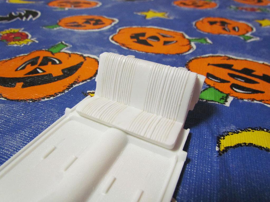

crowe-t Posted November 16, 2021 Author Posted November 16, 2021 (edited) I had a set of front seats from a Revell '85 Olds 442 that I'm using. I modified the seats to match the seats in my friend's 1:1 442. The '85 Olds seats already had a similar shape so it was the easiest way for me to make them. I removed all the details on the '67 kit's rear seat and used half round rods to simulate the look of a '65 rear seat. I had to leave a few pleats out but at this scale it won't be noticeable. The ends of the quarter panels are re-shaped to resemble a '65. Edited November 16, 2021 by crowe-t 1

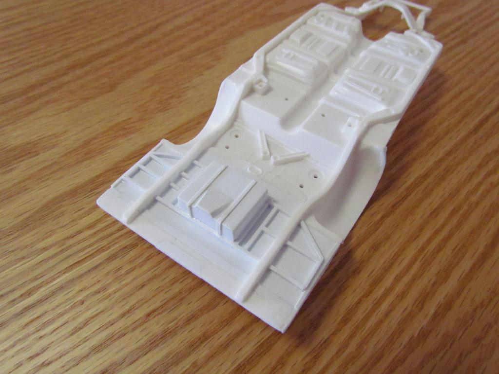

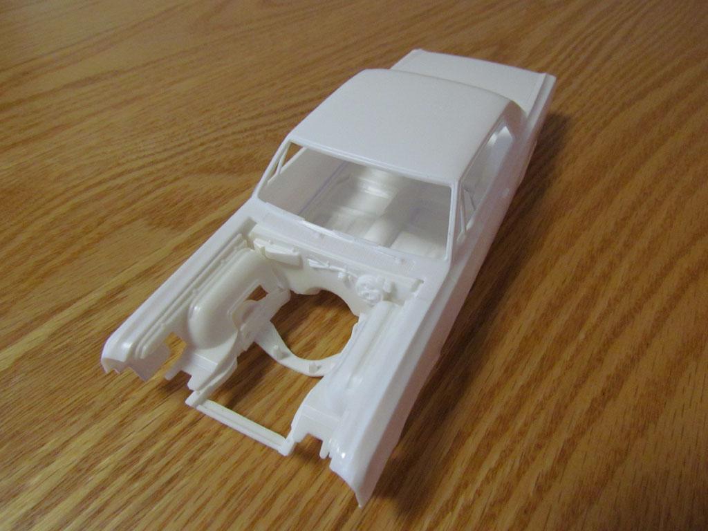

crowe-t Posted November 16, 2021 Author Posted November 16, 2021 (edited) Since the '67 kit has the inner front wheel wells attached to the body I had to cut them out and install them in the '64. They are much nicer than the ones attached to the '64 chassis. The '64 chassis has the exhaust, drive shaft and rear end all molded in. It's one part of the kit Round 2 should have re-tooled. I attached a picture with the hood scoop laid on the hood and a resin grill/bumper from MCW. I bought the front grill/bumper, rear bumper and tail light panel from MCW. These parts are more accurate than the ones in the R&R Resins kit. The '67 rear end has the sway bar molded in which doesn't look realist so I started removing it. I'll make a new one with styrene rod. Today I finished the hood scoop. I glued styrene to the front of the hood to re-shape it. It just needs some putty and sanding. I also added the straps on the fuel cell. Thanks for looking in. I'll post more updates soon. Edited November 16, 2021 by crowe-t 2

kermn8r Posted November 17, 2021 Posted November 17, 2021 Looks like you are off to a great start. I like this body style so I'll be watching. I was wondering how you got the half rod to conform to the curve at the front of the rear seat bottom and at the top of the seat back. I eventually want to model the Red Express truck I used to own with the standard bench seat that is remarkably similar to your rear seat. The kits have the optional bucket seat & the other Dodge trucks have a different style bench seat.

crowe-t Posted November 17, 2021 Author Posted November 17, 2021 (edited) 6 hours ago, kermn8r said: Looks like you are off to a great start. I like this body style so I'll be watching. I was wondering how you got the half rod to conform to the curve at the front of the rear seat bottom and at the top of the seat back. I eventually want to model the Red Express truck I used to own with the standard bench seat that is remarkably similar to your rear seat. The kits have the optional bucket seat & the other Dodge trucks have a different style bench seat. Thanks Walt! I applied some Plastruct Plastic Weld which sets faster than thin cement on the seat and held the half round rod(s) in place until they stuck. I used mostly 1 mm half round and some 1.5 mm for the wider pleats. It's easier to glue it to the curved areas with a thicker cement. Edited November 17, 2021 by crowe-t

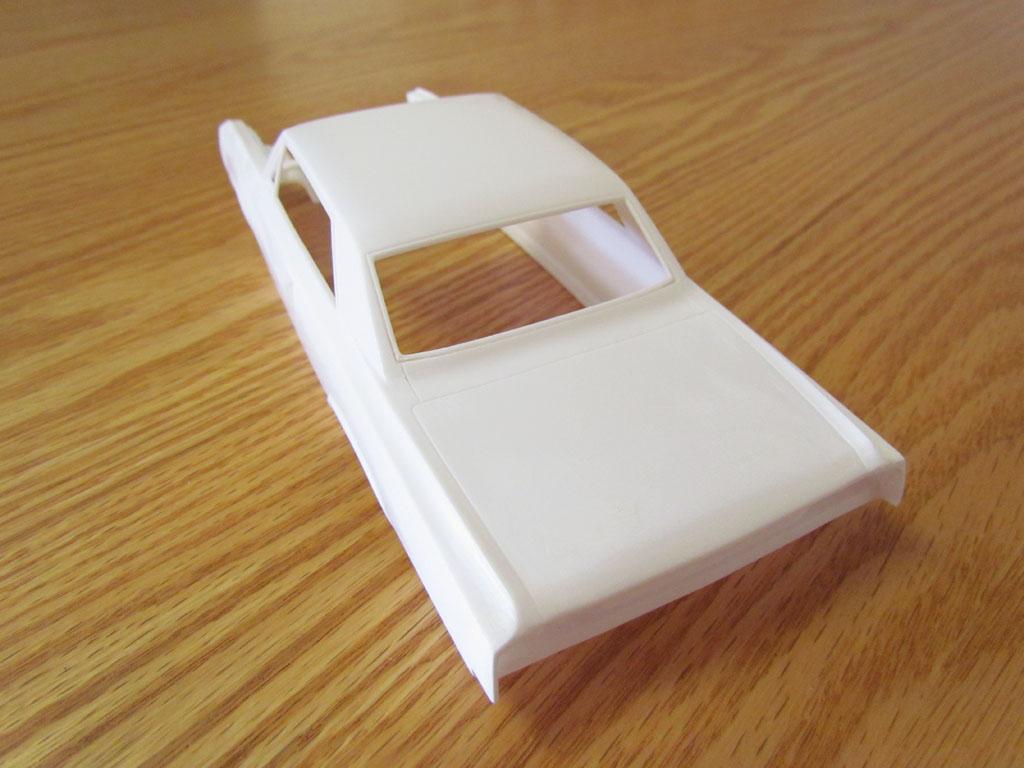

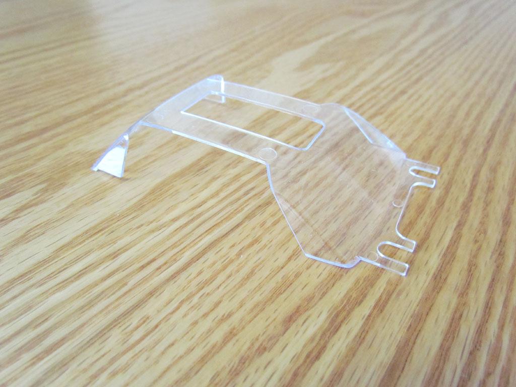

crowe-t Posted November 24, 2021 Author Posted November 24, 2021 (edited) I cut the clear windows out so they can be installed as 2 separate windows. I never liked how they look inside when they are connected. I added some styrene to the lower corners of the windshield frame to round them some more and re-scribed the frame. The lower corners out of box aren't rounded enough. The kit is missing some seam lines below the windshield frame that separate the fenders and windshield valance. I scribed these in. It shows in some of my previous pictures but I hadn't pointed this out. The last picture shows how the lower corners of the windshield frame looked and has no seam lines out of box. Edited November 24, 2021 by crowe-t

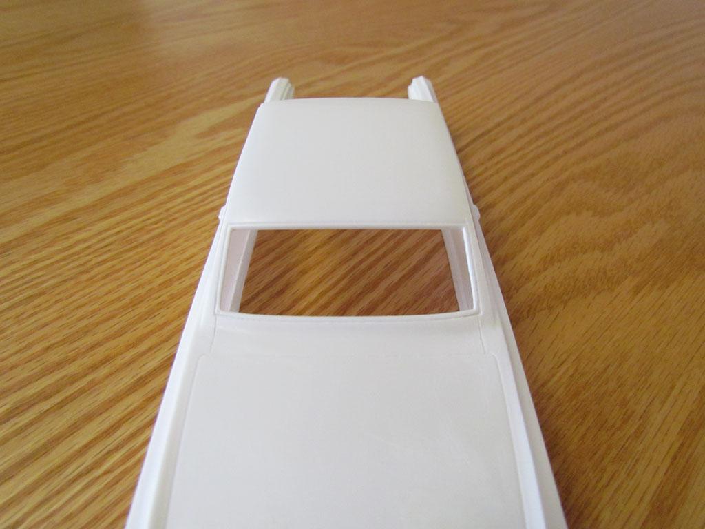

crowe-t Posted November 24, 2021 Author Posted November 24, 2021 (edited) The lower corners of the rear window frame are rounded on the '64 kit. They should be squared off. I squared them and also scribed the lines that separate the rear deck filler panel from the quarter panels. The last picture shows the lower corners of the rear window as round. Unfortunately I forgot to take more pictures of the rear of the body before I squared off the corners and scribed the rear deck filler panel separation lines. This is the best picture I have showing that. Edited November 24, 2021 by crowe-t
