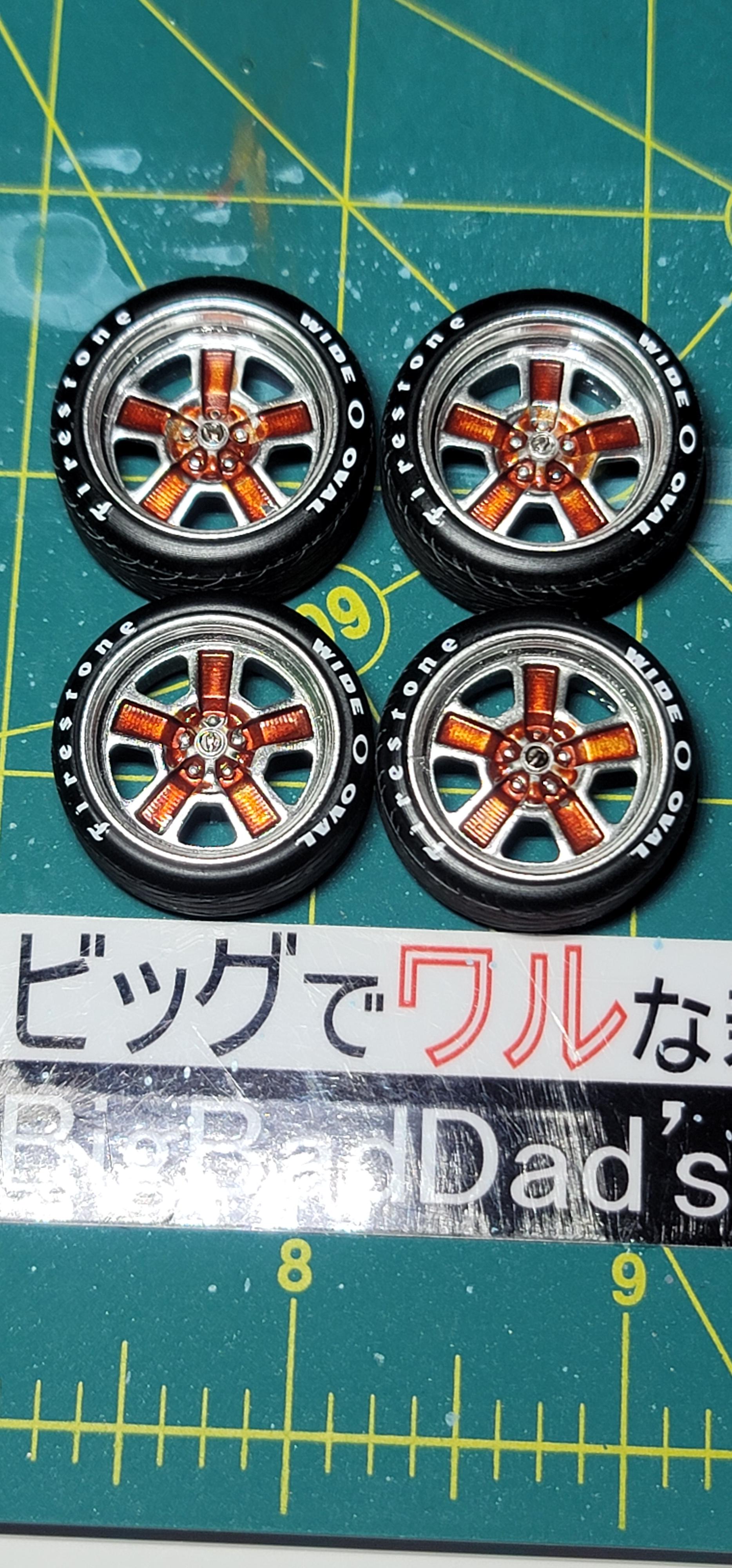

Katsusauce Posted November 19, 2021 Posted November 19, 2021 I'm buying my injet decal paper from Amazon....both clear and white. Some of the decals I've printed for myself using both the clear and white paper from Amazon.... FYI....for these decals I'm using Future Finish as a setting solution....it needs something a lot stronger than microset, Mr. Setter, ect.....
