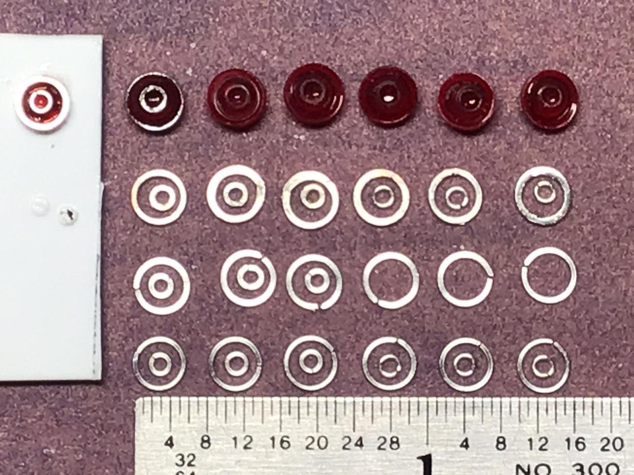

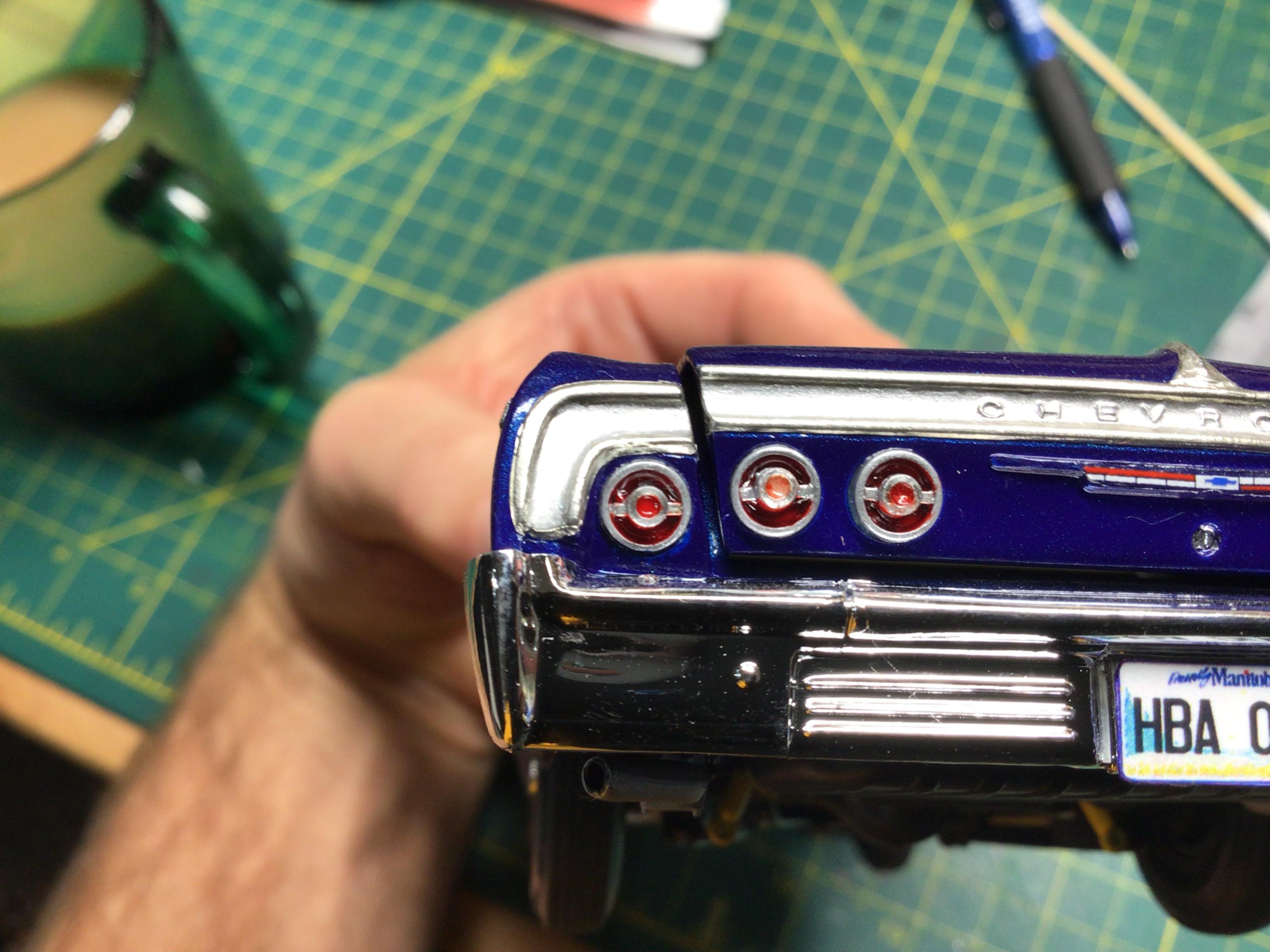

NOBLNG Posted November 24, 2021 Posted November 24, 2021 (edited) If you can find aluminum tube that is the correct size, it would give you a seamless bezel. The wire trick works great and the seam can be cut or filed square on both ends to give an almost invisible seam. I have a cheap set of drill bits that will give me practically any size bezel I want. I have also flattened them slightly in a vise for these tail light bezels. Edited November 24, 2021 by NOBLNG

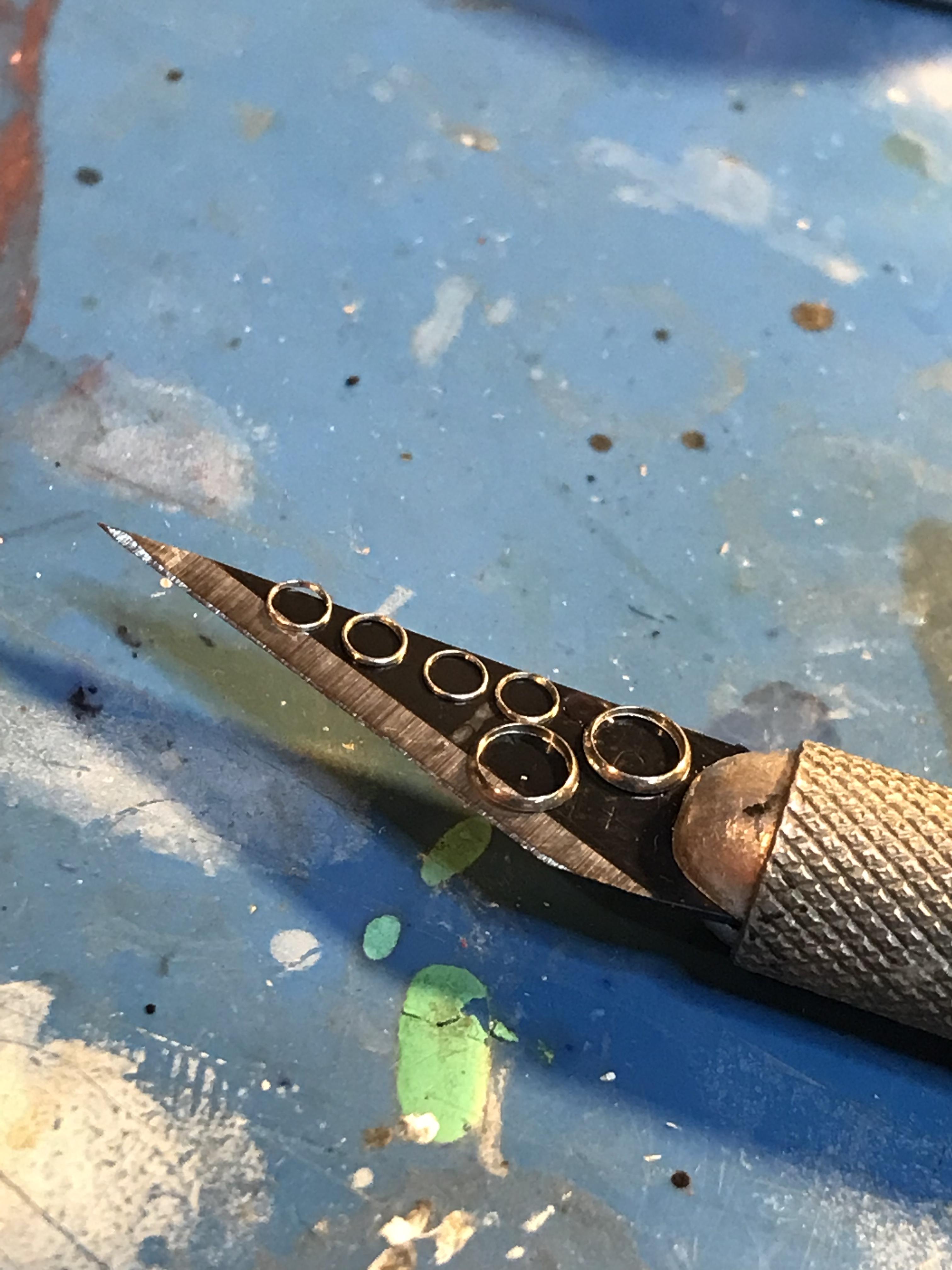

Bainford Posted November 25, 2021 Posted November 25, 2021 (edited) These rings were made from aluminum tube. The small ones are gauge bezels for the small gauges on my Europa build, and the larger ones are for the dash vents. Tricky to make, and it often takes me two to three attempts to get a satisfactory one, but it gets easier and faster as you get in the groove, and they look 10 times better than PE. They are typically .010”-.012” thick, but I’ve successfully made them as thin as .006”. The pucker factor goes up as the they get thinner, so I usually hold up at .010”. That’s a scale 1/4” which is fine for most applications. I can post up a tutorial if there’s any interest. Edited November 25, 2021 by Bainford Where’s my keys 1
