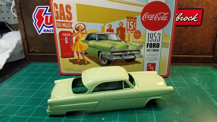

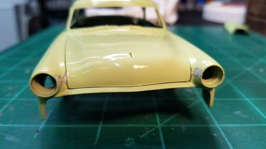

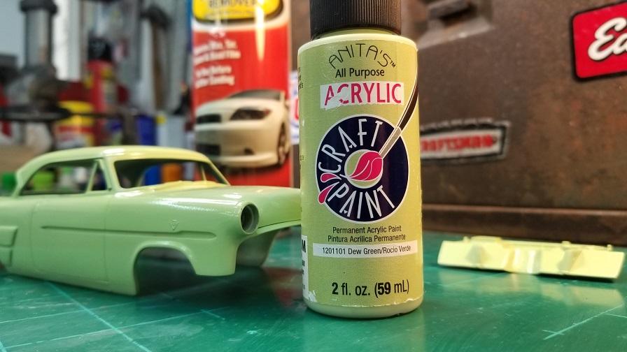

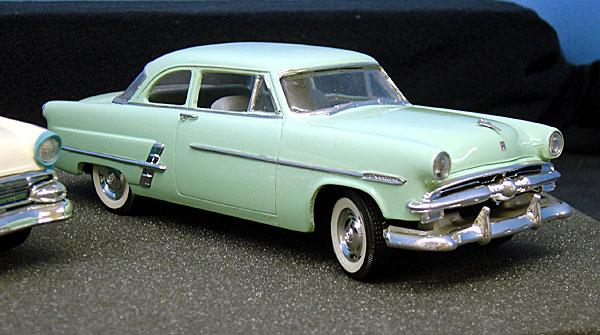

Zippi Posted December 31, 2021 Share Posted December 31, 2021 (edited) Well....I think I have picked my next project for the start of 2022. It's the AMT 1953 Victoria and will be built stock. I painted this some months back in preparation for the cold winter months. I found that I forgot to sand out a couple mold lines by the headlights after it was painted so I sat it aside. I've cleaned up the mold lines and I'll brush on a little of the craft paint and a little Pledge Revive-it and see if I can polish it. If that turns out ok I'll move forward on this build. I'm also debating on leaving the top of the car green or strip it and paint it white. If I go with stripping it I'll have to wait until warmer weather comes back. The body was air brushed with Anita's Dew Green mixed 50/50 with Windex and cleared with Rust-Oleum Crystal Clear Acrylic Lacquer. Edited December 31, 2021 by Zippi 3 Quote Link to comment Share on other sites More sharing options...

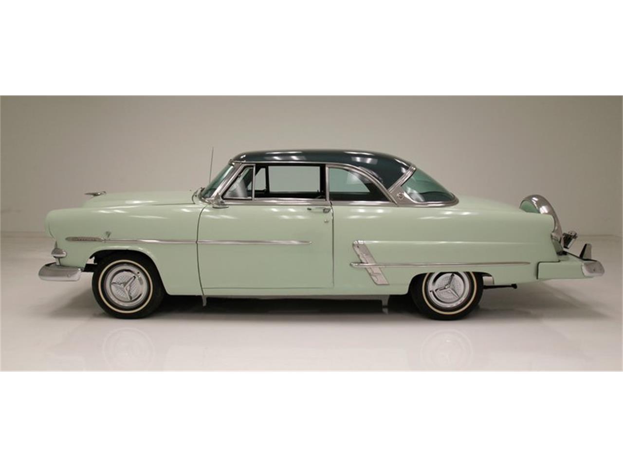

Bullybeef Posted December 31, 2021 Share Posted December 31, 2021 I think for a stock build a two tone would be the choice, unless it’s a base model??♂️. I do like that colour, it’s like a cloudy pea green. Quote Link to comment Share on other sites More sharing options...
Zippi Posted December 31, 2021 Author Share Posted December 31, 2021 9 minutes ago, Bullybeef said: I think for a stock build a two tone would be the choice, unless it’s a base model??♂️. I do like that colour, it’s like a cloudy pea green. Yeah I think your right. I need to get after that top and paint it white. Just need some good weather. 1 Quote Link to comment Share on other sites More sharing options...
espo Posted December 31, 2021 Share Posted December 31, 2021 The White top would look good, or maybe a dark Metallic Green color. Quote Link to comment Share on other sites More sharing options...
Bullybeef Posted December 31, 2021 Share Posted December 31, 2021 You could go either way! I actually like the full monotone Quote Link to comment Share on other sites More sharing options...
TransAmMike Posted December 31, 2021 Share Posted December 31, 2021 I mentioned to you Bob the white top would look good, but like "espo" said, a darker metallic green would work too. Quote Link to comment Share on other sites More sharing options...

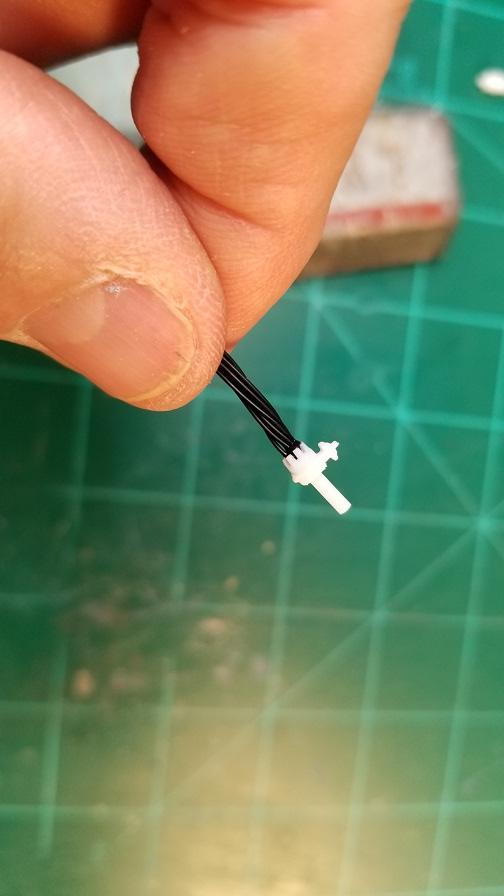

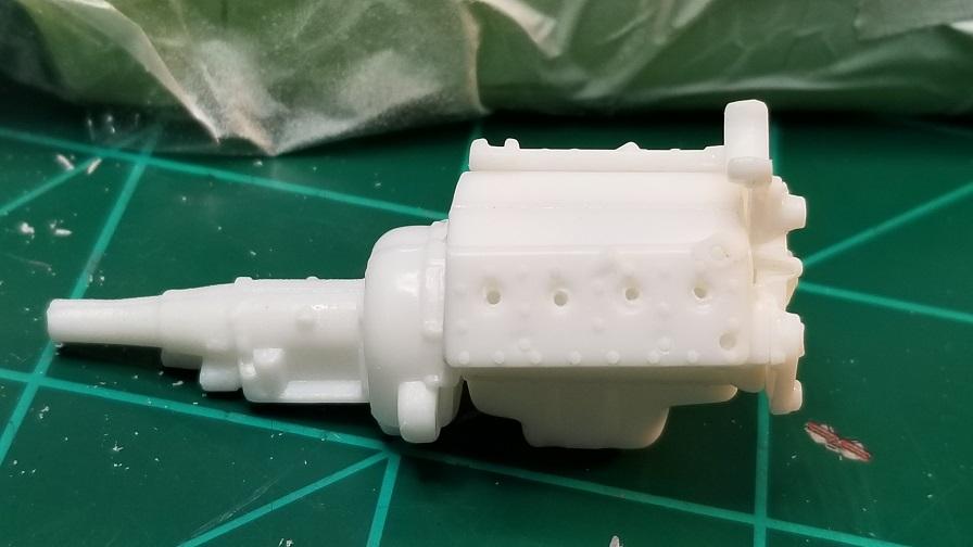

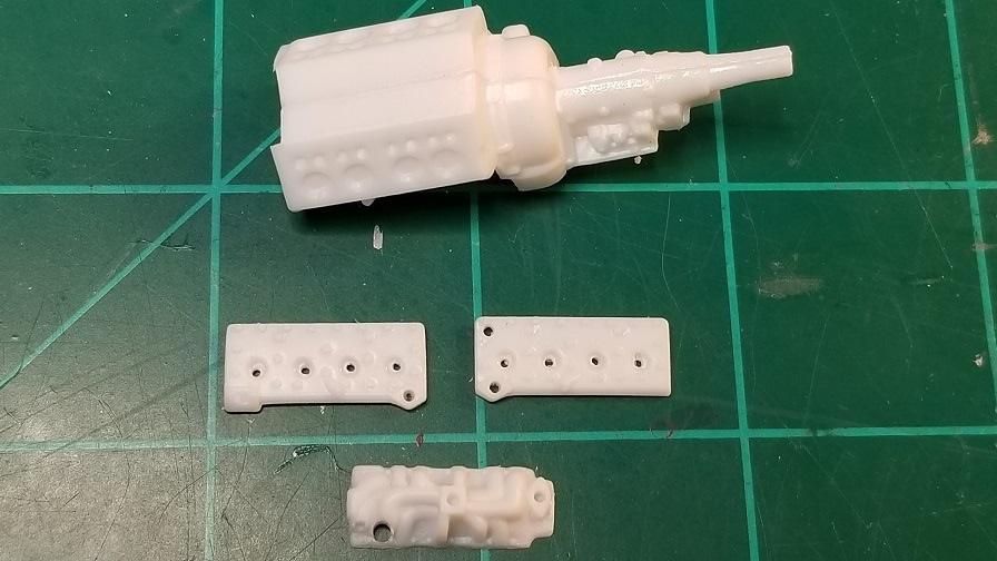

Zippi Posted January 1, 2022 Author Share Posted January 1, 2022 (edited) This year I'm going to try and slow down and produce a better looking model. Plus I'm going about things differently like trial fitting parts before paint and doing moc ups while still in the raw state. I got the holes drilled out on the heads and glued to the block and also got the distributor wired. I really don't like using Testor enamel as it seems to never dry quick enough for me and I always mess it up by not waiting long enough. Edited January 1, 2022 by Zippi Quote Link to comment Share on other sites More sharing options...
customline Posted January 1, 2022 Share Posted January 1, 2022 Bob, have you heard of "Japan Drier" ? I've never used it but maybe it's time; I've noticed lately that Testor's paint doesn't dry like it used to. It's worth a look. Quote Link to comment Share on other sites More sharing options...
