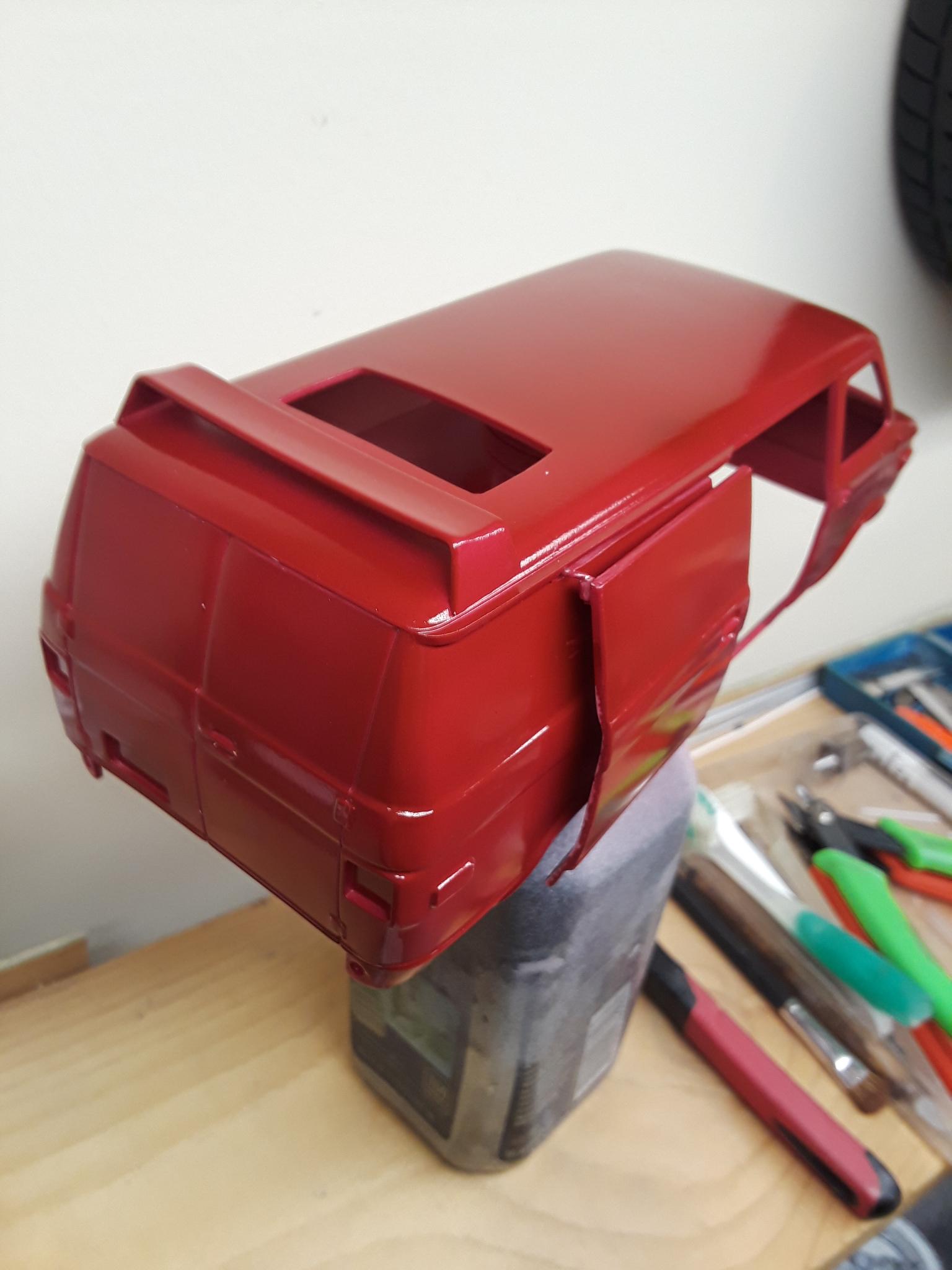

Leica007 Posted March 19, 2022 Author Share Posted March 19, 2022 With what I've seen on the forum, videos, and experience with using craft paints I wanted to get color on the body early so it would have plenty of time to cure before clear coating. Still not sure whether to use lacquer, Testor or Rust-O 2x acrylic; test shot on spoon had no adverse reaction to the base color. Anyway here are couple more pics. This after 3-4 lite coats of Anita's craft wine color with 5mm airbrush at 18lbs. Here's after 2-3 heavier coats. I noticed that red colors especially show uneven application. You can see the darker areas that need additional work (that's where the airbrush really helps). Since the frame is gloss black, I used Testor Ext Laq graphite dust on the bottom of the chassis. Engine bay is done in body color. While waiting for the body to cure, started on the interior. Using Caramel craft acrylic (over Rusto white primer) for the vinyl and metal, tan flocking for the carpeting in the cab. Made these door panels from styrofoam plate and the door pulls/door handles from 18ga craft wire; its soft so the handles could be flattened. The rings under the handles are plastic tubing cut thin. I use testor window glue on the styrofoam panels, doesn't melt the foam. Here's the snack tray made with the 18ga wire and wood from the separating tray in cigar boxes that I get from my tobacco dealer (for free) More to follow, thanks for viewing and commenting. 2 Quote Link to comment Share on other sites More sharing options...

Leica007 Posted March 23, 2022 Author Share Posted March 23, 2022 Thank you all for the positive comments. I will learn how to respond individually. It's been a rough week, and when I tried sanding the clear coat (1000/2000/6000 grits) some of the lacquer & paint came off; so I had to try to touch up and waiting for curing before reapplying the clear. Hope it works. Started in the engine and worked more on the interior. Quote Link to comment Share on other sites More sharing options...

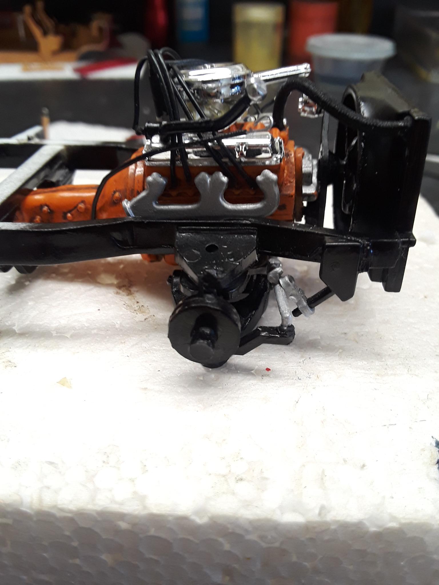

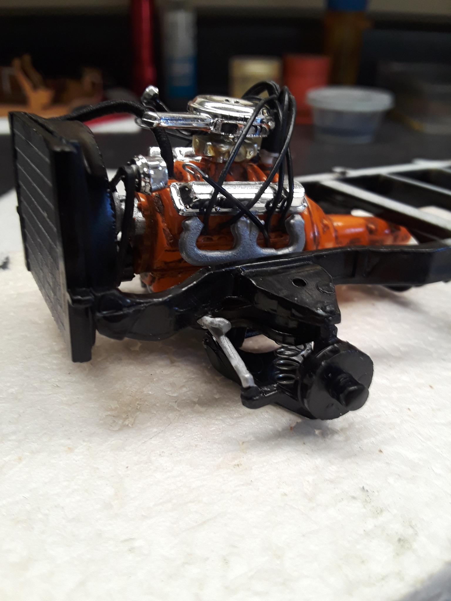

Leica007 Posted April 7, 2022 Author Share Posted April 7, 2022 Here's photos of the van after using Testor's rattle-can lacquer, before polishing. This 3 coats so I can polish, then apply some graphics. I got the engine finished, and wanted to test fit to see how the chassis fit into the body with motor in place. It looked good, so I installed and mounted the radiator and the hose. Also added the transmission/oil dipsticks. Had to make a distributor because the kit part wouldn't fit with the cleaner. This shows how little can be seen through the front. Anyway, after getting the engine, radiator & hose, and the battery installed, I decided to follow the suggestions on the instruction sheet and completed the drive train assembly which worked well. So I thought now the wheels can be mounted and I can do another test fit. That's when I ran into problems. The radiator wouldn't clear the front end, knocked it loose so had to cut the hose and take it out of the way. Then the battery was about 2mm too far off, so it had to come out (I'll put in in from the outside). I also found out the the inside front of the wheel wells need to be trimmed to clear the custom front grille shell (it fit fine during the other 2 or 3 times I did a mock up). After this, decided to concentrate on the body for awhile again. Polished the base coats of clear. I'll upload and post them tomorrow after transfer from my phone. Got a good bit done on the interior also, but need to transfer those pics too. Thanks for looking. 2 Quote Link to comment Share on other sites More sharing options...
Steve H Posted April 7, 2022 Share Posted April 7, 2022 Hi Lei, lots of nice mods and details on this build. The sliding side door is brilliant! May I ask what you used for the front springs, they look perfect. It’s frustrating when you do several mock ups and everything fits, then “suddenly” at final assembly things don’t fit… it’s happened to me. Looks like things are in good hands here, you’ll have everything fit in place. Cheers, Steve Quote Link to comment Share on other sites More sharing options...
espo Posted April 7, 2022 Share Posted April 7, 2022 I agree with Steve, your paint looks great. A shame so little of the engine will be visible when finished. Does the side door move or is it set in thew open position? Quote Link to comment Share on other sites More sharing options...
Leica007 Posted April 7, 2022 Author Share Posted April 7, 2022 6 hours ago, Steve H said: Hi Lei, lots of nice mods and details on this build. The sliding side door is brilliant! May I ask what you used for the front springs, they look perfect. It’s frustrating when you do several mock ups and everything fits, then “suddenly” at final assembly things don’t fit… it’s happened to me. Looks like things are in good hands here, you’ll have everything fit in place. Cheers, Steve Thanks for your encouragement, Steve. The springs are cut down ballpoint pen springs, I've used them on several vehicles, both as the front coils and as coilovers on shocks. The do come in various sizes, so I save them when the pens run out. Quote Link to comment Share on other sites More sharing options...
Leica007 Posted April 7, 2022 Author Share Posted April 7, 2022 6 hours ago, espo said: I agree with Steve, your paint looks great. A shame so little of the engine will be visible when finished. Does the side door move or is it set in thew open position? Hi David, thanks for following and your comments. The door will actually slide, just have to be careful, but I put a stop to keep it from fully closing. Quote Link to comment Share on other sites More sharing options...
