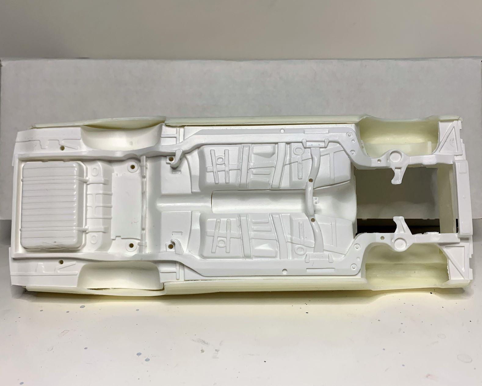

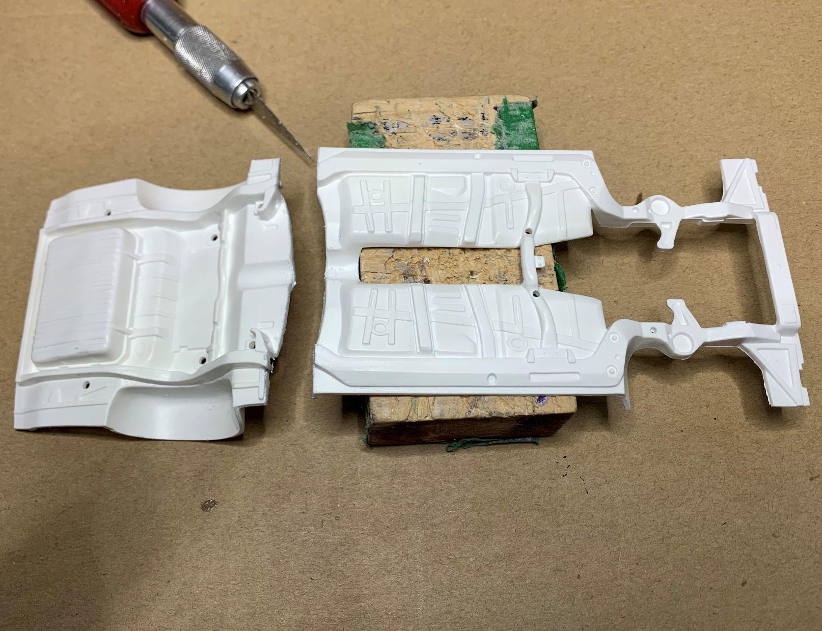

dino246gt Posted May 2, 2022 Author Share Posted May 2, 2022 The body is a re-pop of the annual AMT, from "Missing Link" The chassis is Revell's beautiful '65 kit. The wheelbase IS the same on a real car, but AMTs old kit compared to Revell's much more detailed kit have slightly different wheelbases. 1: First I removed the Revell inner fenders. 2: Then I fit the Revell chassis into the body, and saw how the inner rear fenders are too far back. 3: After cutting (picture in above post) and sanding, then building up the joining frame rails, it fits much better! I DID have to modify the back of the rear seat and the front of the wheel tubs to get the interior to sit far enough back to line up with the body, no problem though, I love doing those little mods. 1 Quote Link to comment Share on other sites More sharing options...

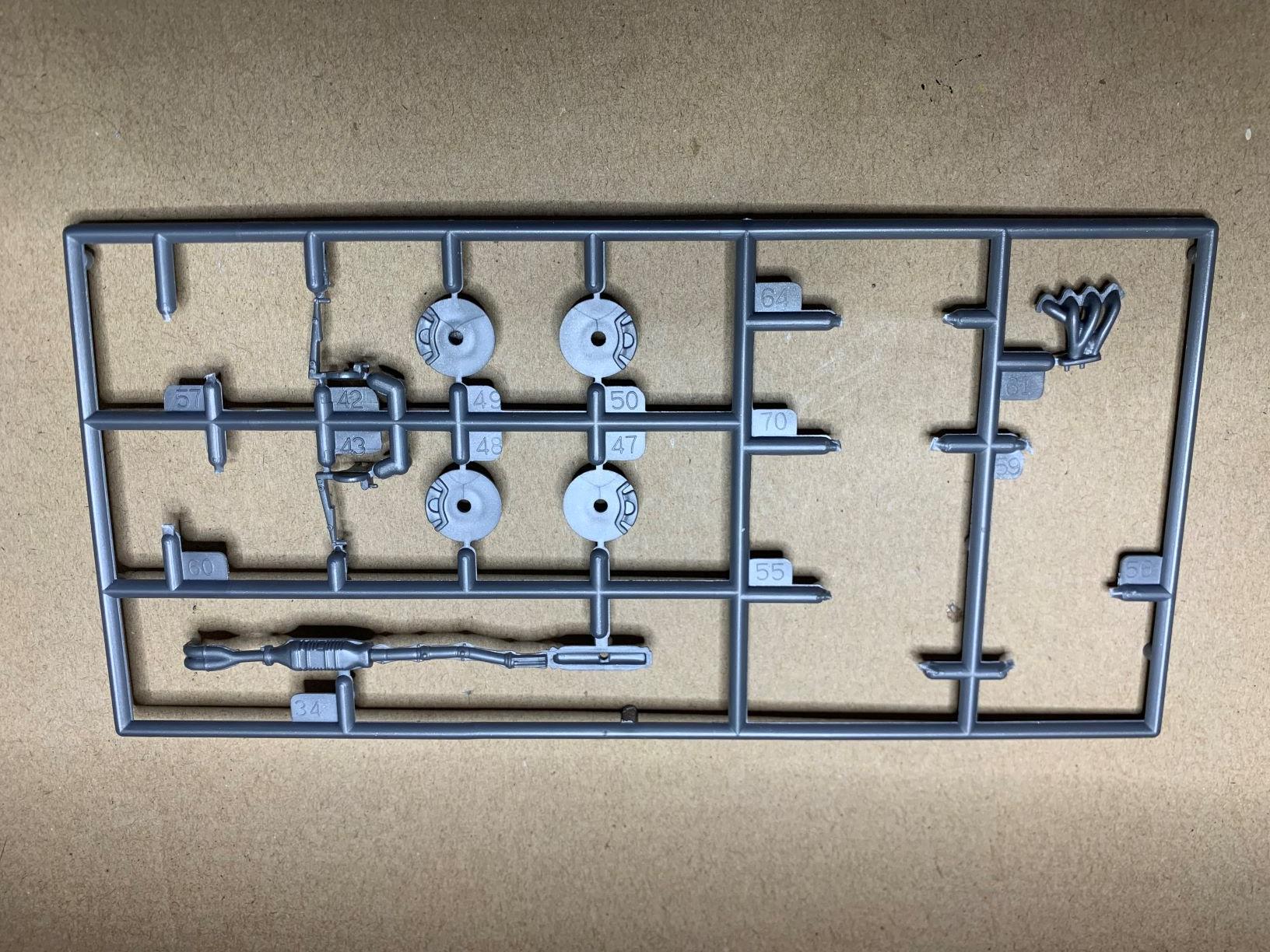

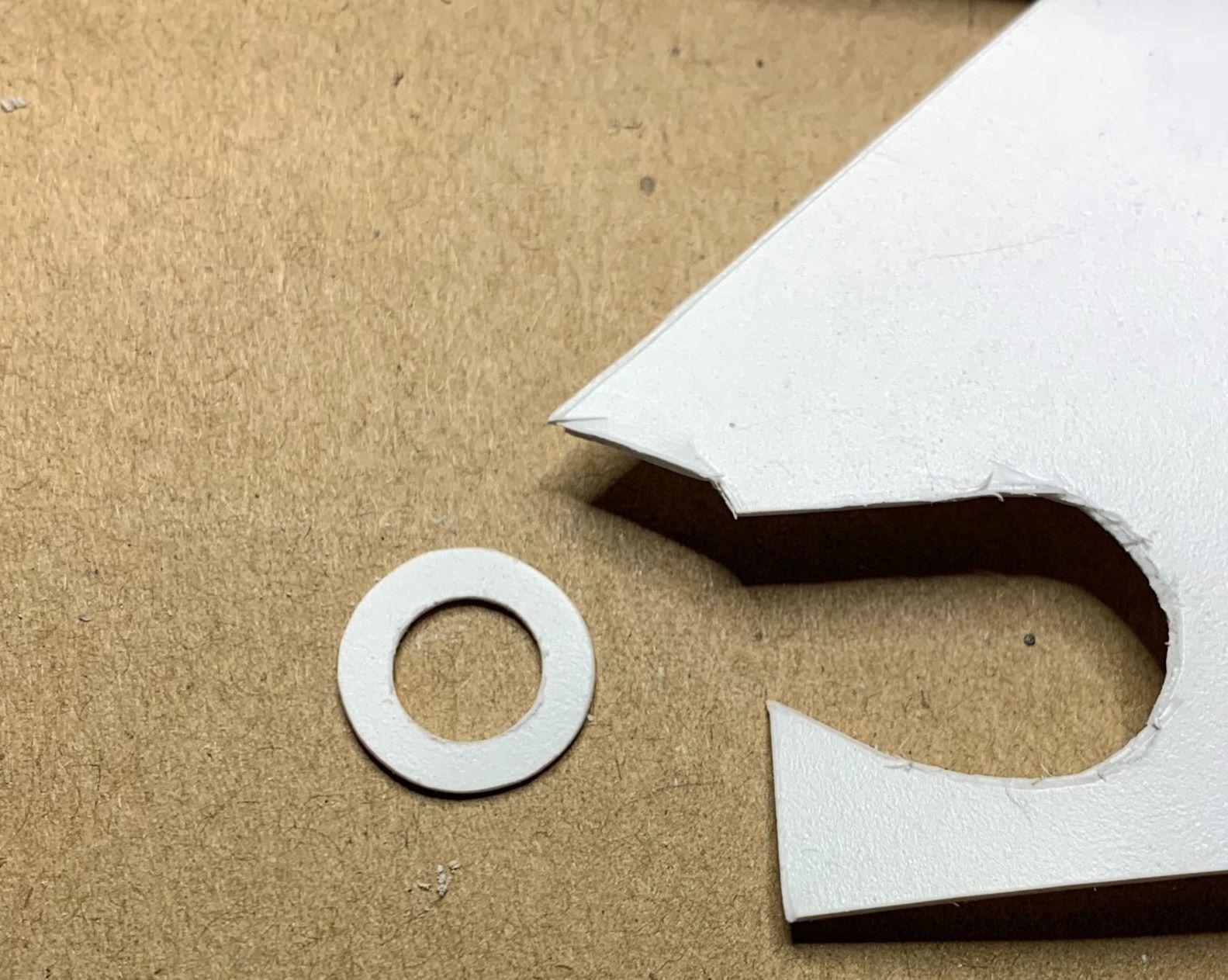

dino246gt Posted May 3, 2022 Author Share Posted May 3, 2022 On this Malibu I'll be using 15" wheels, but I want 4 wheel disc brakes! I do have a lot of cool ones, but they're for larger diameter rims, so...................... 1: I found these rotors from Revell's Acura kit. 2: I opened up the center to fit over the rims I'm using. 3: Then I snipped off all the "stuff" from the backside and sanded them smooth, flat. 4: I made ONE circle the size of a rotor from Evergreen .010 sheet styrene. 5: I cut that circle into 4 pieces. 6: Then I shaped those into somewhat of a caliper look. 7: I painted the "calipers" red, rotors silver and the wheels XF-66 light grey, all Tamiya acrylics brushed one. They're definitely not great but they'll hardly show behind the mags, so good enough and a ton of fun! 1 Quote Link to comment Share on other sites More sharing options...

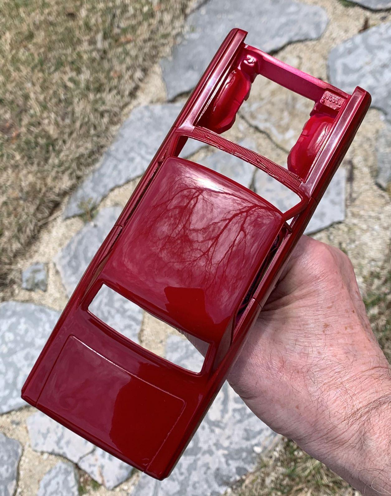

dino246gt Posted May 9, 2022 Author Share Posted May 9, 2022 Here's how the paint turned out, I'm quite pleased. These non-metallic colours are not very forgiving! I used Mr. Color "Wine Red" lacquer, thinned 50/50 and cleared with Mr. Hobby "UV-cut clear" 2 Quote Link to comment Share on other sites More sharing options...

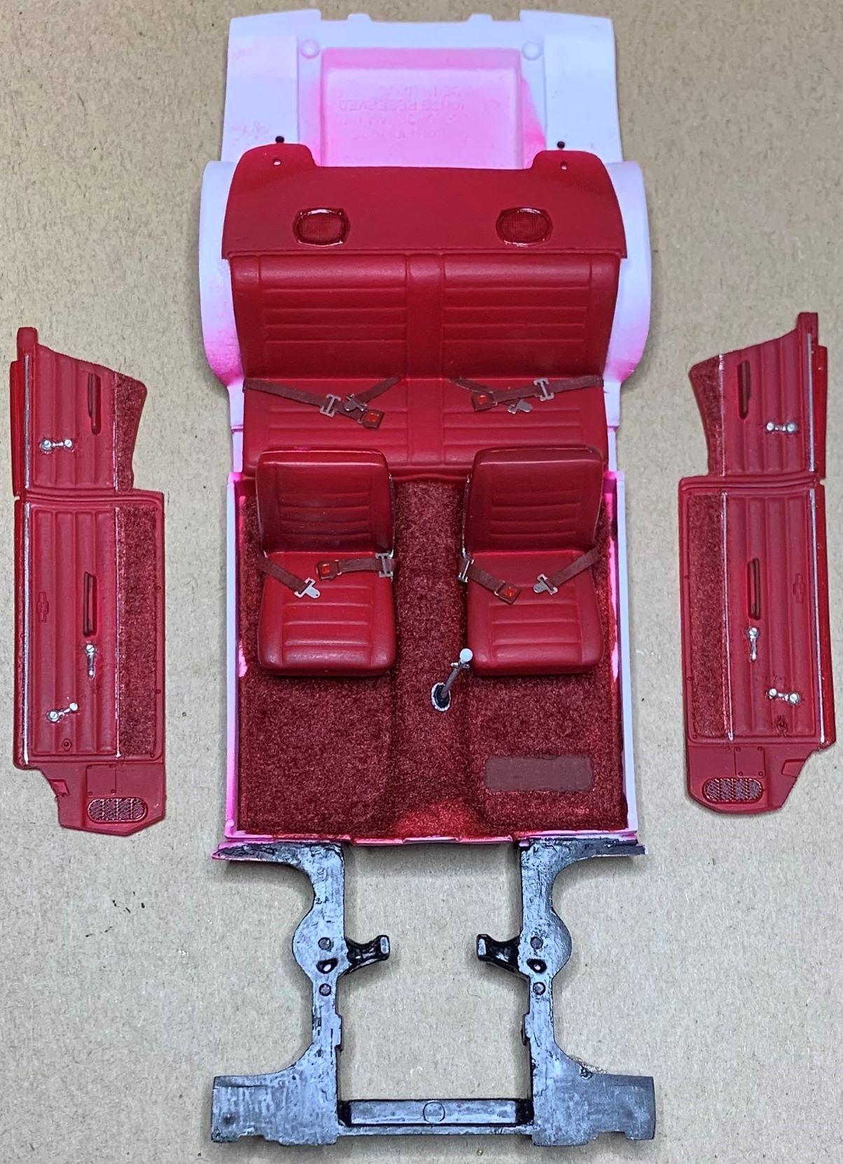

dino246gt Posted May 13, 2022 Author Share Posted May 13, 2022 I'm using the excellent Revell '65 Chevelle interior, with the original '64 dashboard. 1: The Revell kit does have rear quarter "glass" so the interior side panels are too short for me. 2: I wont have rear quarter glass so I added a bit o styrene. 3: I've decided to match the interior to the exterior as was common back then, so here's where it's at so far, cheers! 4 Quote Link to comment Share on other sites More sharing options...
