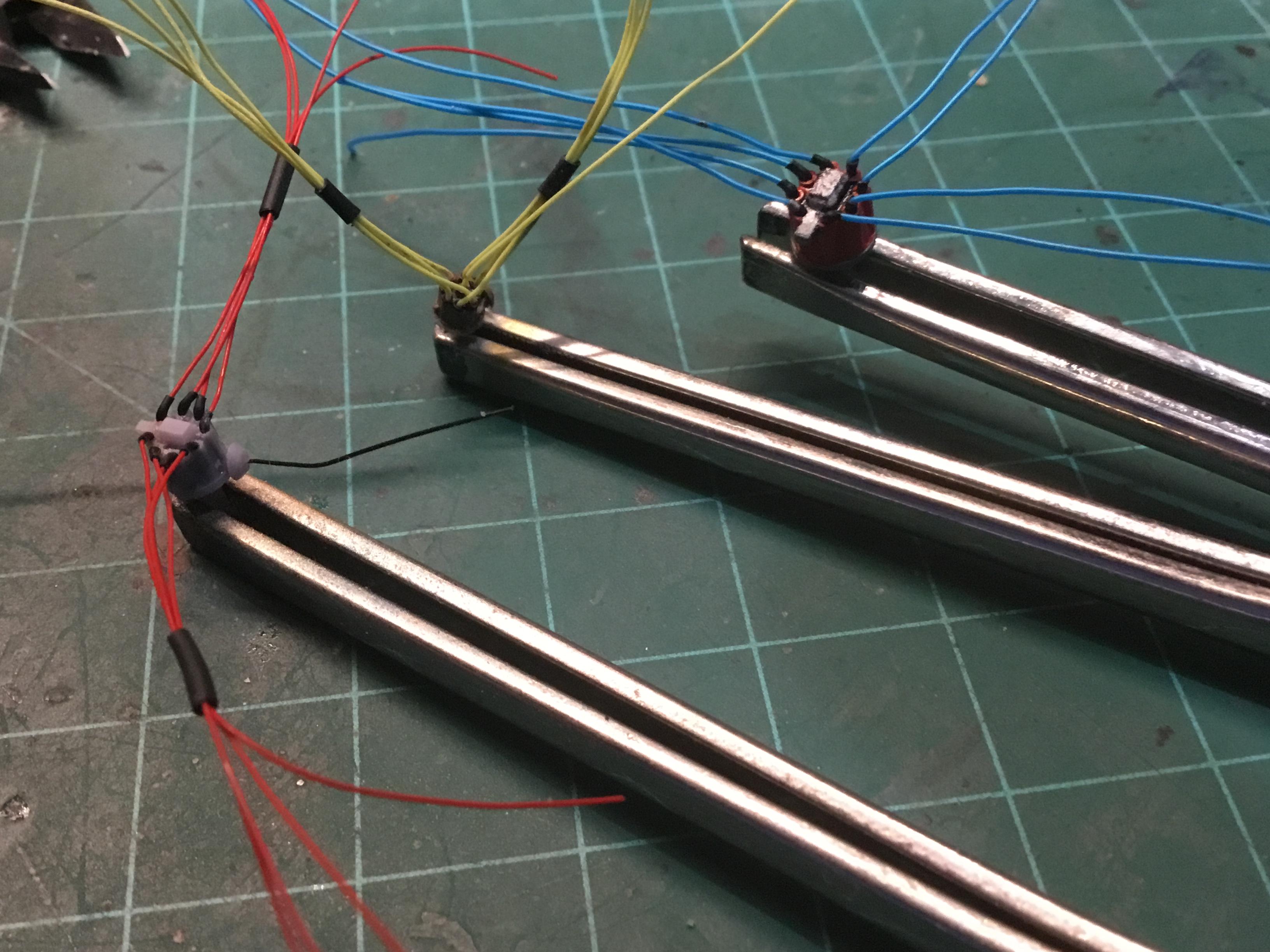

Jiml0001 Posted October 9, 2022 Posted October 9, 2022 Be careful. The AWG rating refers to the size of the conductor not the outside diameter. I have found the same AWG rated wire in three different outside diameters. If you are looking for true scale then you want .25 mm outside diameter for 1/4 inch plug wires and .40 mm for 3/8 high tension wire but again look at the outside diameter not the AWG number
Jiml0001 Posted October 9, 2022 Posted October 9, 2022 I got some .38 mm outside diameter wire on eBay. Many colors to pick from. $5.00 plus shipping for 10 meters (over30 feet) of wire. In 1/24 scale that is almost exactly 3/8 of an inch in scale. I use this size for HEI ignition wires 1
Jiml0001 Posted October 9, 2022 Posted October 9, 2022 Search for UL10064 Ultra-Fine Electronic Wire 0.38MM High Temp Hook Up Wire
Jiml0001 Posted October 9, 2022 Posted October 9, 2022 For .25 mm wire search for 10 meters 7/0.05 ultra slim Dia. 0.28mm 0.011" super thin cable Wires Red again many colors and also $5.00 plus shipping for 10 meters of wire. In 1/24 scale this is 1/4 inch in scale. I use this for standard ignition wires
Jiml0001 Posted October 9, 2022 Posted October 9, 2022 Another thing I found is that wire using Teflon insulation is not opaque. It is translucent and I couldn’t find any paint that would stick to it
Jiml0001 Posted October 9, 2022 Posted October 9, 2022 (edited) Here are some different sizes. The red wire on the hei distributor is .4 mm and scales to 3/8 inch in 1/24 scale. The yellow is .25 mm. And represents 1/4 inch plug wire The blue wire is a half mm and scales out to a half inch in 1/24 scale This is the size most detail vendors sell for plug wire I think it is just too big Edited October 9, 2022 by Jiml0001 2

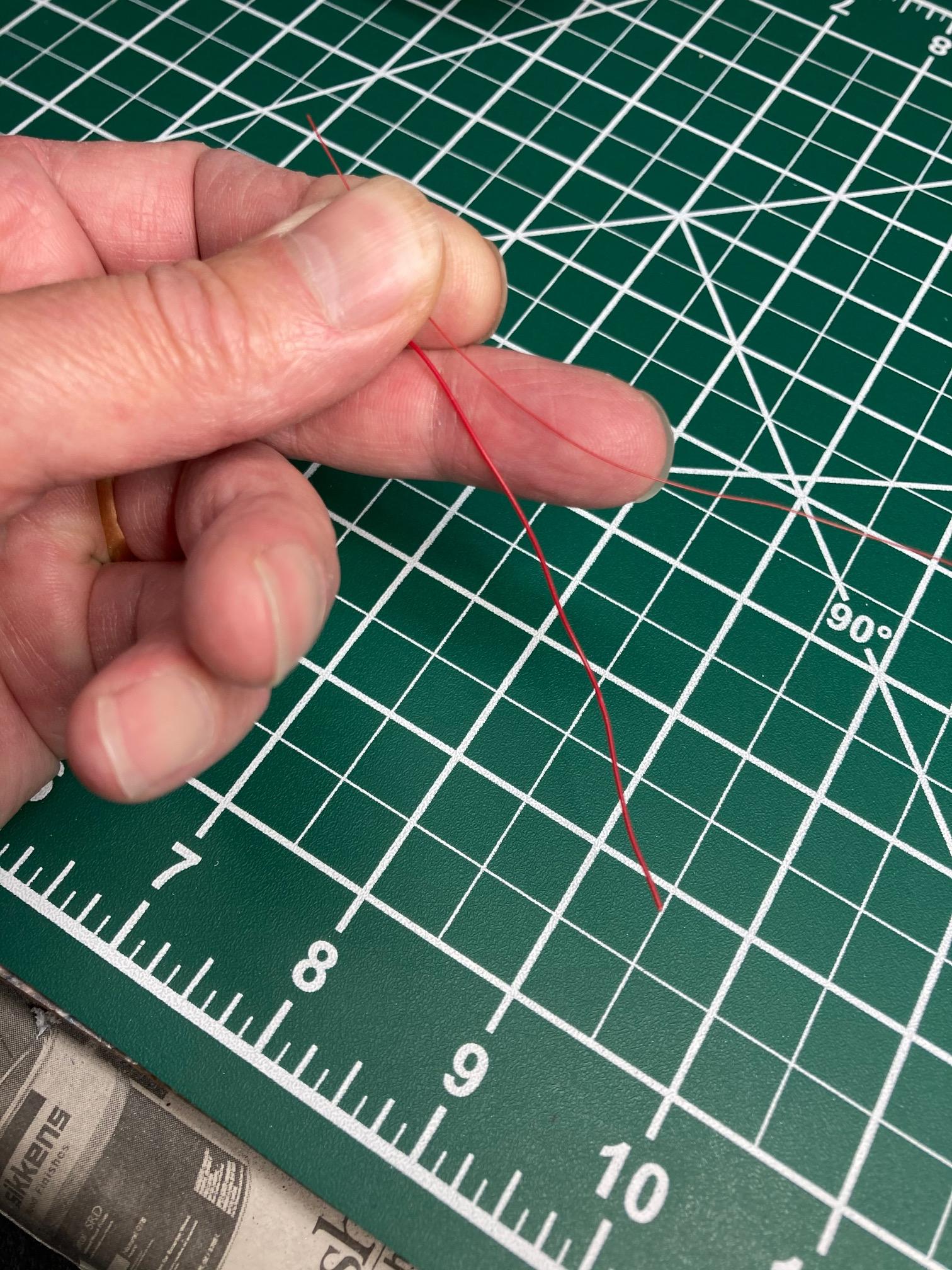

StevenGuthmiller Posted October 23, 2022 Posted October 23, 2022 In case anyone is interested, I just received my package from eBay (China) A couple of packages of the 36 AWG that Theo was asking about, and that Tommy Logan had posted a link for. I'm happy with it. Should work great for small details. The photo shows the 36 AWG wire next to a piece of 30 AWG "wrapping wire", which is close to the size that most would use for plug wires. Steve 1
Theo Posted October 24, 2022 Author Posted October 24, 2022 HI Steve Thanks for the visual comparison. It is very helpful. Theo

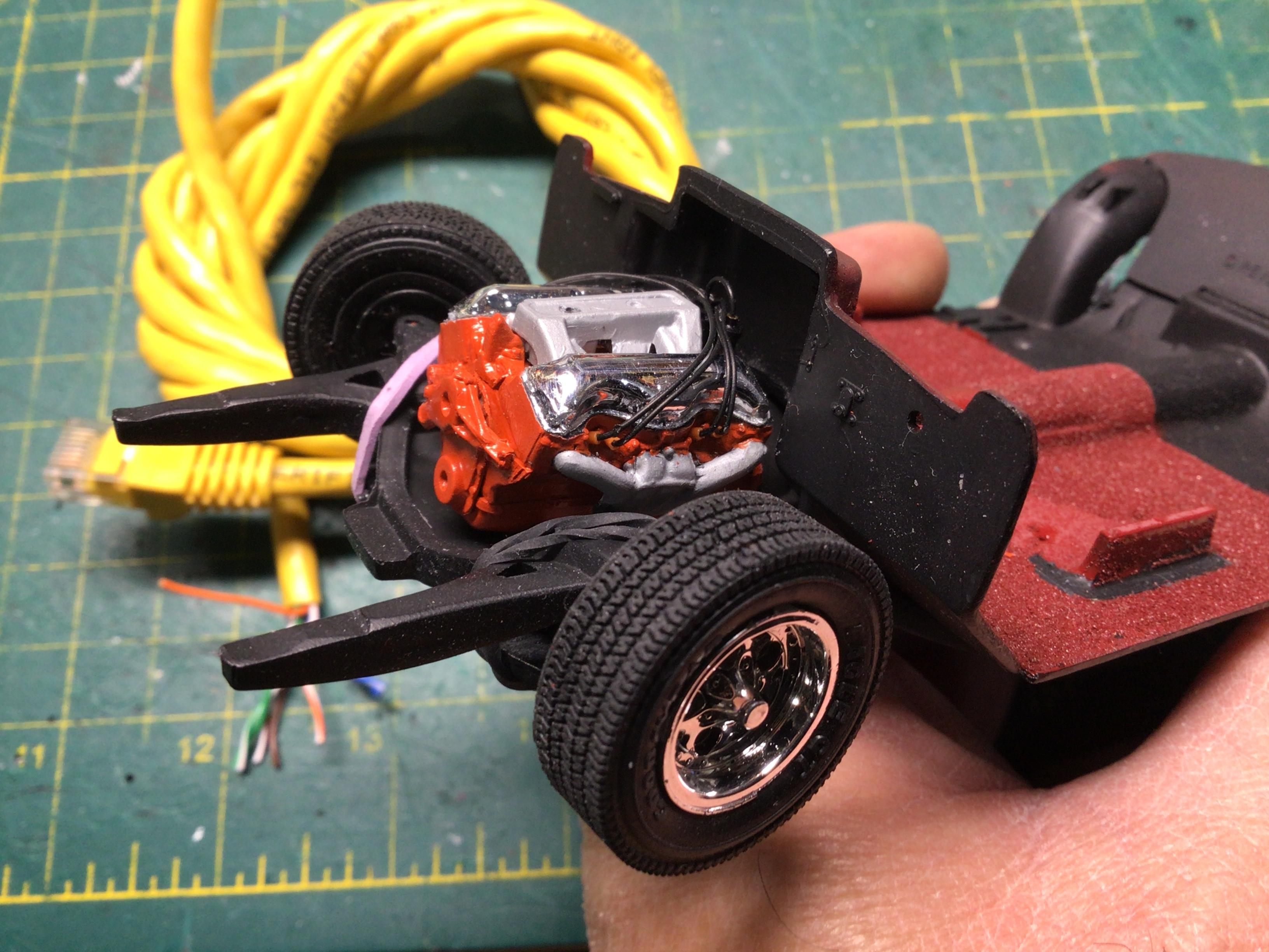

Oldcarfan27 Posted November 4, 2022 Posted November 4, 2022 Has anyone ever used phone wire with the insulation stripped off and bits of the insulation used as the boots? Painted of course.
Mike 1017 Posted November 7, 2022 Posted November 7, 2022 Yes. phone wires, USB cords, anything electronic related. Mike
NOBLNG Posted November 7, 2022 Posted November 7, 2022 On 11/4/2022 at 3:46 PM, Oldcarfan27 said: Has anyone ever used phone wire with the insulation stripped off and bits of the insulation used as the boots? Painted of course. I used the insulation off the orange wire from this cat 5 cable for plug boots, and 30 gage wrapping wire for plug wires. 1
