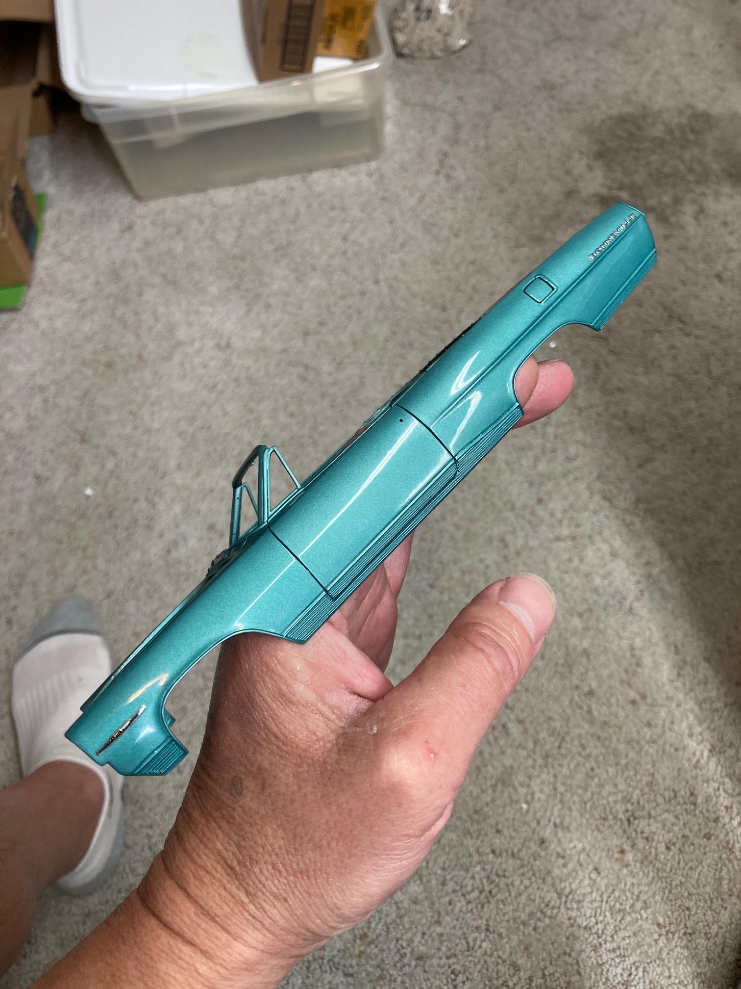

StevenGuthmiller Posted November 3, 2022 Share Posted November 3, 2022 4 hours ago, Bainford said: Sometimes, with good panel scribing, no additional accent is needed at all. 4 hours ago, LL3 Model Worx said: Yup. Just scribe the lines good and deep and like you say... less is more in most cases. Worked pretty well on my latest project. Steve Quote Link to comment Share on other sites More sharing options...
LL3 Model Worx Posted November 3, 2022 Share Posted November 3, 2022 2 hours ago, StevenGuthmiller said: Worked pretty well on my latest project. Steve Indeed Sir, looks fantastic! Quote Link to comment Share on other sites More sharing options...

Bainford Posted November 3, 2022 Share Posted November 3, 2022 10 hours ago, StevenGuthmiller said: Steve Nice corners. Quote Link to comment Share on other sites More sharing options...
