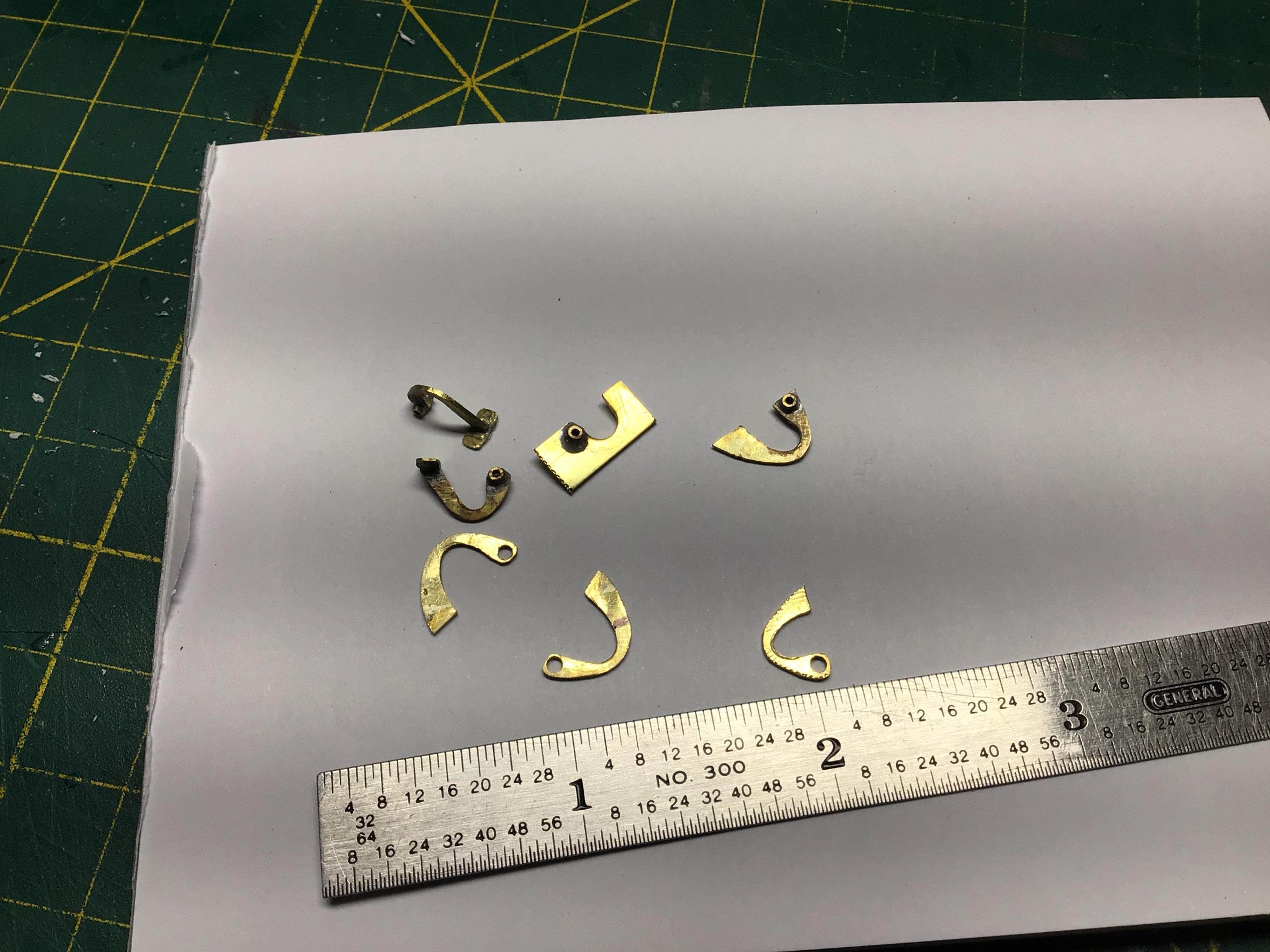

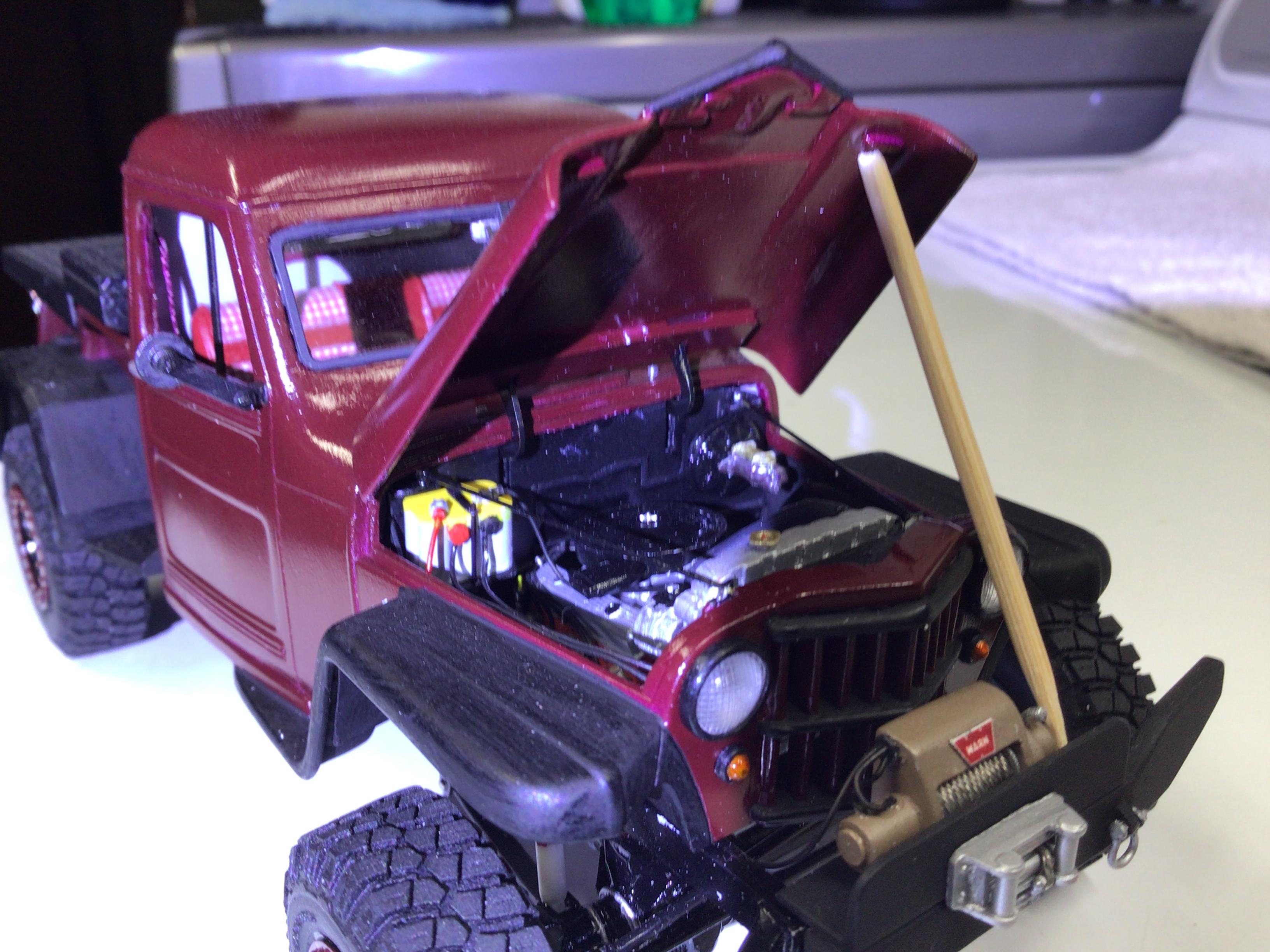

NOBLNG Posted December 3, 2022 Posted December 3, 2022 (edited) This might be more like what you want? I made these for my Willys from .025” brass and 1/16” o.d. tubing. FYI, K&S also has 1mm (.039”) and .032” o.d. tubing. Edited December 3, 2022 by NOBLNG 2 Quote
Fat Brian Posted December 3, 2022 Author Posted December 3, 2022 3 hours ago, NOBLNG said: This might be more like what you want? I made these for my Willys from .025” brass and 1/16” o.d. tubing. FYI, K&S also has 1mm (.039”) and .032” o.d. tubing. Yeah, that's more what I was looking to do. The main reason I don't like the round rod hinges is that there's no good way to mount the part to the rods. It just seems like flat stock would look more realistic like a stamped part. Quote

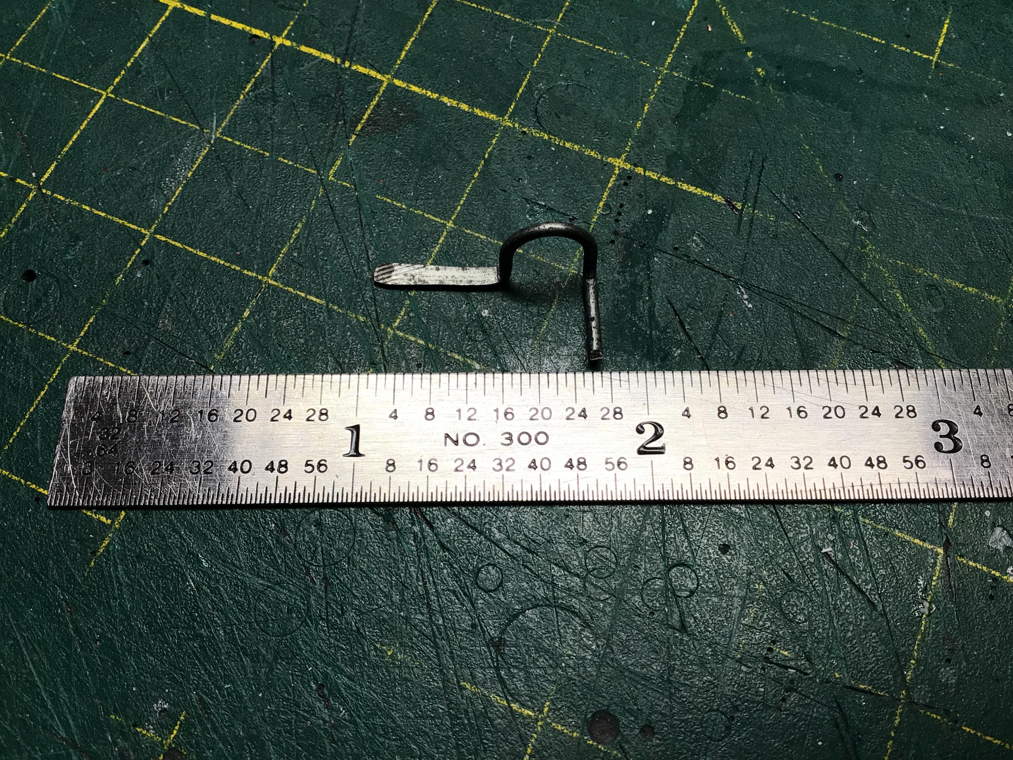

Fat Brian Posted December 6, 2022 Author Posted December 6, 2022 5 hours ago, peteski said: Can you give an example of the specific hinge you are making (or the vehicle that uses it)? I have a hard time picturing exactly what you want to do. Will the hinges be functional or just for looks? Vintage cars with side-opening hoods used long piano-type hinges, and the hinges like used on that Willys kit are either cut from flat sheet stock (or formed from bent wire), not from thin strips. Here's the hinge I made. I would just prefer flat stock so it has better mounting surfaces for the lid. Quote
NOBLNG Posted December 6, 2022 Posted December 6, 2022 (edited) 4 hours ago, Fat Brian said: Here's the hinge I made. I would just prefer flat stock so it has better mounting surfaces for the lid. Do you have a bench vise? You could possibly squash that wire with it, or maybe even flatten it with a small hammer? Alternately you could drill a small chunk of styrene stock to accept the wire and mount it to the trunk lid. Edited December 7, 2022 by NOBLNG Quote
Fat Brian Posted December 6, 2022 Author Posted December 6, 2022 21 minutes ago, NOBLNG said: Do you have a bench vise? You could possibly squash that wire with it, or maybe even flatten it with a small hammer? Alternately you could drill a small chuck of styrene stock to accept the wire and mount it to the trunk lid. Hammering the end flat is an interesting option. I was going to try to hide it in a piece of styrene that could be bracing for the underside of the trunk lid Quote

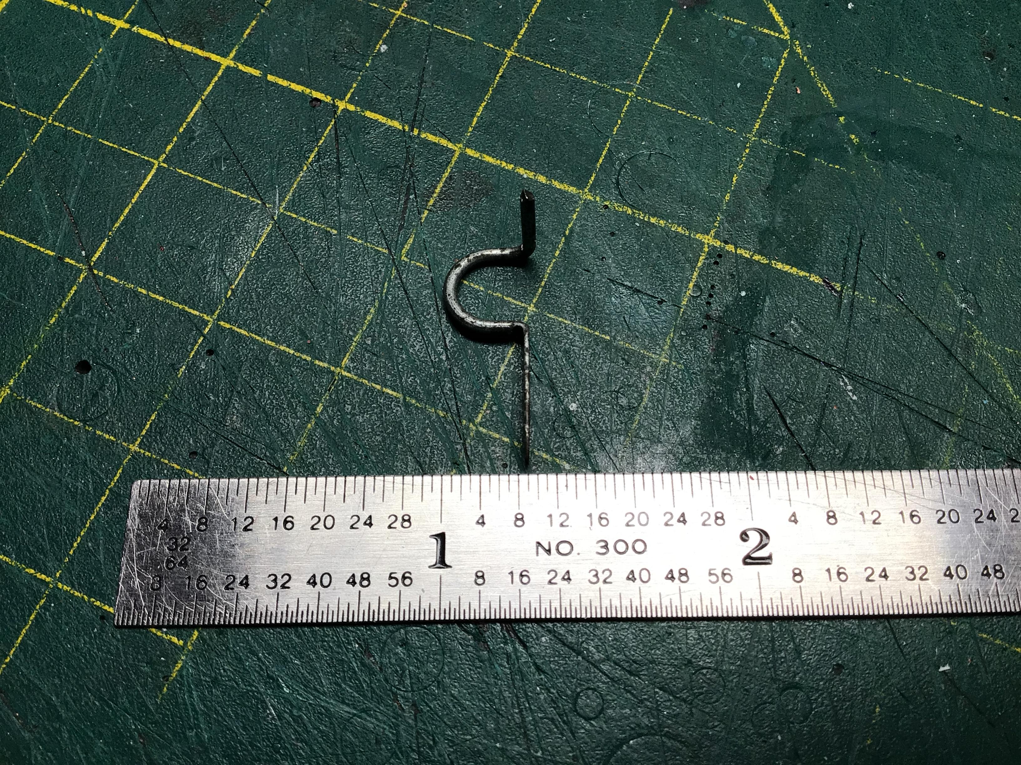

NOBLNG Posted December 7, 2022 Posted December 7, 2022 (edited) That should work. This is some .048” soft steel wire that I just did a quick test on. Edited December 7, 2022 by NOBLNG Quote
Fat Brian Posted December 7, 2022 Author Posted December 7, 2022 15 minutes ago, NOBLNG said: That should work. This is some .048” soft steel wire that I just did a quick test on. Wow, that looks much better. I'll have to do that. Thank you for suggesting that. Quote

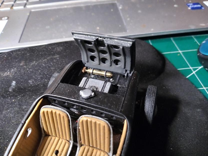

Jon Haigwood Posted December 8, 2022 Posted December 8, 2022 Not exactly what you were looking for but may be helpful. I wanted the trunk to open like a Rumble seat and hide the hinge. Used square brass tube and used it for part of the inner trunk support. Used metal wire and inserted the ends into the trunk floor in small round tubes. I took a lot of trial and error to get it to open and close right. The trunk also opens with the bottom going inside of the body. 1 Quote

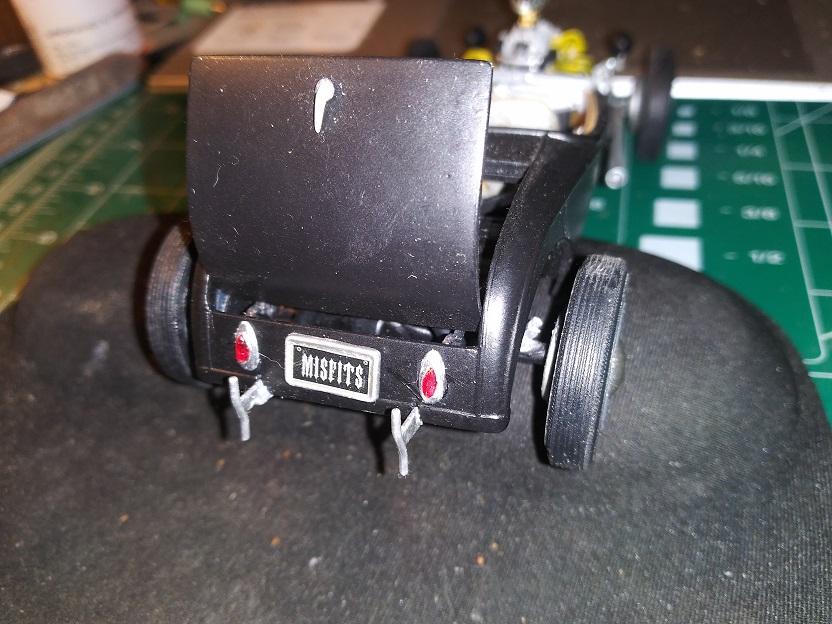

Fat Brian Posted December 8, 2022 Author Posted December 8, 2022 2 hours ago, Jon Haigwood said: Not exactly what you were looking for but may be helpful. I wanted the trunk to open like a Rumble seat and hide the hinge. Used square brass tube and used it for part of the inner trunk support. Used metal wire and inserted the ends into the trunk floor in small round tubes. I took a lot of trial and error to get it to open and close right. The trunk also opens with the bottom going inside of the body. I started to hinge it that way because I cut it open without thinking the roadster would have a rumble seat instead of a trunk. I went ahead and did it the normal way just to get on to the next step. 1 Quote
