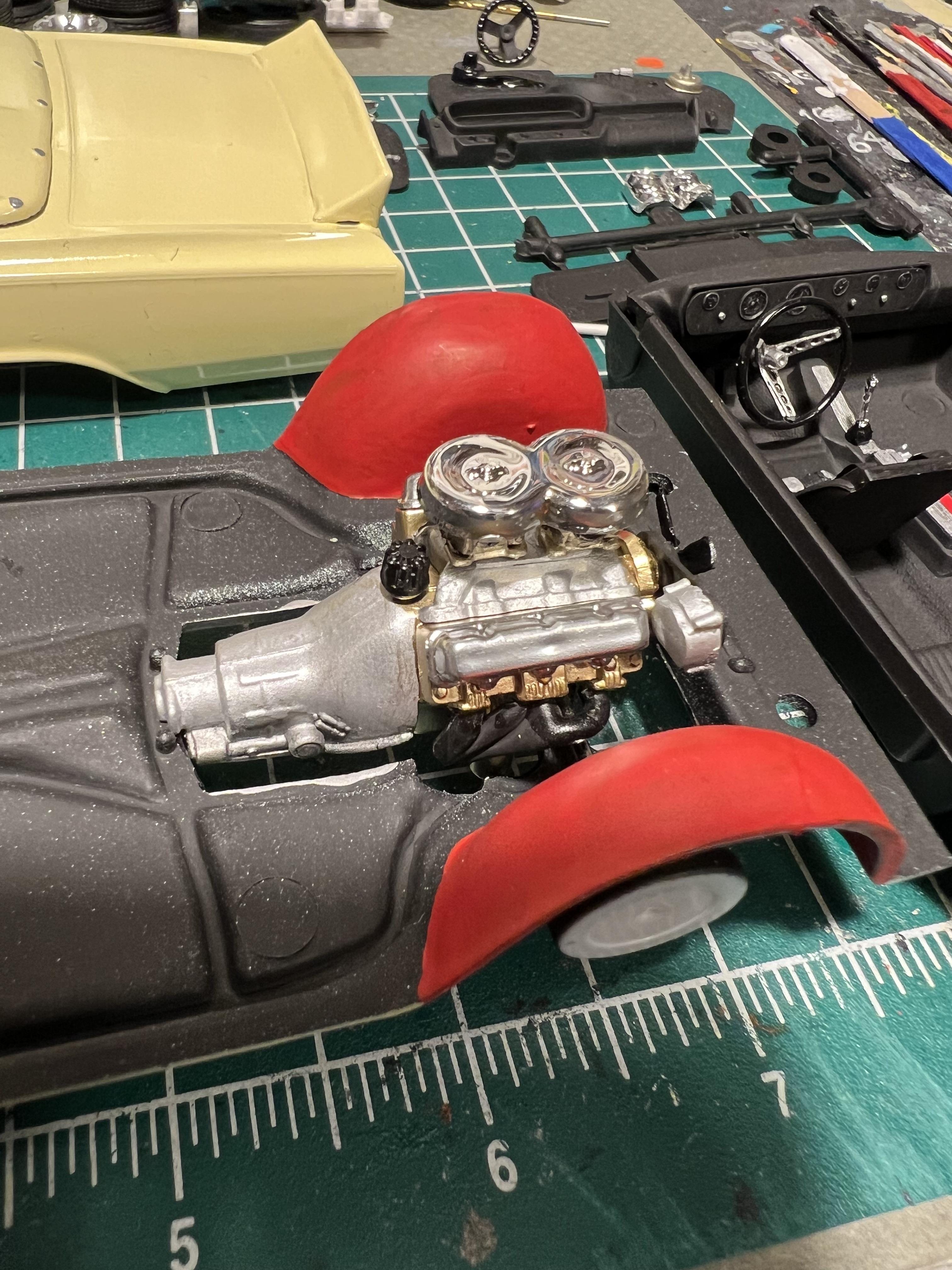

br67 Posted December 15, 2022 Share Posted December 15, 2022 Hi was this ever available in 1/25 scale? Looking to use one on a ‘65 Olds 442 Quote Link to comment Share on other sites More sharing options...
Oldcarfan27 Posted December 15, 2022 Share Posted December 15, 2022 What transmission is in the 64 Olds F85? Quote Link to comment Share on other sites More sharing options...
br67 Posted December 15, 2022 Author Share Posted December 15, 2022 3 hours ago, Oldcarfan27 said: What transmission is in the 64 Olds F85? Looks to be a bit of a blob? Could it be a Jetaway? Quote Link to comment Share on other sites More sharing options...
Ace-Garageguy Posted December 15, 2022 Share Posted December 15, 2022 (edited) 2 hours ago, br67 said: Looks to be a bit of a blob? Could it be a Jetaway? Looks similar, with the big servo in the right place, same overall shape, but the model is missing the tailshaft housing... Known as "Super Turbine 300", it came only with the BOP bolt pattern, so don't bother looking in Chevy kits. Here's the other side: Edited December 15, 2022 by Ace-Garageguy Quote Link to comment Share on other sites More sharing options...
br67 Posted December 15, 2022 Author Share Posted December 15, 2022 (edited) 2 hours ago, Ace-Garageguy said: Looks similar, with the big servo in the right place, same overall shape, but the model is missing the tailshaft housing... Known as "Super Turbine 300", it came only with the BOP bolt pattern, so don't bother looking in Chevy kits. Here's the other side: Thank you Edited December 15, 2022 by br67 Spelling Quote Link to comment Share on other sites More sharing options...
Mark Posted December 15, 2022 Share Posted December 15, 2022 A lot of older annual kits have the transmission tailshaft molded as part of the chassis. That goes back to their origins as dealer promos. Scratch a tailshaft and add it to the kit transmission...problem solved. Quote Link to comment Share on other sites More sharing options...
blizzy63 Posted December 15, 2022 Share Posted December 15, 2022 (edited) 1 hour ago, Mark said: A lot of older annual kits have the transmission tailshaft molded as part of the chassis. That goes back to their origins as dealer promos. Scratch a tailshaft and add it to the kit transmission...problem solved. Stumpy trans...but for a reason. Typical engine-chassis arrangement on AMT annual kits of this period (including the steel axle through the engine block). Edited December 15, 2022 by blizzy63 Quote Link to comment Share on other sites More sharing options...
