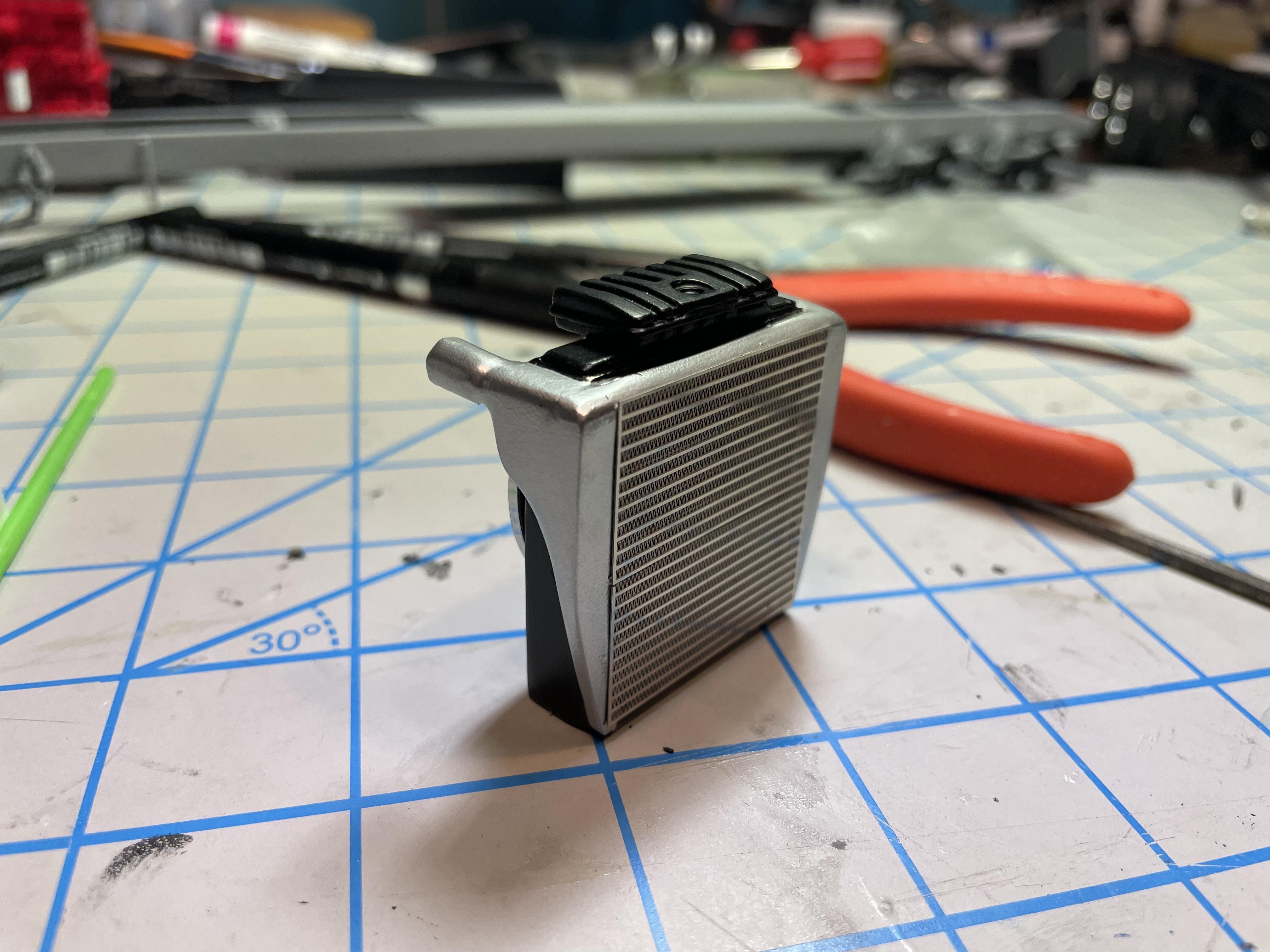

For example, the Cummins NTA 370 in the T600A could, and should, be updated to an N14. I think the parts would be fairly easy to print. There’s a great Car Modeller article by Ken Smith on the update: https://public.fotki.com/modeltrucks25thscale/model_magazine_articles/car_modeller/cm21_sept_1993_conv/
The Italeri “wanna-be” N14 (Aeromax, FLD 120, LTL 9000) should also be corrected in a very similar manner to the AMT NTA 370.
As it was said, updated aftercoolers for each of the Cummins 855 series (Big Cam I, II, III, IV) and Cat 3406 series (3406b) would also be a great idea. The Cat engines could use an accurate Jacket Water Aftercooler (JWAC). It would allow us to more easily model a specific engine in each series that’s accurate for the year of the truck we’re building.

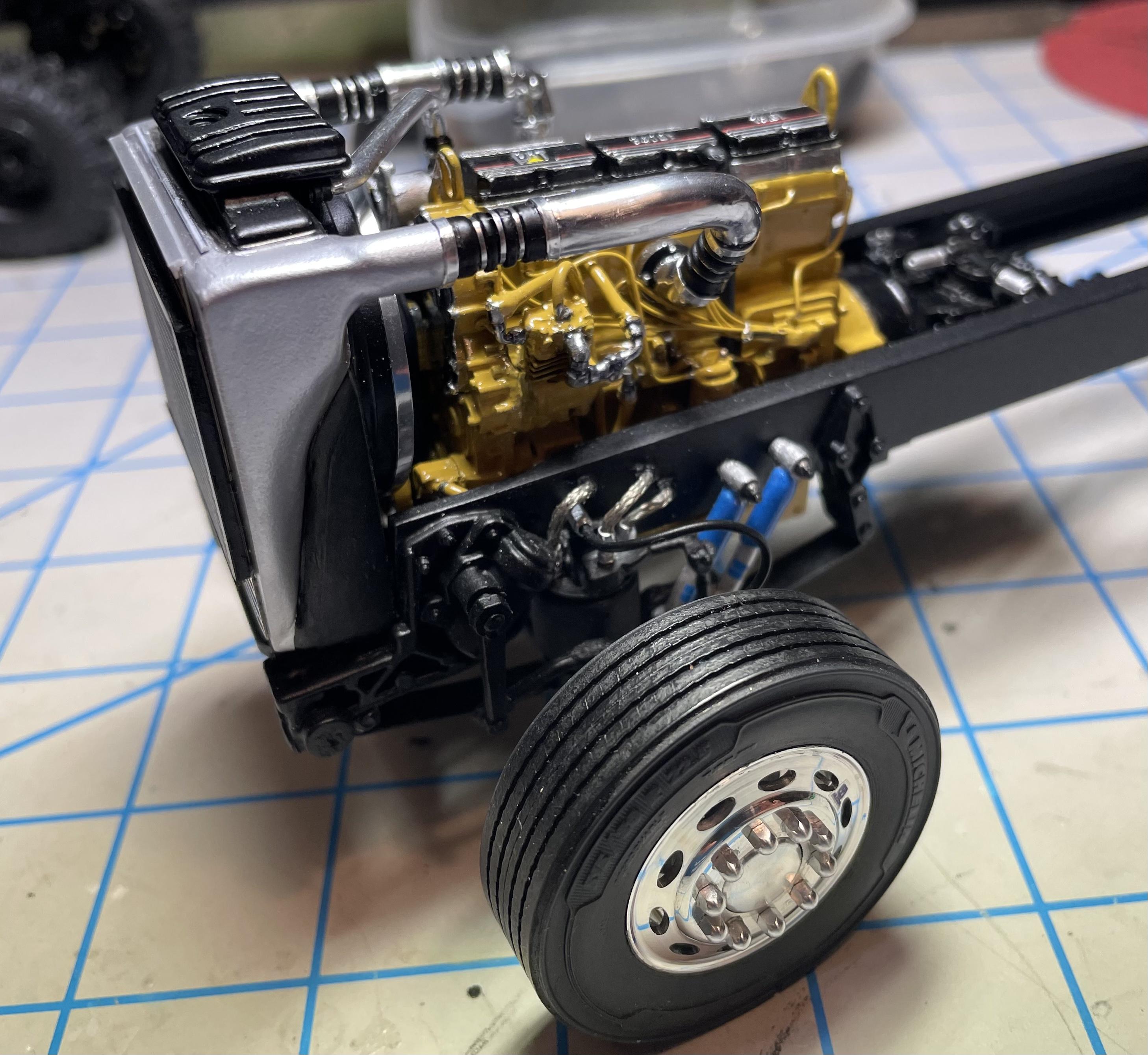

One last thing, for the modern resin engines out there, like Moluminum’s 3406E and C15 (and if you make the updated parts for turning the AMT and Italeri Cummins into an N14), we need a proper Charge Air Cooler (Air to Air Aftercooler). Even the 3406b engine started getting an Air to Air Aftercooler added starting about 1985/86 replacing the JWAC system. The 3406c had the  ATA aftercooler, too.
No one, to my knowledge, has made an accurate ATA/Charge Air Cooler, in resin or 3d. Italeri made a half-hearted attempt with their Series 60, and I used it as a base when I scratch built this one for my 3406E that’s currently on the bench. I modeled it after an aftermarket CAC by Dura-Lite.

8 hours ago, vincen47 said:
I think the idea of having parts to update the outdated engines is a fantastic idea.
Many kits have an engine that’s too old for the truck, but with some modification, they can be made accurate.
Thanks!!!
