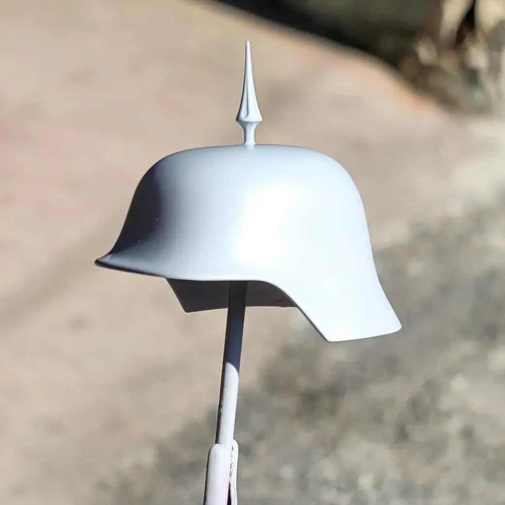

Katsusauce Posted January 19, 2023 Author Posted January 19, 2023 Stripped damaged box stock chrome plating with SuperClean. Sanded so everything has something to bite.
Katsusauce Posted January 19, 2023 Author Posted January 19, 2023 Primed. I used Splash Paints light grey surfacer.

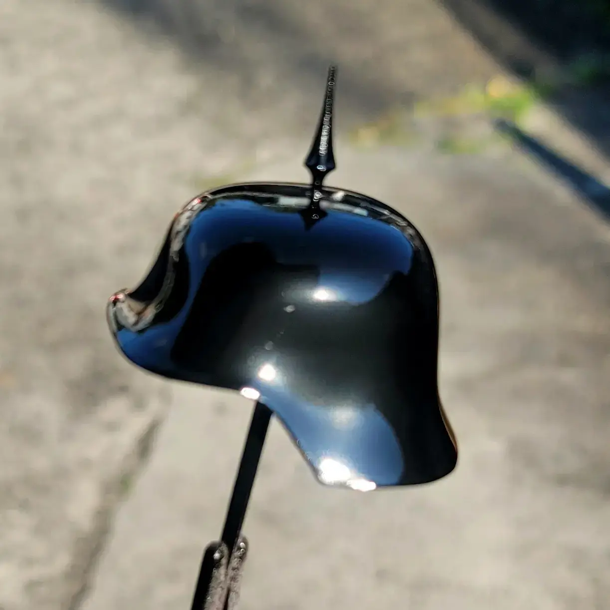

Katsusauce Posted January 19, 2023 Author Posted January 19, 2023 Base coat. I used Tropical Glitz "Abyss Black"
Katsusauce Posted January 19, 2023 Author Posted January 19, 2023 Topped the base with Splash Paints 2k Clear.

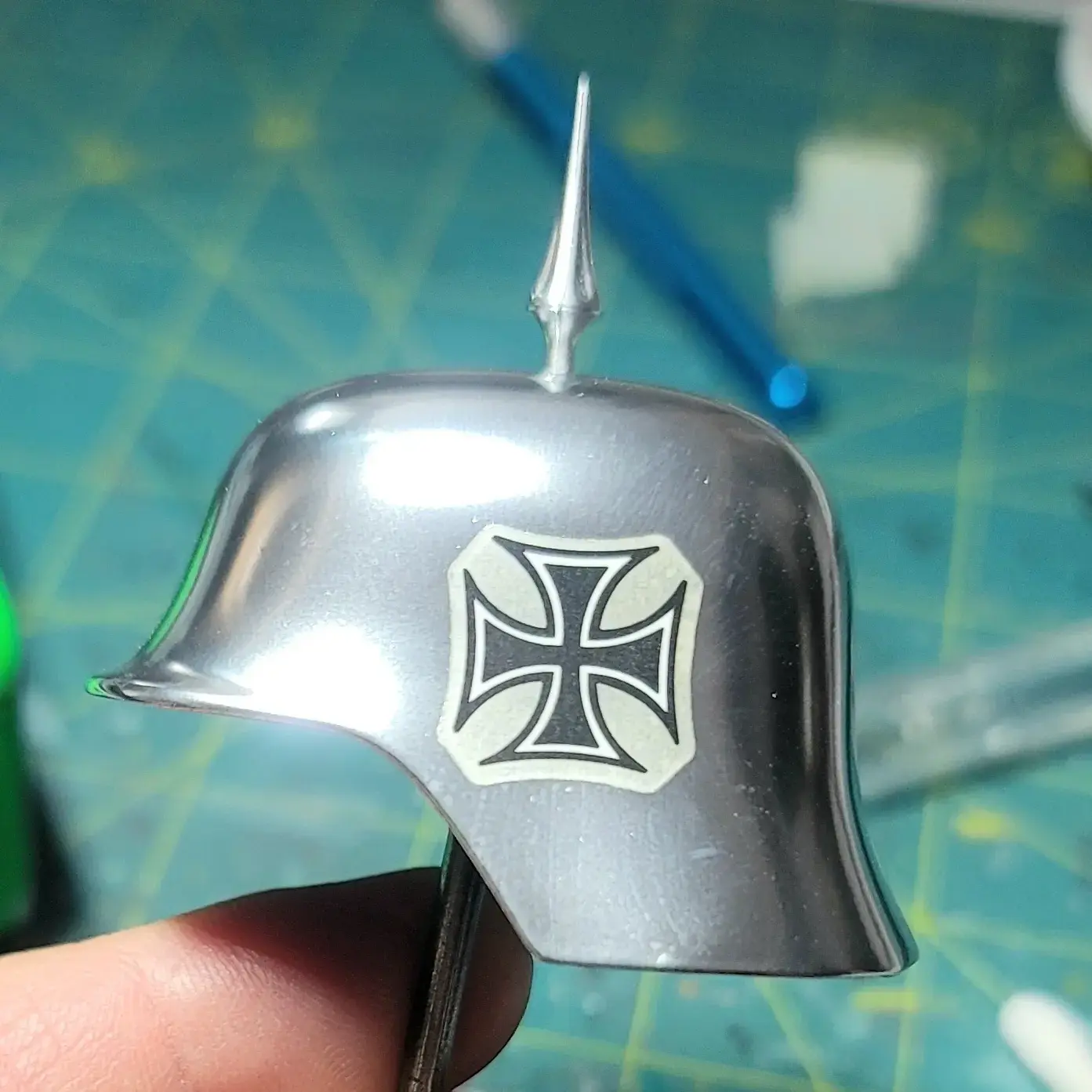

Katsusauce Posted January 19, 2023 Author Posted January 19, 2023 Four light coats of SMS HyperChrome shot at 13psi. Let dry overnight, and buffed off the excess pigment (dry spray) and cleared with Alclad II Aqua Clear. The decal looks crappy because it's like 26 years old! ? Yeah, I should have printed new ones....but it's too late now.....LoL
Shark Posted January 20, 2023 Posted January 20, 2023 Not familiar with this product, where do you get it? I have had good and bad results with other chrome products and like your outcome. 1

Katsusauce Posted January 20, 2023 Author Posted January 20, 2023 3 hours ago, Shark said: Not familiar with this product, where do you get it? I have had good and bad results with other chrome products and like your outcome. Thanks, I got it here..... https://icemancollections.com/products/hyperchrome-chrome-cold-tone-airbrush-ready-by-sms?_pos=1&_psq=sms&_ss=e&_v=1.0 Got to make sure your base is absolutely glossy for best results. 1

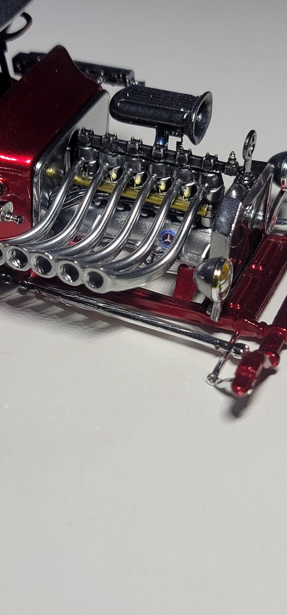

Katsusauce Posted January 25, 2023 Author Posted January 25, 2023 Everything that is chrome in this pic I painted with SMS..... 1
