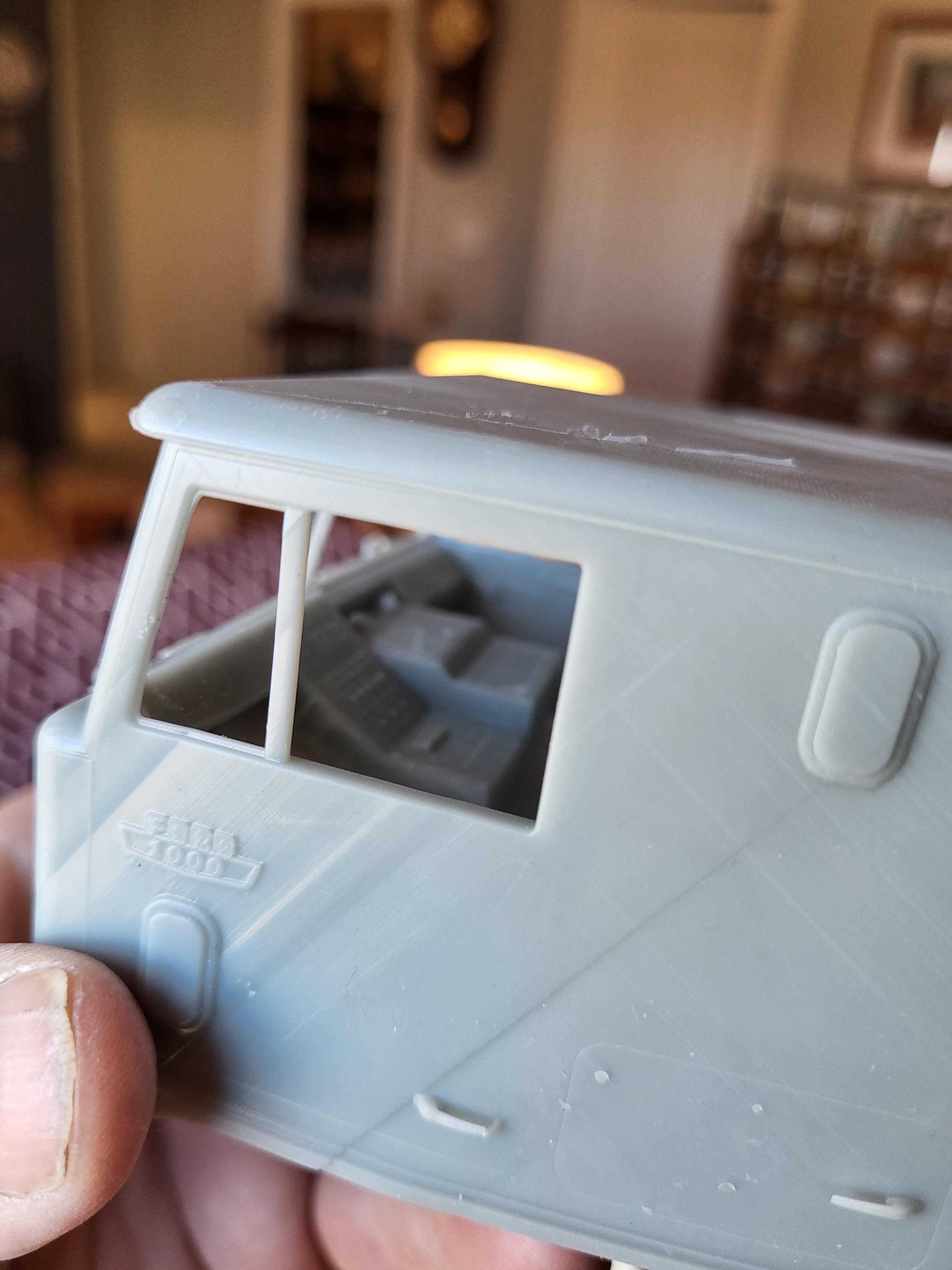

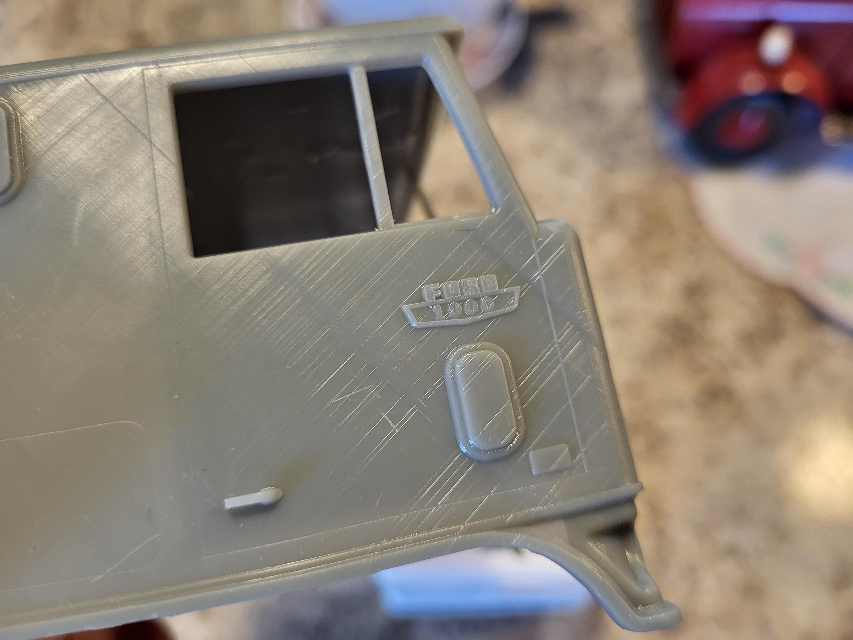

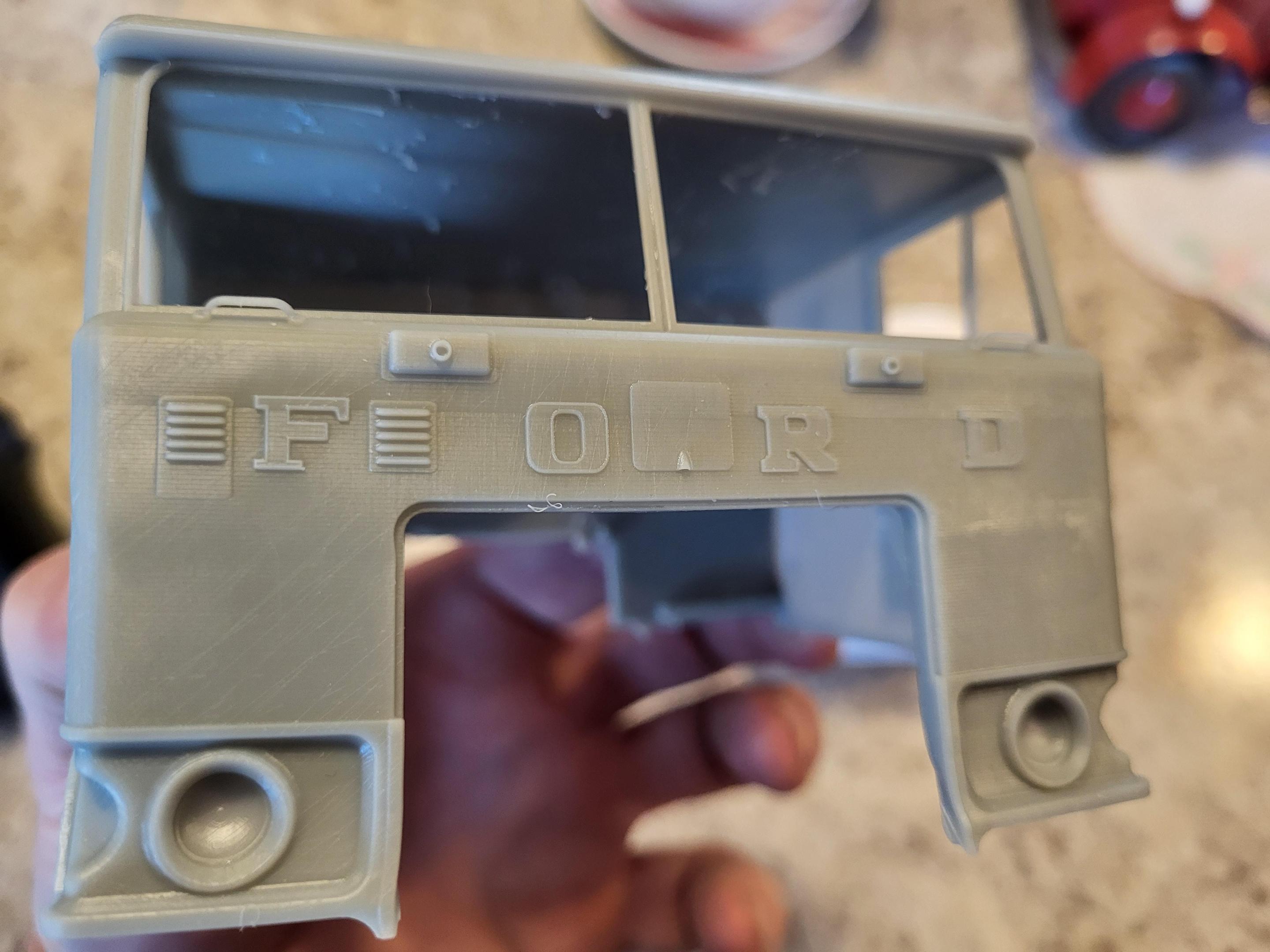

Oldmopars Posted January 30, 2023 Author Posted January 30, 2023 So, I did thicken up the F but I did it after this trial test print. Keep in mind, this is just a test to see if the interior will fit. I am not the master of printing and so this shows a few issue that I know Charles can fix. 1 Quote
Repstock Posted January 30, 2023 Posted January 30, 2023 You'd have to scribe some things deeper, but there's a lot of potential. Looks good! Like you say, what things are off are from printing, not the drawing. Quote

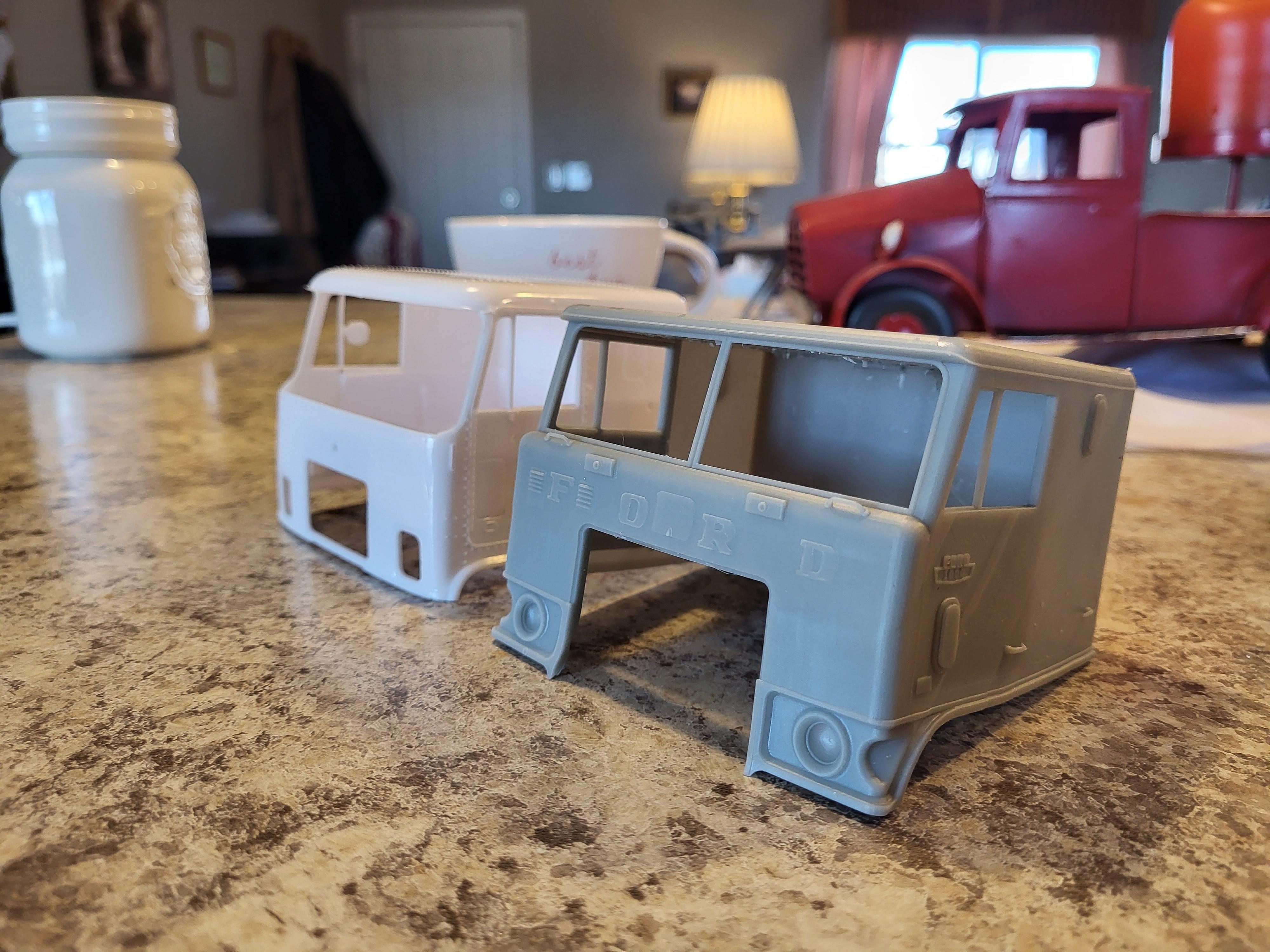

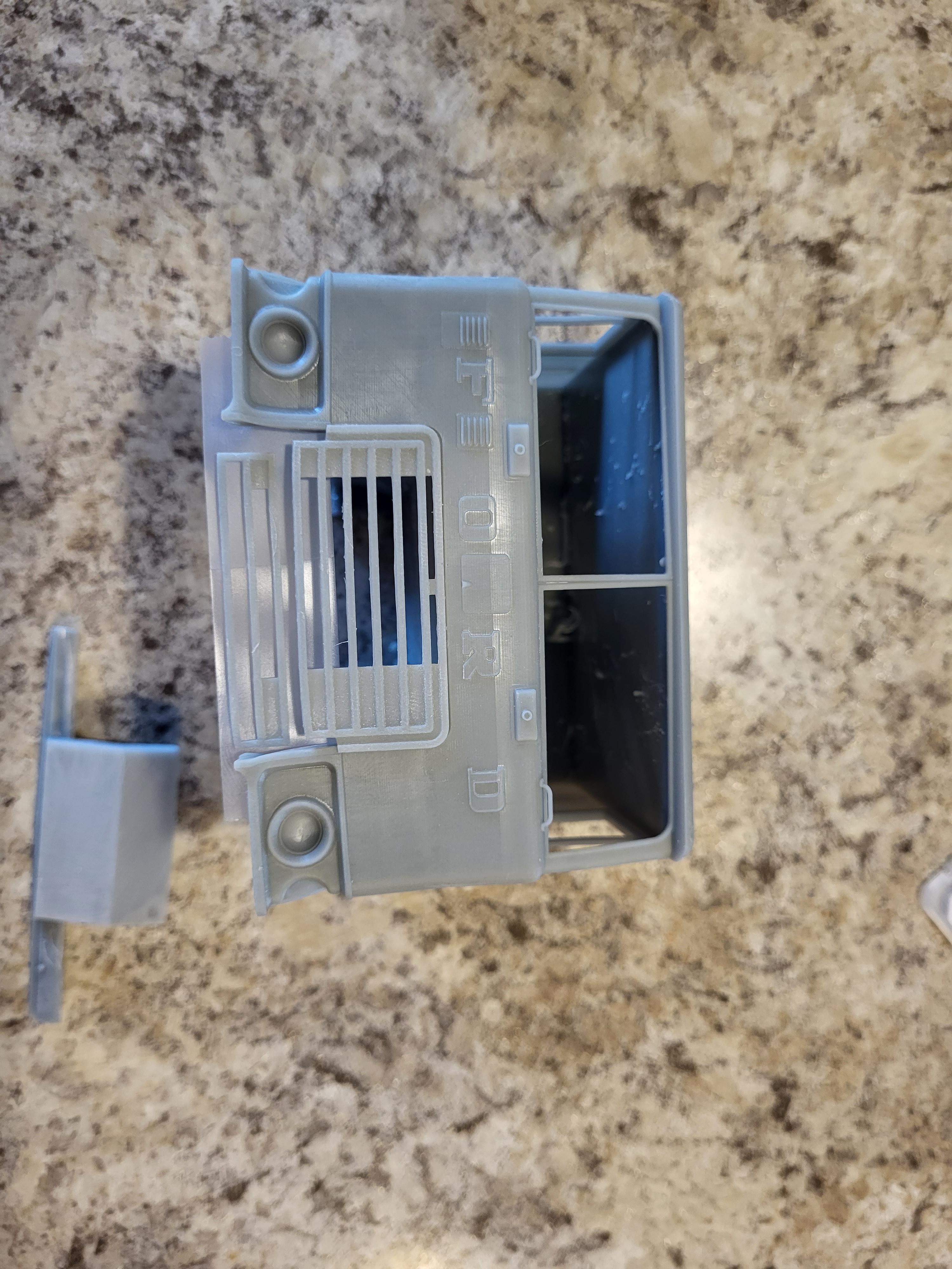

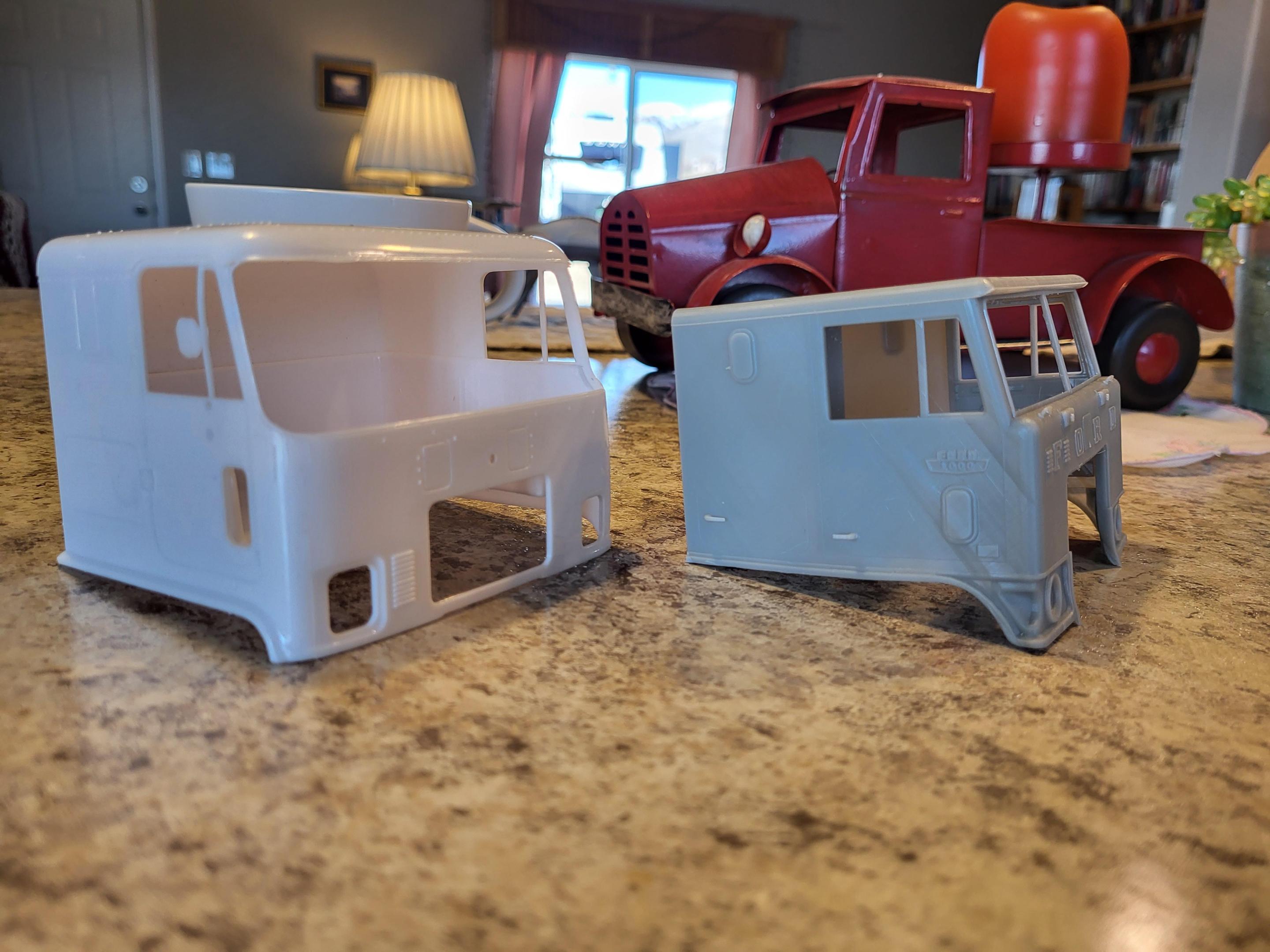

Oldmopars Posted January 30, 2023 Author Posted January 30, 2023 I have gone back and fixed the panel lines. Those are something that is hard to know how they will look until you print it. On the computer they are well defined, but printed, they are not as deep and clear, so that is fixed. I also added a removable support to keep the opening at the bottom of the grill from spreading as it cures. The GMC cab is there for scale. Quote

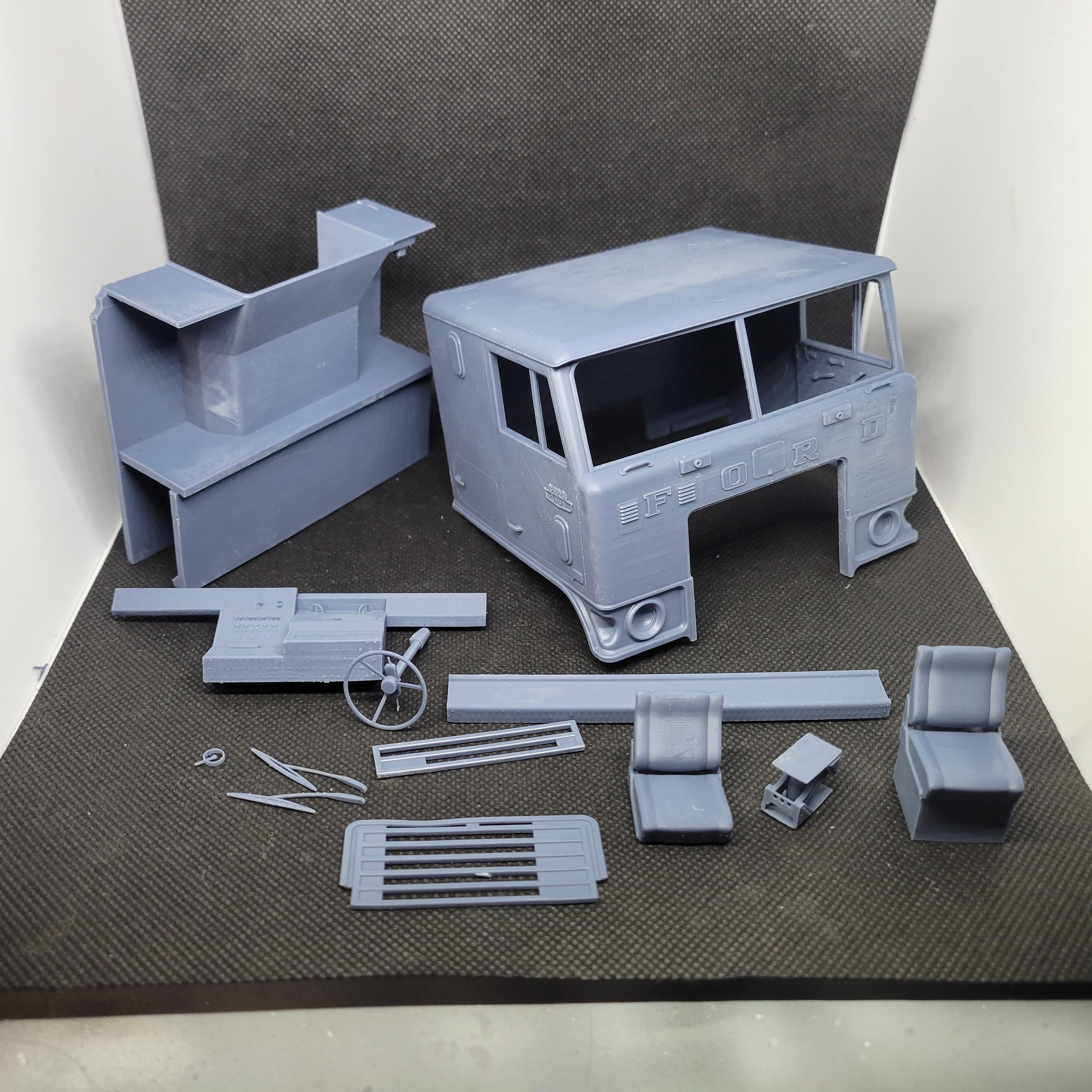

Texas_3D_Customs Posted February 2, 2023 Posted February 2, 2023 (edited) My photo booth is not big enough for something like this but this is where it stands right now for me got a few things to work on either I'll fix it Scott will fix it I actually do know how to model I just don't have time and I'm not as good as Scott I won't argue that but most everything came out pretty well I'm going to probably change the way I orient the body to get rid of the fuel lines that I see on mine but other than that the seats came out good most everything looks great The problem's going to be I need to figure a way to make this cost effective for you and for me Edited February 2, 2023 by Texas_3D_Customs Quote
