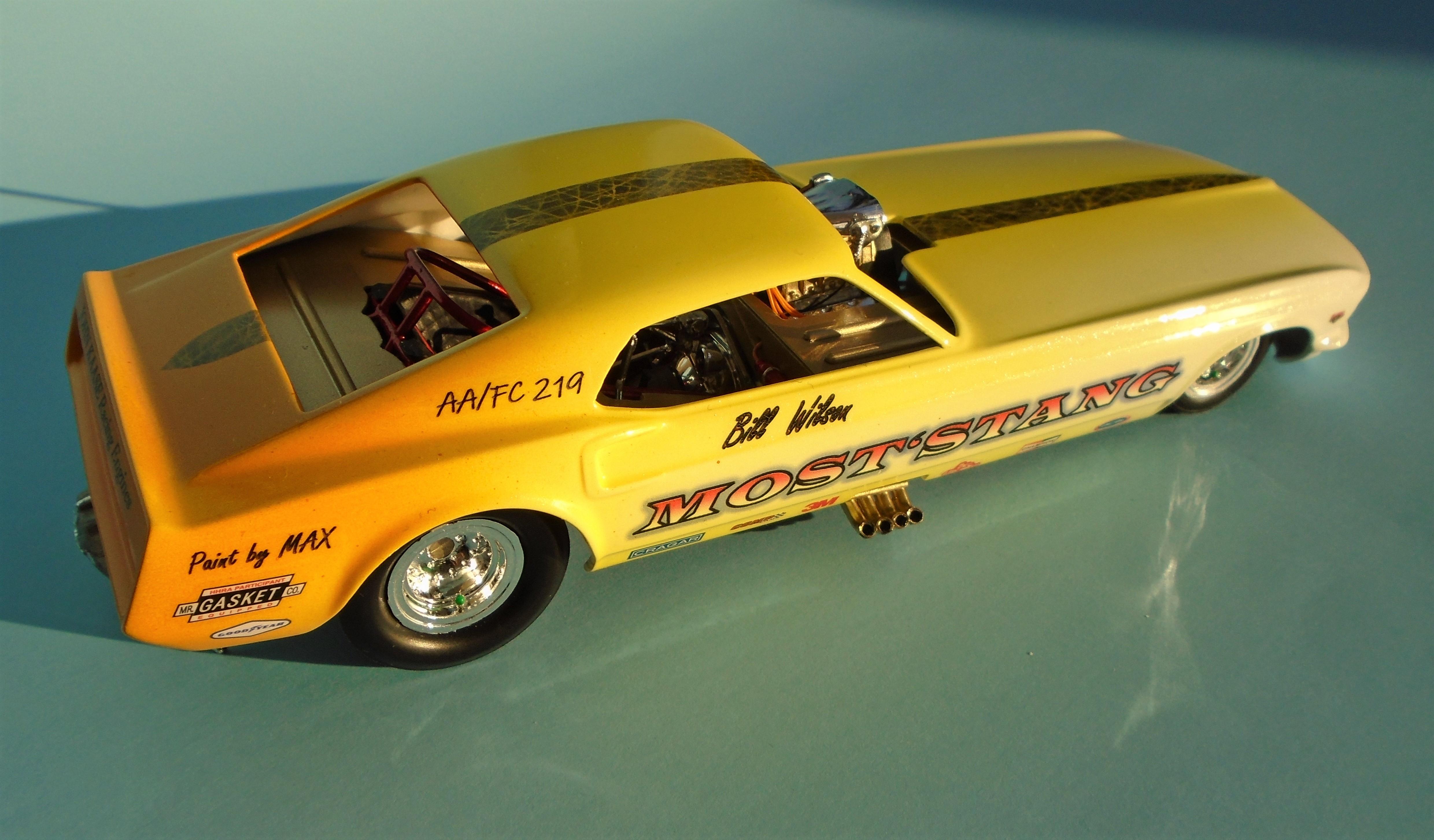

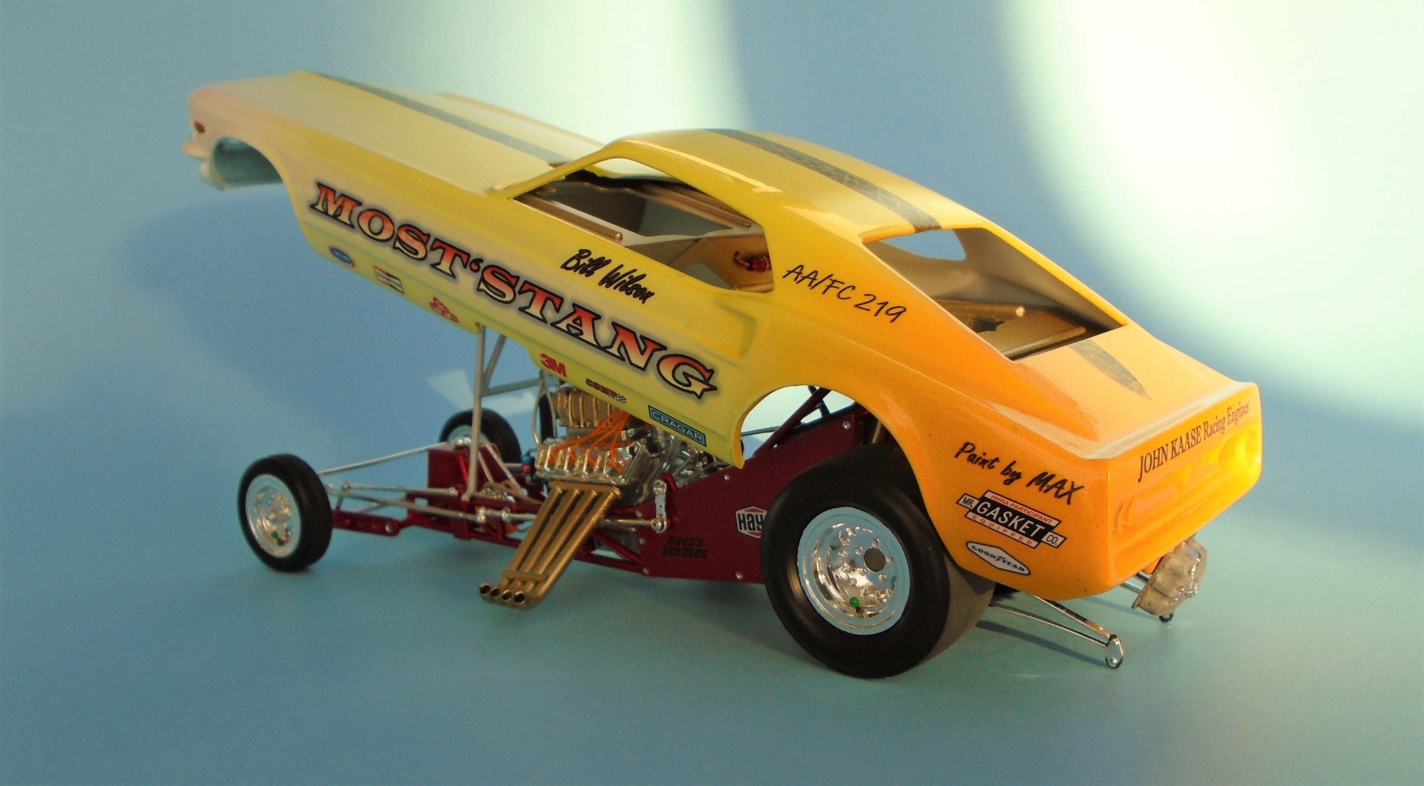

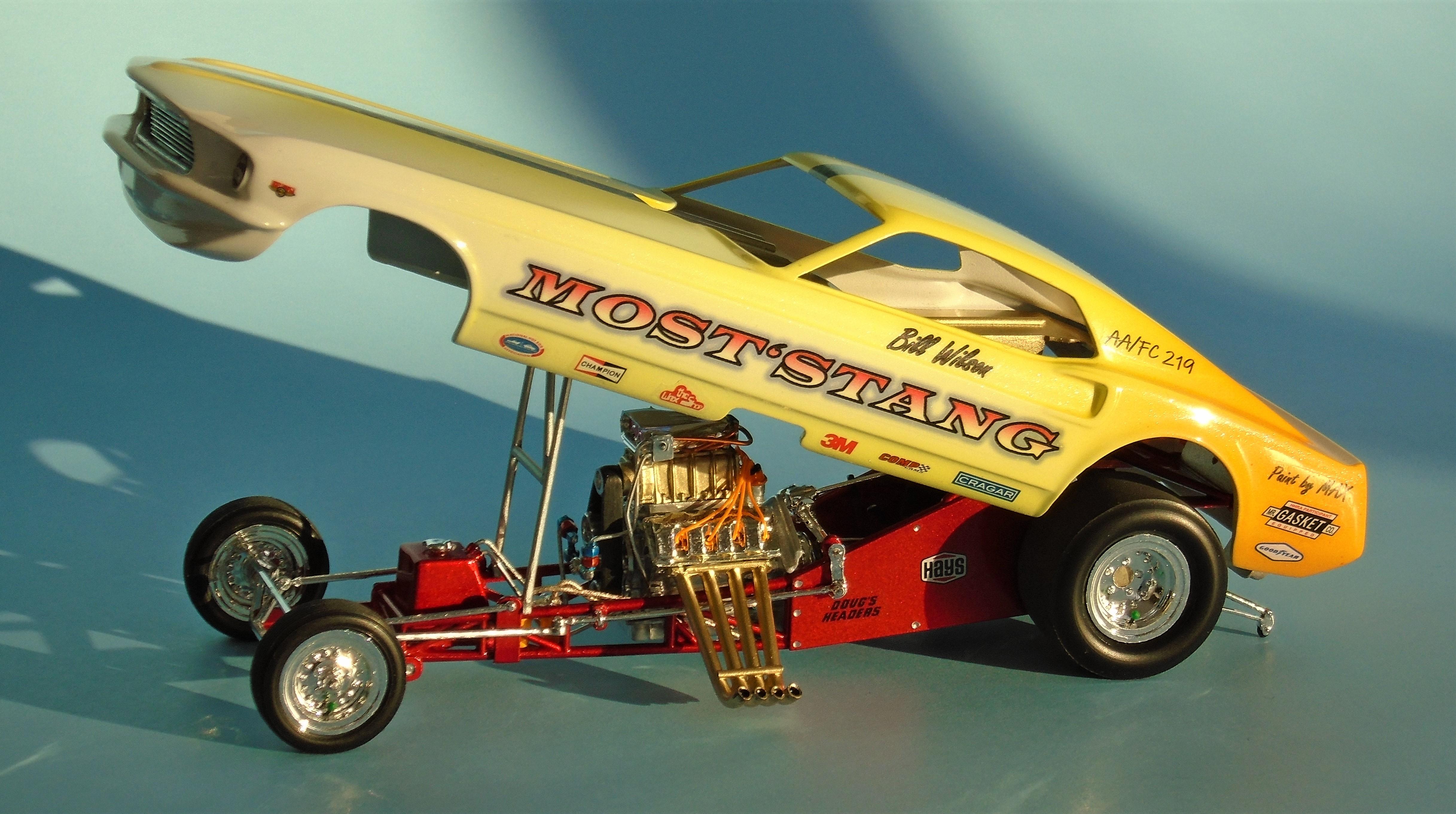

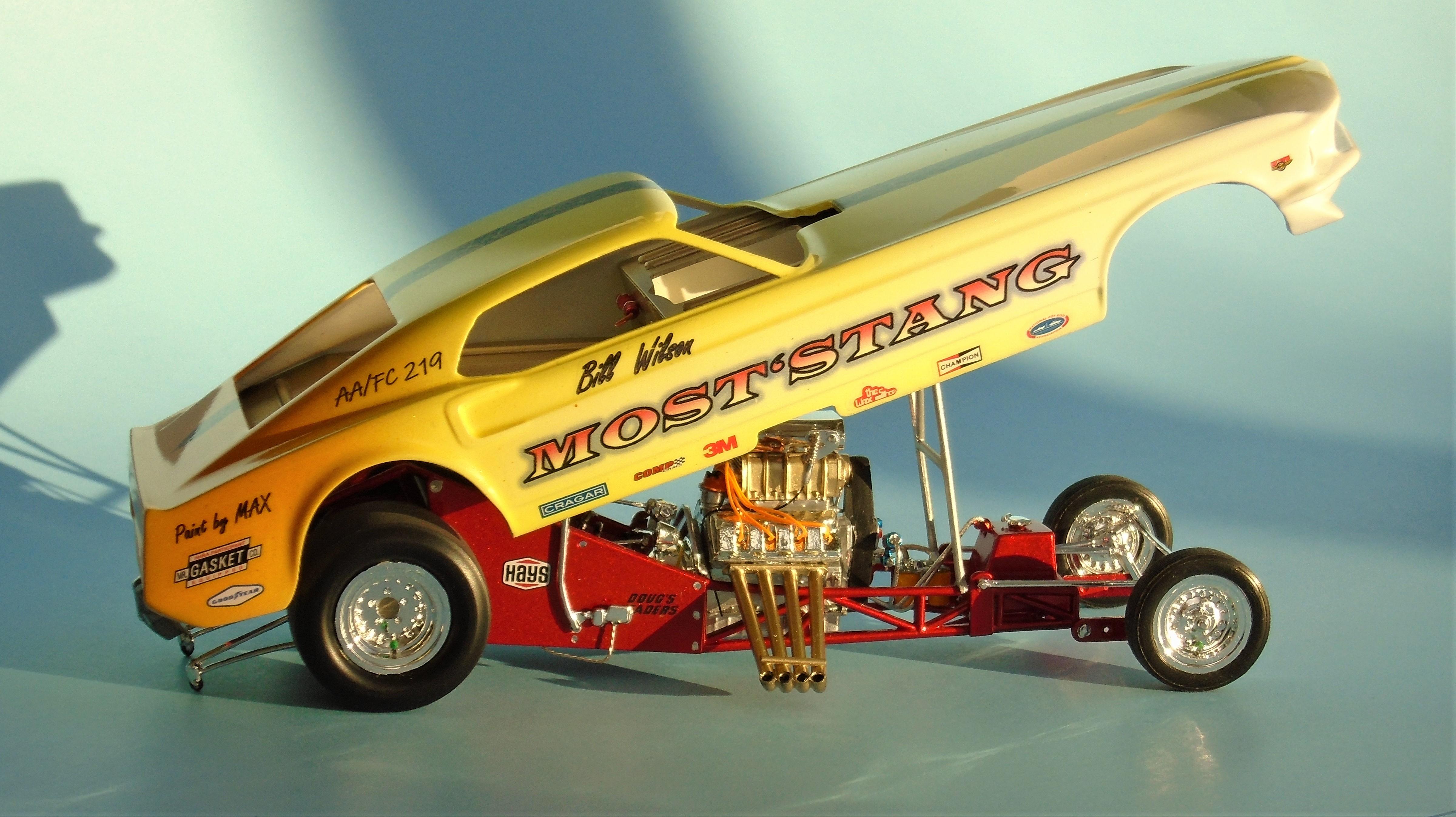

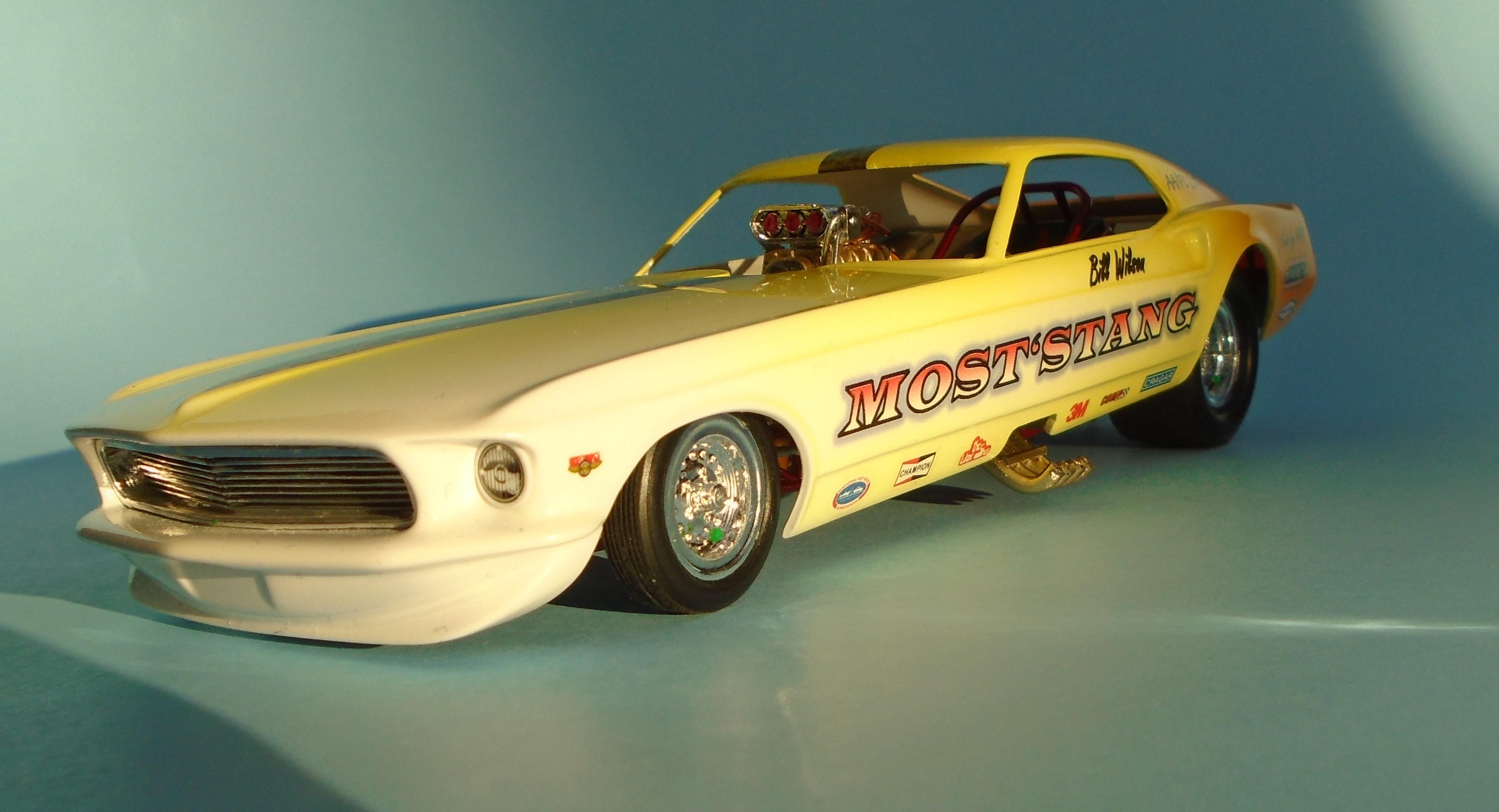

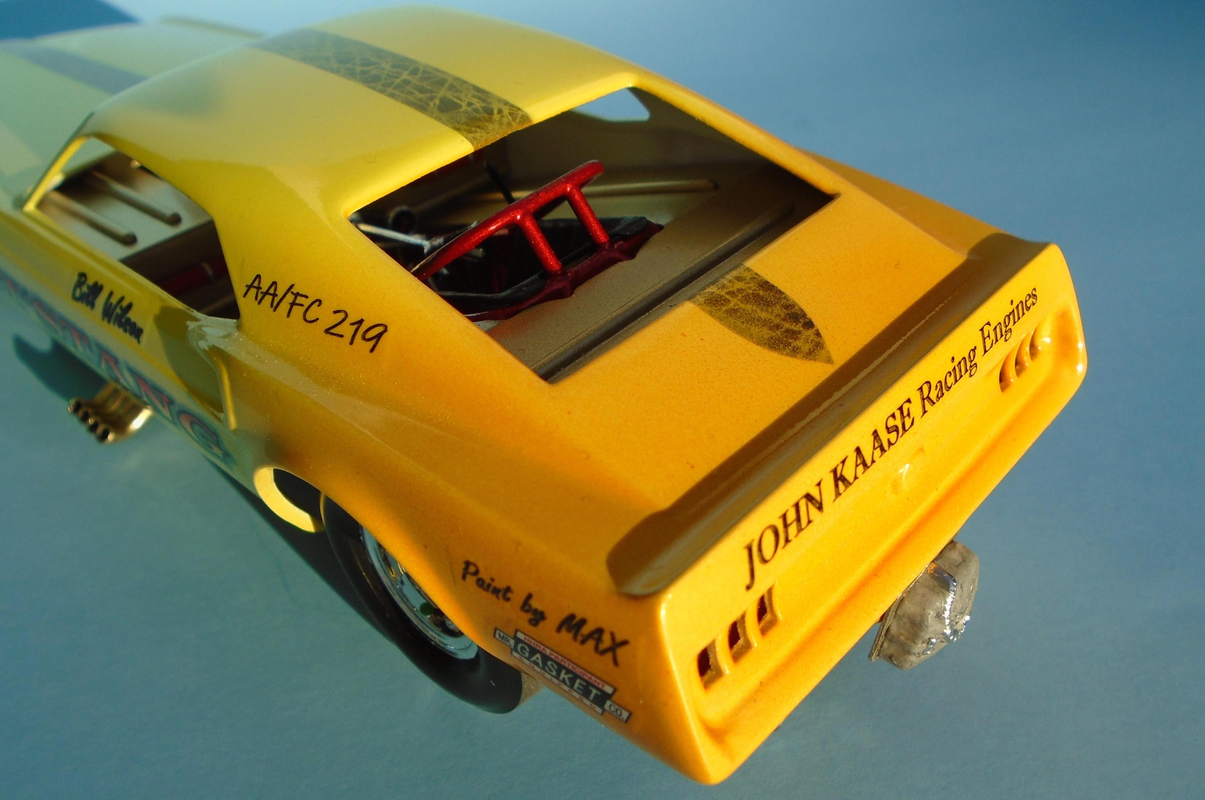

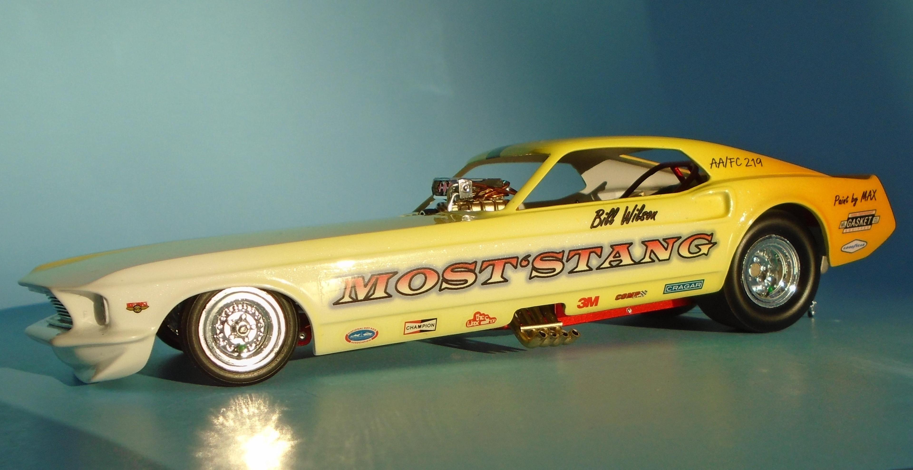

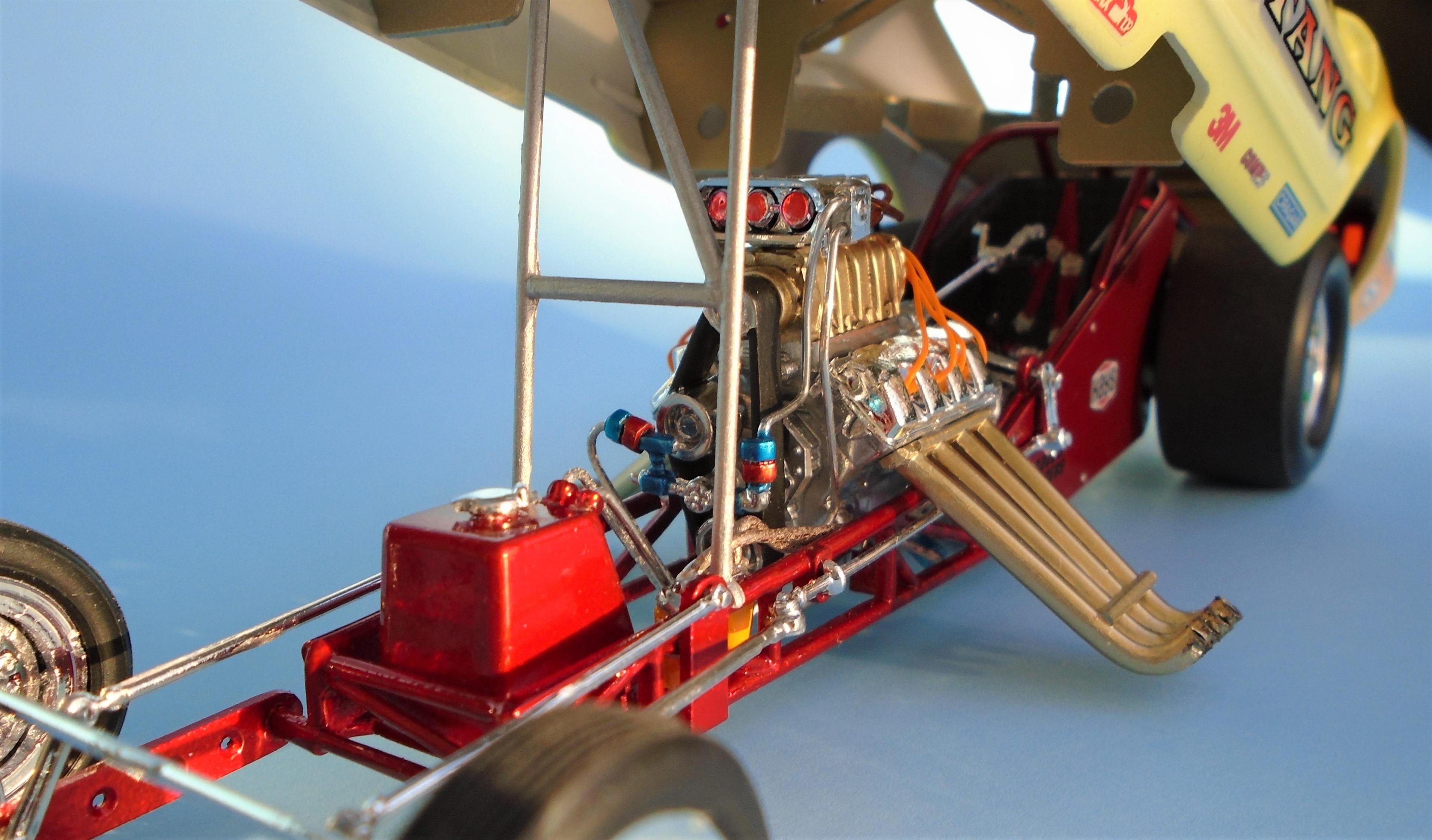

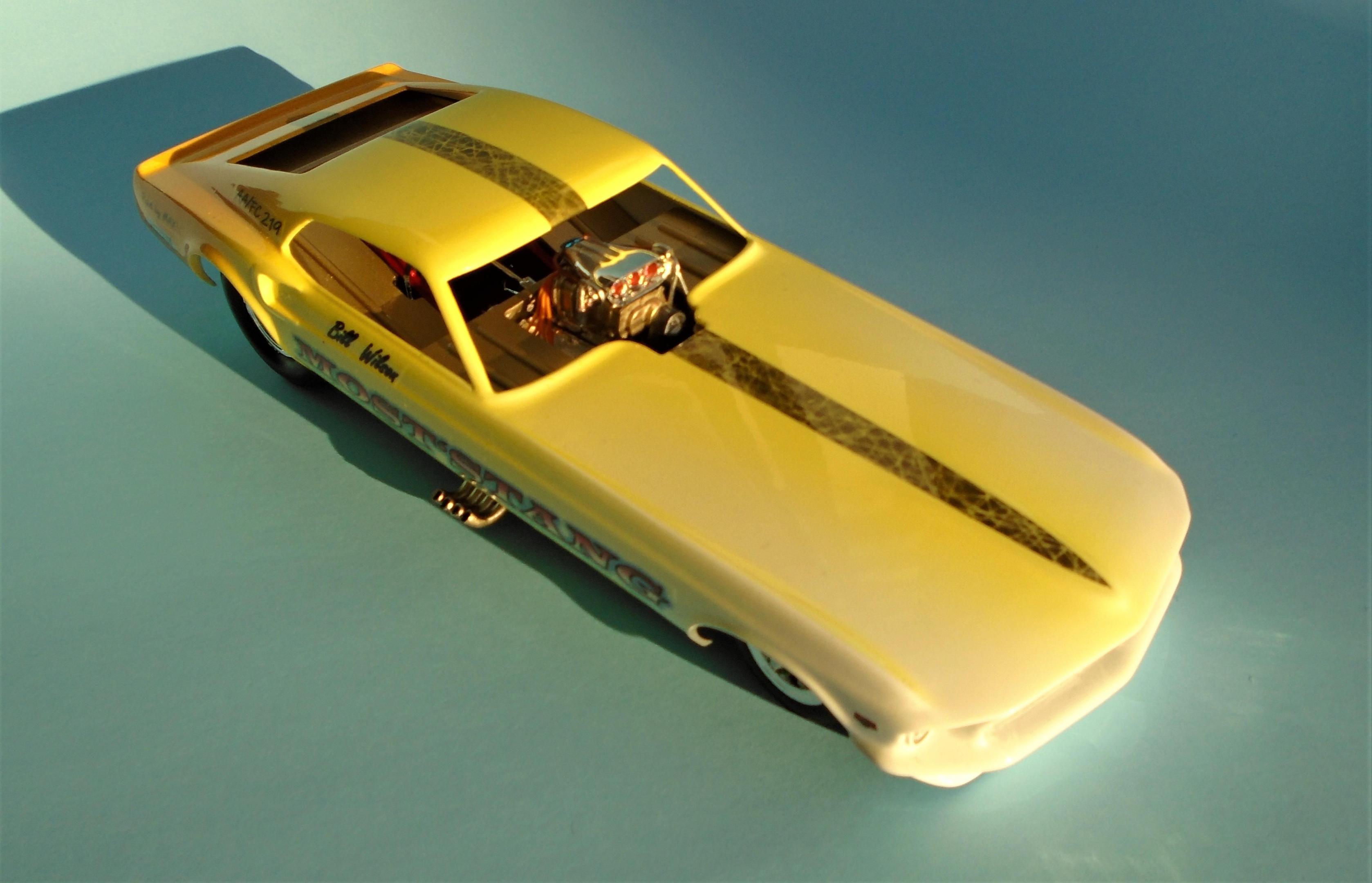

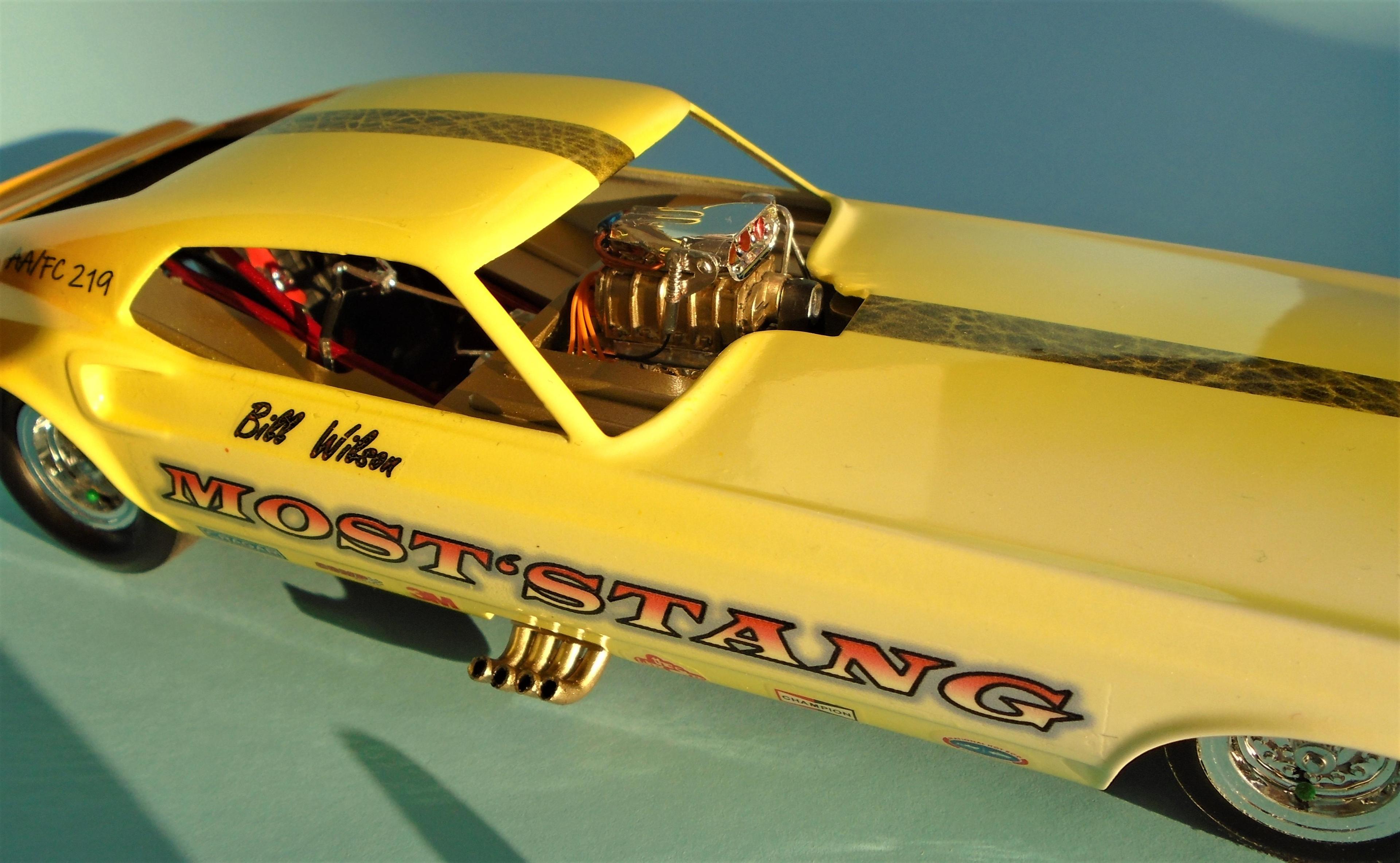

Claude Thibodeau Posted January 25, 2023 Posted January 25, 2023 HI! A lucky find at my last model show: a vintage ULTRA-RARE AMT Gas Rhonda Longnose Mustang kit! Virgin body, but partially assembled chassis painted with Humbrol enamel. I had the chassis/powertrain from the Mongoose 75 Duster FC in my stash, so... Here we go! Scratchbuilt: elongated torsion arms & steering rod (to match wheelbase of body), molded bumpers, all chassis & body tinwork, gas & oil lines, barrel valve, throttle, extinguishers, injector lines, Earl's fittings, tire air valves, etc. Tamya's & AK's lacquer colors fade & lace job trough airbrush, home made decals, Mr. Hobby Top Coat clear, fully polished. Molotow's chrome accents. Purists rejoyce: I have a second copy in my stash, but much less pristine: this one will be built stock, to show alongside this updated version, maybe next year? HOURS OF FUN WITH STYRENE! 8
skymnky721 Posted January 25, 2023 Posted January 25, 2023 awsome,,now did this car run w/o the windshield? or is that builders choice?
Claude Thibodeau Posted January 25, 2023 Author Posted January 25, 2023 1 hour ago, skymnky721 said: awsome,,now did this car run w/o the windshield? or is that builders choice? Hi Scott! Thank you for the comment. To your question: there is NO windshield in the kit, and we don't see any on the instruction sheet either. I tried an AMT 1/25 Mustang Mach One windshield on it, but there were substantial differences at the lower edge. So, as the hole required for the blower/injector hat would have eaten most of the glass area anyways, I chose to let it "box stock" in this regard. Must be a hairy ride, eh? CT
