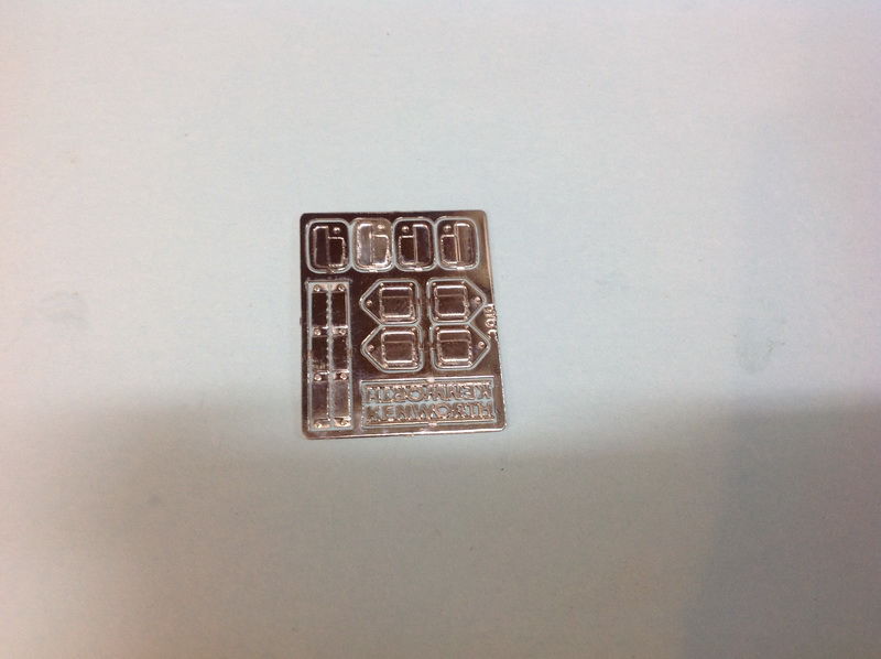

Auslowe has the correct style in photo etch, the middle ones in the picture below are right with the triangle shape and lock cylinder on top, can most certainly be found at STS.
The ones on top is the new style used on modern KW's
CMT do also have them but you have to get a complete detail set to get them, STS deals with CTM parts too.

You're right on that. Plus, the Auslowe set is better than most I've seen. But this type of latch has always looked a little flat to me when done in PE, and I find adding some thin styrene to correct the flange shape is an easier task for me. I have a feeling it's a YMMV situation, so just throwing out some further options.
Edited by spencer1984
That's why I suggested a foil copy to capture the deeper detail, the Revell Germany W900 kit has the handles as separate pieces and the Revell snap kit they are moded to the cab.
