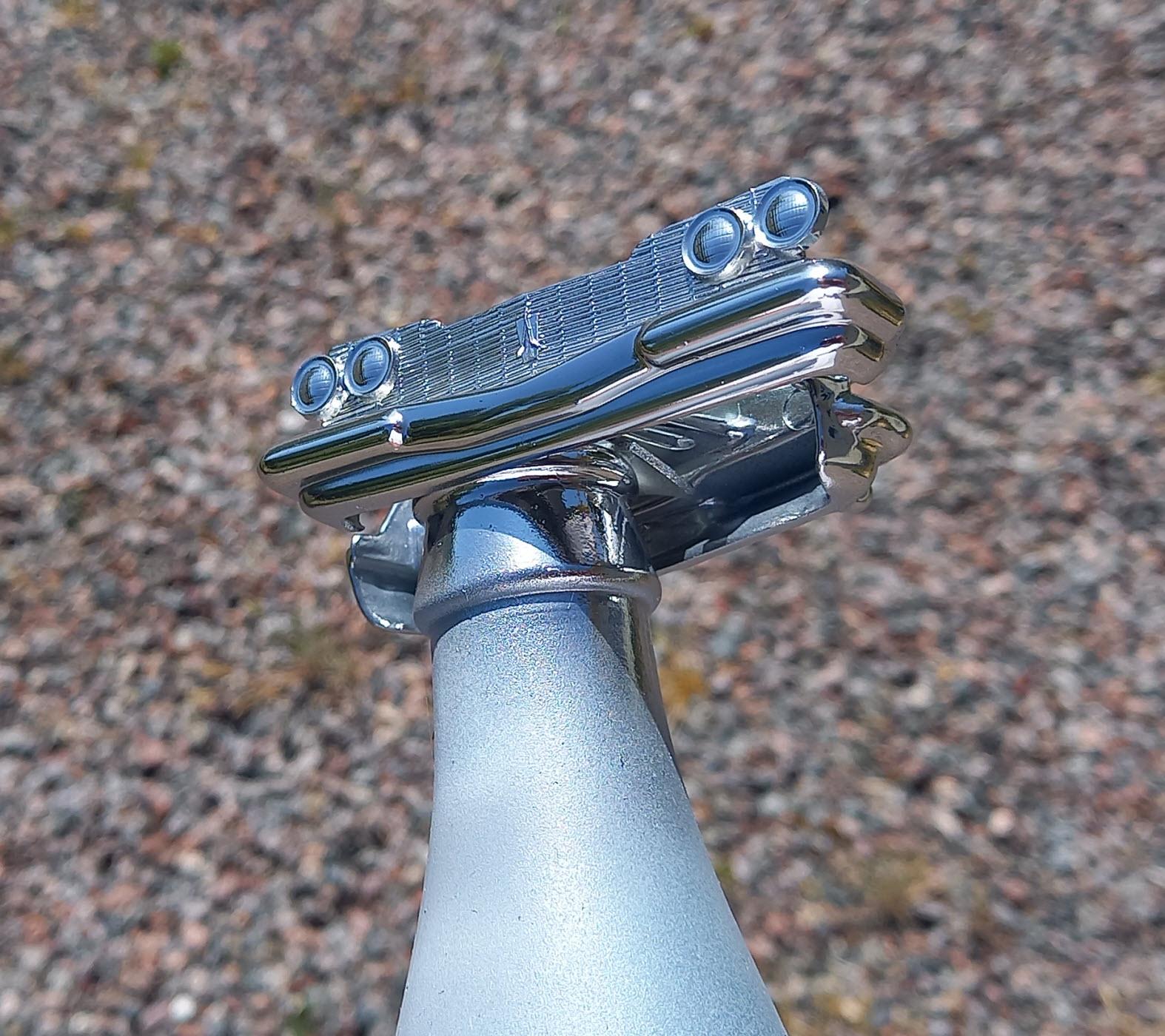

Chuck Kourouklis Posted June 20, 2023 Posted June 20, 2023 Did I mention Barbatos has great videos? I tend not to mind a wide-ranging thread myself, but one disadvantage has come up in this one. Even though Claes has basically declared it, I still have to ask, to be absolutely certain: that IS the Revell chrome you have on that Imperial grille/bumper, right? 'Cause those results are most emphatically not bad.

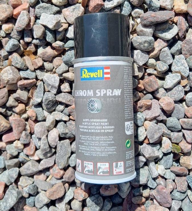

Claes Ericsson Posted June 21, 2023 Posted June 21, 2023 14 hours ago, Chuck Kourouklis said: I tend not to mind a wide-ranging thread myself, but one disadvantage has come up in this one. Even though Claes has basically declared it, I still have to ask, to be absolutely certain: that IS the Revell chrome you have on that Imperial grille/bumper, right? 'Cause those results are most emphatically not bad. Yes, it IS the Revell spray, this is a ’60 Plymouth bumper painted at the same time, mounted back to back of the Imperial bumper. Both primered. And I think the sunshine improves the image somewhat. Only issue so far, and that’s probably a handling issue, is, I, a couple of times have gotten a lot of small bubbles in finely textured grilles like ’63 Bonneville & ’64 Grand Prix. Probably too much paint too soon.... And this is the can..... 3 1
atomicholiday Posted June 21, 2023 Posted June 21, 2023 3 hours ago, Claes Ericsson said: Yes, it IS the Revell spray, this is a ’60 Plymouth bumper painted at the same time, mounted back to back of the Imperial bumper. Both primered. And I think the sunshine improves the image somewhat. Only issue so far, and that’s probably a handling issue, is, I, a couple of times have gotten a lot of small bubbles in finely textured grilles like ’63 Bonneville & ’64 Grand Prix. Probably too much paint too soon.... And this is the can..... That's pretty stunning. Not sure you could ask for better results than that.
niteowl7710 Posted June 21, 2023 Posted June 21, 2023 It looks good, but then so does Molotow. But from what I've seen of this stuff it might be slightly more resilient than Molotow, but this can of Chrom will fade to silver if you touch it too much just the same. You get a bit more durability out of it by decanting it and cutting it with MLT, but even then it's fairly easy to dull it to silver with handling and it won't accept a clear coat and remain "lustrous" any more than anything else out there.
