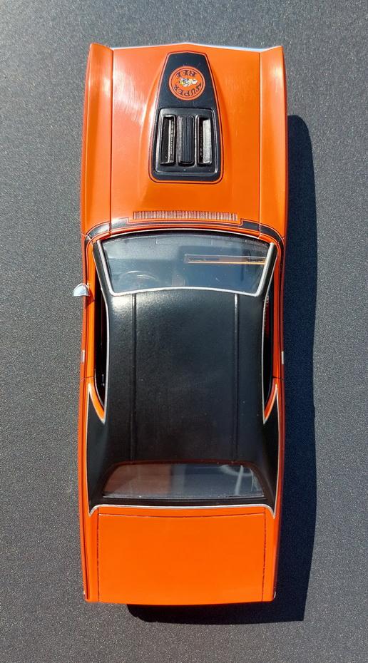

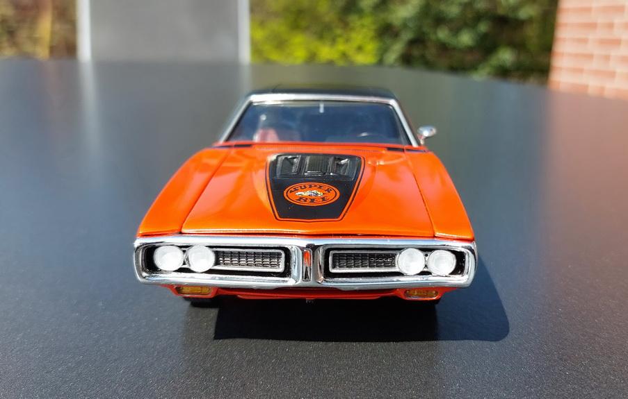

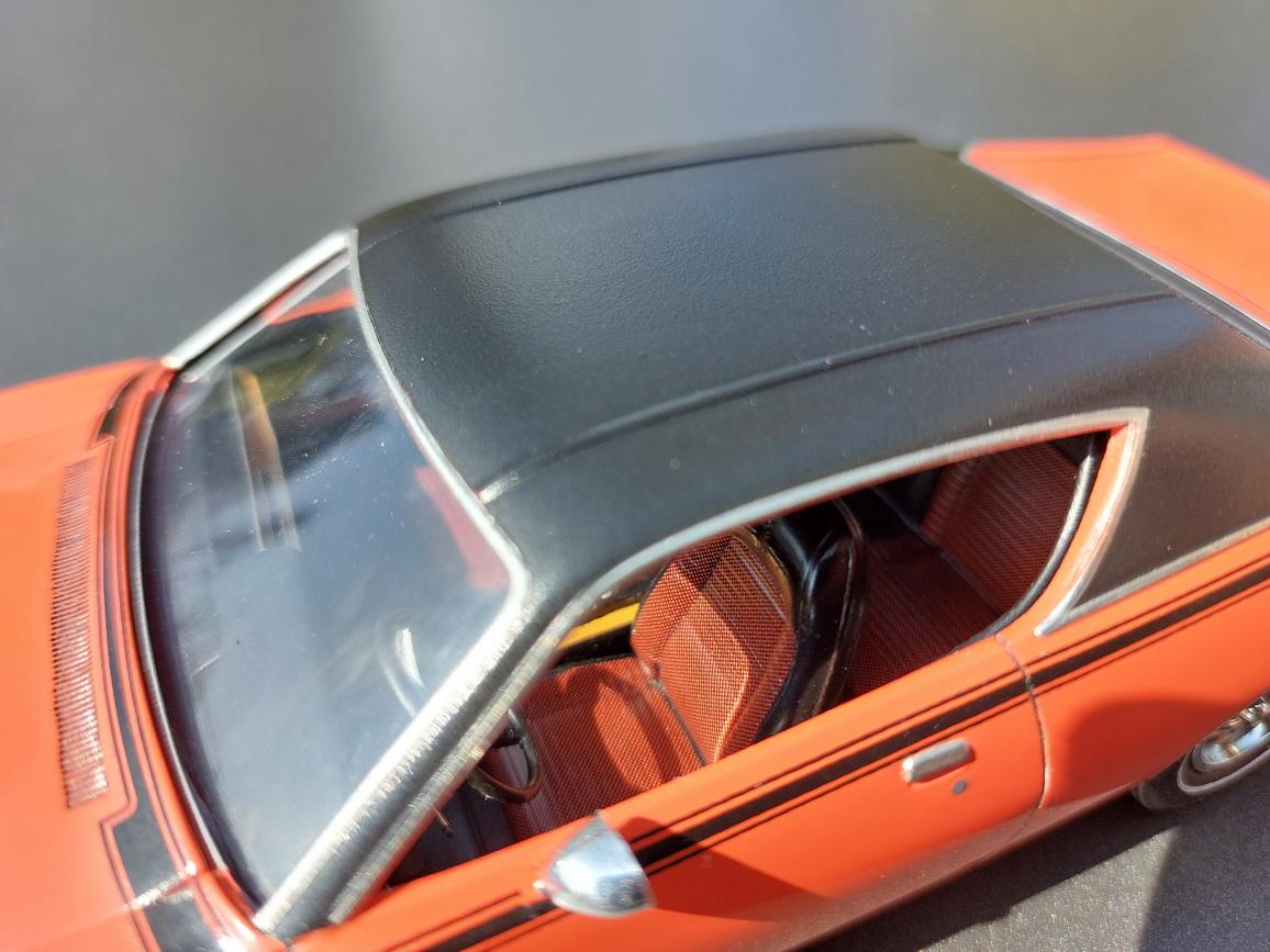

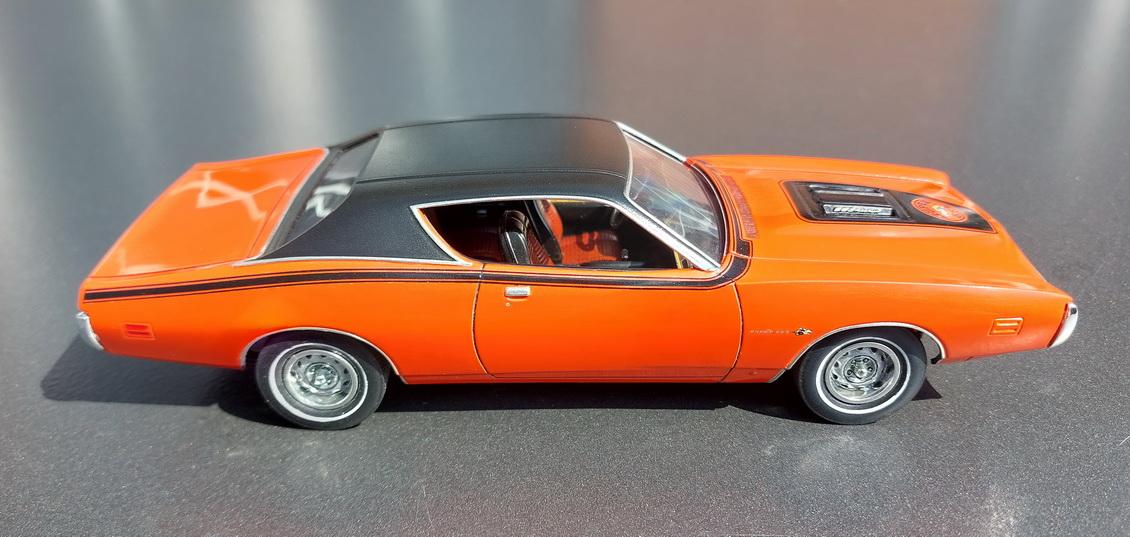

JS23U Posted June 13, 2023 Share Posted June 13, 2023 (edited) I finally finished a build replicating my own 1:1 Super Bee as it would have looked when rolling off the dealer's lot in 1971. I used an MPC NASCAR body because of its doors without gills (those are R/T-only). The side markers had to be carved in as the MPC body is a 72. I 3D-designed the stock taillights and bezels and fitted them into a resin bumper loop. The hood insert is a resin part. I converted the AMT seat bench to buckets, the console and steering wheel were taken off a Monogram 71 "Satellite". Most of the rest came from the AMT "new tool" 71 Charger R/T. The parts of these two different kits fit together better than I expected. Edited June 13, 2023 by JS23U 10 Quote Link to comment Share on other sites More sharing options...

Bainford Posted June 13, 2023 Share Posted June 13, 2023 That is a stellar build, Jens. Your conversion to Super Bee is top notch. Excellent detailing, and good realism, too. The vinyl top and its attendant trim look particularly good. All round an excellent build. By the way, I'm really digging the well-used look of you 1:1, too. Quote Link to comment Share on other sites More sharing options...

espo Posted June 13, 2023 Share Posted June 13, 2023 Beautiful looking model. Looks like the 1:1 will keep you busy for a while to bring it to this level. The interior looks very realistic, and I was wondering what you used for the interior inserts on the seats. Quote Link to comment Share on other sites More sharing options...

JS23U Posted June 13, 2023 Author Share Posted June 13, 2023 Thanks a lot. The photo of my car was taken last year. It looks battered but actually drives well and is reliable. I had a friend design the seat pattern and then it was printed as a decal. Because of the curvature of the seats I had to cut them into separate pieces. Quote Link to comment Share on other sites More sharing options...

1972coronet Posted June 13, 2023 Share Posted June 13, 2023 Gorgeous WM23N1 ! I love how the C5XV seats/interior turned out -- nice touch. Where was your 1:1 'Bee built ? Quote Link to comment Share on other sites More sharing options...
JS23U Posted June 13, 2023 Author Share Posted June 13, 2023 My interior code is C5XV. The car was built in Lynch Road / Detroit. 1 Quote Link to comment Share on other sites More sharing options...
