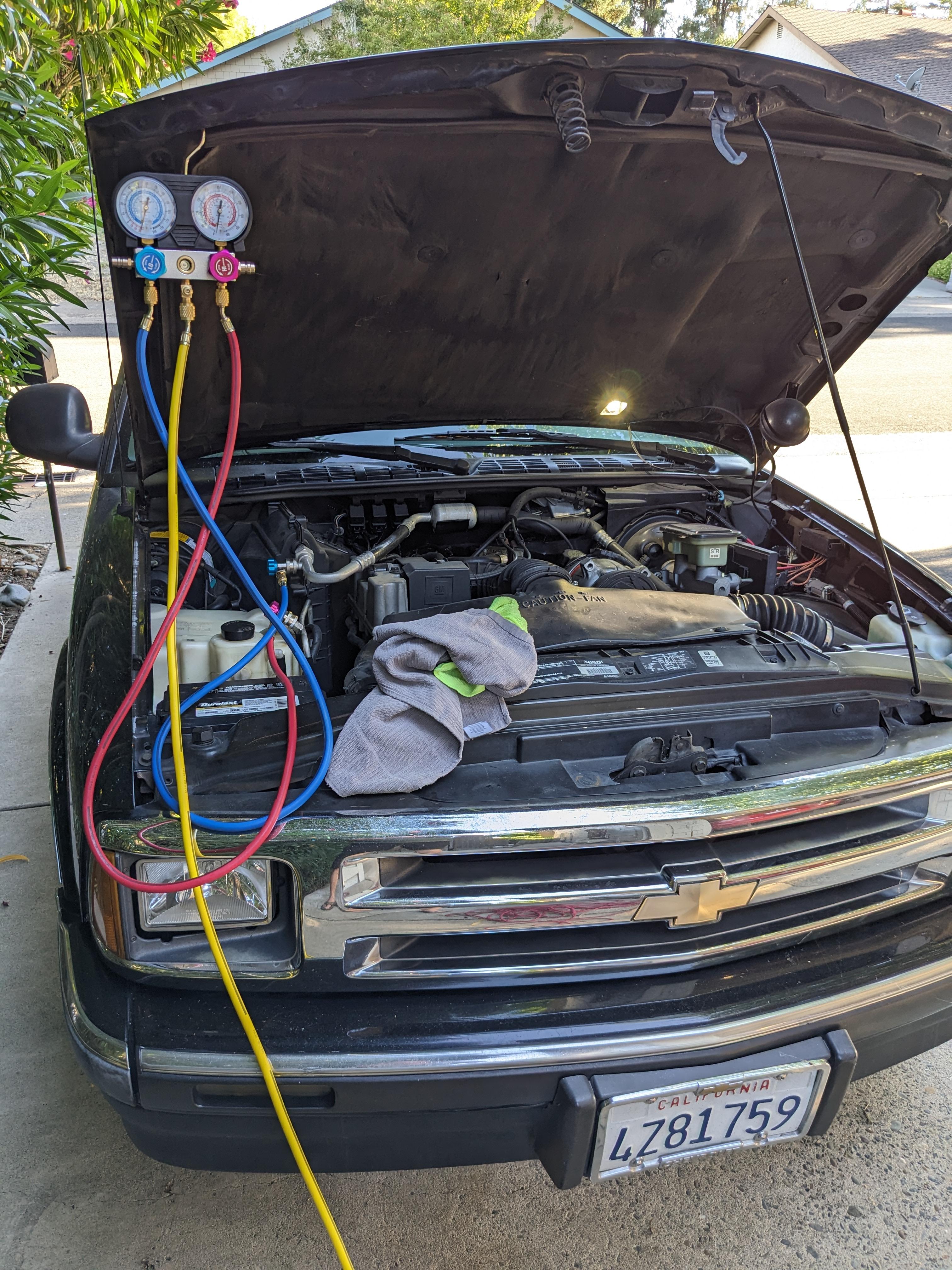

I already have a butane torch. After a short detour down a dirt road when I discovered that butane isn't available just everywhere in California anymore, I went through four heat/soak cycles and finally extracted the bugger using a boxend on the hex behind it and pliers on the fitting itself.
I installed the new service valve (with the correct 8-side socket) last night and drew a vacuum. I am going to try to charge it tonight if I have time.

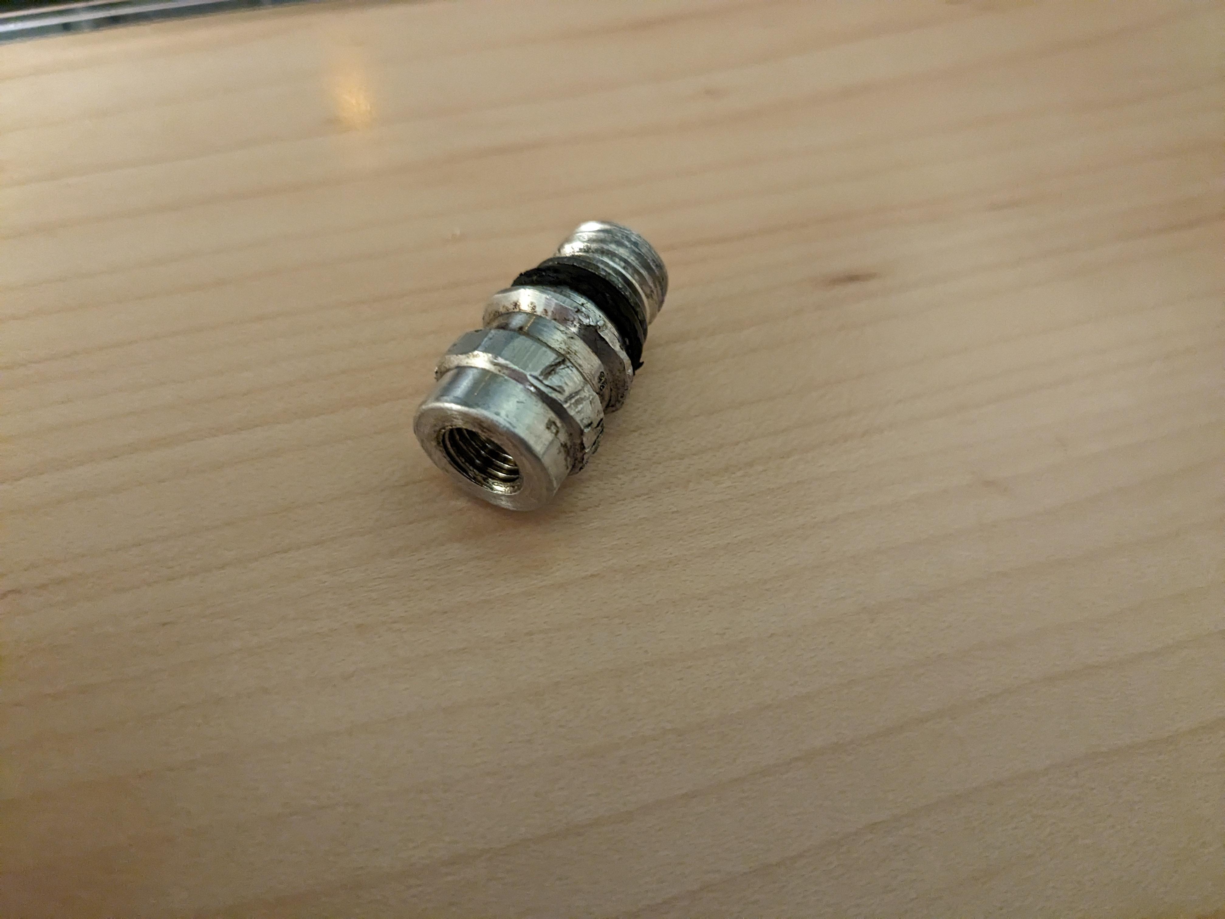

Now that I have the old valve out, it looks like some type of steel, not aluminum.
