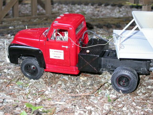

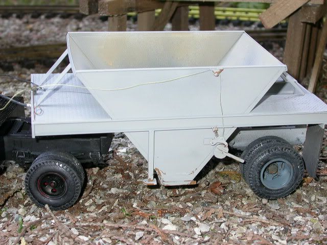

dptydawg Posted May 14, 2009 Posted May 14, 2009 Hi folks Here are a few pictures of my latest build. This 1953 ford tractor and gravel hopper are replicas (as close as my old memory will allow) of the trucks that my uncle owned back in the 1950's. The trailers were shop built in his maintenance shop. As a kid my cousins and I used to log many an imaginary mile on Sunday afternoons hauling imaginary gravel in their yard. The tractor is a GearBox diecast 1953 Ford wrecker. I modified it slightly by adding parts box suspension, flathead engine and rookie rods on the bumper. Also added door windows and no-drafts. The tires are the stock tires with AMT 1000 X 20 retreads glued on top to bring them up to 7.75-8.25 x 20 tire size. The saddle tanks are scratch built also. The hopper is entirely scratch built with the exception of parts box wheels and tires The trailer has been lightly weathered but the rattle can paint job I did on the Ford looked so good I haven't weathered it yet. Used TSC tractor paint. Best rattle can paint I've found yet The dump gate trip and closure mechanism is functional. the gate opens if the string is pulled Thanks for looking Carl Quote

airhorn Posted May 14, 2009 Posted May 14, 2009 (edited) Good job but have a question. What's the wire or cable going from the cab back to the trailer? Does it release the hopper doors? If it does thats some inovation. Win Edited May 14, 2009 by airhorn Quote
dptydawg Posted May 14, 2009 Author Posted May 14, 2009 Good job but have a question. What's the wire or cable going from the cab back to the trailer? Does it release the hopper doors? If it does thats some inovation. Win Hi Win Your right on about the function of the rope. This was a '50;s vintage truck, so technollogy was simple and mostly mechanical. this is a close-up of the trip mechanism. These pics are during cunstruction of the trailer. The spring loaded dog kept the gate closed. pulling the rope released the catch. The trailer was used to spread gravel a couple inches thick on township roads. Depth of gravel was controled by the trucks speed. The Gate is latched closed in this pic The Gate has been tripped. The handle on the latch was to reclose the gate. The chain length could be adjusted to control gate opening. These trailer had juice brakes operated by engine vacuum to a brake booster unit that operated a master cylinder. I have not instaled the braking set up yet. It will mount on the rear subframe Thanks fpr looking Carl. Quote
