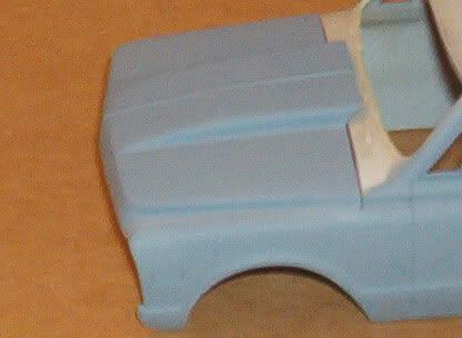

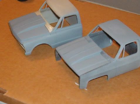

SoCalMark Posted April 2, 2006 Share Posted April 2, 2006 I saw one on eBay the other day and thought it wouldn't be too hard to make one for my Manza. I found a sheet of .40 sheet styrene and cut a pair of sides and the top. I then filed a line on the underside where I wanted it to bend and glued the three parts together. Then do some shaping to fit the shape of the hood your using. I put some tape on the hood to help center the part. I held it in place with some close pins and glued it in place. After some more sanding I put a coat of primer to see how it looked. I still need to do some blending on the front but you get the picture. I know it's a easy one but this shows how easy it is to make little goodies. Made a couple more, one for my 78 Chevy P/U old fall guy and one for my 72 Chevy P/U Daully. On these I glued a thin strip down the middle for a body line. Mark Quote Link to comment Share on other sites More sharing options...

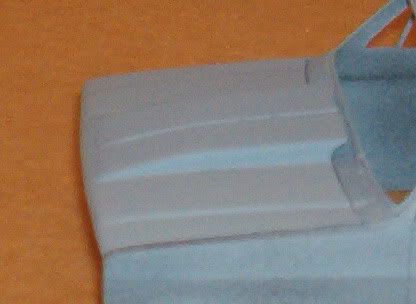

Steve H. Posted June 15, 2006 Share Posted June 15, 2006 I've done the same with a slightly different technique. I glued the large styrene sheet to the leading edge of the hood, then built a hidden support under the back half using .040 square rod. I massaged the large sheet to the gentle curve seen here and glued it to the support structure. After that had cured, I glued in sheets on the sides, slightly larger than needed and filed them down after it cured. The bead down the center is a craft wire blended in with putty. Mind you, this is a 1/18th diecast, so it was a little easier to work with. Quote Link to comment Share on other sites More sharing options...
