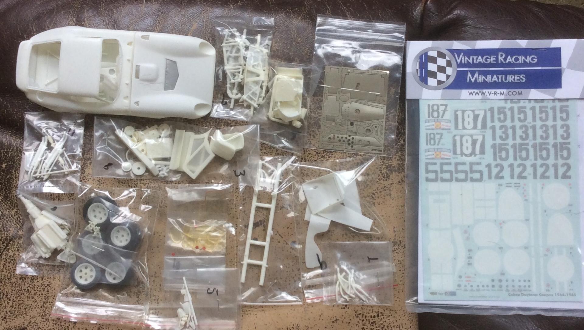

RancheroSteve Posted November 1, 2018 Posted November 1, 2018 1 hour ago, Ace-Garageguy said: How are the proportions on the Gunze kit? Please, be hyper-critical. I'm not worried about a lack of engine or opening hood. Easy enough to rectify. But I just HATE having to redo a body because the manufacturer didn't get it right. I suppose that partly depends on which Cobra Daytona you want it to represent - they were all a little different, right?! And I'm not completely sure of this, but I suspect the HRM body may be based on the Gunze body. But for the price, I'd go with the HRM kit, unless you can find an affordable builder like I did a few years back. It's a crazy kit to build, but with the addition of the VRM decals, you can end up with a reasonable looking Daytona:
