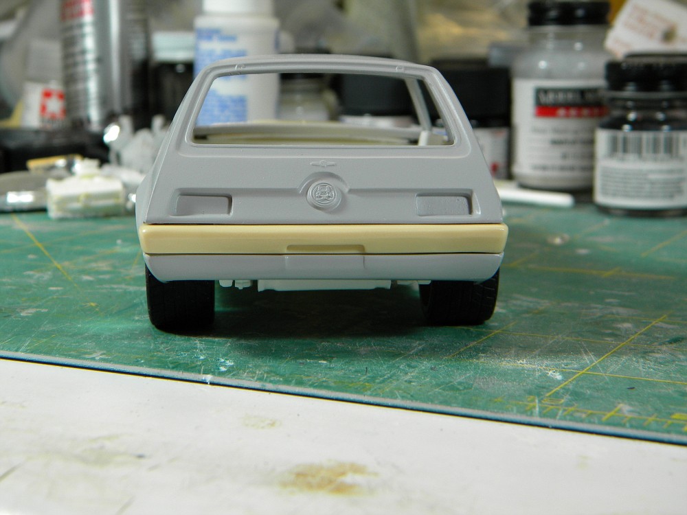

Marc @ MPC Motorsports Posted August 8, 2010 Posted August 8, 2010 (edited) My Modeler's ADD is in full stun mode! Received my Bandit Resins 1972 Gremlin on Saturday. Here's what was in the box. Body, hood, front and rear pans, bumpers, grille, taillights, interior tub, dash, and vacformed glass. Here's some close up pics of the body. Very clean casting, typical Bandit Resin quality. I'm using the chassis and interior from a partially built AMT 1975 Gremlin X annual. Watch for updates real soon! Edited October 31, 2010 by Marc @ MPC Motorsports Quote

Marc @ MPC Motorsports Posted August 10, 2010 Author Posted August 10, 2010 Shaved emblems and side markers. Attached front and rear pans and molded them in. Shot some Tamiya primer to check progress. Gas tank narrowed, springs moved inboard and differential narrowed for Pegasus 23" Centerlines. A cute little car and a fun build! Quote
