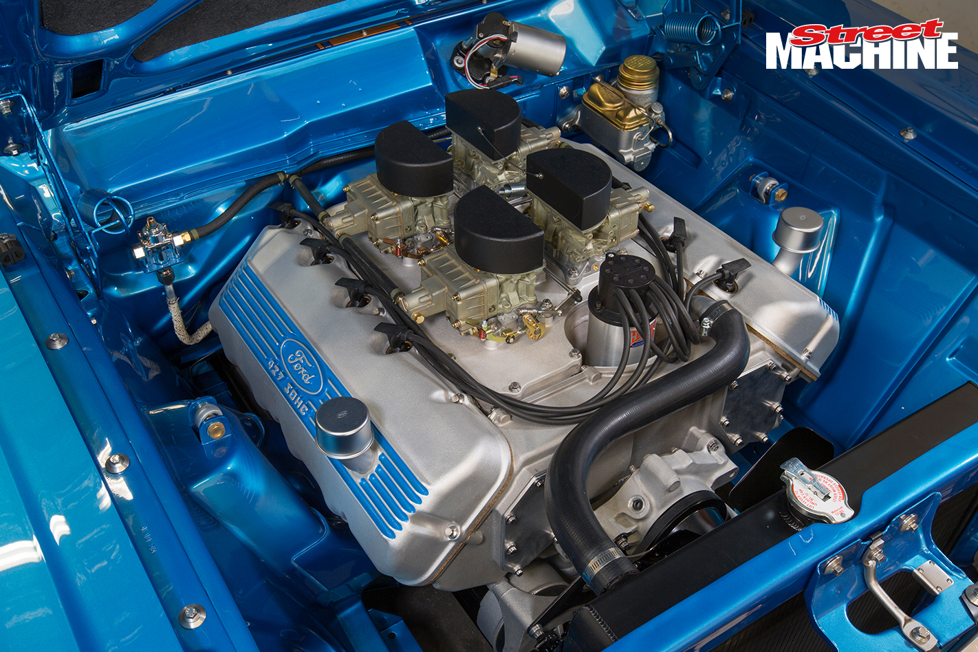

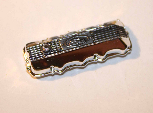

Casey Posted September 23, 2018 Posted September 23, 2018 On 3/31/2007 at 8:44 PM, Guest zebm1 said: The AMT 1965 A/FX drag racers have 427 SOHCs. Here's a close-up look at the SOHC valve covers from the AMT '65 Mustang AWB kit: Here's a good shot of the real valve cover: If a scale valve cover doesn't have those clearance 'bumps' at the bottom edge of the valve cover, I would immediately rule it out. 13 hours ago, Straightliner59 said: the best cam covers were from Monogram's T'rantula. Here's the 1/24 scale T'rantula's left valve cover, which I would agree this is the best version in scale: Has anybody tried the T'rantula's 1/24 scale valve cover(s) and other parts on one of the better 1/25 scale Ford FE-series engines (Revell '64 Tbolt, AMT '60 Ford Starliner, etc.)?

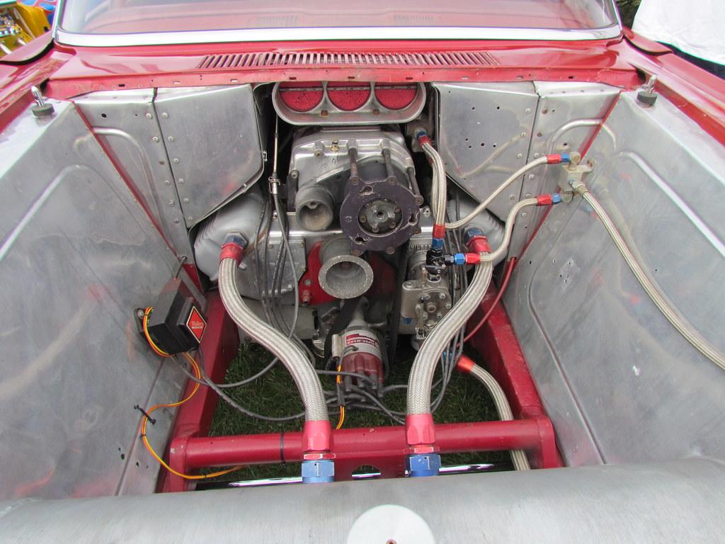

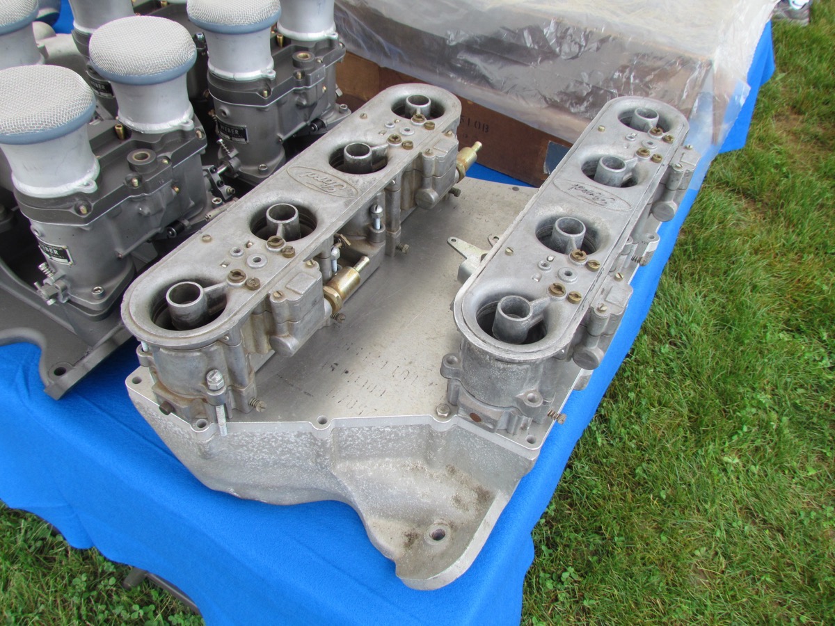

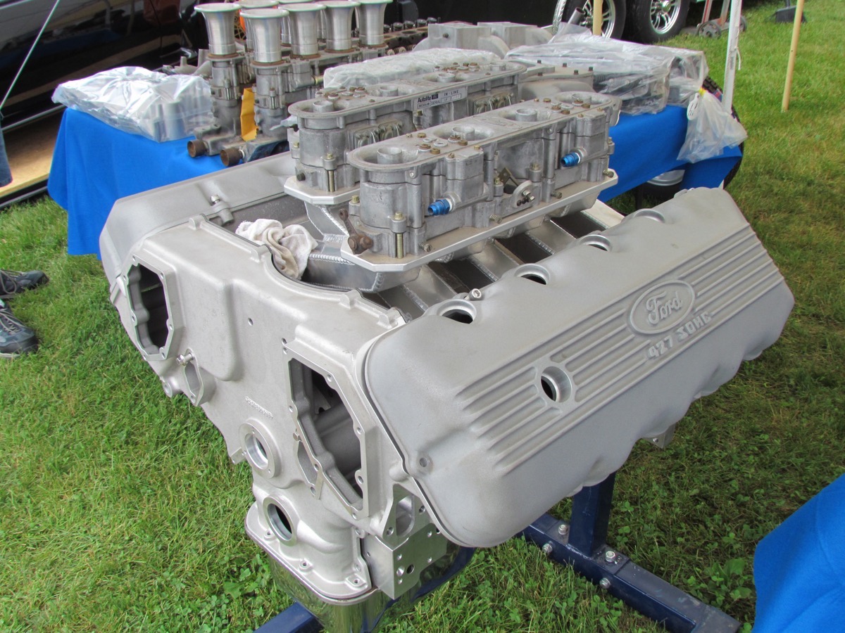

Deuces Posted September 25, 2018 Posted September 25, 2018 Here's some Cammer pictures I posted on the H.A.M.B. 1

landman Posted October 26, 2018 Posted October 26, 2018 29 minutes ago, Old Nasty said: Yes. OK thanks. On 9/25/2018 at 7:42 PM, Deuces said: Here's some Cammer pictures I posted on the H.A.M.B. What carbs are these?
Ace-Garageguy Posted October 26, 2018 Posted October 26, 2018 (edited) 13 minutes ago, landman said: ...What carbs are these? Modified 2-barrel Holleys, mounted 900 differently from what you normally see, with somewhat unusual center-hung float bowls. Edited October 26, 2018 by Ace-Garageguy
Deuces Posted October 26, 2018 Posted October 26, 2018 (edited) Those are old Nascar Ford float bowls that Holley made up... They might be the same ones that came on the '65-'66 Shelby GT-350s... Edited October 26, 2018 by Deuces

Ace-Garageguy Posted August 10, 2020 Posted August 10, 2020 ^^^ Great photos. I need to build that thing. And the distributor drive is particularly interesting...
Ace-Garageguy Posted August 10, 2020 Posted August 10, 2020 On 10/26/2018 at 8:55 PM, STYRENE-SURFER said: ...It's amazing to me how many attempts have failed at reproducing this engine in scale. Bottom line: we've got a lot of people who don't know squat about engines doing tooling for models.
Deuces ll Posted August 10, 2020 Posted August 10, 2020 (edited) 4 hours ago, Ace-Garageguy said: ^^^ Great photos. I need to build that thing. And the distributor drive is particularly interesting... Oh, yeah... I failed to mention that I got those off the hamb.... There's a whole thread dedicated to the Cammer 427... And also a 4 minute video of that^^^^^Comet idling... Sweeeeeeet music!... ?? Sorry I can't post videos.... ? Edited August 10, 2020 by Deuces ll

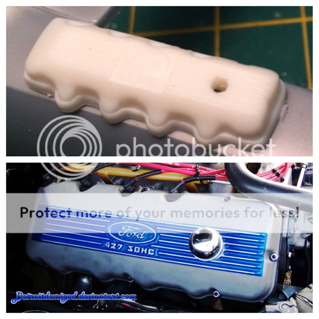

mad mike Posted August 11, 2020 Posted August 11, 2020 So what would you think about this 3d printed one? 1/24 scale.
