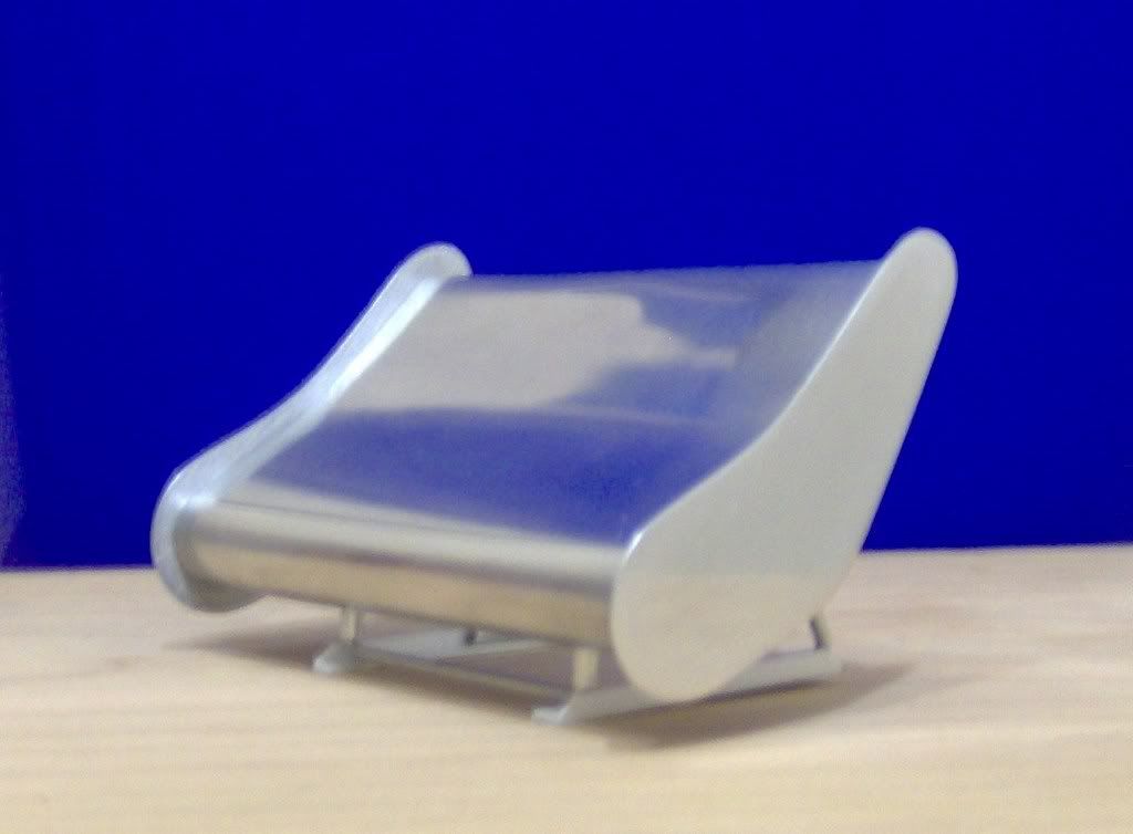

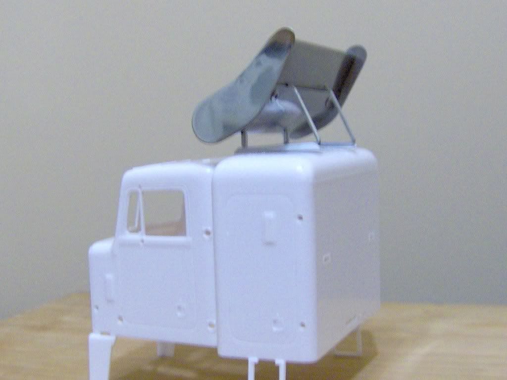

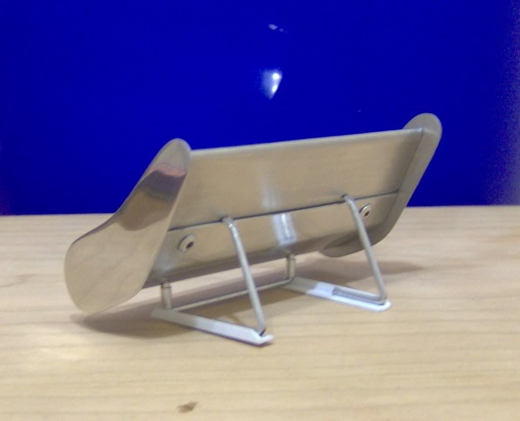

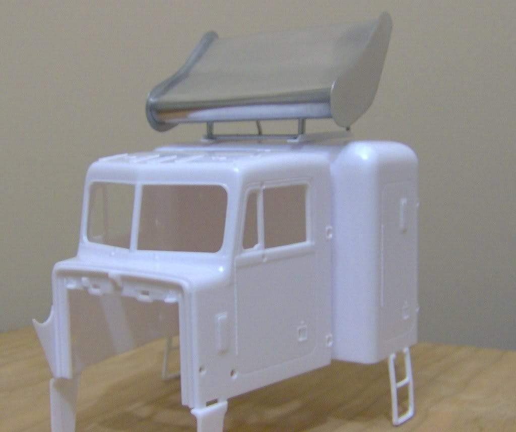

chevymaniac Posted May 5, 2007 Share Posted May 5, 2007 Had a few request for Turbo Wings and here's my version of them. This one is at a scaled 44" x 80". Looks a little big sitting on a single bunk snap Pete but I don't have a double bunk to take pictures right now. I'll make them to any size. Go to www.danmodeltruckworld.com for info Later Dan Quote Link to comment Share on other sites More sharing options...

SpreadAxle Posted May 5, 2007 Share Posted May 5, 2007 Wild Child, Dan's wing in the pic is a good example of the size I tend to see on larger, say 60", flattop sleepers. Raised roof sleeper wings tend not to be as tall. You could use it on a cabover, just not the Kenworth K100 aerodyne as it might be too tall. Quote Link to comment Share on other sites More sharing options...
