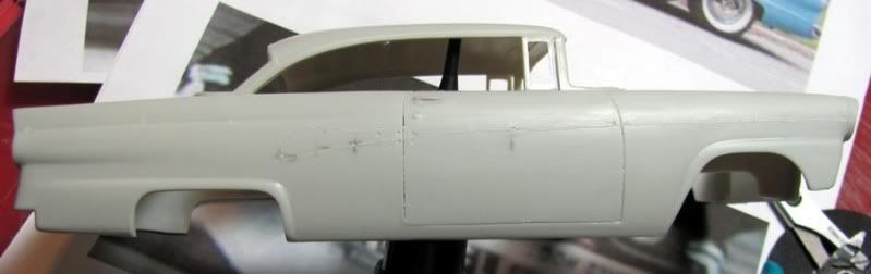

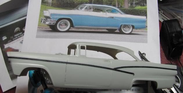

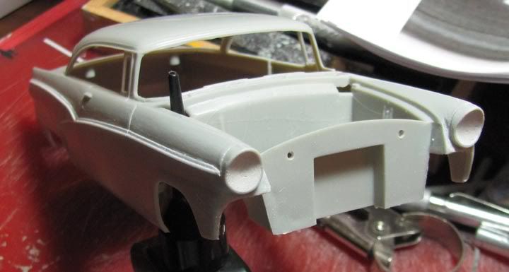

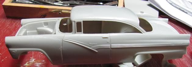

MarkJ Posted September 3, 2011 Posted September 3, 2011 With this model I will try to depict the 1956 Southern 500 winner. Here is the kit and some reference and wip pics. I will have to remove the Victoria moldings and add Customline moldings to depict the real car.

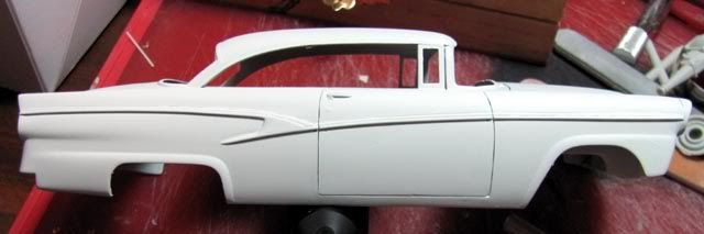

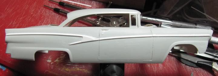

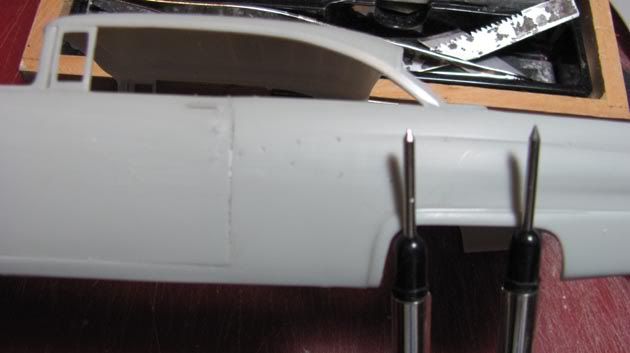

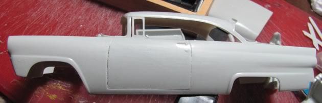

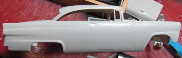

MarkJ Posted September 4, 2011 Author Posted September 4, 2011 I Need to add the customline trim so first I lay down some narrow tape and mark above the tape with a tinydrill bit. Then with the dividers I transfer the drill marks to the other side of the car I layed the first tape down below where I wanted the moldings. I then remove that tape and install new tape right on top of the drill marks on both sides of the car. I then use a #11 blade to scratch along the bottom edge of the tape on both sides to have a guide to show me where to glue the moldings.

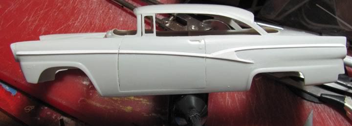

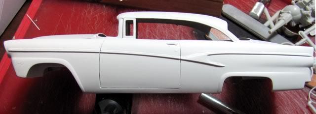

MarkJ Posted September 4, 2011 Author Posted September 4, 2011 I used .010 X .060 styrene strips for the molding then added .025 styrene rod at the bottom edge of the strip to give the molding a more realistic look. I filled in the area where the two moldings meet with squadron white putty. I will make a customline decal to be placed in this area after it is bare metal foiled.
FordRodnKustom Posted September 4, 2011 Posted September 4, 2011 Nice scratchbuilding work on the side trim. Looking forward to watching this build progress.

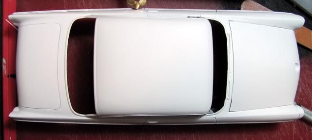

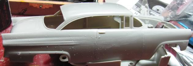

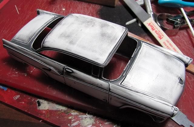

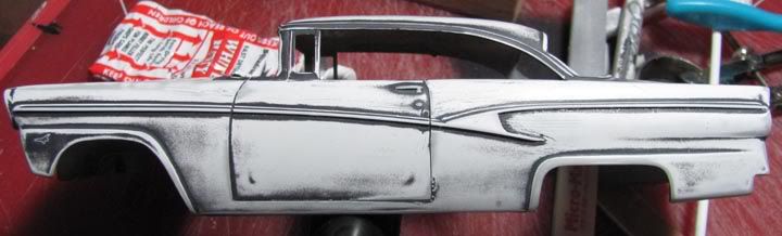

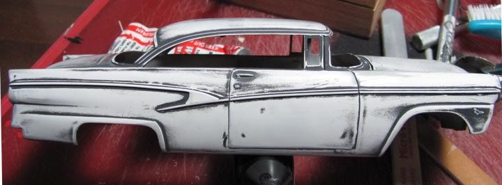

MarkJ Posted September 5, 2011 Author Posted September 5, 2011 I layed down the first primer coat and the sanding guide coat and sanded it to prepare for the hopefully final primer coat.
W-409 Posted September 6, 2011 Posted September 6, 2011 Really nice work again, Mark! That looks good. I like how you modified the side trim to match the real car. Nice job with it. Looking forward to see more work with it. Great start. Where you find these decals, I'd like to build some Nascar racer also, but I'd like to have decals for that too.

MarkJ Posted September 6, 2011 Author Posted September 6, 2011 Hopefully this is the last primer coat.

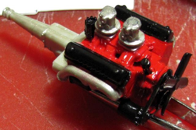

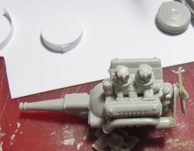

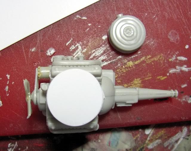

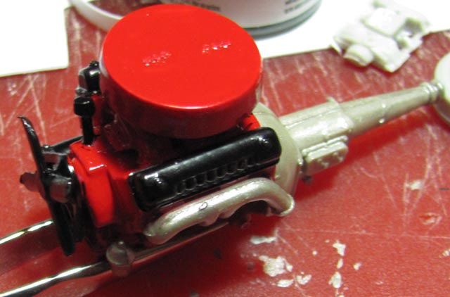

MarkJ Posted September 9, 2011 Author Posted September 9, 2011 Pics of the beginnings of the powerplant. The big round white air cleaner depicts the Purolator filters they used back then.

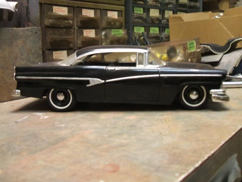

MarkJ Posted September 13, 2011 Author Posted September 13, 2011 I got the body finished as far as painting goes. need to take and post pics.
