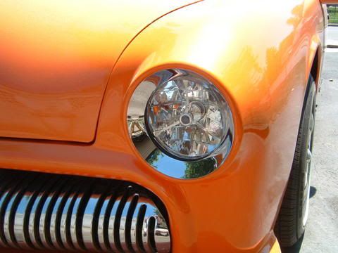

MikeMc Posted February 27, 2012 Share Posted February 27, 2012 So, how can the headlights on the Hudson be Frenched? Mount them from inside the fenders.....filing , grinding or a different set of lights a bit smaller....see how these "sit back"? Quote Link to comment Share on other sites More sharing options...

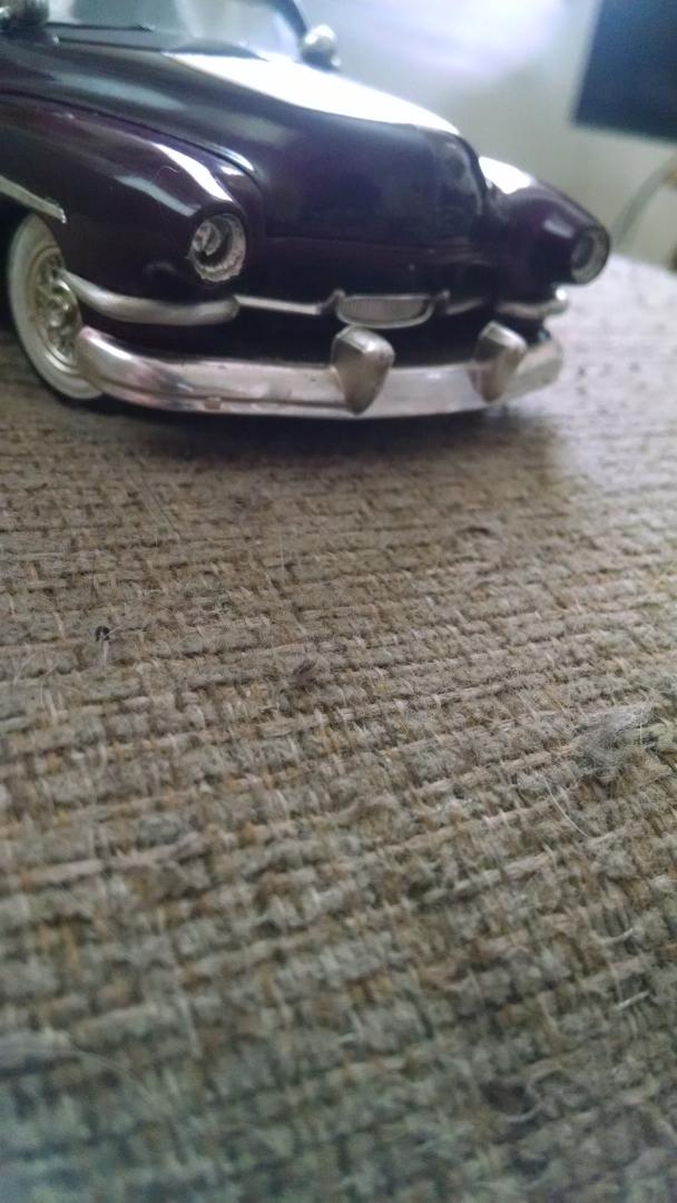

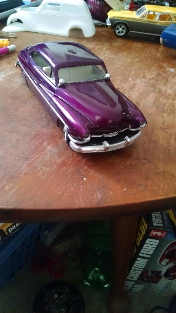

Stevetbird Posted January 31, 2018 Share Posted January 31, 2018 If that is Frenching then what would you call these lights on my 50 Merc? Tunneled? Extended? Quote Link to comment Share on other sites More sharing options...
espo Posted January 31, 2018 Share Posted January 31, 2018 I would think of them as both. In the '50's tradition the headlight moldings were usually in the stock position and welded to the body. In the 1:1 car this offered a problem when it came time for the mounting of the headlight its self. Remember these mostly chromed trim rings were one a styling element but also covered the mechanics of mounting the headlight its self. In that era when inner fender liners were not commonly used the access to the mounting points were easily reached from inside the fender. The headlight mountings and adjustments were just mounted to the back side of the fender. One of the more common used headlight rings for mounting was the '54 Ford and some Mercury cars from that time. The advantage was that the design used had a very slim chrome inner ring between the outer body painted ring and the headlight its self. This would give you easy access to the mounting points plus a touch of chrome. This is just the basics of Frenching a headlight. There is more variables of this technique than sand on the beach. This is an excellent example of the extended look that was also somewhat common of that era. If you look at any pictures of the early work by Barris Kustoms, and George Barris is only one of many who did this type of modifications, it may go a long way to seeing what all was done with headlights and tail lights that was called Frenching at that time. 7 hours ago, Stevetbird said: If that is Frenching then what would you call these lights on my 50 Merc? Tunneled? Extended? Quote Link to comment Share on other sites More sharing options...
