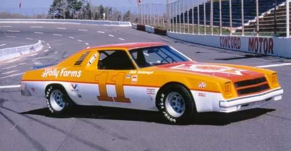

bbowser Posted February 19, 2012 Posted February 19, 2012 This is my first attempt at documenting a WIP here on the forum, in the past I've only posted finished builds. I'm hoping for some constructive feedback / tips / ideas as the build progresses. This is the car I hope to end up with, Cale driving for Junior in 1976, the first of 3 consecutive championship seasons. Cale was inducted into the NASCAR HOF this year which prompted me to model one of his cars since I don't have one in the collection. Cale won 9 races in 1976, including 4 in a row - Richmond, Dover, Martinsville, and N. Wilkesboro late in the season. He won the Cup by nearly 200 points over Richard Petty.

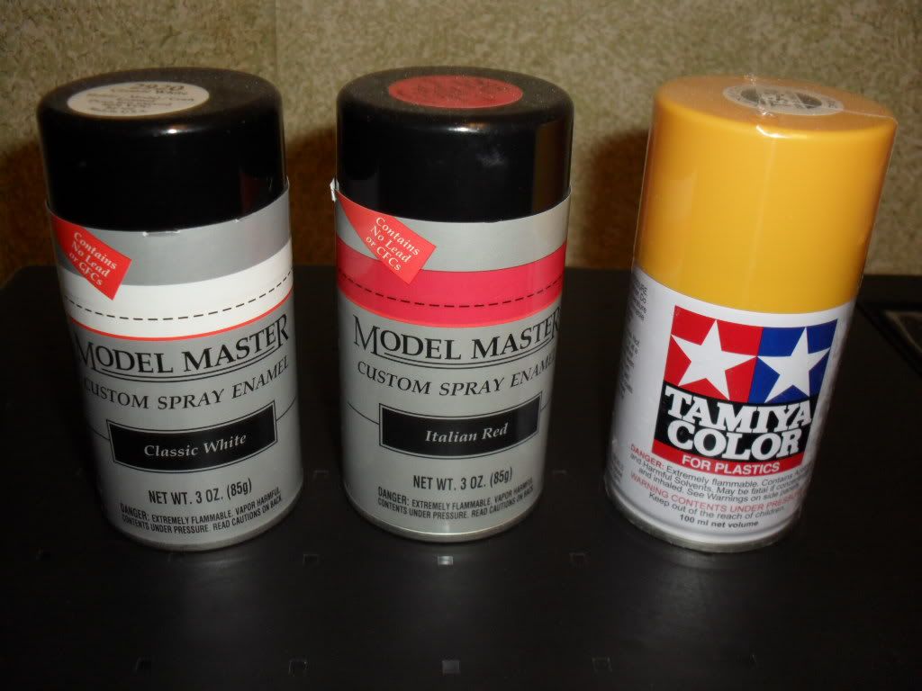

bbowser Posted February 19, 2012 Author Posted February 19, 2012 The basis for this build is the Model King re-issue of the Laguna S3. The body is the best part of this kit. I discovered the rear suspension was leaf springs in the kit, which is incorrect. Cup cars have used coils / trailing arms for years right up to the present day. I decided to use the rear suspension from an AMT kit, maybe not totally correct but a lot closer. These are the decals (Fred Cady from Southernmotorsports) and paint colors I plan to use. I decided on these after cruising Randy Ayer's site and saw a couple of beautiful builds on there using these colors.

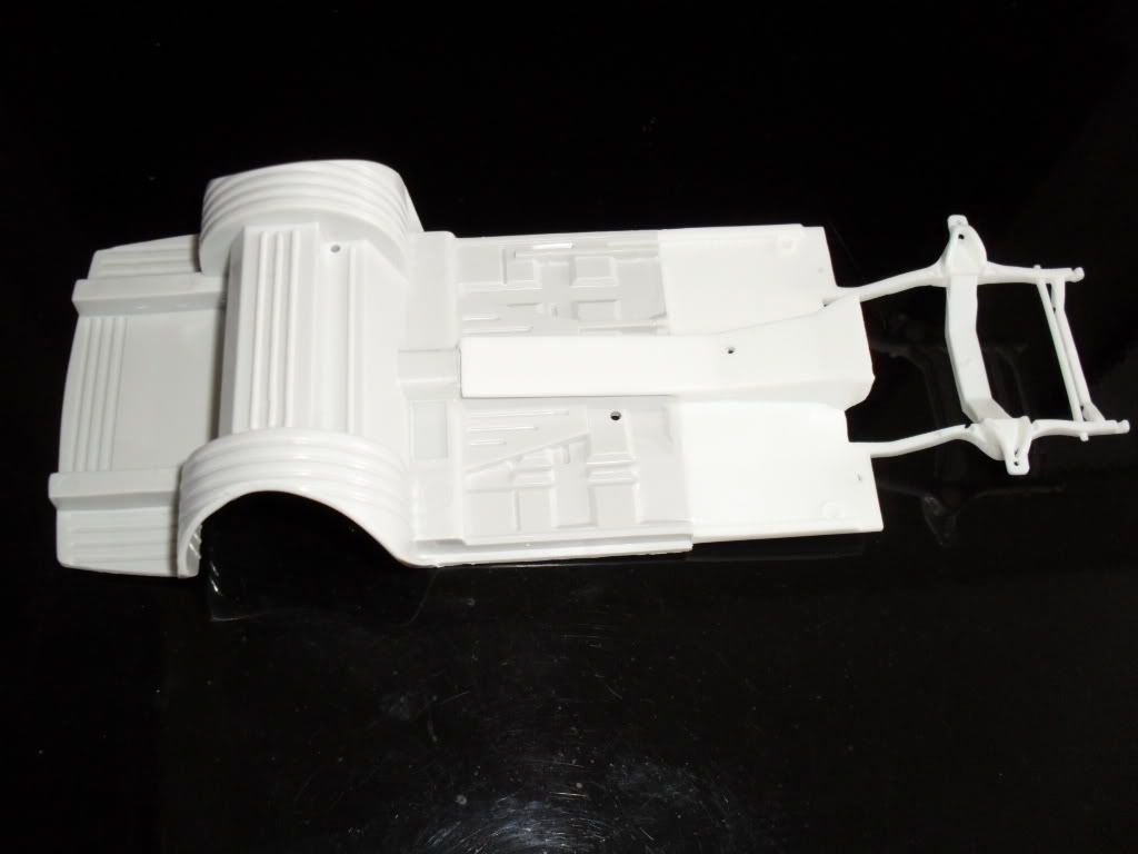

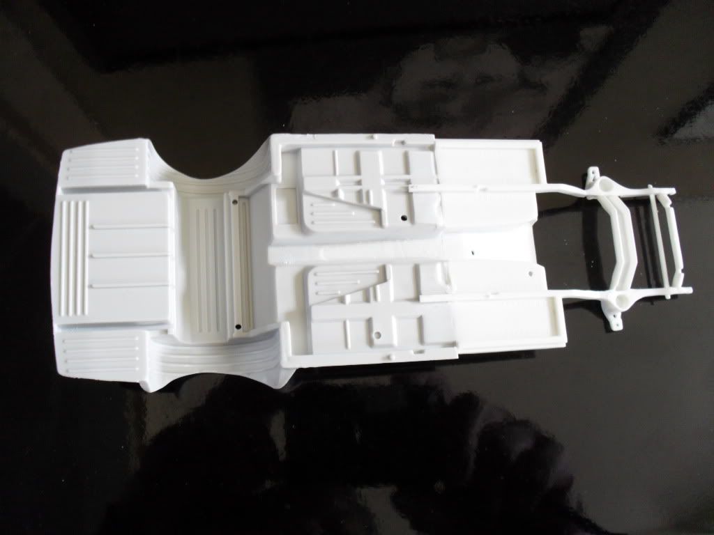

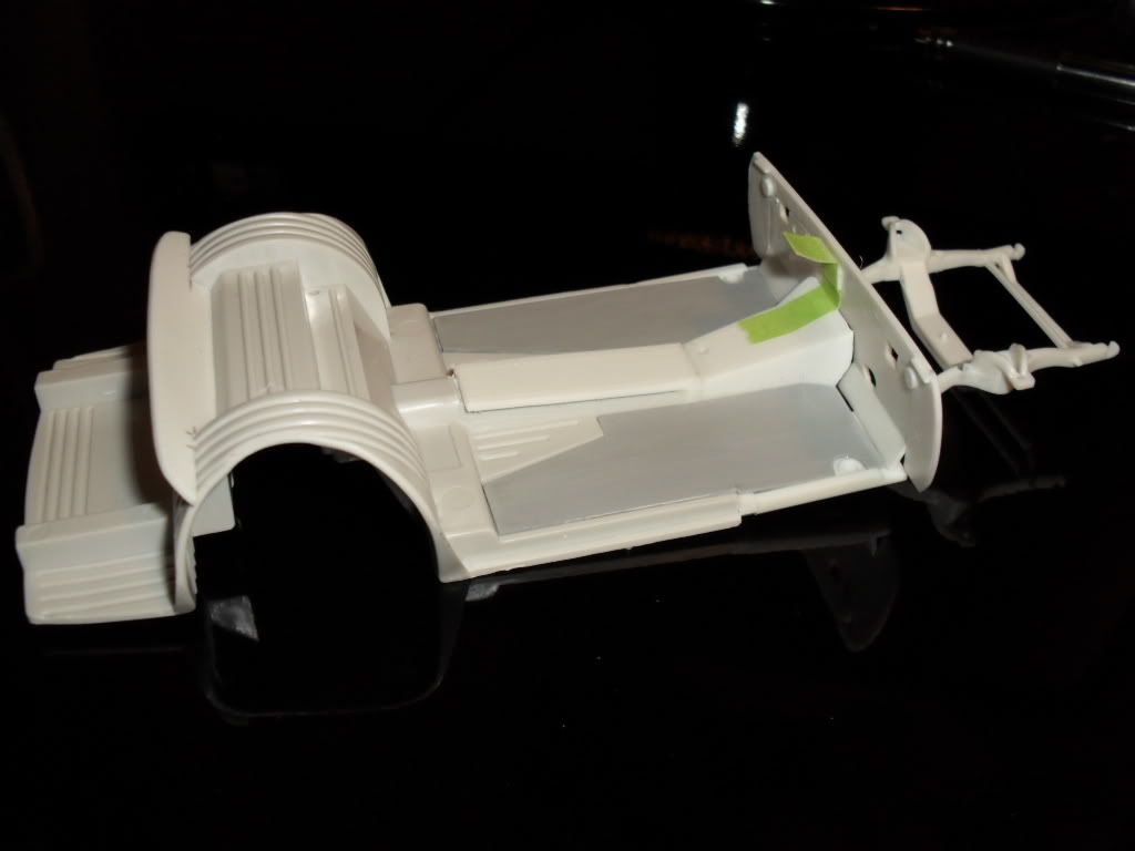

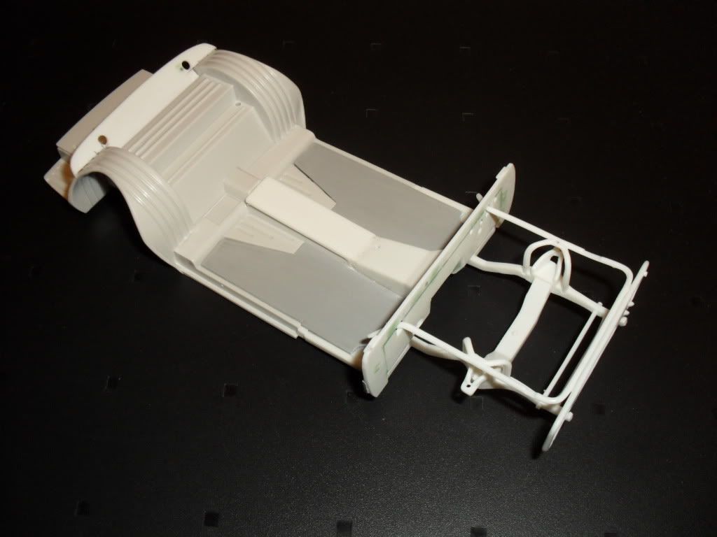

bbowser Posted February 19, 2012 Author Posted February 19, 2012 First order of business is the rear suspension. I checked out Dave Van's fotki site and a couple of others who adapted trailing arms to the MK floor pan, but I decided it would be easier to 'back-halve' the chassis in order to have all the proper pick-up points. In hindsight this may not have been easier! It doesn't show up real well in the photos but the AMT rear portion is light gray and the MK front is white.

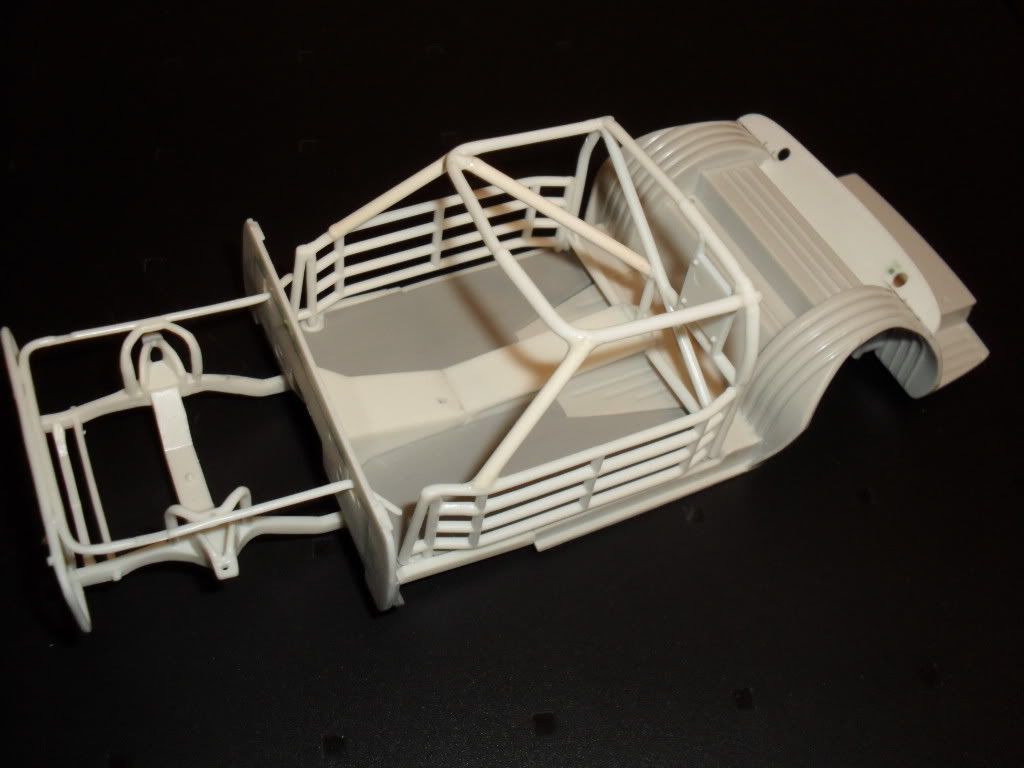

bbowser Posted February 19, 2012 Author Posted February 19, 2012 I had to shave the tops of the wheel tubs quite a bit to fit into the body. I thought I had made careful measurements but it turned out that the wheelbase was about 3mm too long, so I had to go back and slice that much more out of the pan. It's very true, measure twice (3, 4, 10 times) and cut once! Once that was straightened out I cut some thin sheet for the floorboards, both to clean up and add some strength to the joint. You can also see where I've added the firewall (2 pieces from the kit glued together and cut down) as well as the rear bulkhead (also cut down). The Model King kit is definitly NOT a shake & bake, there are lots of fit issues
bbowser Posted February 19, 2012 Author Posted February 19, 2012 where's the orange!!! Dick, the decals and photos look a lot more red than orange to me. The cars I looked at on other sites used the italian red so I think that's what I'm going with?
Kmidd65 Posted February 19, 2012 Posted February 19, 2012 Bruce, I like the paint selections on this one. I have never tried one of these older kits. I definitely will be following this one. One word of caution if I may; lay that Tamiya down first!! If not, you may have some crazing issues with those Testors enamels!! I went with enamel under Tamiya on my Fina Car and paid dearly! I ended up letting it gas out, sanded the Tamiya smooth, applied a Future barrier coat, and then re-shot.... It all worked out in the end but it sure was a lesson for me about mixing paint types! LOL! - Kirk
bbowser Posted February 19, 2012 Author Posted February 19, 2012 Thanks Kirk. I wondered about that, figured on doing some test shots before I laid paint on the body. Appreciate the heads-up!

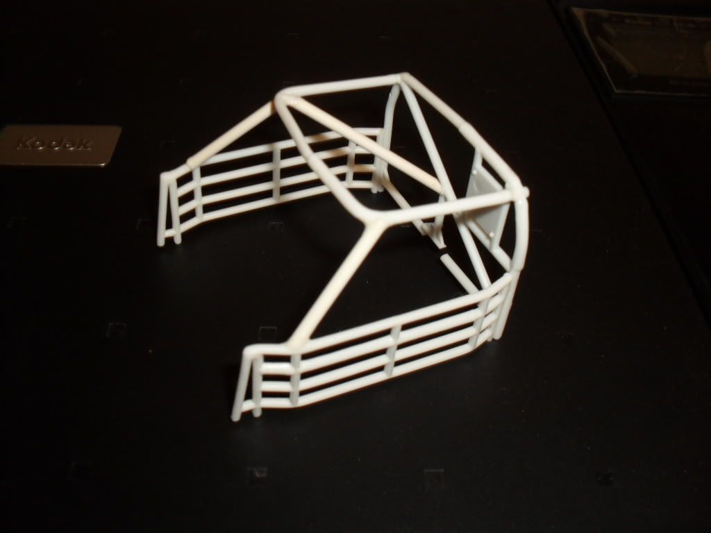

bbowser Posted February 19, 2012 Author Posted February 19, 2012 (edited) Appreciate the help Jacen. Too late to turn back now. This is a '76 so the nose is not an issue. Got a little more done today. Reworked the roll cage to move the A pillars back so they don't hit the windshield. It's not 100% correct but close enough for me. Edited February 19, 2012 by bbowser

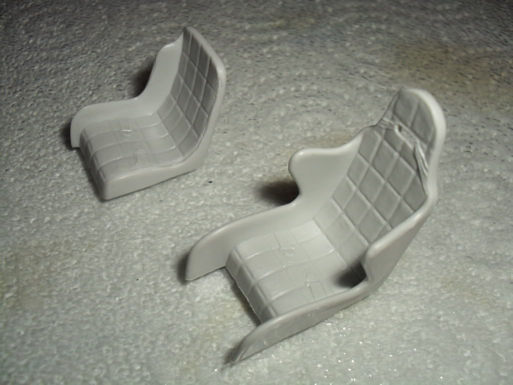

bbowser Posted February 20, 2012 Author Posted February 20, 2012 Thanks guys. This is turning into a real history lesson for me. While we're at it, where would I source an appropriate seat? The one in the kit is pretty bad, complete with the bolster on the wrong side!
weasel Posted February 20, 2012 Posted February 20, 2012 Dick, the decals and photos look a lot more red than orange to me. The cars I looked at on other sites used the italian red so I think that's what I'm going with? i'm cornfused, in your 1st pix, it shows an orange/white two tone with a wide red stripe[which is how i remember it]...you got yer white, red, and yella, no orange...IJS...lol
Kmidd65 Posted February 20, 2012 Posted February 20, 2012 i'm cornfused, in your 1st pix, it shows an orange/white two tone with a wide red stripe[which is how i remember it]...you got yer white, red, and yella, no orange...IJS...lol Dick, I hear what you are saying. The pictures he is showing look a tad more orange than yellow. The problem is that the decals that he will be using are clearly more yellow. I personally would lean towards matching the decals in that case. Just my 2 cents!
bbowser Posted February 20, 2012 Author Posted February 20, 2012 The Tamiya is actually called 'Camel Yellow' which seems to pretty closely match the reference pics I have. The decals are a little more yellow which will contrast a bit. I thought you were talking about the red as being orange.
roadhawg Posted February 21, 2012 Posted February 21, 2012 ... While we're at it, where would I source an appropriate seat? The one in the kit is pretty bad, complete with the bolster on the wrong side! I think one from a Monogram Nascar Monte Carlo Aerocoupe (like an old #3 Goodwrench car) should be close enough. And here is a little something to help you with the details..... http://public.fotki.com/mrchevyblack/model_reference_/stock_car_sportsman/11_cale_yarborough/

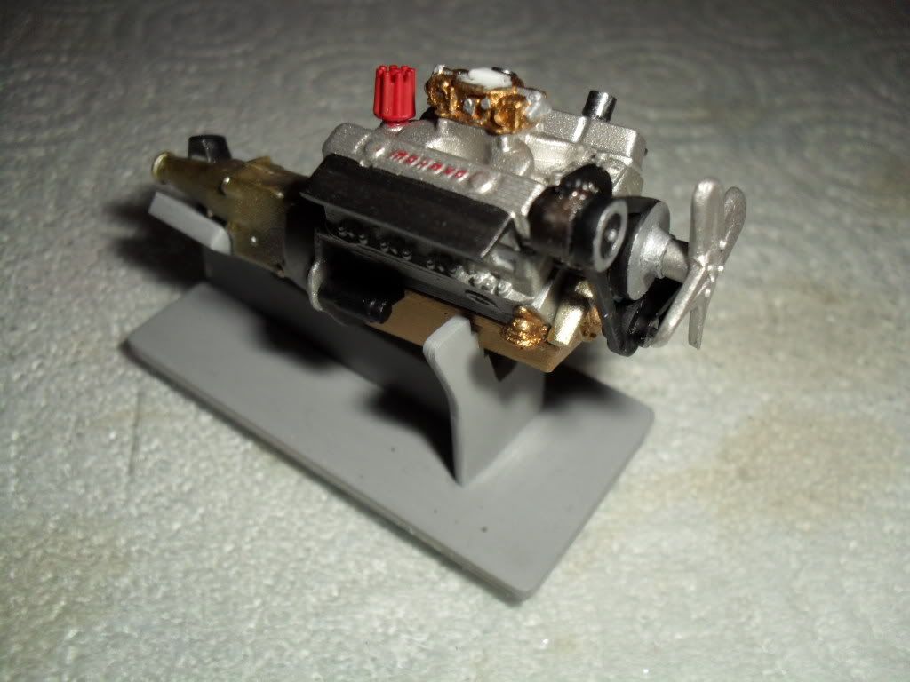

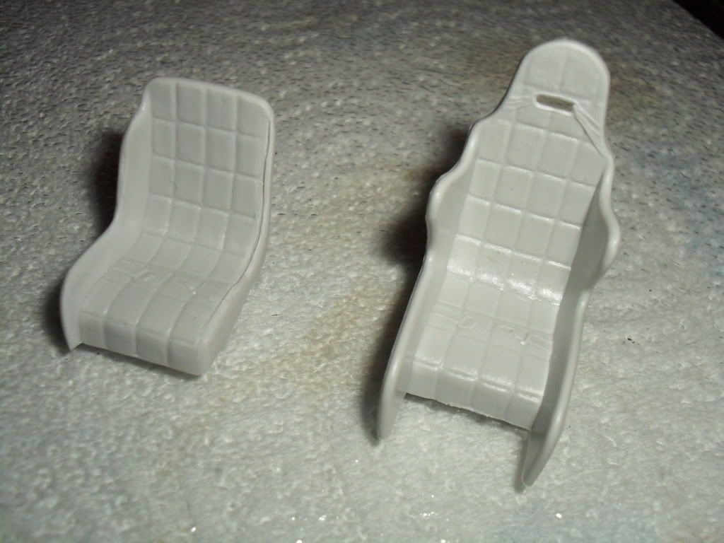

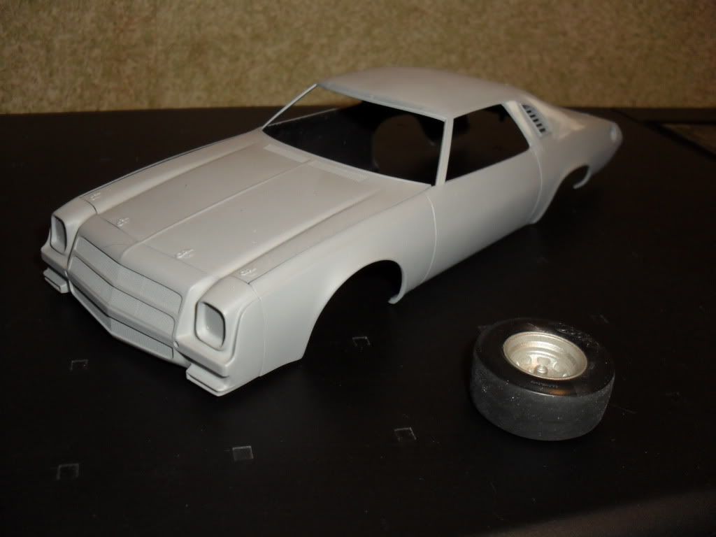

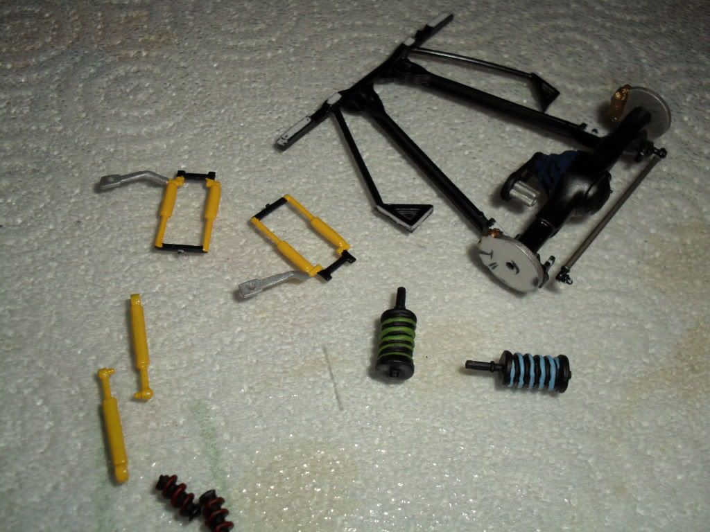

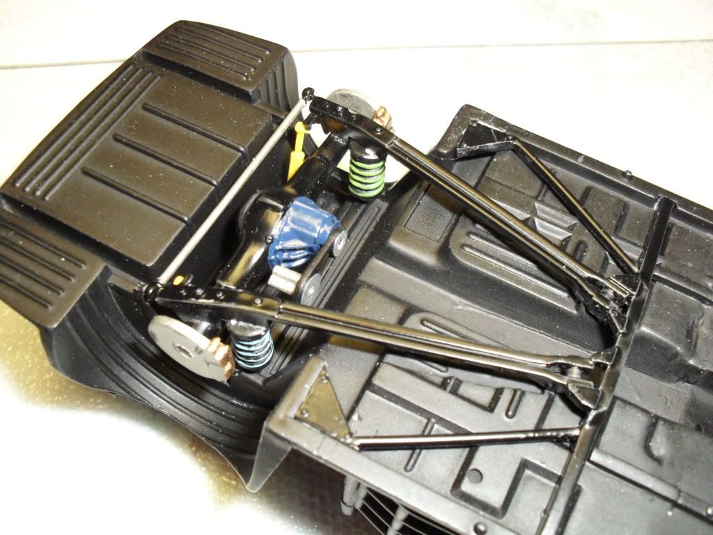

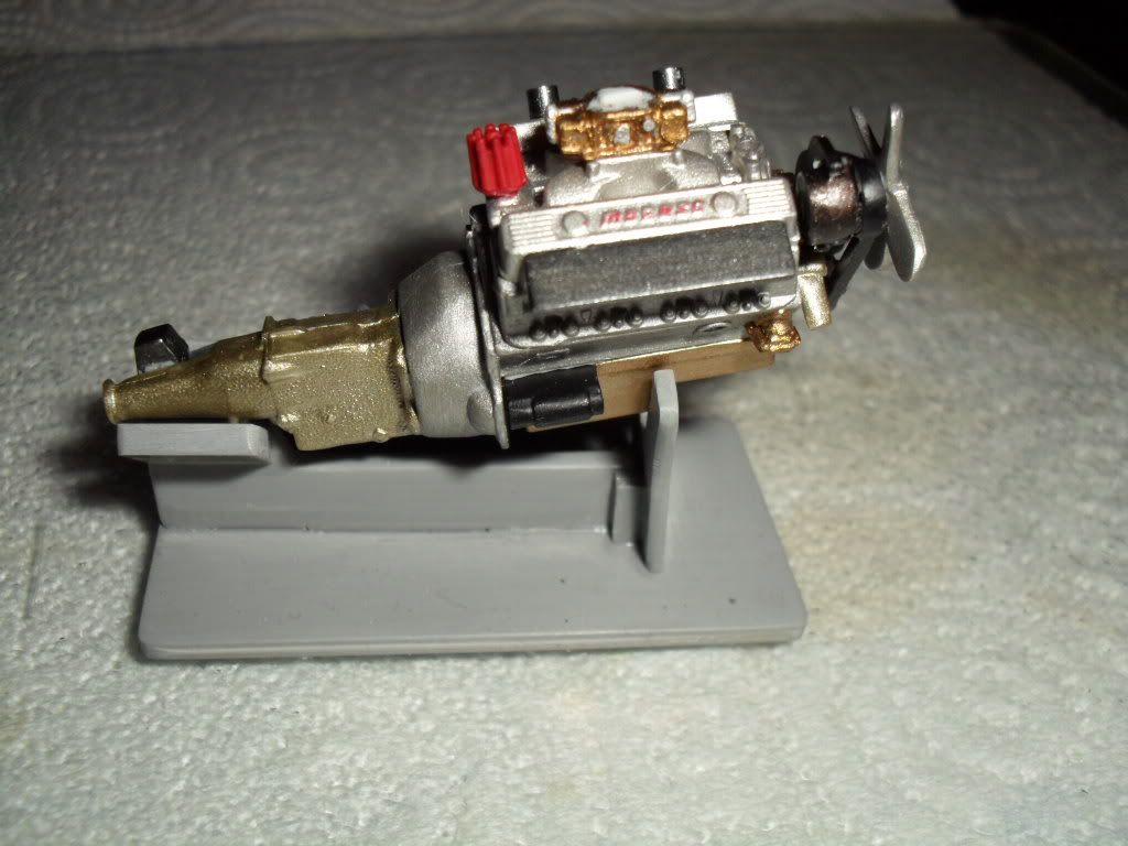

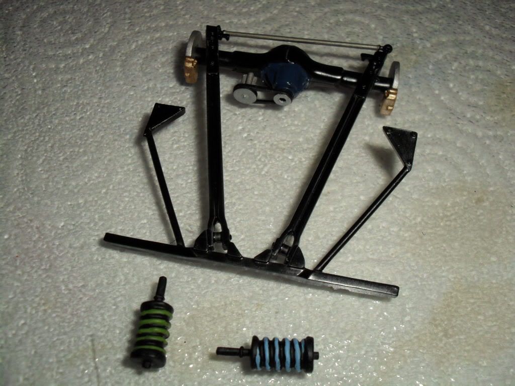

bbowser Posted February 24, 2012 Author Posted February 24, 2012 So I managed to make a little progress the last few days. Using the engine from the AMT Pontiac, OOB - just paint detailing. I can't bring myself to fully plumb an engine on a stock car when the hood is rarely lifted after it goes in the display case. I've also assembled and painted the rear suspension. 2 colors of springs to represent different rate springs used by the teams, color-coded. I cut down the seat from the newer car to represent the older style used back then. Also did some initial clean-up and got a coat of primer on the body. That's it for now, may get a chance to work on it more this weekend. Thanks for looking.

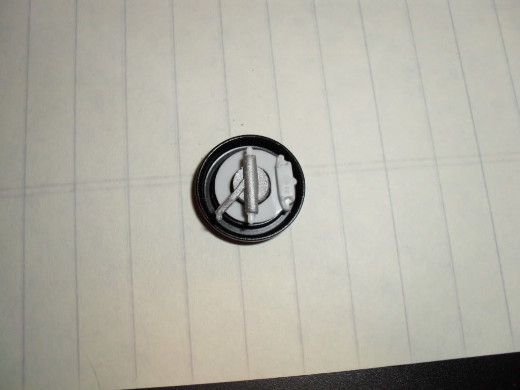

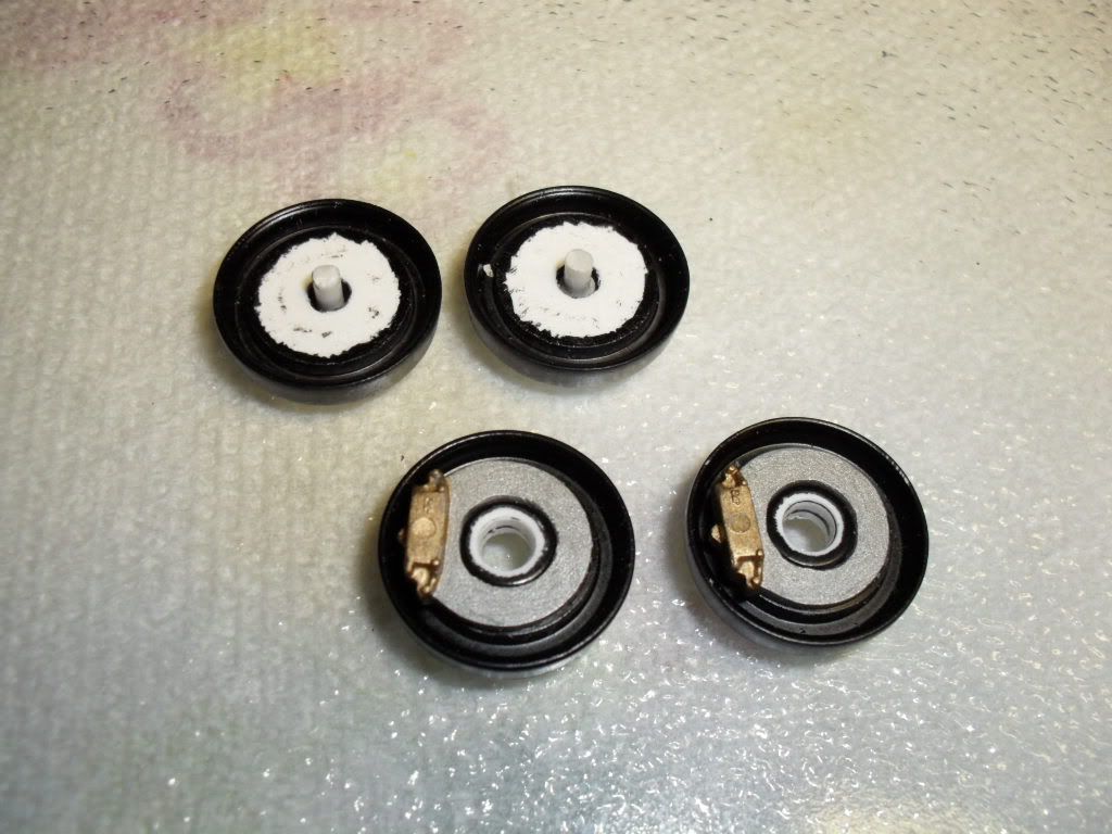

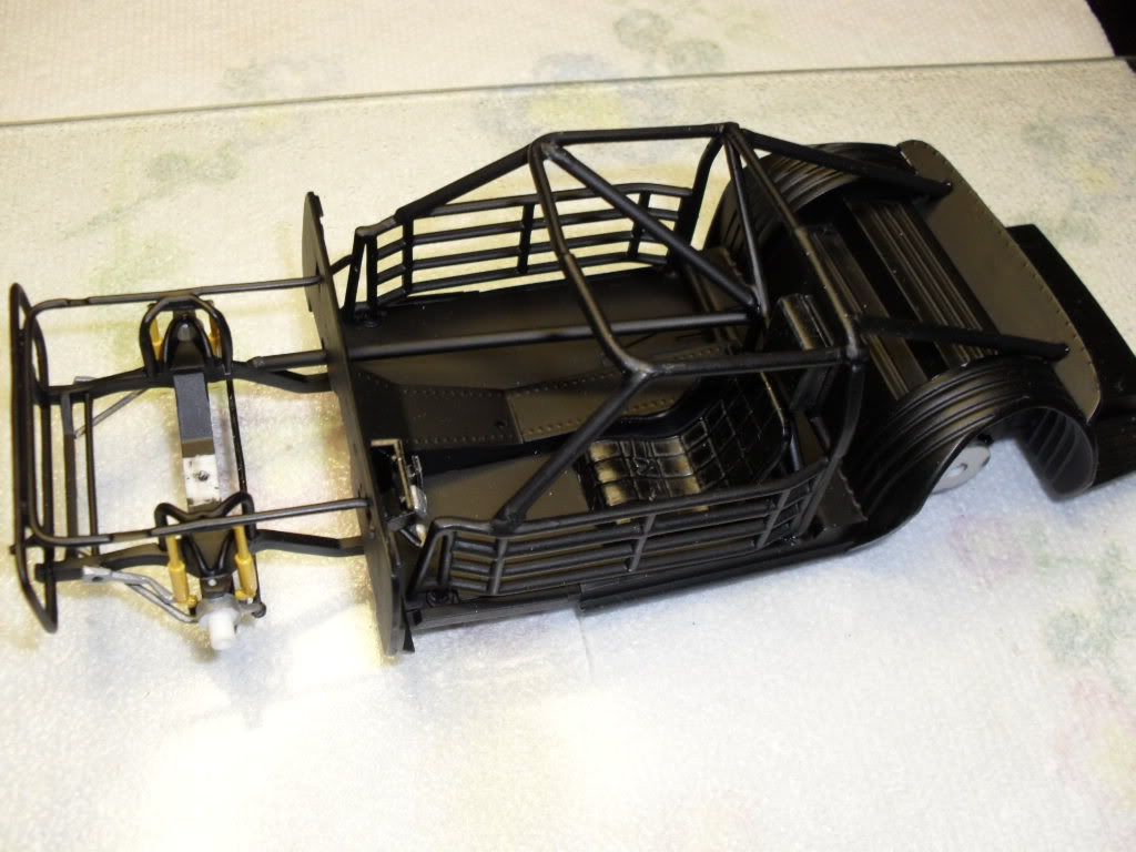

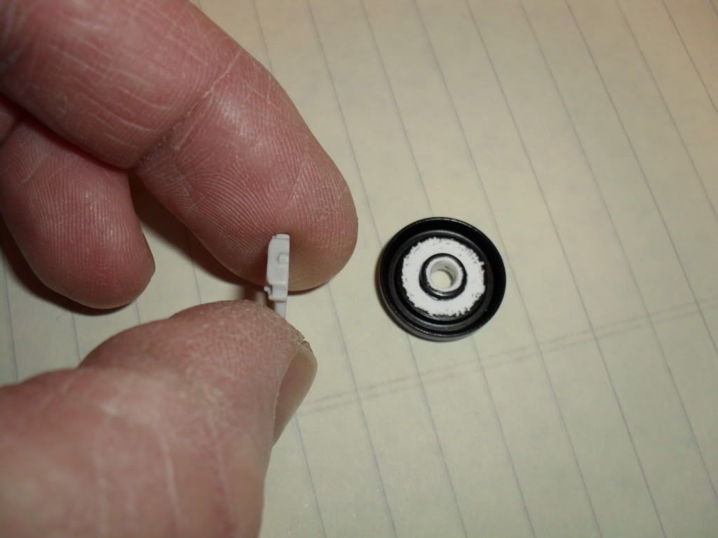

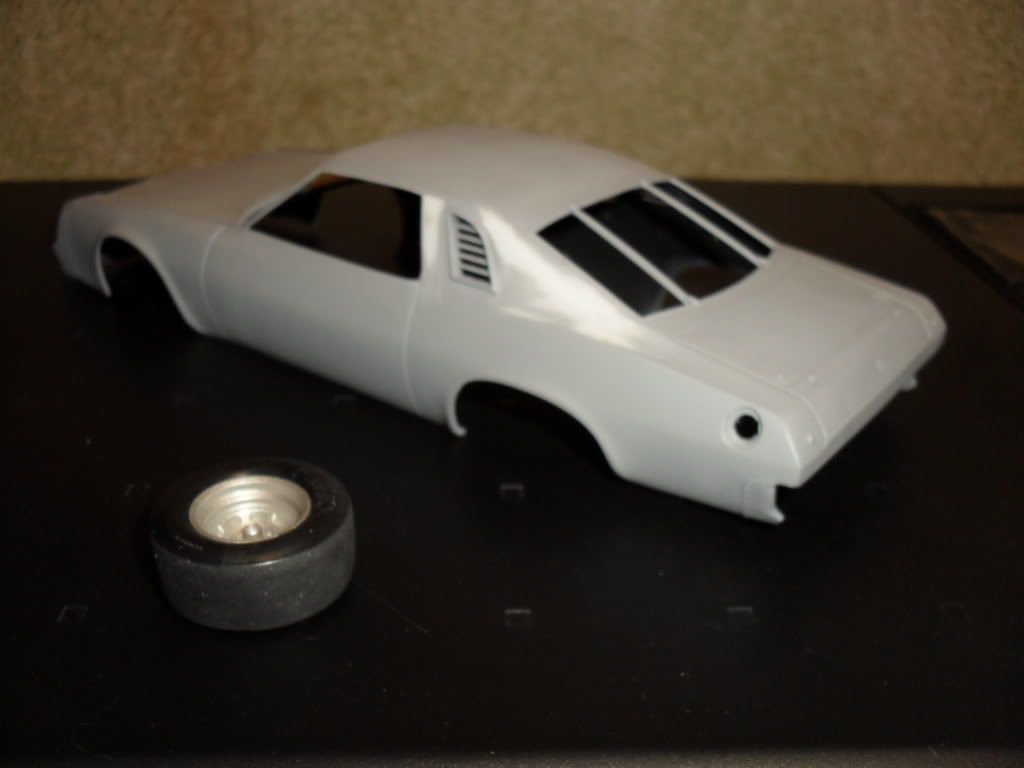

bbowser Posted March 3, 2012 Author Posted March 3, 2012 Finally have had a chance to get back to this one. Most of the chassis and rollcage is complete, got the front & rear suspensions installed. I modified the brake assemblies to fit the wheels. I'm using 1/24 wheels/tires from a Monogram kit as I think they fill the wheelwells a little better. I basically sanded them flat on one side to glue to the wheel backs, and opened up the hub to fit the spindles. Stripped the chrome and painted the wheels silver, with the hubs painted steel and the lugs picked out with gold. Shabo transfers for the Goodyear lettering. With most of the greasy parts done, it's time to tackle the body. Thanks for looking, comments welcome as always.
