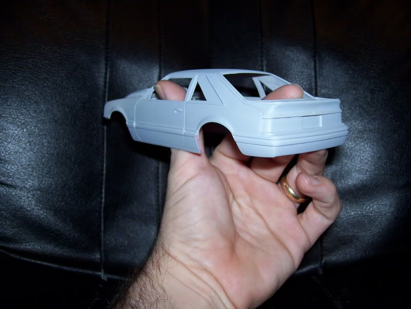

Abell82 Posted June 14, 2007 Posted June 14, 2007 I have an LX hatch I was working on, but it still needs a lot of work to the rear bumper, and a complete front bumper:

white00gt Posted June 15, 2007 Author Posted June 15, 2007 I have an LX hatch I was working on, but it still needs a lot of work to the rear bumper, and a complete front bumper: Great work so far , looks amazing- Looks like your using the 93 cobra body but , is the LX wing scratch made?

Abell82 Posted June 15, 2007 Posted June 15, 2007 No, it is the stock hatch and spoiler from a Café Racer/79 Cobra, reshaped with a styrene sheet filler panel added, to the top.

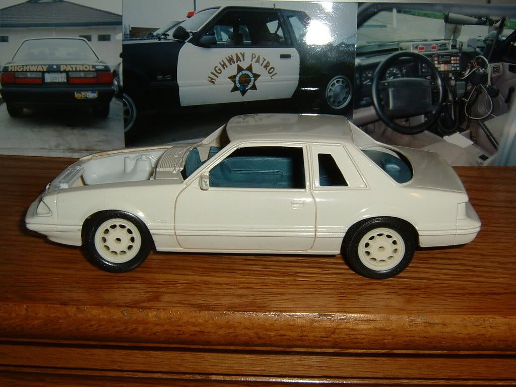

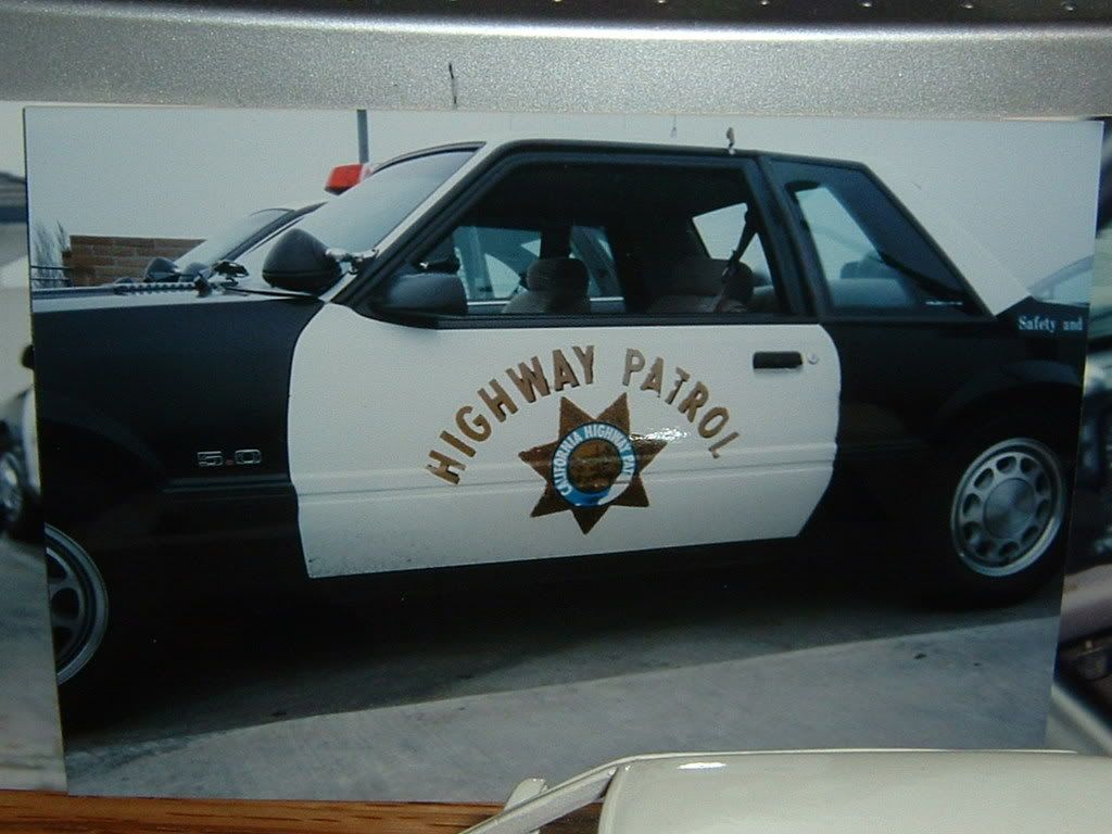

455 Rocket Posted August 12, 2007 Posted August 12, 2007 Rick, like this? I got this one at least 10 years ago and started in it. I'm glad I never finished it though. Art Anderson did a great job on it, but there were a few things that needed to be changed to make it an 87-93 model. The resin body was based off an 84 carborated model. I cut out the original engine bay and added the one from the 92 kit. I also never did like the fact that it had the 84 side trim on it. Now that my skills have greatly improved, when ever I get back to this model I will remove the 84 trim and add the 92 from the kit. I'll just have to be carefull with the door area as CHP deleted the door trim. Good luck on your search.

Zoom Zoom Posted September 4, 2007 Posted September 4, 2007 Yes this will have the correct tail lights too. When we discussed doing this kit, we knew that it would be put under the microscope by those who desperatly want one of these. With the high demand there is for this subject we figured it's well worth the time to get it right. when it came to making the appropriate changes to make the coupe body I went the extra mile to measure every possible angle and dimension. I think you guys will be pleased. I trust yours will have the correct roofline; the gray one in the picture has issues w/the rear quarter window and C pillar angle, and is clearly sub-par versus the AAM body. It will be nice having one that's got all the corrections; I did one myself years ago when I owned an '88 sedan but didn't have the skills to do the correct side trim. To make taillights I took SVO Mustang rear lenses and filled the outer lenses w/superglue to correct them. While everyone still likes the notchback sedan, there's a ready market for resin hatchbacks and GT coupes as well; All American did those, and they too were compromised in some fashion, as the basic Monogram kit has many compromises as well.

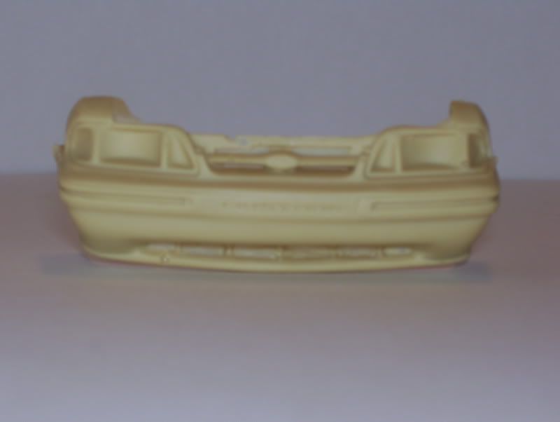

Abell82 Posted September 5, 2007 Posted September 5, 2007 (edited) Edit: Since we are cutting the heck up out of this thread I thought I'd show pics of the finished nose Edited October 22, 2011 by Abell82
