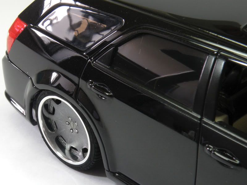

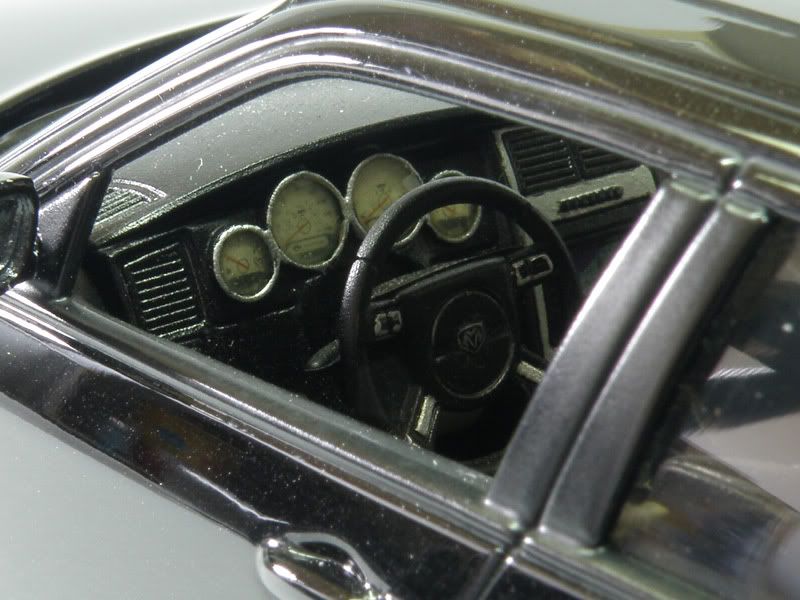

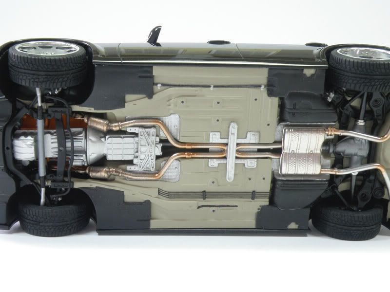

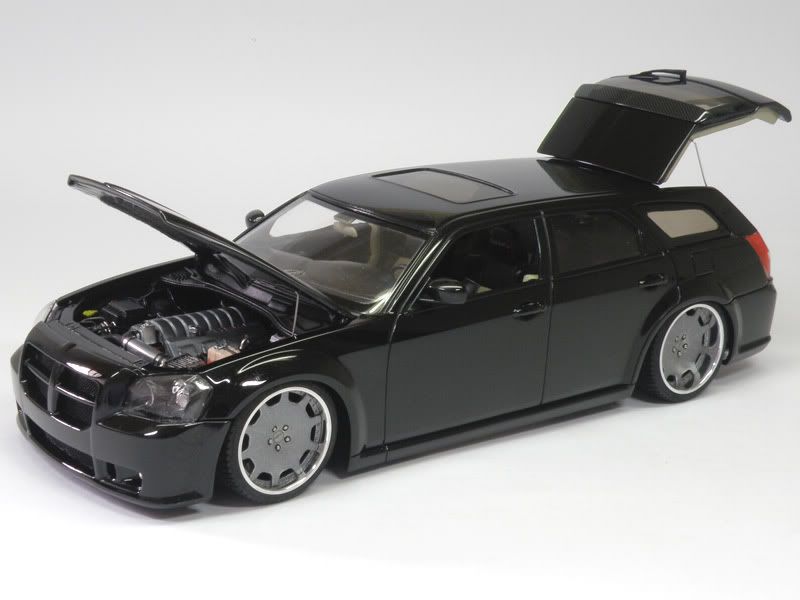

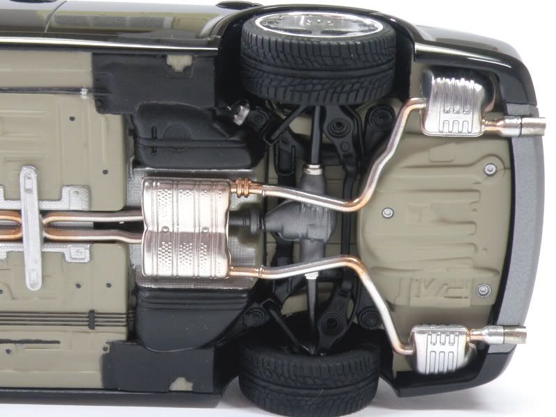

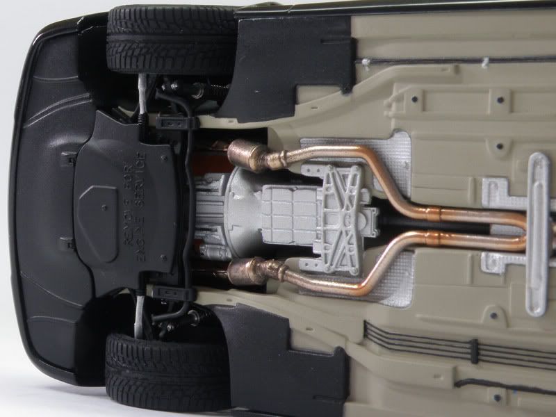

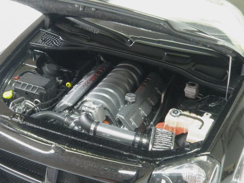

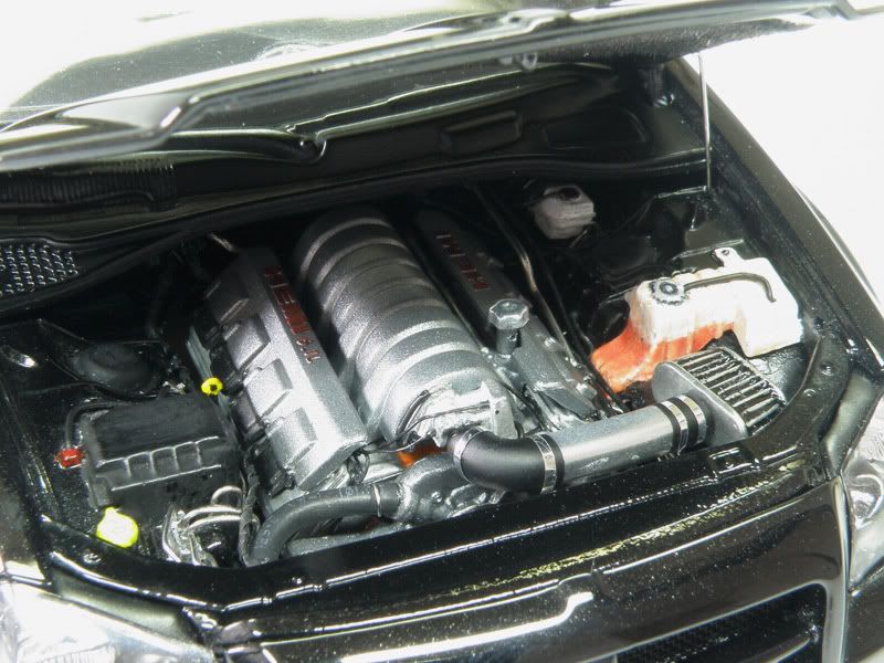

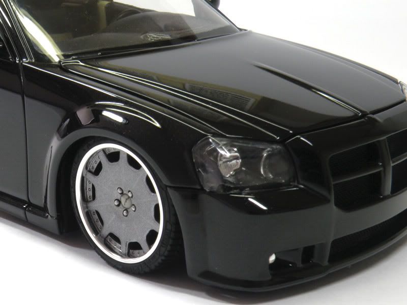

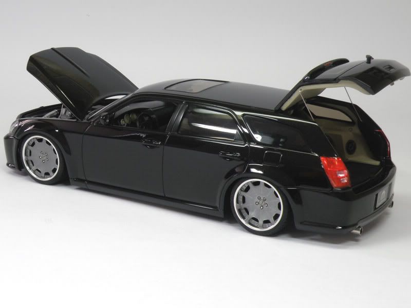

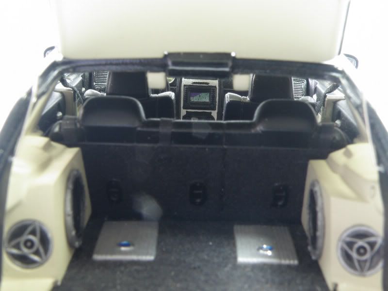

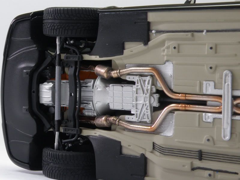

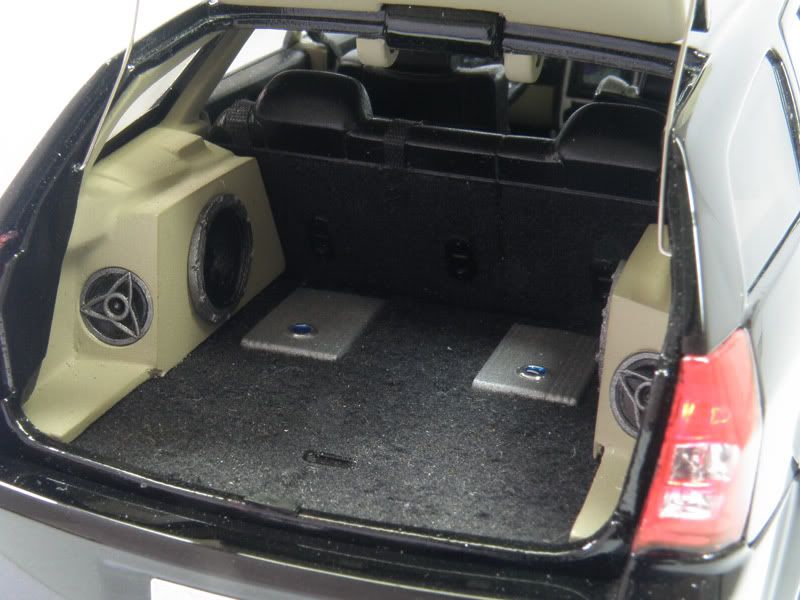

Cesar Bossolani Posted December 31, 2012 Posted December 31, 2012 Happy New Year Fellas!! Finally I finished the most detailed car which I built. It is a great kit to build but need some attention in engine bay and trunk. I suggest you full pre-assembly before paint. A 23 months build and over 400 hours. I didn't finished before because I was studing in 2012 to be a lawyer. Was to be a simple community building group but it goes to another way of detailing. Body - Body trims shaved; - Bumper trims shaved; - Mesh on front bumper; - Wildened and carboned wing; - Black mask in head lights; - Sakatsu fog lights; - Obsidian Schwarz from Mercedes-Benz PPG; - Crystal Antimon Gray from Mercedes-Benz PPG; - D800 PPG; - Satin Clear by Kuriaki; - Licence plate "Mopar" by Geronimo works; - Windows replacement by Cliffo Caddy/Drago. Interior - P.E. seat belts by Mr. Model; - Speakers/Subwoofer/Amps resin by Dan Studio; - Modified trunk; - Chincha metal foil; - Semi-gloss Black Tamiya; - Deck Tan Tamiya; - Flat Aluminum Tamiya; - Flocking; - Scotch Mix 3M on gauges. Chassis - Scratchbuilding coilover set; - One-of-a-kind 20" Aoshima Trafficstar DTX; - Scratchbuilding outter wheels; - Scratchbuilding rear spindles; - Modified rear axe; - Super clean floor as "show car"; - Service cover engine removable; - Exhaust system: HOK Kosmic Krome/PPG D800/Tamiya Clear Orange/Verniz Fosco; - Stainless Steel Tips; - Semi-gloss Black Tamiya; - Deck Tan Tamiya; - Brake tubes: Wire Up 0.5mm; - Aoshima Brembo disk brake (Skyline GT-R 34 Z-Tune). Engine/Engine Bay - Custom 6.1 Hemi; - Scratchbuilding one-of-a-kind serpentine pulley system; - Brake/ABS: Stainless Steel Wire 0.5mm; - Electrical wire revestment: Kyosho micro masking tape 0.4mm - Electrical wire: "cabelinho de biscuit" 0.25/0.30/0.35mm - A/C, DH, Alternador Air Cleaner resin Dan Studio; - Scratchbuilding EFI system - A/C Tubes: Wire Up 0.7/1.0mm e arame de aço inox 0.7mm; - Scratchbuilding Air Intake; - Scratchbuilding dipstick. WIP http://www.modelcarsmag.com/forums/index.php?showtopic=40574 I want thank you to following at here and a special thanks to Cliff Caddy and Drago to all support in this build.
S. Svendsen Posted December 31, 2012 Posted December 31, 2012 That's probably the nicest Magnum anybody has ever built.
sjordan2 Posted December 31, 2012 Posted December 31, 2012 Hard for me to say, because I don't like this car or these kinds of customs, but SUPERB paint and detail, and something you should be proud to show to others and display at home.
bbowser Posted December 31, 2012 Posted December 31, 2012 Excellent build. All your hard work has paid off, you have a right to be very proud.
CJ1971 Posted December 31, 2012 Posted December 31, 2012 1 word..... Maybe 2 words... Just MAGNIFICENT!! Best detailed Magnum I've ever seen! Your efforts & time have paid off immensely bro! Absolutely well done!! Saude Cliffo

scalemodelworld Posted December 31, 2012 Posted December 31, 2012 Absolutely amazing. Those wheels are sweet.

realgone58 Posted January 1, 2013 Posted January 1, 2013 Crazy clean! I built one of these as well, but just stock straight out of the box. I agree with you about pre-assembly under the hood before painting.
Green Duster Posted January 1, 2013 Posted January 1, 2013 Only thing I can say is WOW! Really like the way you did the speakers in the back. Exterior is great. And the wheels.

Johnny1973 Posted January 2, 2013 Posted January 2, 2013 Thats one sweet Magnum.Nice detail, great wheels,I like the lower stance.Awesome job
