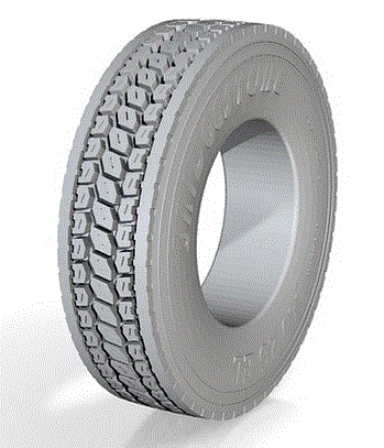

Thatswhatshesaid Posted August 24, 2014 Posted August 24, 2014 OK, I was looking at the wrong pic. Those are nice. It says the are only 20" however.
chuckyr Posted August 25, 2014 Posted August 25, 2014 It says the are only 20" however. They look right.
TRaymo Posted August 26, 2014 Posted August 26, 2014 Bridgstone 726s are the best lug drive you can buy! I'd buy a lot of them. Cast it they will sell!
Petetrucker07 Posted August 26, 2014 Posted August 26, 2014 Id be interested in a few sets right now. Bridgestone steer tires too.

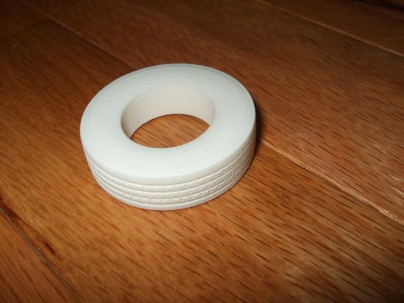

KJ790 Posted August 28, 2014 Author Posted August 28, 2014 I got my first set of 3D printed tires today. I want to make a few tweaks and have them re-printed before I make a mold, but all in all they came out pretty good.
Petetrucker07 Posted August 28, 2014 Posted August 28, 2014 They look good, can't wait for them to be ready to buy

Lownslow Posted September 6, 2014 Posted September 6, 2014 I got my first set of 3D printed tires today. I want to make a few tweaks and have them re-printed before I make a mold, but all in all they came out pretty good. get them printed hollow save yourself some money just put a plug hole on the inside of the "tube" and make the innards hollow then when it comes to molding time just plug the hole with Ca or tape.

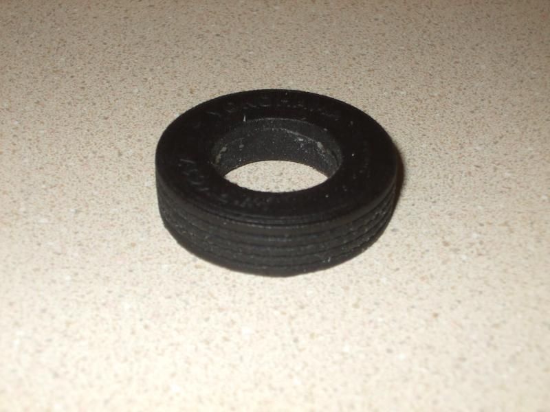

KJ790 Posted September 14, 2014 Author Posted September 14, 2014 First tire fresh out of the mold. All in all I am happy with it. I also have a picture of the tire on one of the new rims I will be casting soon.
Petetrucker07 Posted September 14, 2014 Posted September 14, 2014 Those look really good. Keep us posted when they are available. Have you thought about doing super single rims and tires?

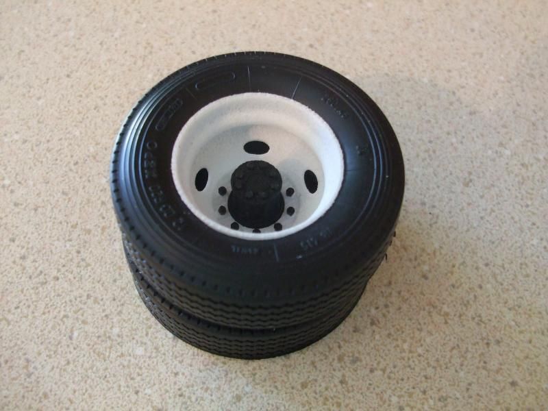

KJ790 Posted September 15, 2014 Author Posted September 15, 2014 Here is a complete wheel set. I have been building up a stock pile of my stemco oil hubs, brake drums, drive hubs, and hub caps. I have 2-hole and 5-hole rims in 22.5" and 24.5" sizes, but I am still working on making molds for all of these.
chuckyr Posted September 15, 2014 Posted September 15, 2014 This appears to be 1/25th scale. You should make those in 1/24th scale for Italeri model trucks.
KJ790 Posted September 16, 2014 Author Posted September 16, 2014 This appears to be 1/25th scale. You should make those in 1/24th scale for Italeri model trucks. They are 1/25 scale, but the 24.5" rims actually fit the Italeri tires perfectly.
Petetrucker07 Posted September 16, 2014 Posted September 16, 2014 If they fit the kit tires, i would call it to scale. If makes you feel better they can be listed as 22" 1/24 instead of 24 1/25.
chuckyr Posted September 16, 2014 Posted September 16, 2014 If they fit the kit tires, i would call it to scale. If makes you feel better they can be listed as 22" 1/24 instead of 24 1/25.It's not whether it makes me feel better, it's proper scale.
KJ790 Posted September 16, 2014 Author Posted September 16, 2014 (edited) It's not whether it makes me feel better, it's proper scale. The problem is that Italeri wheels are not to 1/24 scale. Ever measure one? They work out to 23" in diameter in 1/24 scale. They work out to 24" in 1/25 scale however. Edited September 16, 2014 by KJ790
