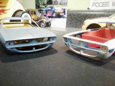

Snake45 Posted September 4, 2014 Posted September 4, 2014 Does anyone make an improved grille for the AMT/MPC '72-'74 Cudas, or at least the headlight buckets? I have a couple of these I'd like to build but I just can't stand the way the headlights look. Or does anyone have a suggested fix for the area? I can't quite figure out how to fix the mess.
freakshow12 Posted September 4, 2014 Posted September 4, 2014 I would drill the headlight holes and use buckets/ lenses from either the new cuda or a rm 69 camaro
Snake45 Posted September 4, 2014 Author Posted September 4, 2014 I thought of that but the shape of the headlight surrounds are different between the '70 and the '72-'74. I'm thinking of maybe backing up the area with several thickness of styrene, drilling out to set the headlights deeper into the area, and then trying to "cone" out the area either with a drill or by filing. Might not be 100% accurate but almost anything would have to look better than the kit treatment of the area.

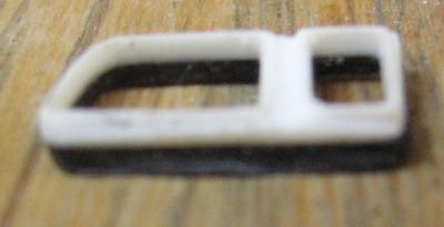

ChrisPflug Posted September 9, 2014 Posted September 9, 2014 I made some light buckets from an AMT Duster grille
mikelo Posted September 9, 2014 Posted September 9, 2014 Let me see if I can remember to get some pics. It would be easy to add the headlights of your choice with the original front. I still have found no reason for why they did that. Mike

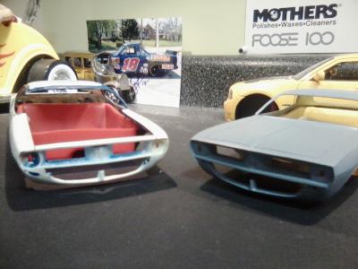

mikelo Posted September 10, 2014 Posted September 10, 2014 I found them. The original one is in white plastic but was painted blue and had the custom nose glued on with tube glue. I think you can still see how the area around the headlight was more correct than it is now (the one in primer). Mike

caine440 Posted September 10, 2014 Posted September 10, 2014 I drilled these out and used an AMT Duster grille for the parts. Not the best but it still loks better then the stock kit I started with.

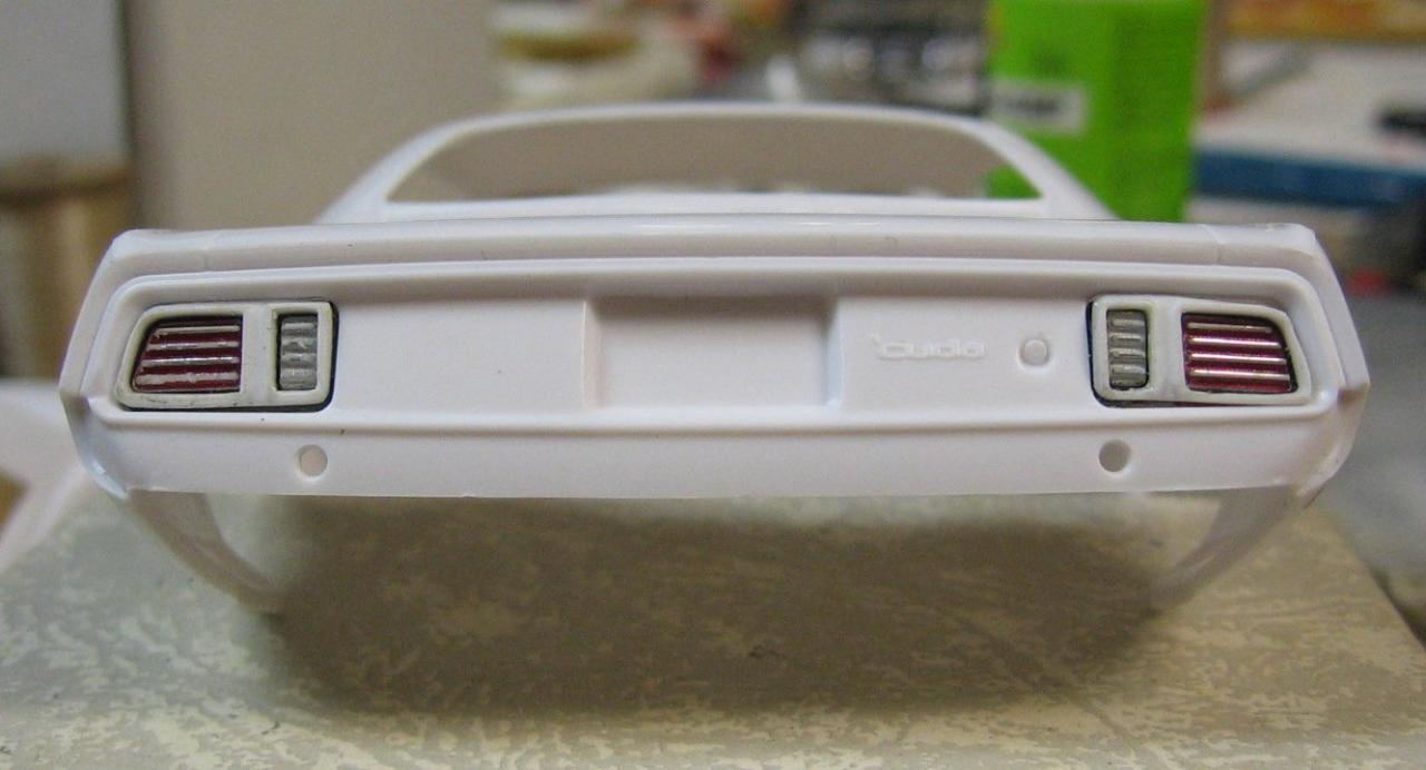

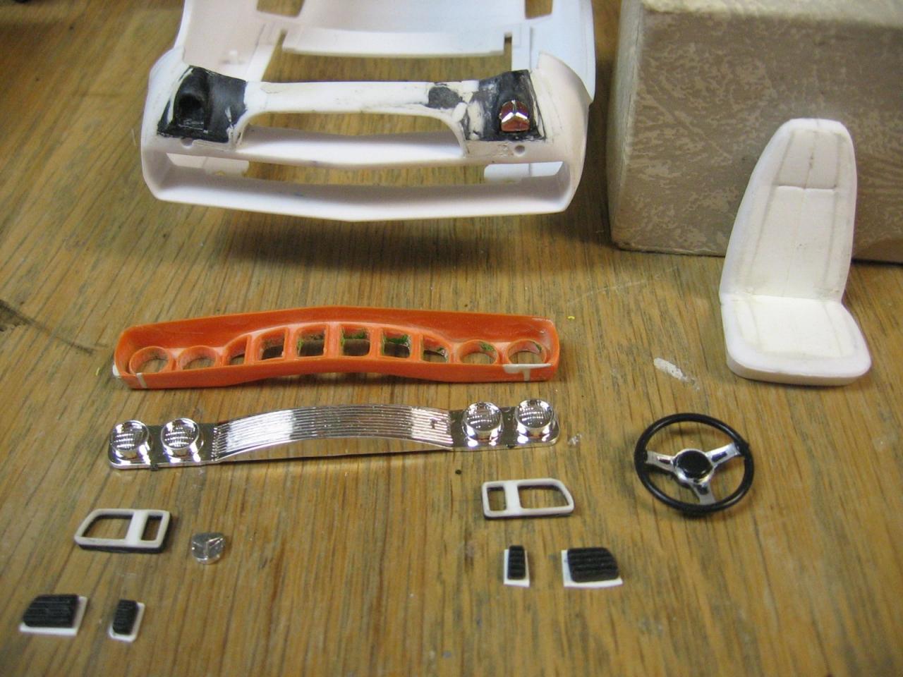

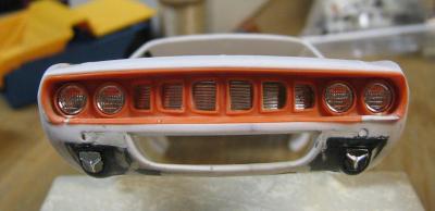

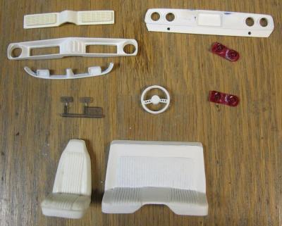

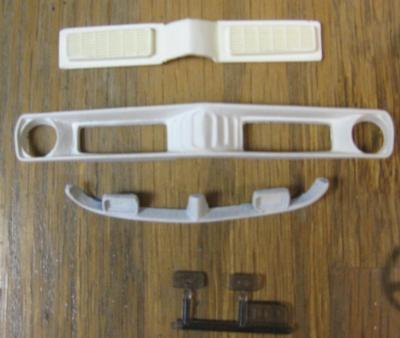

VRM Posted September 11, 2014 Posted September 11, 2014 Here are the '72-74 updates for the Revell Cuda. Not sure if the bumper updates are needed, but they might be helpful. Feel free to comment or suggest. '71 Cuda up after this... Steve

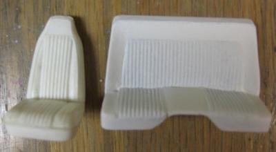

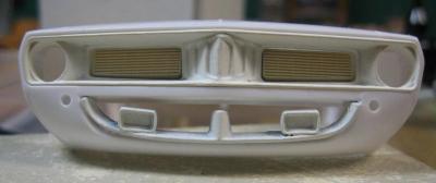

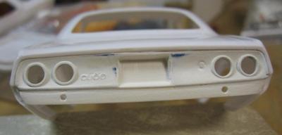

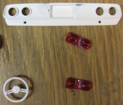

VRM Posted September 11, 2014 Posted September 11, 2014 Here are the '71 parts to convert the Revell Cuda. He said there is still about a weeks worth of work left to finish. Feel free to comment or suggest... Steve
Snake45 Posted September 11, 2014 Author Posted September 11, 2014 Those '72-'74 headlight buckets look 100% better than the kit parts, but it looks like the headlights might sit out too far. Or do they really sit back in those buckets a bit, like the real ones?
VRM Posted September 12, 2014 Posted September 12, 2014 On 9/11/2014 at 10:48 PM, Snake45 said: Those '72-'74 headlight buckets look 100% better than the kit parts, but it looks like the headlights might sit out too far. Or do they really sit back in those buckets a bit, like the real ones? The headlights buckets are from the '70, so they should sit at the same point. I think it will be just a bit inside the grille edge. They are not recessed into the grille section, but they will look pretty close.
