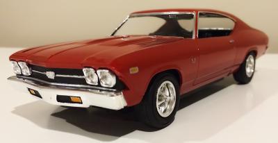

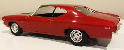

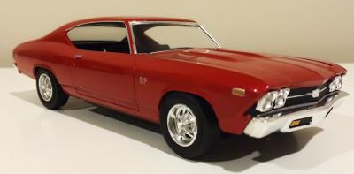

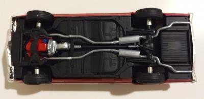

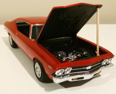

taaron76 Posted November 23, 2014 Author Posted November 23, 2014 Finally finished the Chevelle... Changed the wheels out, seemed to look better than the other ones. A few issues with the stance, but not too bad. This was my first attempt at BMF, so the next one will come out much better. Turned out to be a pretty good build. I'll take some more pics tomorrow with some natural sunlight. Thanks! Tim

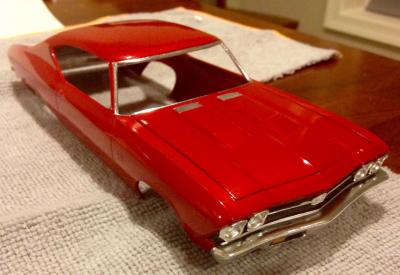

mustang1989 Posted November 23, 2014 Posted November 23, 2014 Man Tim that finish looks awesome! How in the hell did you get such an amazing gloss finish using MM acrylic gloss? I have YET to have mine get any where NEAR that shiny and understand there's a common problem with that. HInts and suggestions would be welcomed. Again, awesome job on this build! She sure is purdy!
taaron76 Posted November 23, 2014 Author Posted November 23, 2014 Man Tim that finish looks awesome! How in the hell did you get such an amazing gloss finish using MM acrylic gloss? I have YET to have mine get any where NEAR that shiny and understand there's a common problem with that. HInts and suggestions would be welcomed. Again, awesome job on this build! She sure is purdy! Hi Joe! You are from my home town of Corpus Christi! As far as the gloss, I just put 3-4 really good coats of clear on it, wet sanded and polished it out. Hopefully the pics tomorrow in the sun will help some of that silver below the clear red come out. Silver-clear red-clear coat was all I did. I use a 4 inch buffing wheel on the spindle of a Dremmel. The buffing wheel only get so much pressure before it won't spin any more so it doesn't burn the clear. Prior to that, I just wet sanded flat, then polished with Novus #2. Thanks for the compliments! Tim
