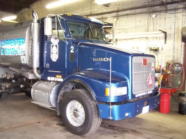

sourkraut Posted February 5, 2008 Author Share Posted February 5, 2008 I forgot, real Marmon? I see one every morning when I walk into the shop at work! Pictures when Photobucket comes back up! Quote Link to comment Share on other sites More sharing options...

sourkraut Posted February 7, 2008 Author Share Posted February 7, 2008 I thought I posted this already? Oh well, here goes again! 1994 Marmon SB57L, 3306 Cat. 8LL trans, #40,000 Eaton rears on Hendrickson RTE and 11.00R-24.5 on spokes. #16,000 Eaton front axle with #16,000 multi leafs riding on 385/65R22.5 4500 gallon fuel oil tank. Works every day in the winter. Quote Link to comment Share on other sites More sharing options...
