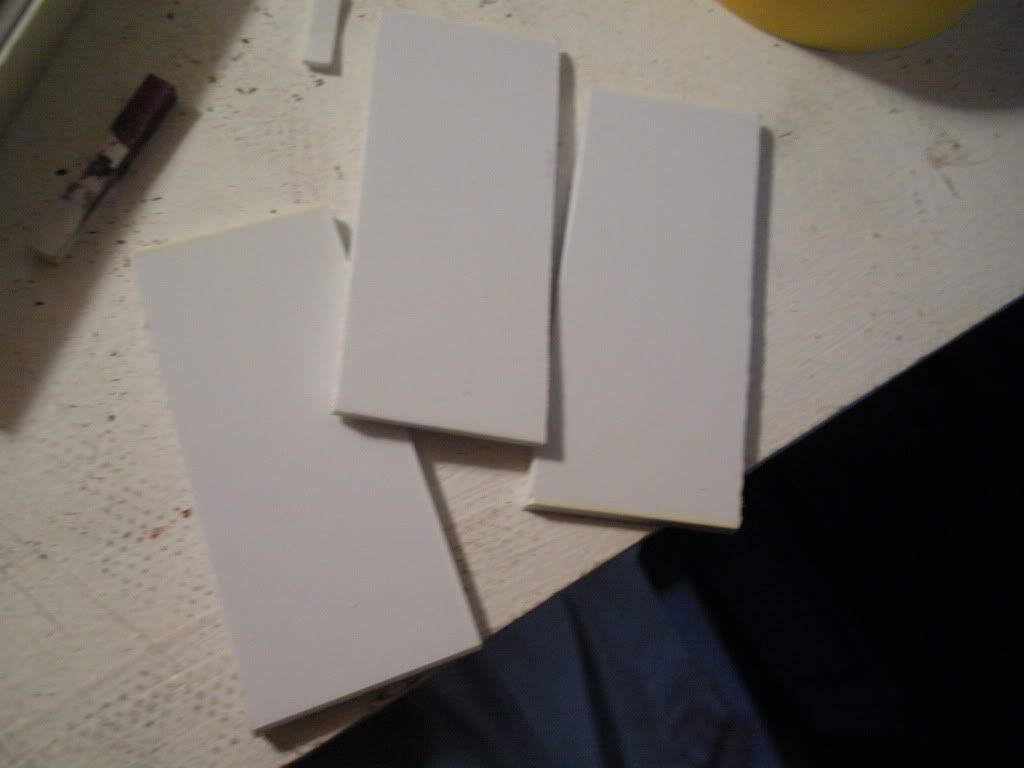

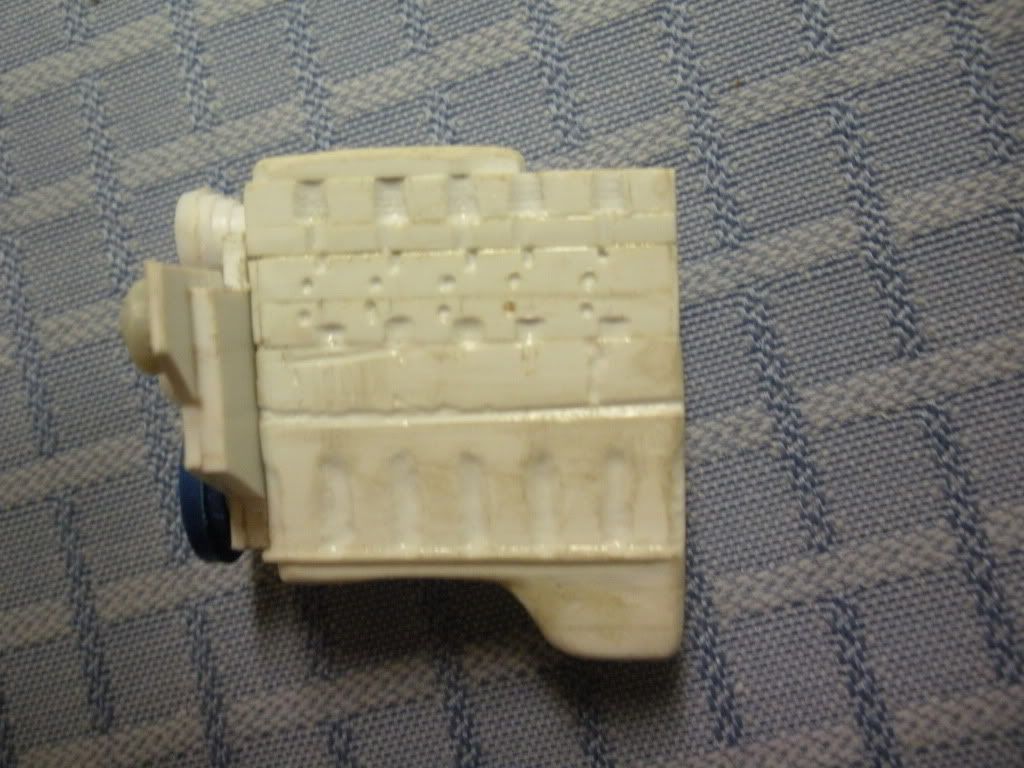

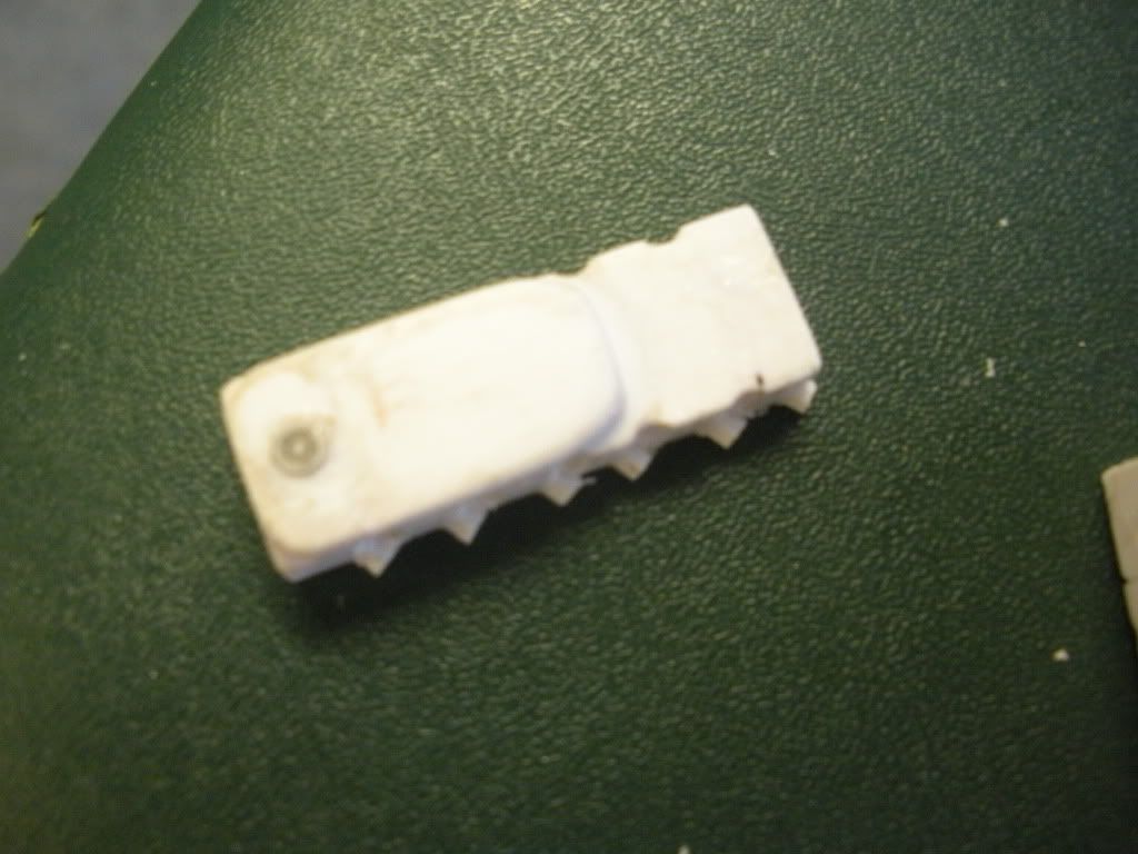

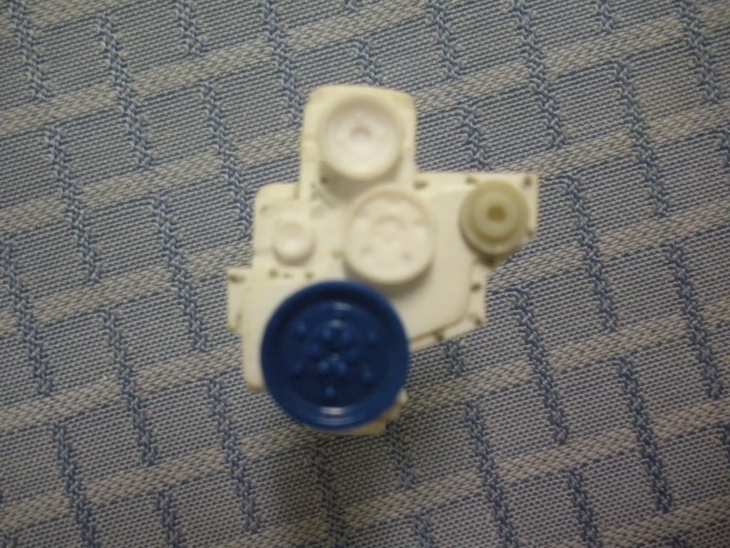

stewart Posted September 12, 2010 Share Posted September 12, 2010 (edited) I built a one-off inline six engine for my fast and furious 67 chevy truck (see my other thread) and was asked to build a cummins for another member of the forum so I decided to post a thread on the build. I started by asking another member for some dimensions (thank you scale auto style). I then cut several rectangles of the thickest plastic sheeting I have and laminated them together until I reached the desired thickness. for the oil pan flange, I used a thin sheet of styrene cut to size. I then laminated several thicker pieces on top of this to create the basic shape of the oil pan which will be shaped with a dremel tool and file. I finished all of the basic shaping on the block. It just needs the head and valve cover to be made and placed on. All the engraving I did with my dremel tool, file, and knife. STewart Edited June 16, 2011 by stewart Quote Link to comment Share on other sites More sharing options...

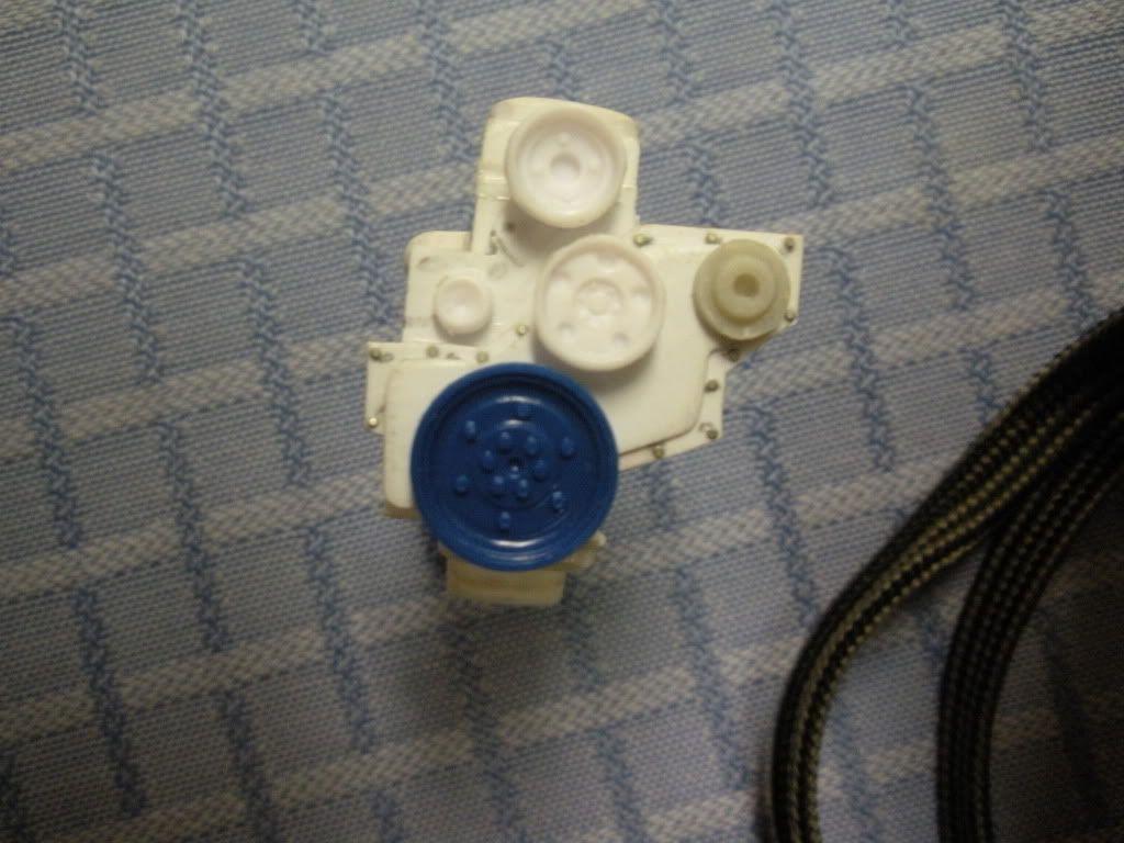

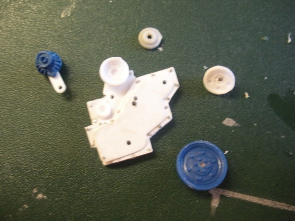

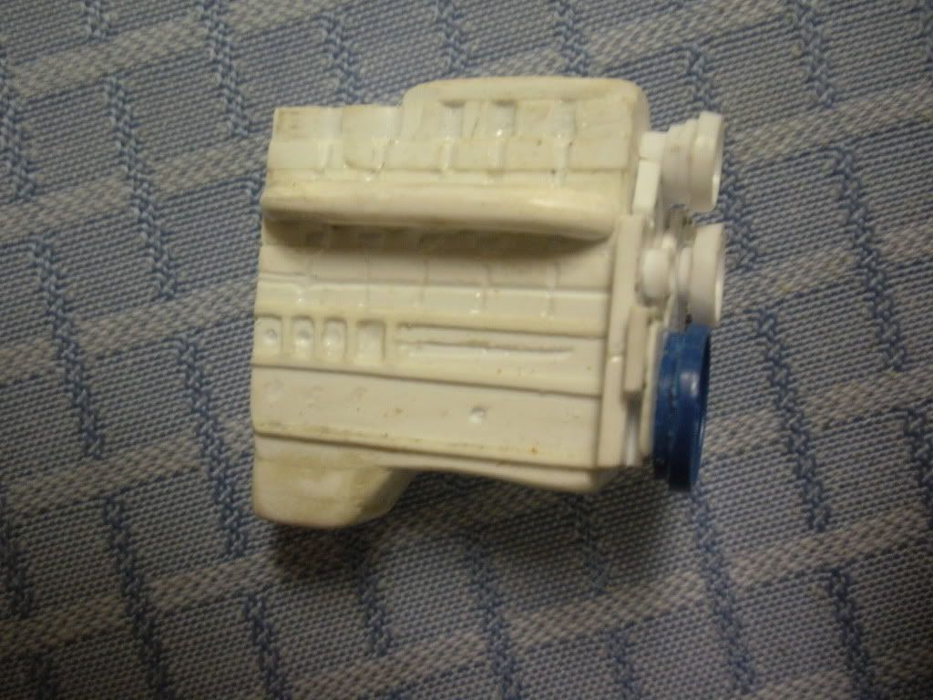

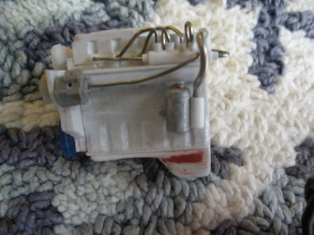

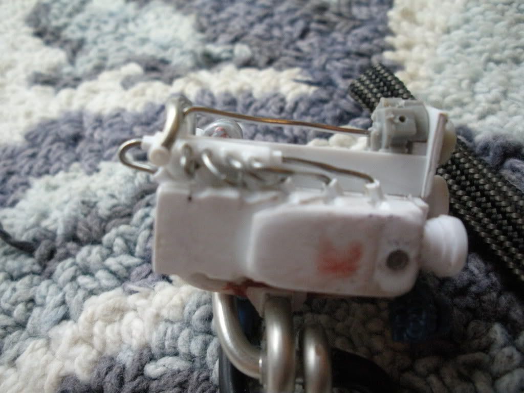

stewart Posted September 29, 2010 Author Share Posted September 29, 2010 I have completed the basic block and most of the engine front and pulleys. Now I am starting to work on the turbo, exhaust, and intake setup along with all the rest of the things. The engine front is just from sheet styrene, and the pulleys are from the parts box. I used Pro Tech photoetched bolt heads and a Detail master photo etch piece from their engine detail set for the oil fill cap. You can see the beginnings of an exhaust manifold in the previous and next pictures. STewart Quote Link to comment Share on other sites More sharing options...

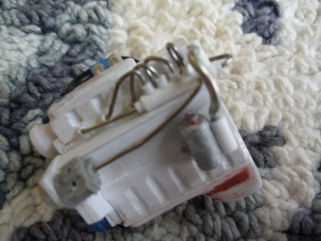

stewart Posted October 4, 2010 Author Share Posted October 4, 2010 I am working on the turbo setup and have started the air intake. I made an oil filter and pirated an alternator from a Revell kit. I also finished the exhaust. STewart Quote Link to comment Share on other sites More sharing options...

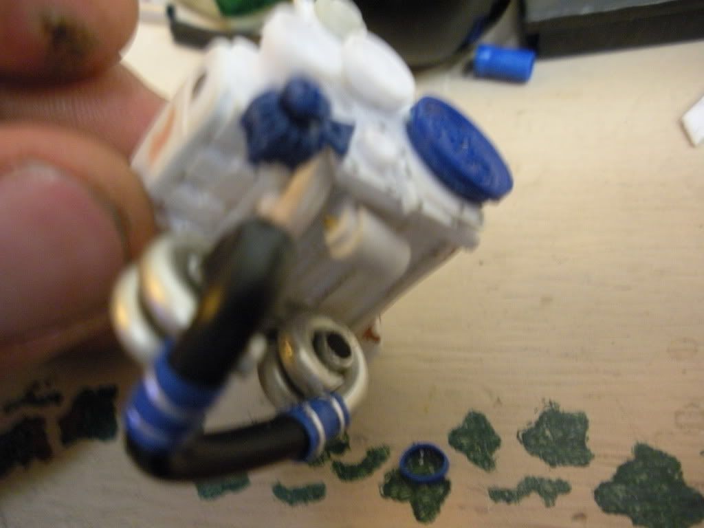

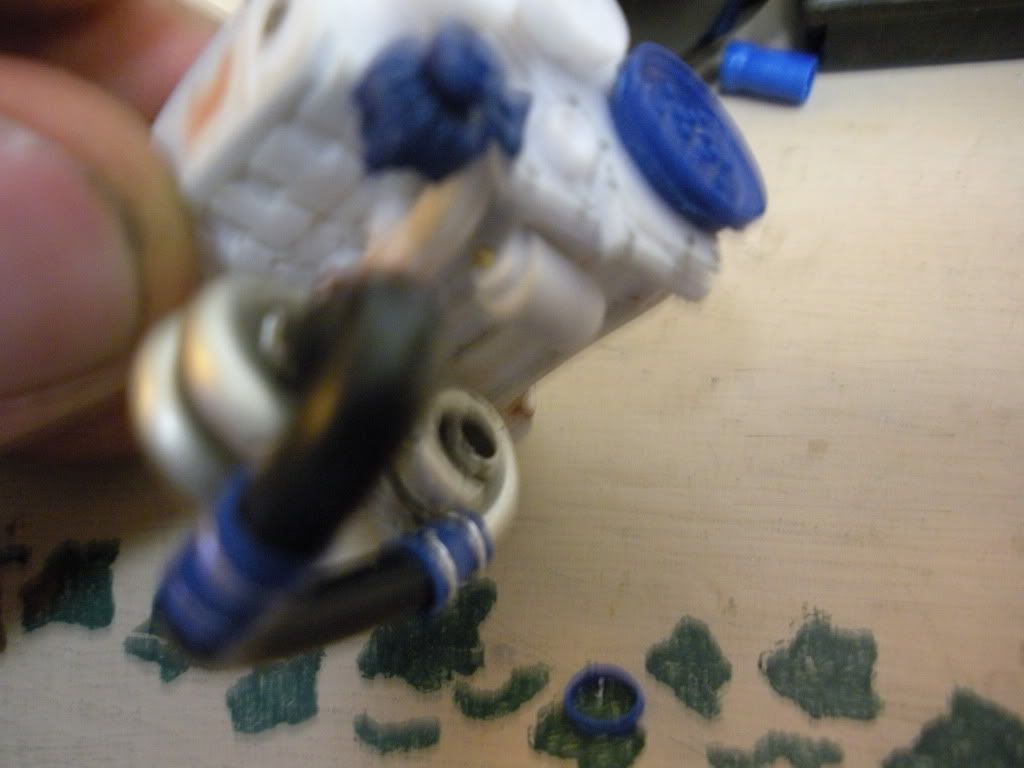

mistermodel Posted October 4, 2010 Share Posted October 4, 2010 what are the black and blue intake parts made out of? Quote Link to comment Share on other sites More sharing options...
stewart Posted October 5, 2010 Author Share Posted October 5, 2010 The black is 12 gauge stranded wire with black insulation. The blue is heat shrink tubing. STewart Quote Link to comment Share on other sites More sharing options...

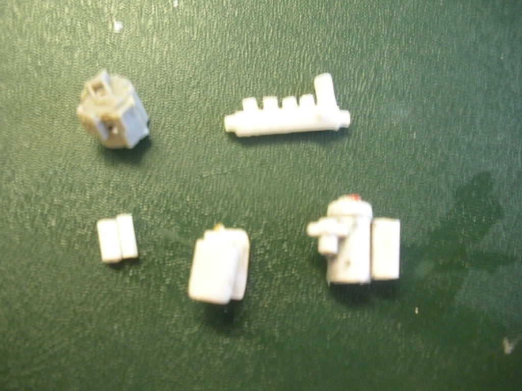

stewart Posted October 17, 2010 Author Share Posted October 17, 2010 (edited) I have mostly completed the engine. All it needs now is the wiring to and from the oil filter and pump, a few more pulleys on the front, an oil pump, and a power steering pump. I have disassembled the engine to send to Alan at Ma's Resin for casting. Here are the pics. exhaust manifold on top, the mostly completed intake manifold on the bottom The engine front with alternator and bracket, and most of the pulleys. (on top) The fuel pump Fuel filter (bottom) fuel line connector oil filter Fuel pump Engine block with cylinder head in place Valve Cover Twin turbos STewart Edited October 17, 2010 by stewart Quote Link to comment Share on other sites More sharing options...
