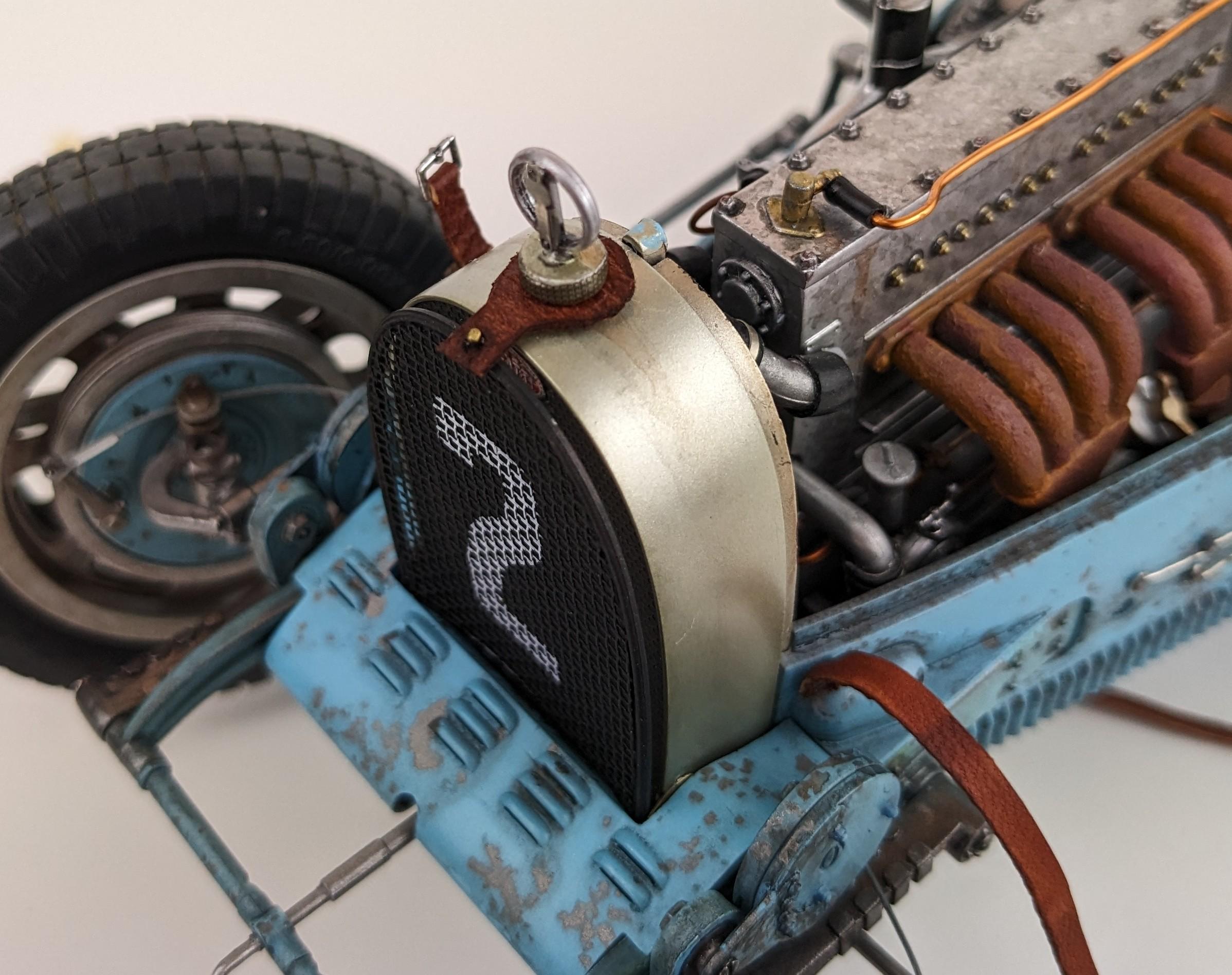

  10. Thanks Pierre! I'm really happy with how the metal finishes turned out. A lot of it comes down to the Vallejo Metal Color paint. The pigments are Metalizer-fine, but Metal Color is water-based and pre-thinned for airbrushing. It doesn't mind being brush-painted over small areas either. A lot of the chassis components were painted with their Gunmetal Grey and then drybrushed with the Chrome to give it depth and shine like the alloy components of the 1:1. Salt weathering is FUN. Definitely going to go into my bag of tricks for future use. It's a really random effect, which is a challenge for me since I like to control every aspect of my builds, but I couldn't be happier with how it turned out. The barn-find aspect of the build suffered from "mission creep" as it progressed. The more you research these cars, even with tatty (or sometimes no) paint and wrecked leather, you realize they are still loved. Which makes sense as they are mid 7-figure cars these days. By keeping the mechanicals shiny and everything else a bit rough, I think I hit that aesthetic.
  11. Thanks man! The exhaust manifolds were done using Perfect Plastic Putty, which is an acrylic putty. I thinned it down to a very thick paint consistency and stippled it on with an old brush. Once dry I primed with Tamiya red oxide primer, misted with Tamiya grey primer and gave it a wash with thinned Revell light brown acrylic. The leather was pretty easy, the hardest part was getting straight cuts on 1/32 in thick leather that wants to bunch up on you as you're cutting. Ask away whenever you'd like. I built the 8c a few years back and it's just as good as this kit. Here's a pic below, I didn't go as crazy on the weathering as I did on this one.

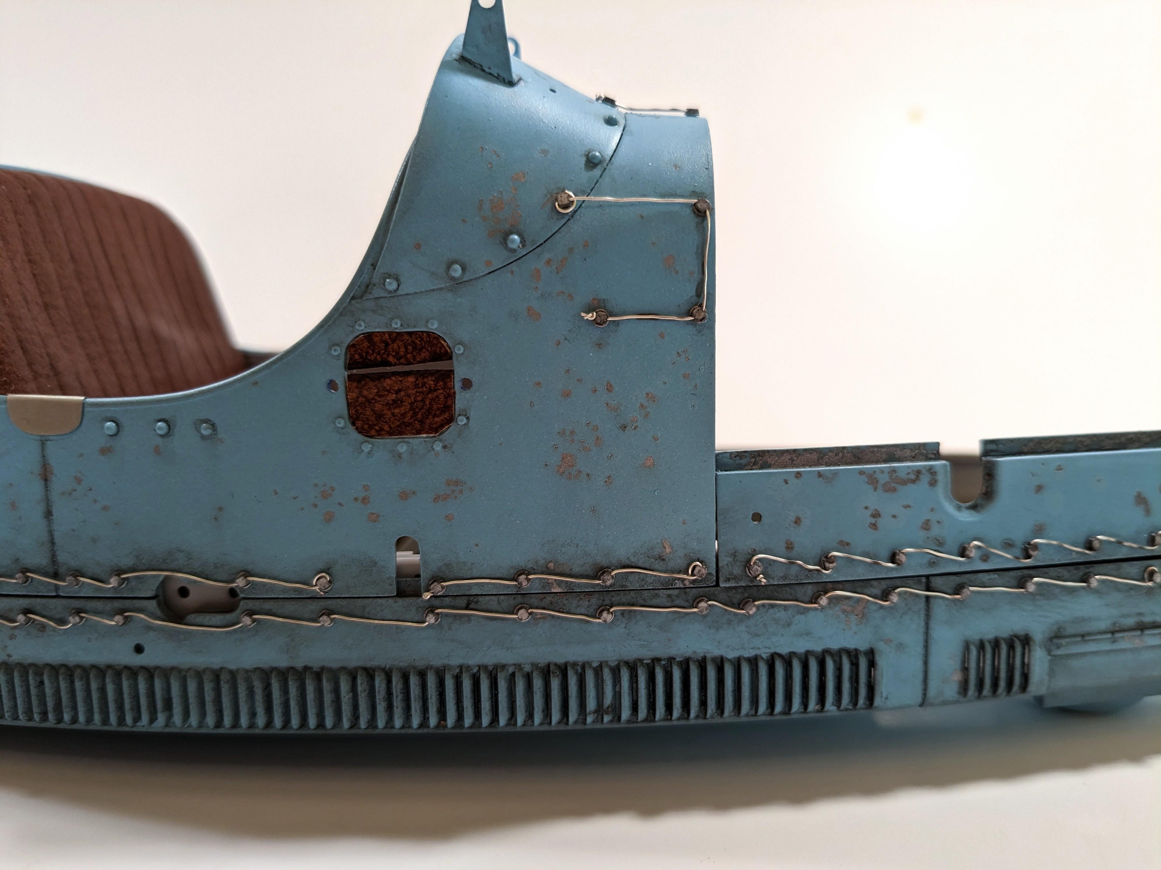

  12. Yes, but not 100% accurate to how Bugatti did it. The locking bolts are 3d printed by a company out of the UK called Unobtanium. THey're an ingenious design that uses a jig to drill .3mm holes for 30 gauge wire through each bolt. They're designed for the 1/12 Italeri Alfa 8c, which is a slightly different design to Bugatti's locking bolts. It looks good though, and this design is less fragile than the accurate ones would be. The wire is 30 gauge soft jewelry wire. Thanks!

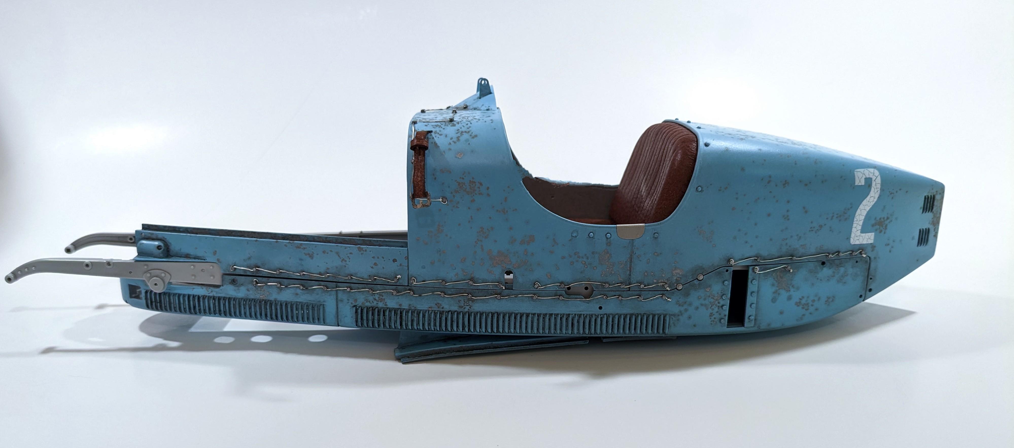

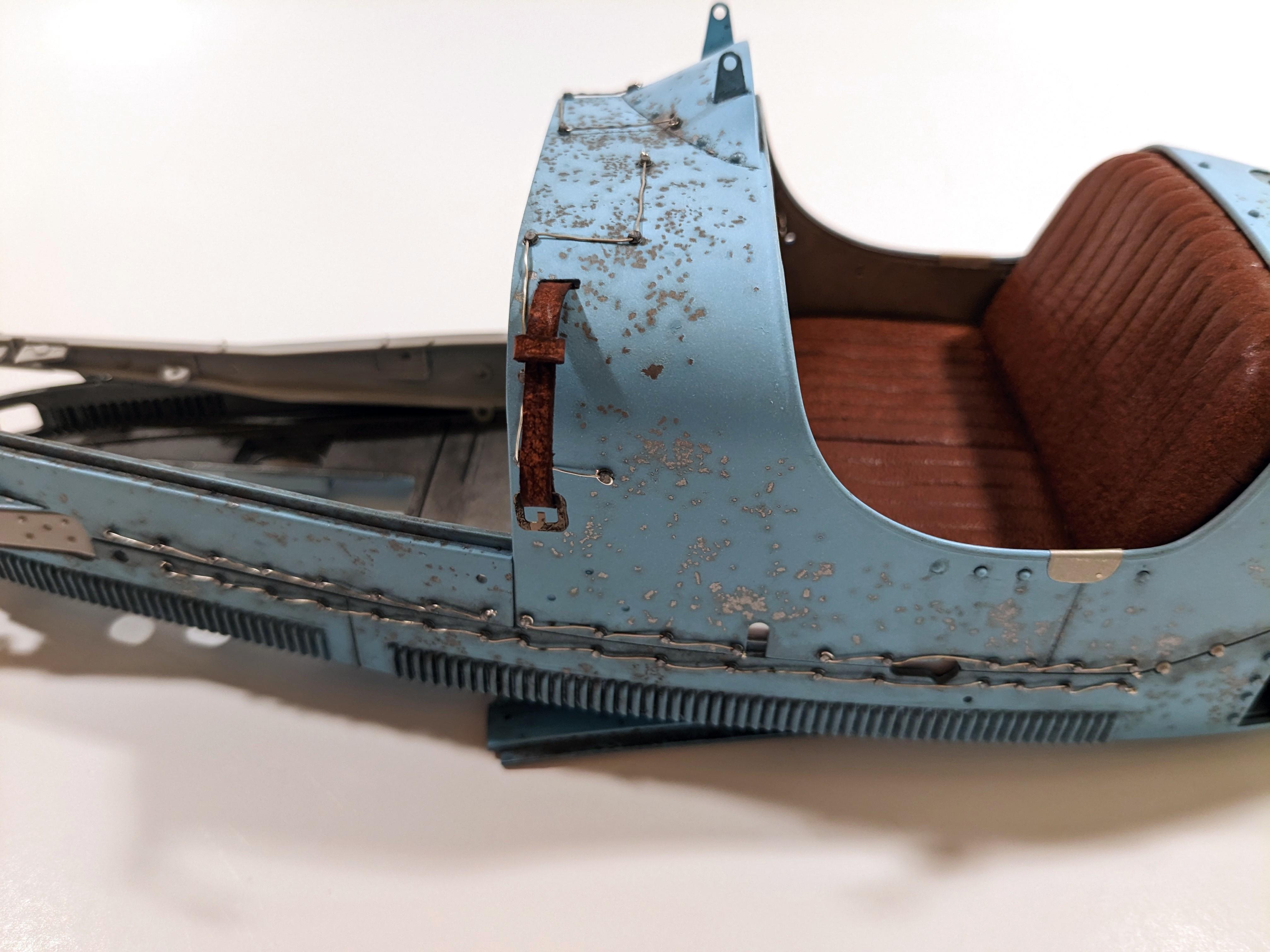

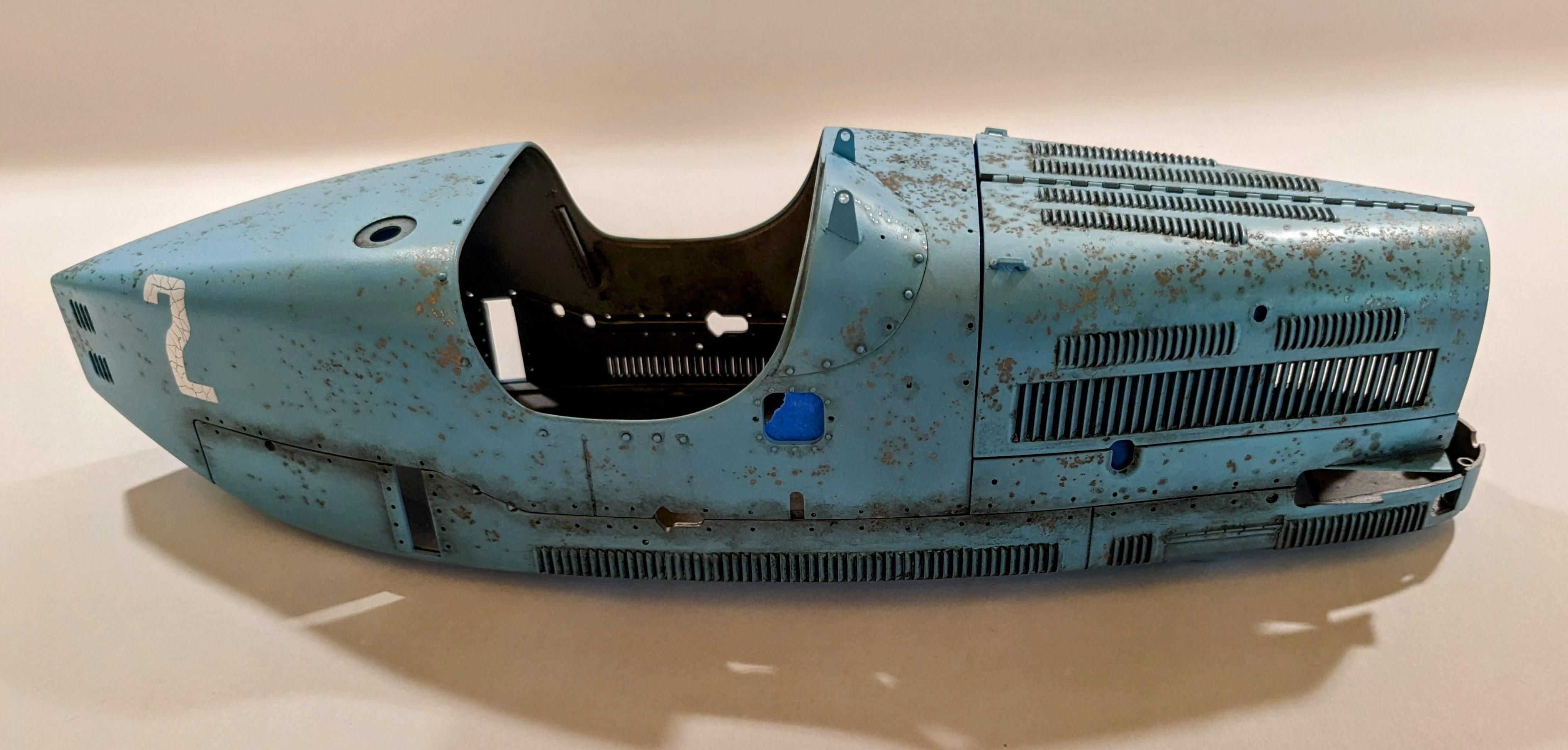

  15. This is Italeri's new-tool Bugatti 35b in 1/12 scale. It's a beautiful kit and a great starting point for a detailed build. I started building this model in my head when the kit was announced in February 2022. My plan was to replicate the carefully preserved patina that the best examples of Bugatti's racing cars all seem to have. It's a tricky combination of careworn paint, cracked leather and polished (but not too polished) metal. First step was to remove the molded rivets and locking bolts for Tichy Train Group styrene rivets and 3d printed locking bolts from Unobtanium. I used a salt weathering technique on the body to allow the bare aluminum base coat to peek through the Vallejo Sky Blue paint. The racing numbers were painted on using masks from Orlee. The leather throughout the car is 1.5oz thin bookbinding leather in distressed Cognac. Brake cables are thin braided stainless steel. Metallic finishes are all Vallejo Metal Color. Weathering was done with Vallejo washes and Tamiya Weathering Master pastels. This was an excellent kit overall. Most of the locating holes needed minor reaming out, largely due to paint thickness. The screws, which are slotted instead of Phillips and not magnetic, were a challenge as well. I genuinely enjoyed this build. Sometimes you're just "in the zone" when building a model and this was one of those cases. It's the first time I used the salt weathering technique as well as my first time using leather for upholstery. I'm sure it won't be my last... I have a LOT left over! Anyway, on to the pics!

  19. Chassis is ready to install into floor pan so I figured I'd get some shots before it disappears forever. The level of kit detail is very good (if a little soft) and really comes to life with a little work. One thing about this kit... the decals are outstanding! No carrier film and they settle down nicely with a little Mark Fit and heat. The turned aluminum on the dash and firewall are beautifully printed. I'd buy these decals by the sheet. The radiator shell was stripped of chrome and painted in a mix of Vallejo Metal Color Chrome, Aluminum and Gold to represent the color of worn nickel plating over brass. Staining was done with Vallejo washes and Tamiya Weathering Master pastels. The grille guard and radiator cap will be installed a bit later after the floor pan is installed. I decided to repaint the exhaust manifolds, btw. Glad I did, the rust color works so much better. On to the pics!
  20. Been a while since I did an update and I've gotten a lot done. The engine is complete, or at least as complete as it's going to get until the firewall is installed. The 1:1 has a machined finish on the block that I tried to represent. I used a base coat of Vallejo Metal Color aluminum followed by a stippled layer of dark grey wash and a final stippling of Vallejo chrome. The Vallejo chrome was also used on the intake manifold. It does a great job of representing polished aluminum. I'm not sold on the paint finish on the exhaust manifolds yet... I might try something else. They aren't glued on at this point as I want them to be positionable when the exhausts are installed later. The other end of the ignition wires will mount into a tube that runs into the firewall. The chassis is built up to the point where it receives the engine. Lots of washes and dry brushing to bring out the details. Most of which will never be seen again after it's enclosed by the body and belly pan. A quick test fit with the firewall and bodywork in place. It's starting to get tight. One thing I've noticed on this kit is that the tolerances are very... intolerant. Next will be the instrument panel and firewall... more pics soon!
